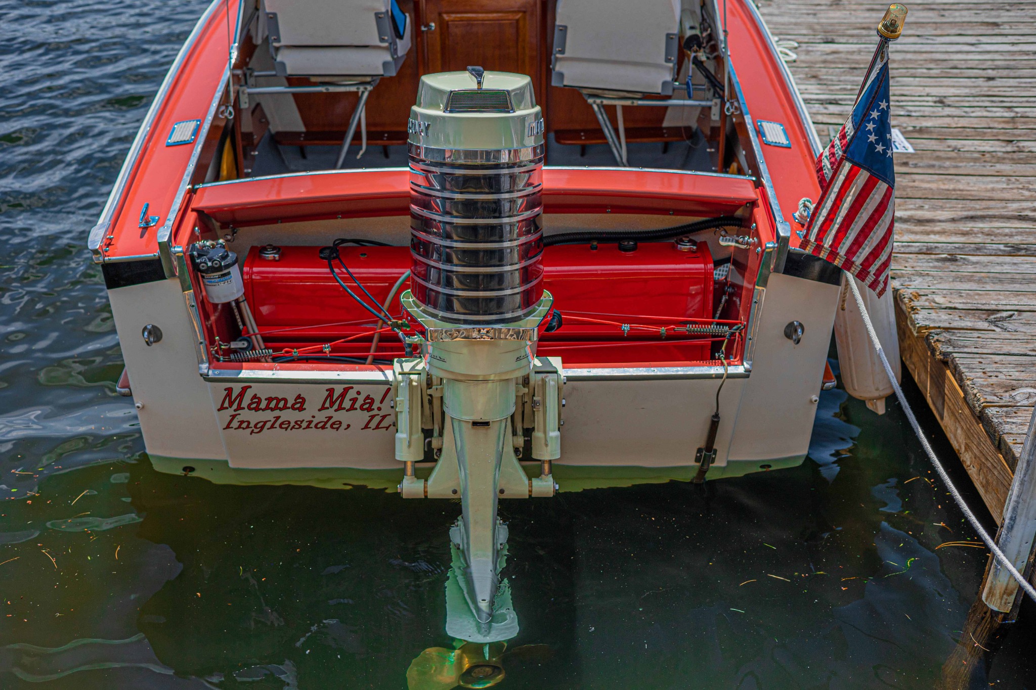

You've had quite a journey with Mercury Heads, Trim packages, steering cables...... Exceptional work with show quality results.
Looks like the Nason Urethane has held up remarkably on Mama Mia!.
