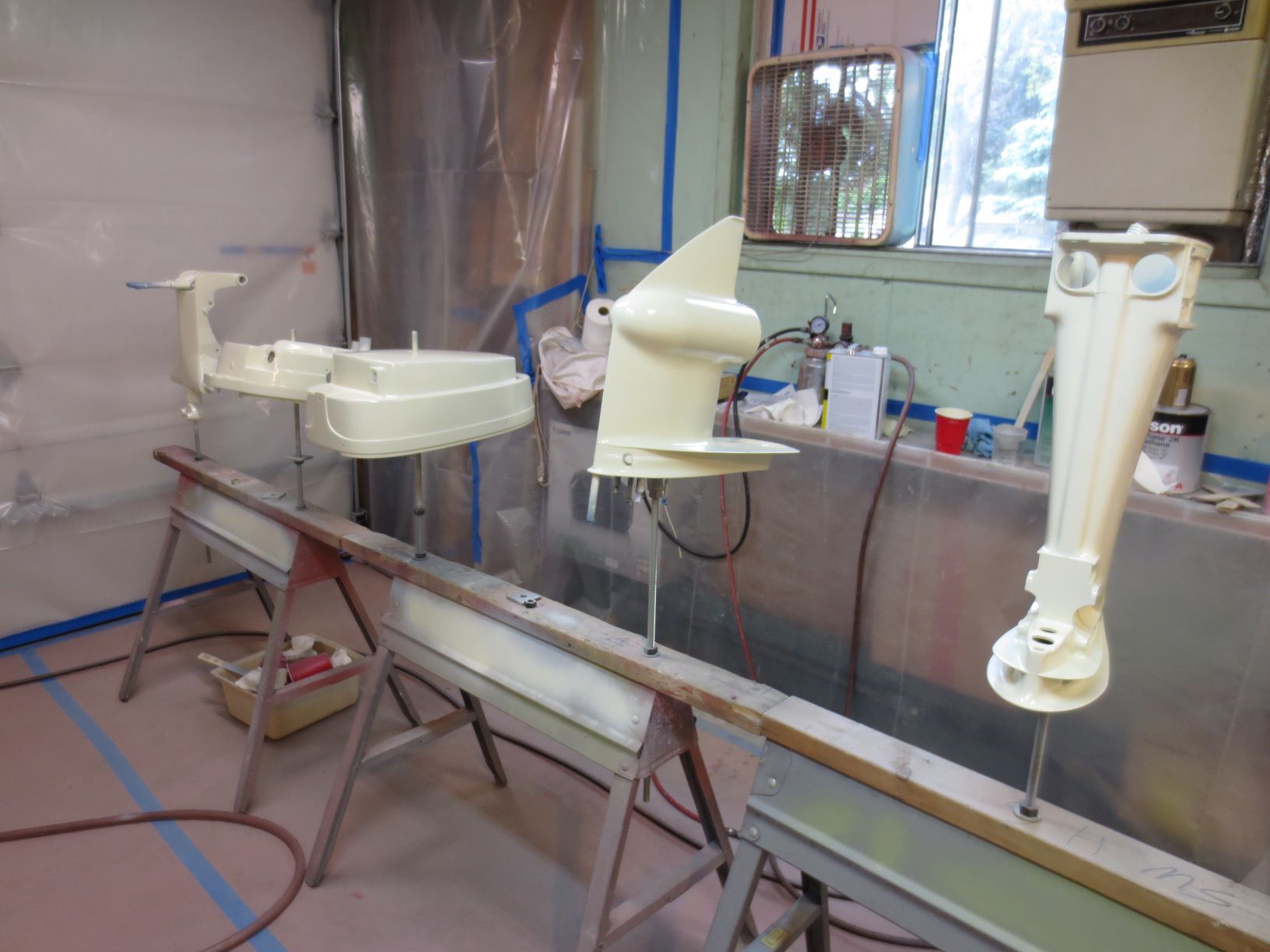

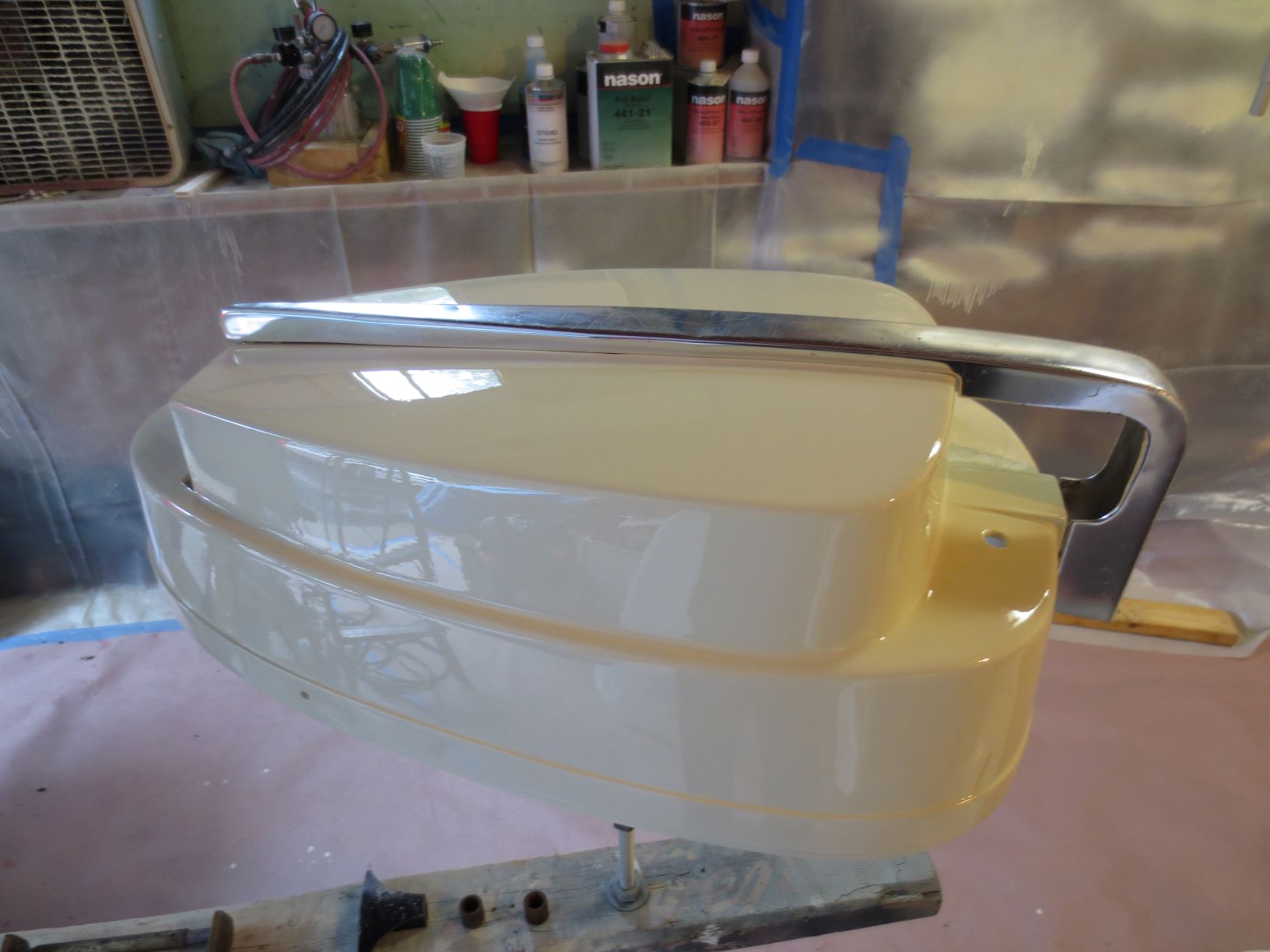

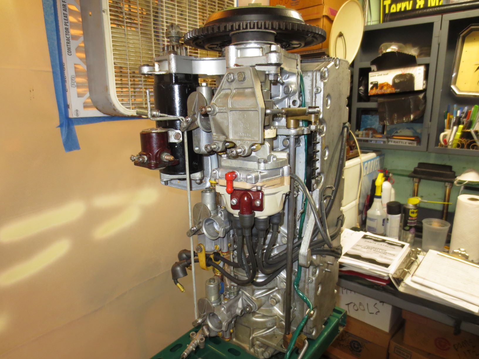

Hey All,

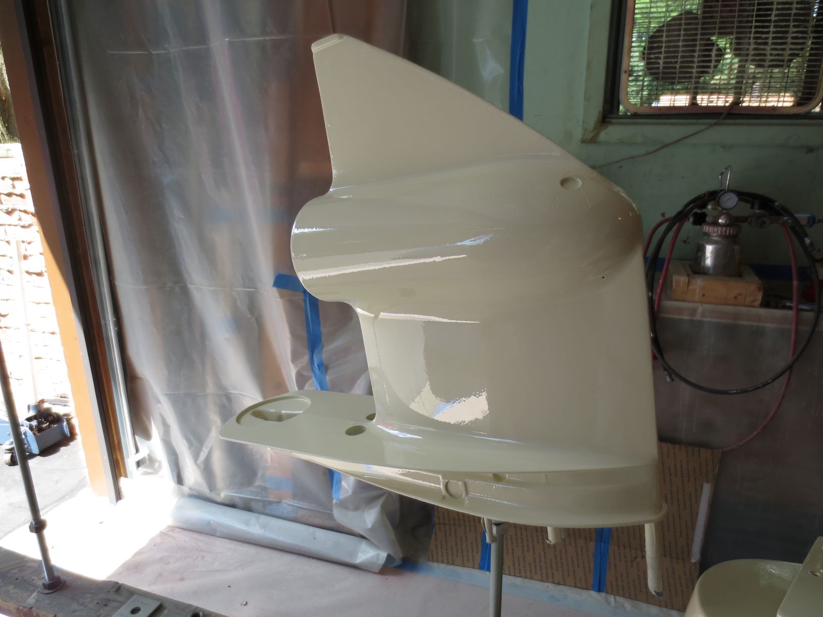

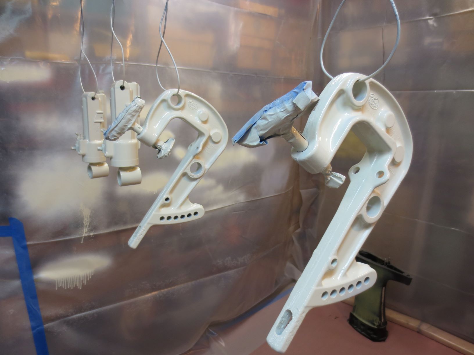

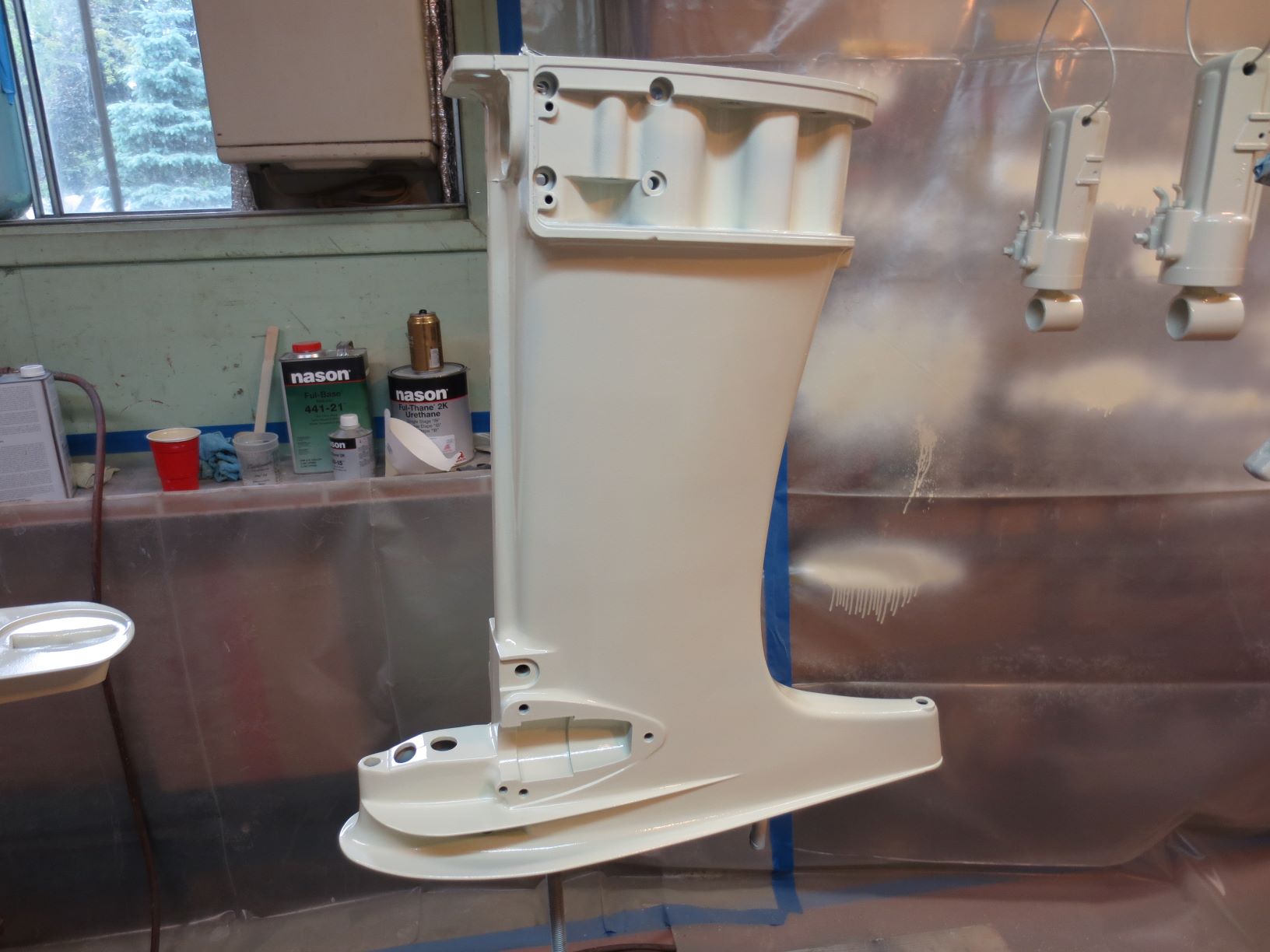

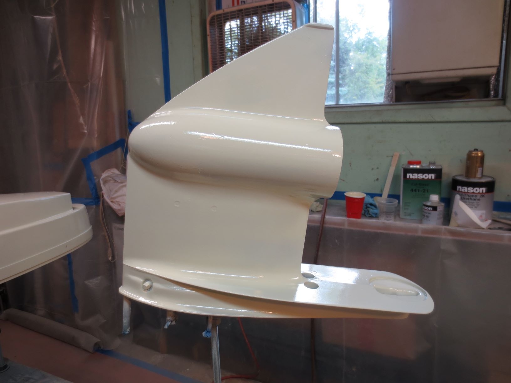

Finally got my ass in gear up here in the Holler and put some paint on this 61 Merc 800EL-1
Used Nasson single stage urethane with high build sanding primer over top of etching primer on finely blasted aluminium.
The lakes here in Northern IL are open now and I plan to get the motor in the water next week and see how it performs. Concerned with the noise I heard but want to make idle adjustments on the water and then run it and see what happens. The Merc manual states carbon buildup can cause noise so I got a can of Merc Tune and gonna blast and soak it and pray for a miracle.
Hey Randy aka 63g3,
Thanks for all the great info and recommendations. You know you should write a book.
I determined the rattle is not emanating from the lower unit or cowl. I had actually considered replacing the cap bearing, when I had it torn down, based on what I learned from Bob Grubb at OldMercs.
Thanks,
Terry

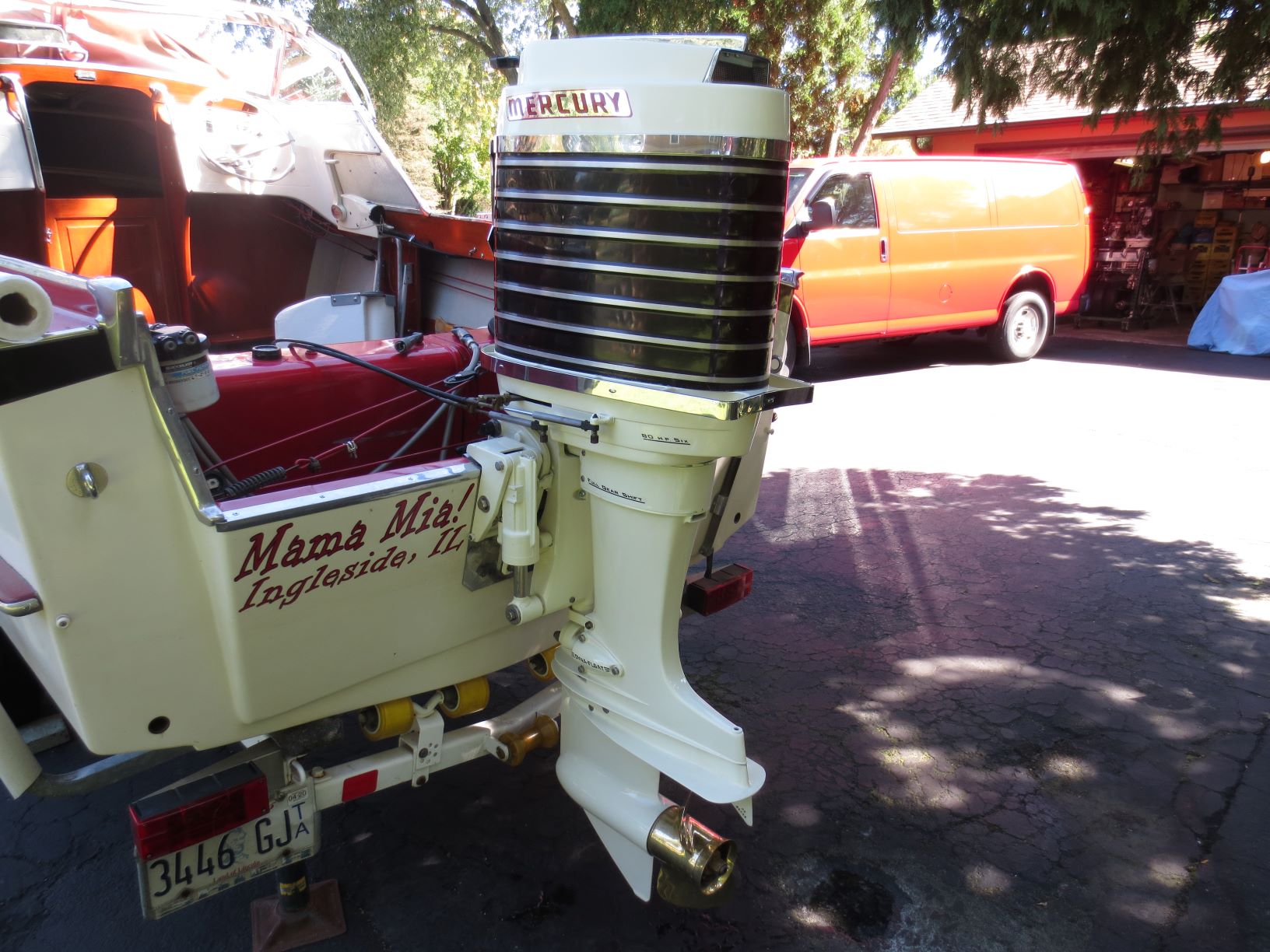

Thanks Cal,

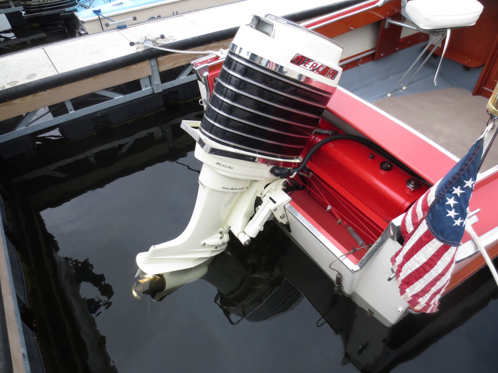

Still at work and making some progress on the Old Merc.
The motor performed great over the weekend and Mama Mia! took a 2nd Best Fiberglass award at Famous Freddie’s.
Been using the SeaFoam and she starts up cold on first try every time which is amazing.

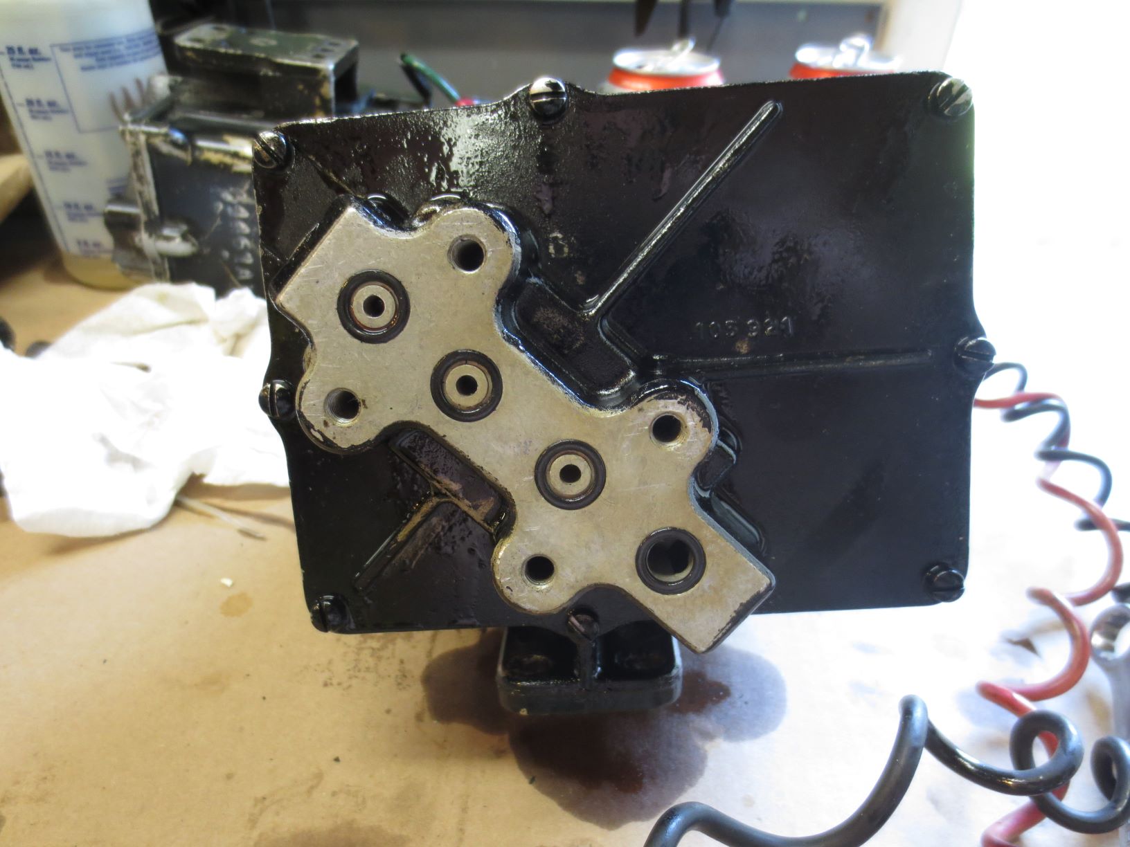

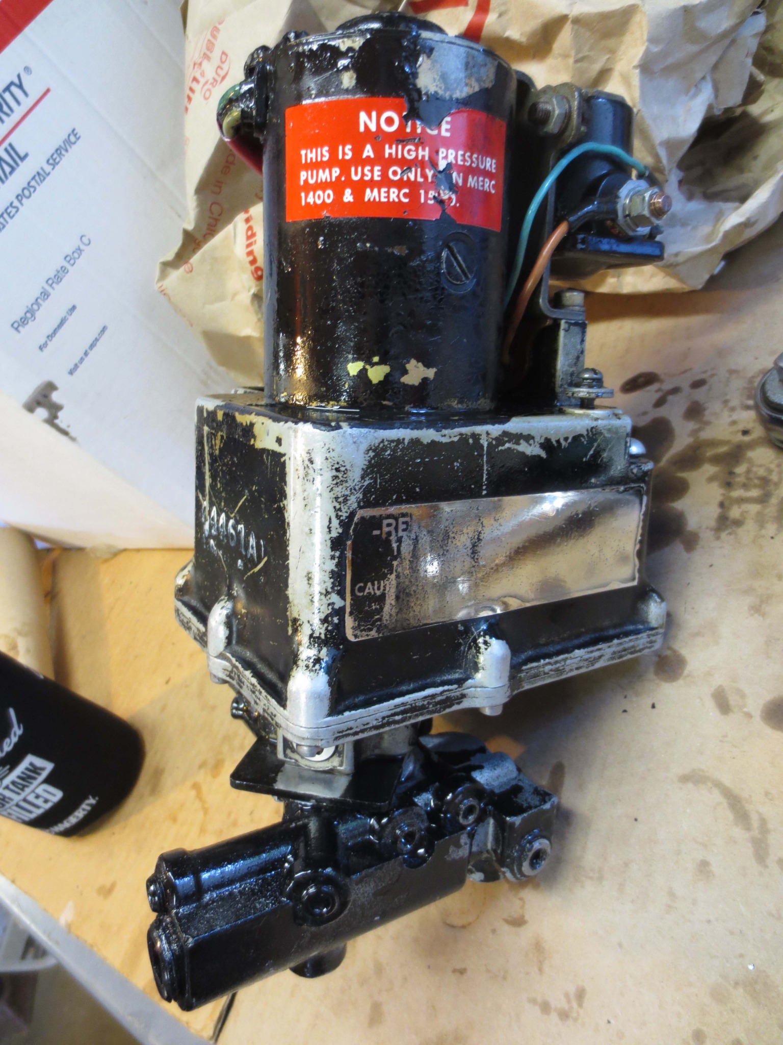

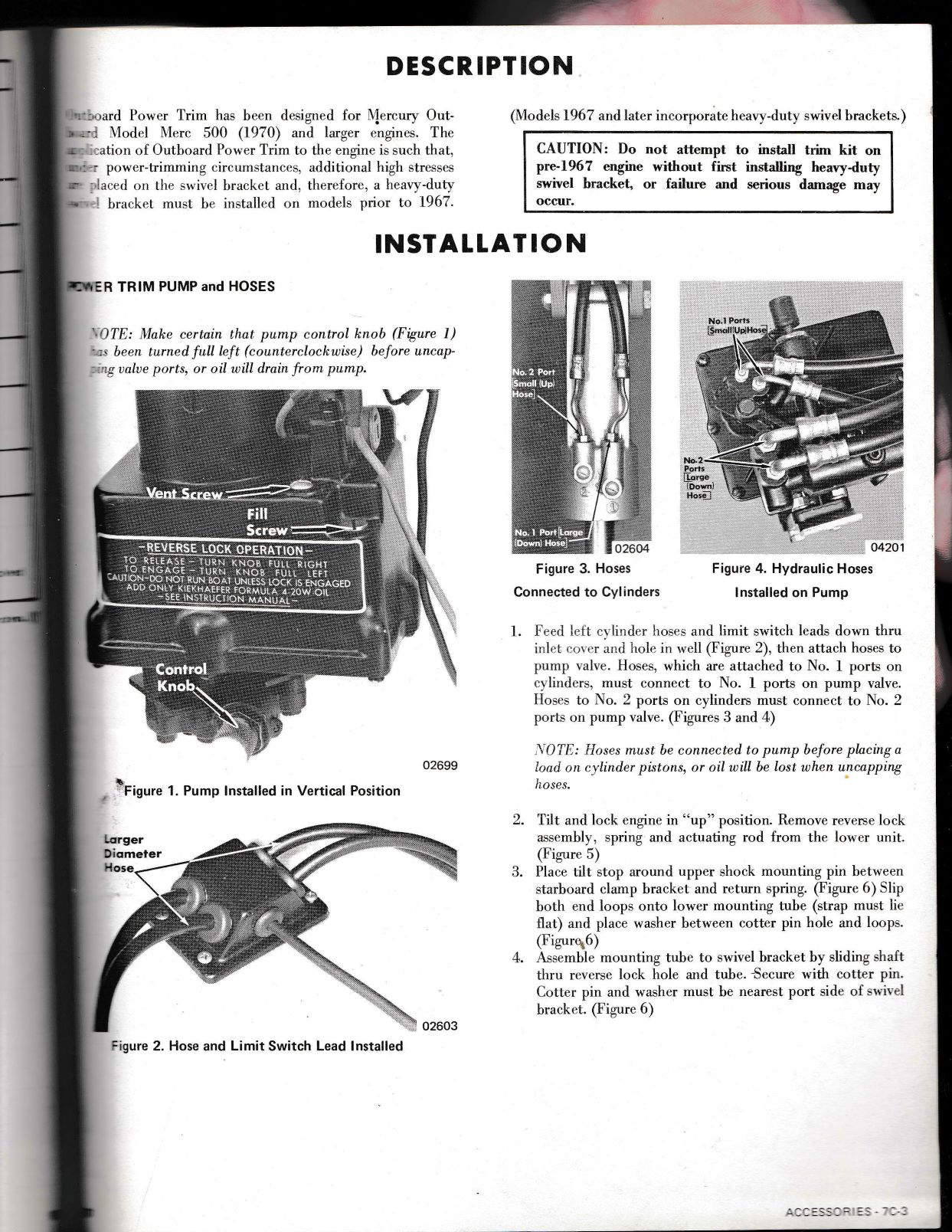

Have the tilt/trim setup assembled and goes up fine but gotta push down by hand when pump the pump is reversed.
Also, I’m curious how this is supposed to be wired. The pump only has one solenoid.
Our friend Mary has found a copy of the Mercury decal and is going to replicate the same.
Working on the lower unit reassembly next.
Thanks,
Terry
Inline six power tilt trim 7 years 3 months ago #140333
Terry,
If the power trim rams motion when tilting up isn't stopped by a safety strap, the rams go fully extended, which results in the Merc can tilt over center (too far), and then when attempting to tilt down, the rams can't contract unless you manually give the beast a slight push.
The trim assembly can have just one solenoid for UP, and for DOWN the trim motor's large green can be wired directly to the small green (maybe green with a white tracer (stripe) since commonly there isn't enough load to require a solenoid for DOWN, with its relative large Red (battery positive).
I've seen lots of those trim systems with (2) solenoids too. One for UP and one for DOWN.

Terry, I was thinking that noise sounded a lot like when I lost a rod bearing on the crankshaft of my v6 Merc. If that is it, you should stop running that one to prevent further damage. There is a test you can perform in the garage that may help find if that is the problem. Pm me of call if you want to discuss further.
Dr.Go!

Terry,
If you were testing the power trim on the motor stand without the weight of the motor, that is probably why you had to push to make it go down. Add that 250 lbs and it will work fine as long as it doesn't go up too far up.
Bill

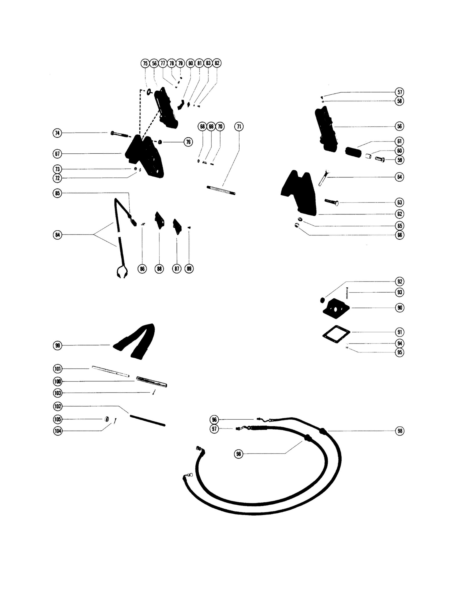

Thanks Doc,
I have the Merc Outboard Parts manual and they show what looks like a strap which is #99 and identified as a Tilt Stop.

Hope it is the simple things Terry. The garage test I was talking about is simple. Pull all spark plugs. Rotate flywheel by hand pick a cylinder and bring that piston to just past top dead center... meaning the crankshaft is now pulling the piston back down the cylinder just past top dead center and stop. Now reach inside with something blunt, firm and that won’t flake or chip and won’t scar the piston. Now pay close attention as you try to push the piston down towards the crankshaft and see if it moves at all. Do this for every piston in the firing order. I did this years ago on my V6 200 and found one piston moved down. It had been making a similar noise. When the engine was disassembled, found the rod bearing to the crankshaft was chewed up and damaged my crankshaft. This was 10 years ago and a new crank from Merc was quoted at 2,400 dollars. I found someone in California that welded and reground the crankshaft that repaired cranks for tunnel boat racers. 350 buck shipped out and back a decade ago and the motor still runs great. I just was trying to be conservative and have you rule out this worse case scenario first if it helped from damaging the engine. Maybe the in line is totally different in noise as I know the bearings are different. Most of the experts here know way more than me. I am just sharing my experience and don’t want others to have my same problem. And least I found my problem and saved my engine before I let it get past the repair stage. Good luck with your other procedures.
Dr.Go!

Better hope not as IL6 have needle bearings rods.

I listened closely to both videos, and it sure sounds like conn rod noise to me. If not the Big End, then maybe a wristpin. Something is really clattery, and I'd be hesitant to run it much more until it's found. Barring something really weird like a noisy distributor (bad bearings, busted internals), I can't see what else it would be except the rotating innards. The 800 should have a solid flywheel, so no possibility of flex-plate noise.
Normally, on a rattly engine I'd say check the upper main bearing, but that doesn't doesn't sound anything like bearing clatter. Too bad, because if it were the upper ball bearing, it's pressed into the bearing cap and you can pull the cap without tearing apart the powerhead.
One last thought, how does it sound under load in the water, say at a fast idle? Still clattery?
How 'bout when you're underway at a good clip, can you still hear the noise. Or is it mostly at idle?
If you do decide to tear into it, one thing you can first do is pull the intake port covers. You'll at least get a good view of the intake side of the pistons, and the exhaust port side of the block. Maybe you'll be able to see something in there.
Maybe the Doc can weigh in, does it sound like a Death Knell to Mien Gut Docktor, eh?
HTH...........ed

unfortunately best bet is to pull the powerhead and take a look inside...

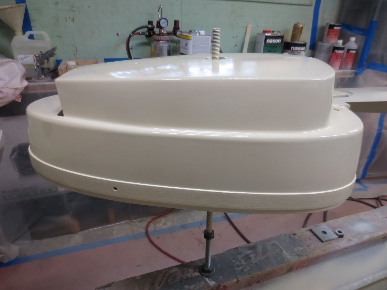

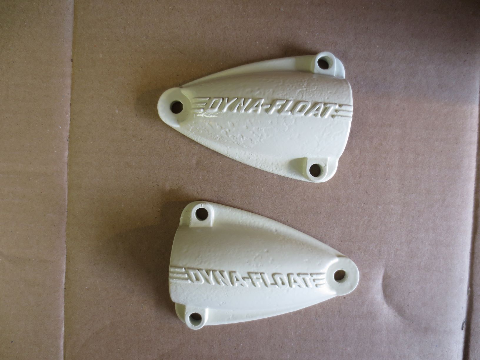

Hey All,
Pluggin along here up in the holler and making some progress. Thanks for all your comments.
Have not run the noisy 800-1 since last post and think from what I am hearing from you all the power head is certainly a candidate for dissection. I always wanted to open one up.
So, I cleaned and dressed my original 800 and it is ready to plug into the cowl.
Hope to have it all together and on the boat this weekend.

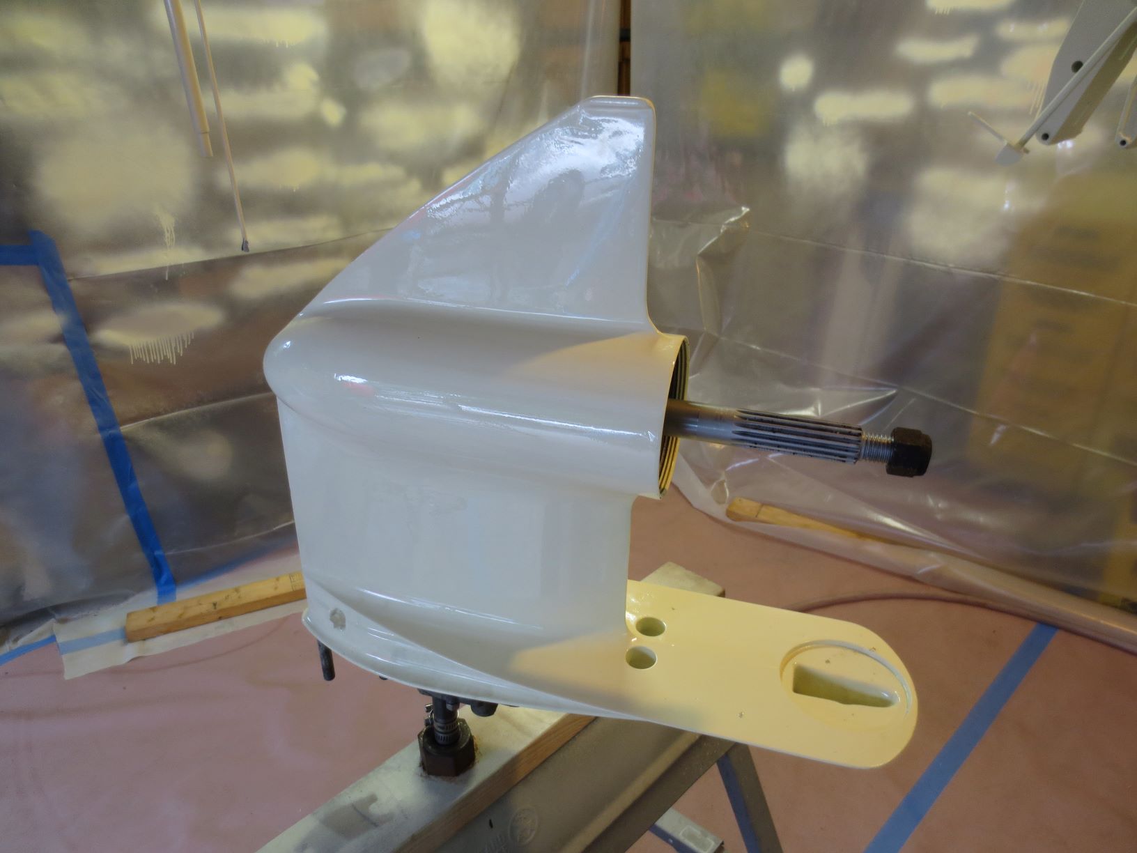

Lower is reassembled and of course I nicked the fresh paint so need to sand and put on some more.
Also need to reshoot the top. Wonder if anyone has a spare handle in good shape.
Also, curious if anyone has painted the black on the raised letters.
Thanks,
Terry

what I do is sand front to rear with final 180 grit wet-dry sand paper.
Inline six power tilt trim 7 years 2 months ago #140810
Terry, that workroom is waaayyyy too clean. Question, what was the first thing out of your mouth when you nicked that paint?
Other than those issues things look fantastic. Hope you are able to find the problem on the 800 and get it fixed up before there is any real damage.

Not sure what you mean but if I was to sand off the top of the letters the black paint may be easier to apply.

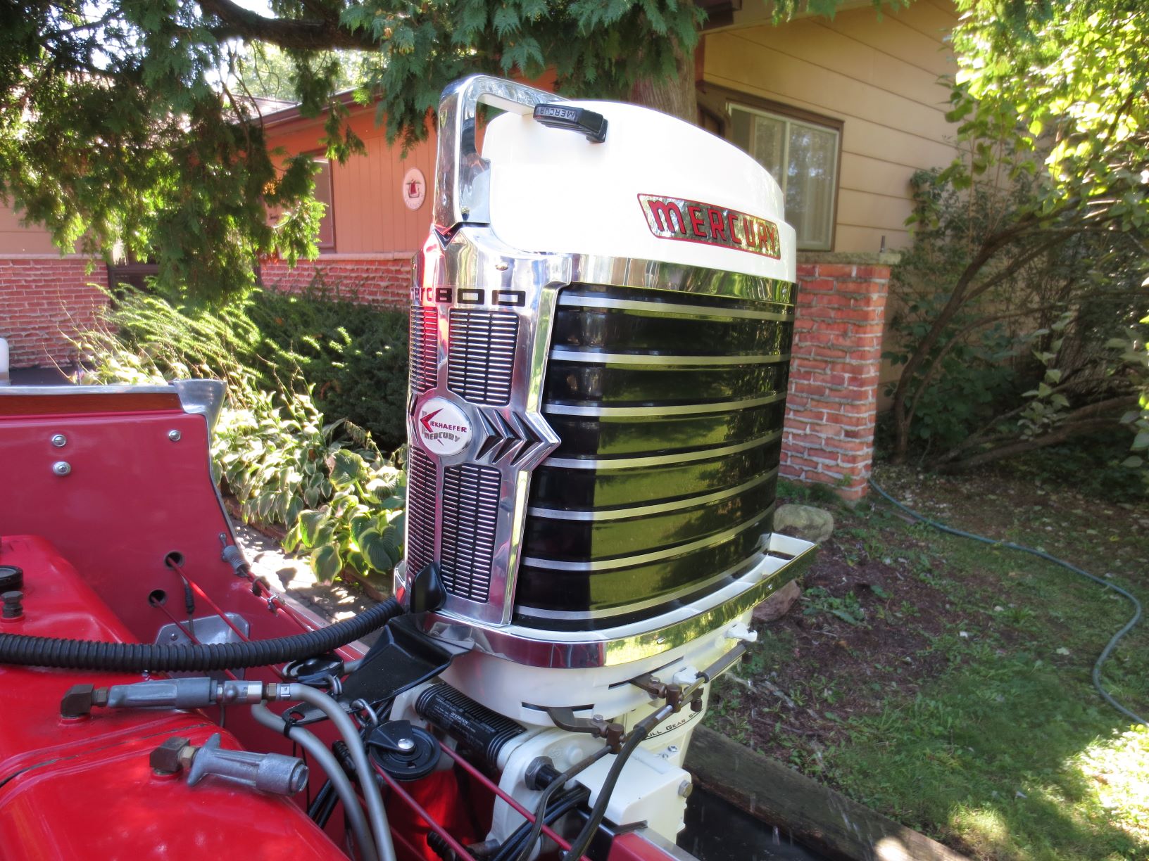

Hey All,

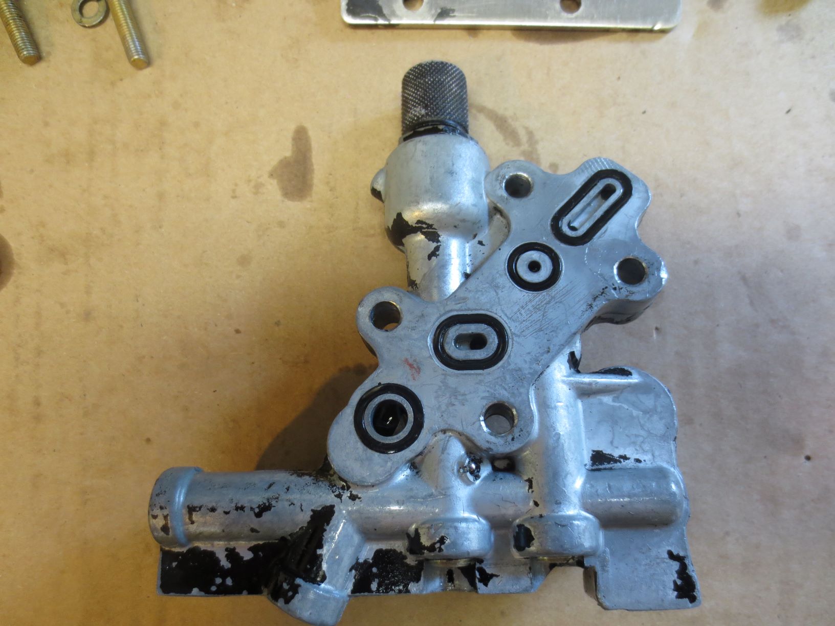

I finally have this old Merc nearly put all back together on the boat. Got it started yesterday and this powerhead sounds just fine.
Have the hydraulics connections complete and the pump mounted. Man! that was a lot of work.
Just have cosmetics to complete now and get her cleaned up.
And we are still planning to show Mama Mia! and her new Old Merc power this weekend at the Abbey on Geneva Lake.
Thanks,
Terry

It’s down to the wire but we’re lookin good to run the Old Merc on Geneva Lake tomorrow.
Terry

Some Merc Guys here say you can use the pre 67 swivels with caution. Mercury made it clear in the Power Trim installation manual.
Not sure of the last year where the heavy-duty swivel is interchangeable but thinking early 80’s. Also not sure if there were any manufacturing differences for the Canadian market.

Thanks Bruce and welcome back.
The new Old Merc refresh turned out pretty good.
No, I have not investigated the rattler 800 any further.
There were two schools of thought regarding the noise. Some thought carbon buildup and others internals.
Al suggested a rod going though the case would be the tell all.
Sounds like something is moving around in there to me and want to dig into it for sure.
Working now blasting a top cowl for paint with the cast MERCURY lettering.
Thanks,
Terry

You made a good choice painting the engine with a durable finish. I did the Gale V4 on my Skagit with Nasson GM Fleet White in 2002. 15 years later it still looked like new, excepting for a few chips on the lower unit. I sold it to another California boat enthusiast. It's more expensive to do it 'right' but boy, it's worth it to have a lasting job.

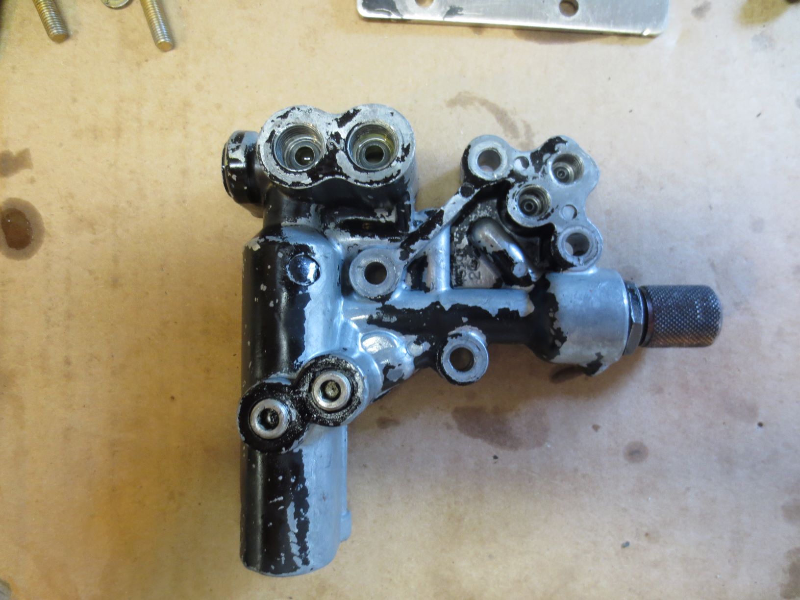

Hello Merc Guys,
Headed back to the water after some extended down time. This Merc 800 after the P/T retrofit was on the water once and the reverse lock did not engage. Prop walks out of the water in reverse. Really make docking a challenge.
Merc manual says internal cylinder leaks or valve assembly inoperative. When I pull the motor up manually, I can hear oil gushing in the pump reservoir.
Bled as recommended although on the second bleeding the motor would not tilt back down. Tried pushing and it would not budge.
Relieved the pressure on the upside of the cylinders and it came back down and seems to operate OK but still no reverse lock.
Doc says the motor can travel up to far and stick. I do not have the restraint and guessing that is what is supposed to prevent over tilting.
Any Ideas would be appreciated.
Thanks,
Terry

Do you have the reverse lock knob on the PT&T pump in the correct position? You shouldn't ever be able to pull the motor up manually unless the knob is fully CW. To engage the reverse lock the knob should be turned fully CCW.
I'd imagine if that valve was leaking internally, it'd cause a problem as well.
IIRC Thom said he used some poly or other type of non-rotting material to make his own tilt-limiting straps.
HTH..........ed

Thanks Ed,
Turning the knob does not affect the lock. I’m guessing the control valve is is the problem.
Terry

Got my hands on a pump off a 1500. Label clearly states the pump is sized for for those big boys.
The control valve appears to be the same and can find no other #’s for the valve so hope it is a correct replacement.
Learned quite a bit these last few days chasing down this issue, but the knowledge was hard to come by.
A wise man told me yesterday this particular part is a good example of Mercury’s holding some information close. It’s like the witch’s house. You don’t go in there.
Thanks Joe,
Terry
