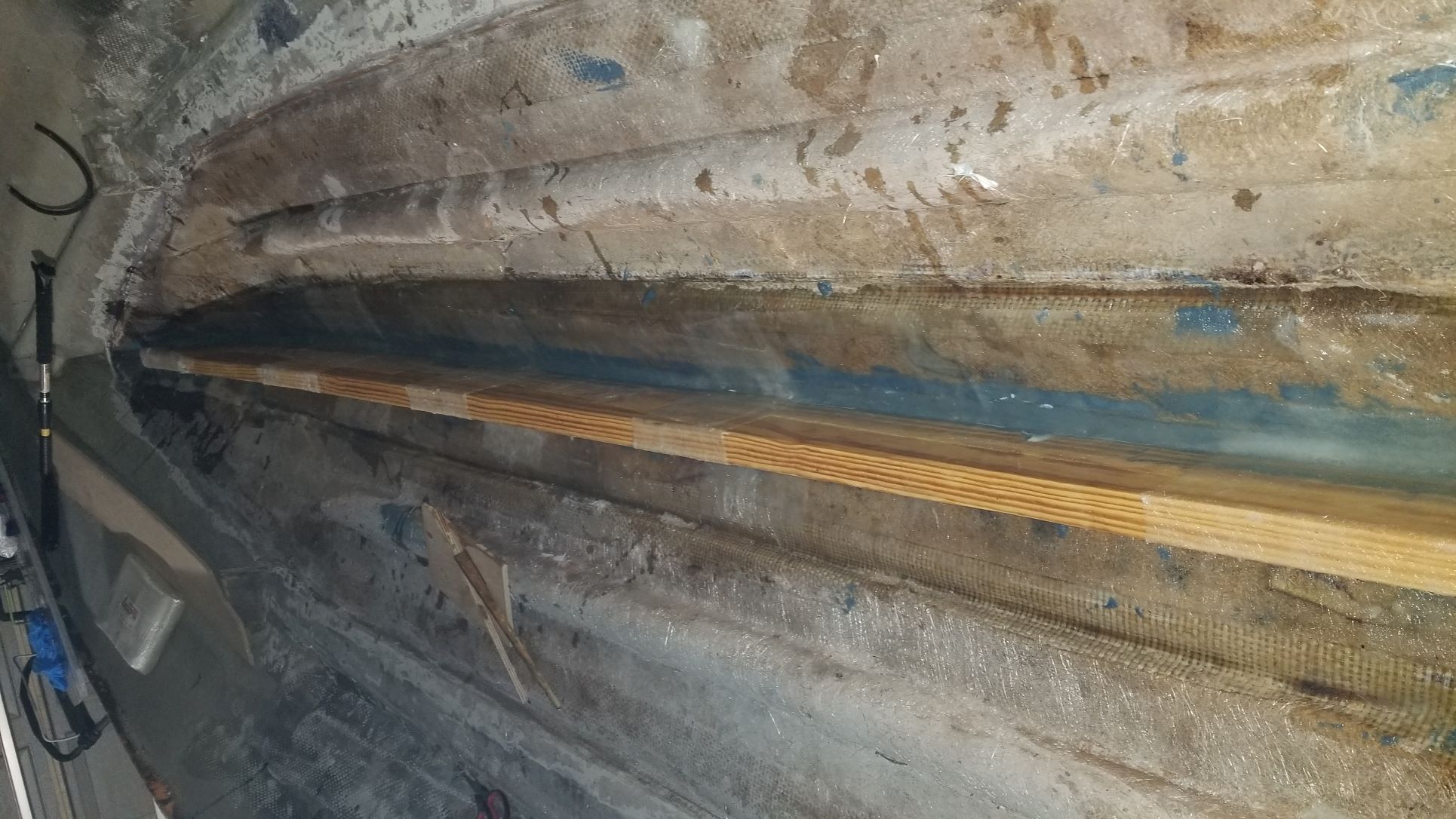

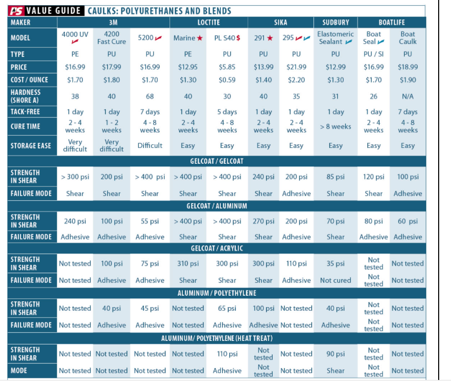

Little at a time getting some more done. We got the cap flipped over and cut away the old fiberglass that was holding the wooden supports for the bow deck. A few of them had broken or detached from the fiberglass on the underside of the deck. It looked like these supports was placed and the cap was flipped over onto the hull before it was dry and the wooden supports sagged away from the bottom of the deck. (sorry didn't get photos) Started to grind on the old fiberglass in preparation to reattach these supports but my battery died on my grinder with the sanding disk on it and went to change it out and realized that someone drained the other 2 and didn't put them on the charger. (could have been me but easier to blame some one else) so I placed these boards back into position to see how they fit against the hull and look to be a really good fit that will take little pressure to get the fiberglass back into the shape it suppose to be at with these supports doing their job. I will add a couple pieces of wood where the faux hood scoop is to give some additional support in that area as there was not really any thing there.
I was shopping for some 5200 adhesive and my home store by me does not carry it, there is one that has 7 in stock 40 miles away but I wondered if there was an alternative product out there that is equivalent. Googling it, I found Loctite makes a product and my local store has it in stock. It is also about $16 instead of the 3M 5200 price of $25. Has any body used this product and had any issues with it? I have only read about people on the boating forums using the 5200. Reading about the product online, it sounds like it is a similar product. I did find where someone did some comparison tests at the address below but wanted to hear from someone here and there opinion to using something that does not take a month or 2 to set up.
www.practical-sailor.com/boat-maintenance/marine-sealant-adhesion-tests

I always used 5200 but a drawback is the 7 day cure time. Once it's there nothing will remove it. wear old clothers!
The Century in my avitar had the bottom planks laid with 5200. An issue was that it was so good that during the dry winter off season the planks would shrink like normal but the 5200 would not move and the planks would develop small splits in the grain.
I've seen sikaflex used also but never tried it.

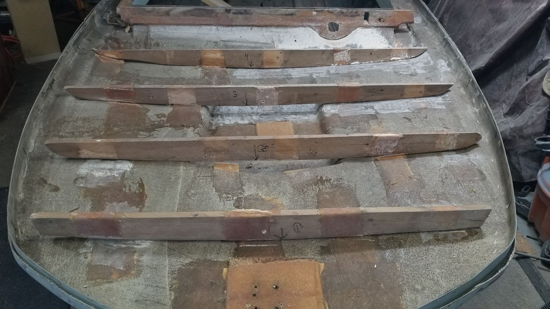

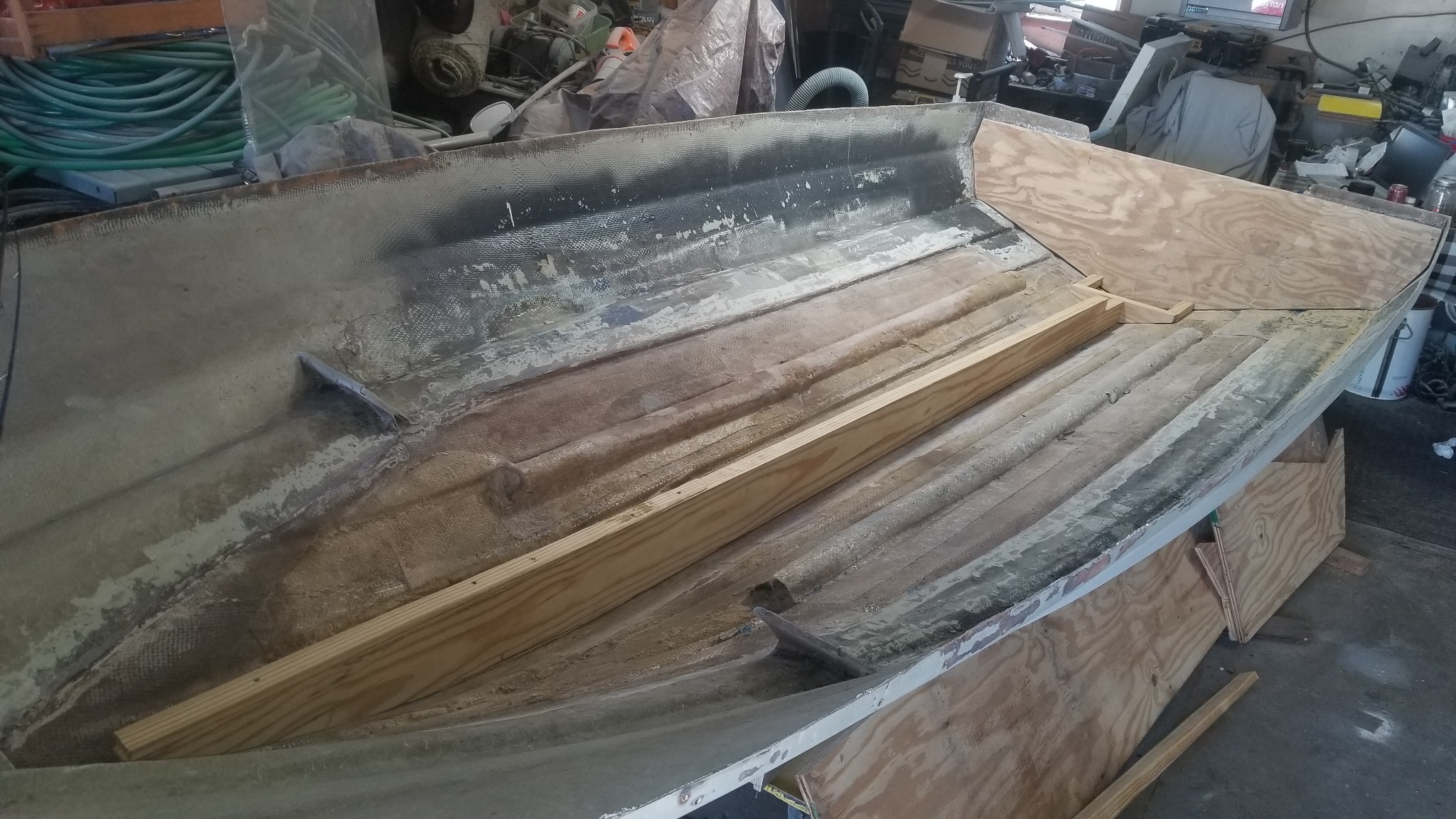

I added an extra support to the existing using a piece of old cedar I had laying around and started to fiberglass it all in. I ran out of the west system epoxy resin I was given by my parents left over from their aviation projects, ordered another gal. kit of TotalBoat epoxy to be able to continue. Should arrive today with any luck. I have noticed that the deck has sagged quite a bit over the years so i have added some weight (bucket of bird seed and a ratchet strap to pull it back into more of a shape it should be) When I get to work on the stringers and flooring I will add some vertical support from the stringers up to the bottom of the deck to keep this from happening again. I have been looking at the some other Glastron builds for ideas on how to make this bow deck much stronger. I cant find any pics now that I am looking for it, but have it in my head how to do it. I have seen where there is 2 vertical supports that make a cubby for skies. Im thinking something like this would make the deck rock solid.

Nautilus wrote: WOW! Lots of questions...

Question Nautilus, If you don't mind sharing your expertise some more. As the order of tasks have changed many times in this project, I am finally getting close to setting the stringers and pouring foam. What density foam do you recommend? Thanks in advance and hope all is well.

The stringers need to be totally bedded in 3M 5200 and allowed 4 to 5 days to cure before you pour foam. I use the 2lb foam. The 4lb is too dense and you only get half as much coverage. Buy plenty of graduated plastic buckets...same place you buy the foam. I use the 3 qt ones. You need about 10-12, maybe more.

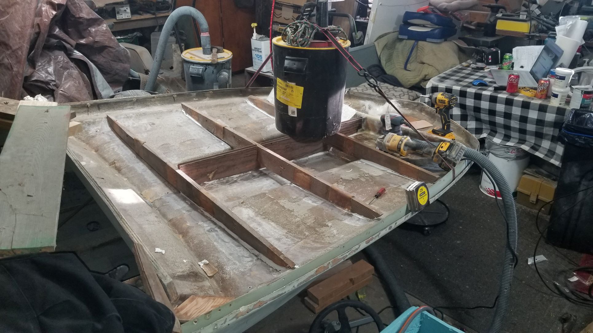

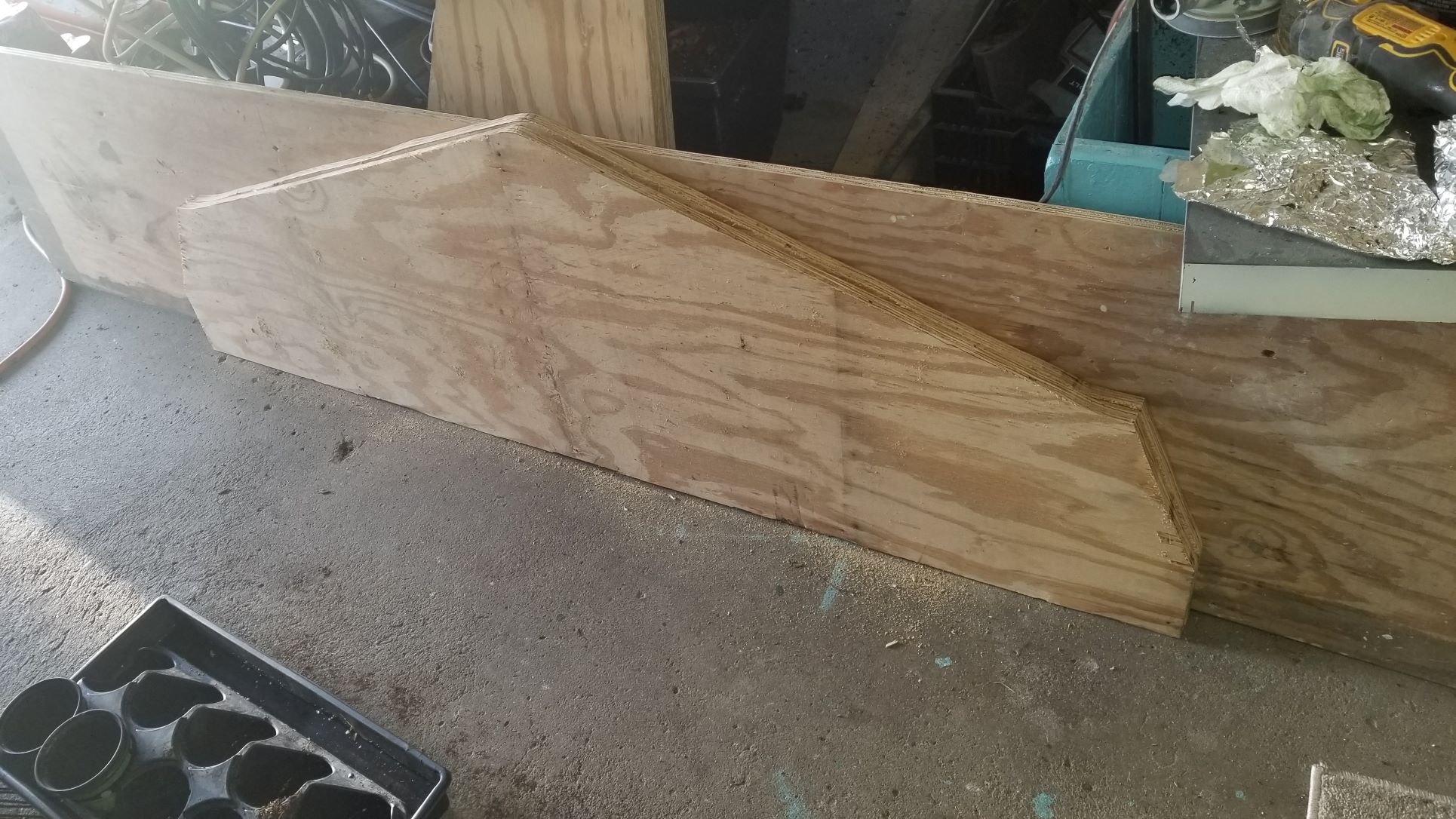

Well, on to the transom. Tonight I cut out 2 pieces to glue together. I cant believe I put her in the water and was going WOT for a good 45 minutes trying to see what this little boat might be capable of with this holding the motor on. It has been 5 months now since the rotted transom was removed. This is takin a bit longer than expected but hoping to have her water ready before summer. That is less than 2 months away. I best get busy!

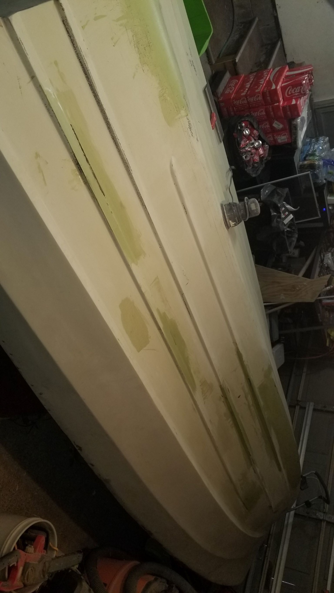

Well summer is officially over. (It has snowed 2 times here already) Got the bass boat winterized and was able to store it over in my parents pole barn. Thanks guys! Now its time to revive this ol thread and get back to work on the old project boat. I didn't get the Jetflite V143 that I was looking at earlier. I had to pass and just let it go. We ordered another gal of resin to get working on finishing tabbing in the stringer. I just need to get some yard work done this weekend, Damn leaves, and move some things around in the garage to be able to get back to work on the hull. I don't remember where I really left off here but the Transom is all set in place along with the stringers, all is coated in resin and most is tabbed in at the rear. The stringer was cut to fit and a few coats of epoxy resin was applied over everything prior to being set in some thickened epoxy down into the hull. I have the floors cut out ready to go in once all is set including adding flotation foam prior to the floors install. I do plan on coating the floor bottom prior to installing just as added protection against any moisture being able to saturate the wood. I still fear the foam process. this could get messy fast and I don't look forward to trimming it. I was hoping to set the floor in and drill holds and pour the foam but I think I was talked out of this method by a wise man here. Thanks for the advice Jan AKA Nautilus. Pictures to follow soon.

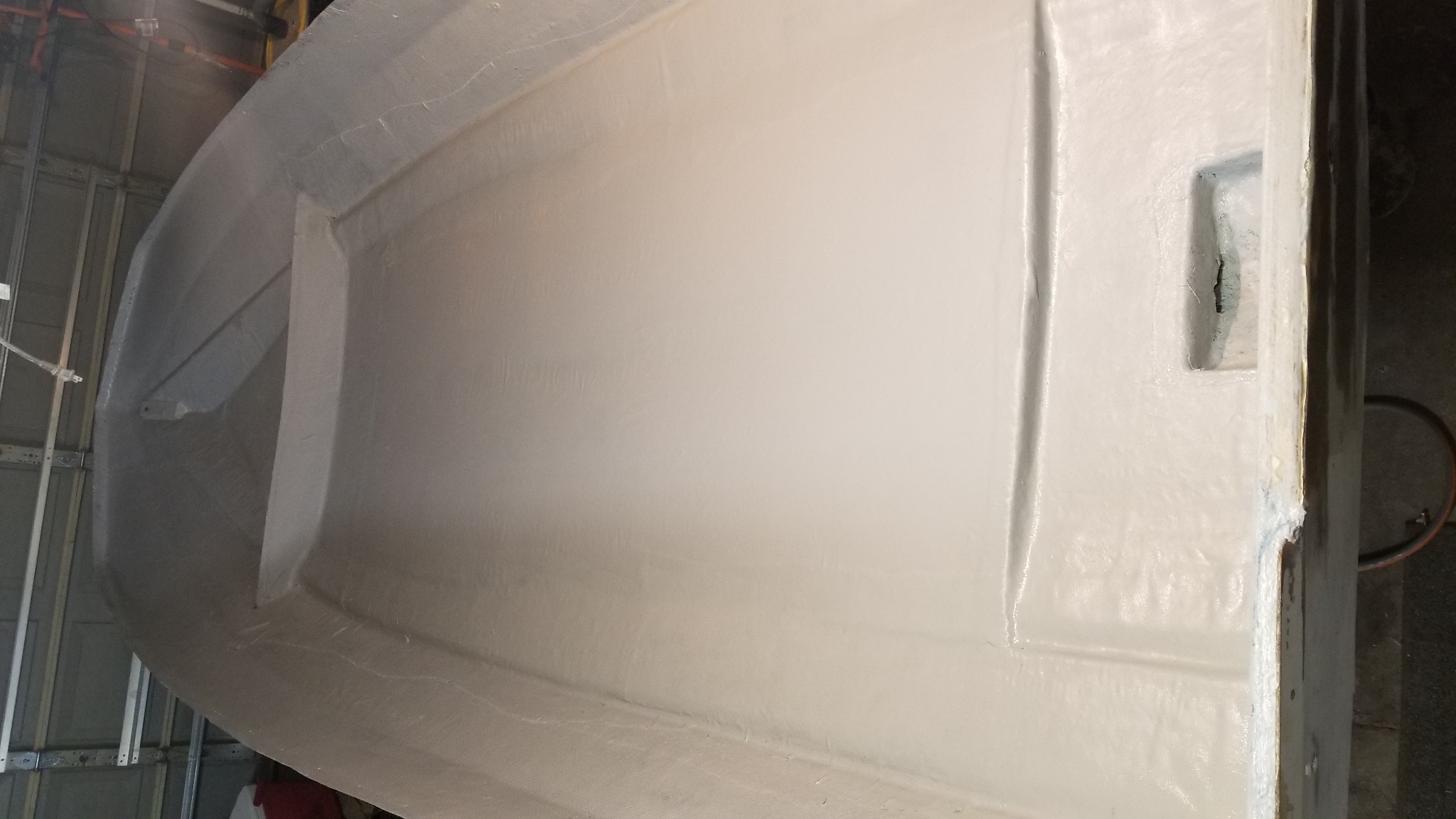

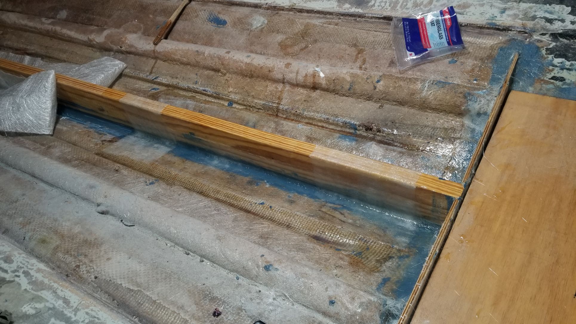

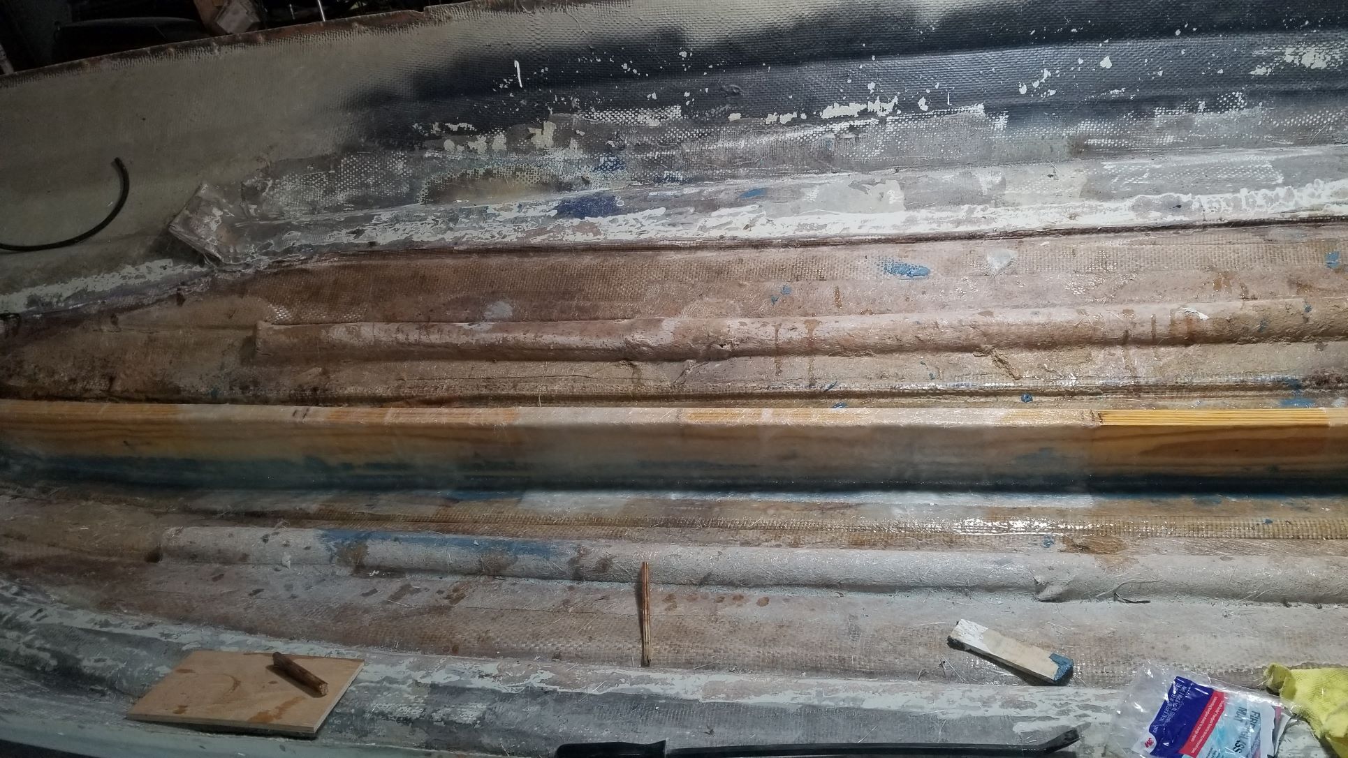

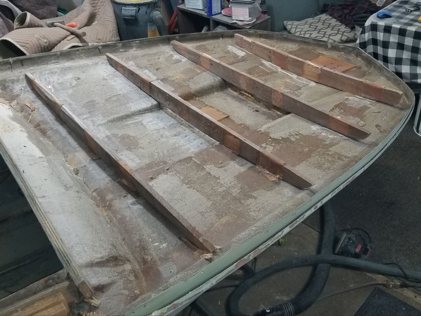

Had some time after work and some on the weekends to finish up tabbing in the stringer. Weather has cooled down quite a bit but still getting out to do some more fishing here and there. Still trying to catch the monster that claims a small fishing hole as her home close by. I have landed a couple of her babies.
Finishing up the last layer of fiberglass today and working out the bubbles. Next is to get the foam poured in.

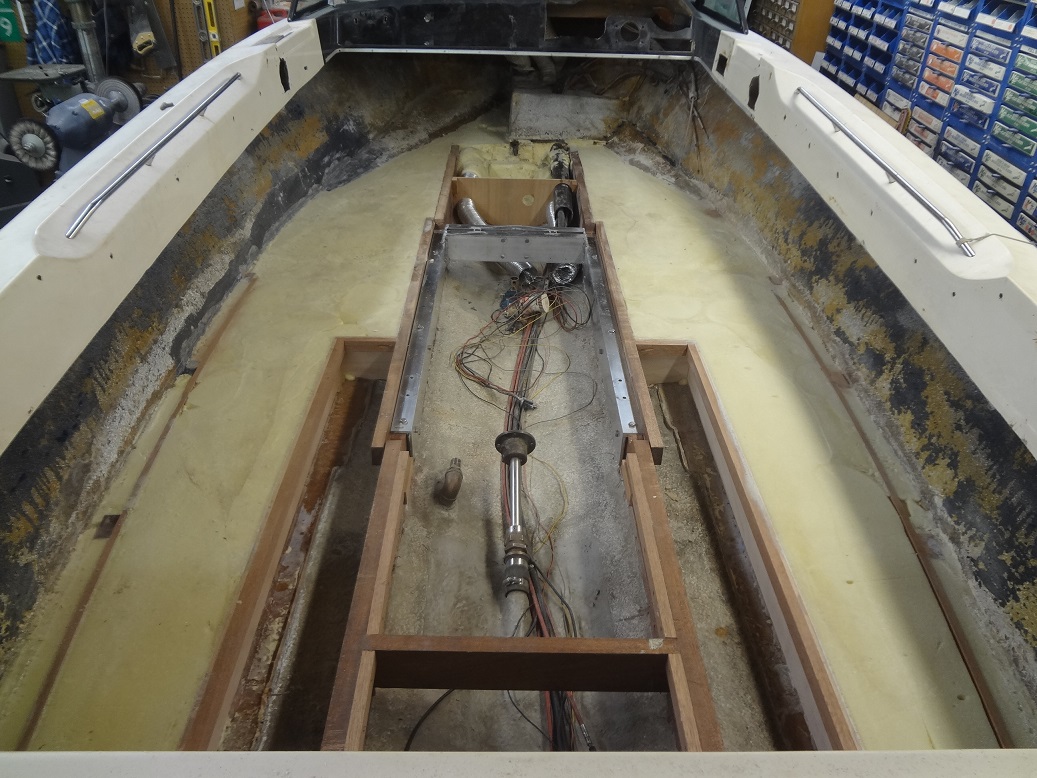

Filling in the rest of the hull under the floor with the foam today. Now to plan on setting the floor in. Question, should I just use 5200 and a bunch of weight to glue this floor down or mix up a peanut butter mix of resin to glue the floor in? I do already plan on glassing the floor in with at least 2 layers of cloth after the floor is glued in place. Any advise on this would be greatly appreciated.

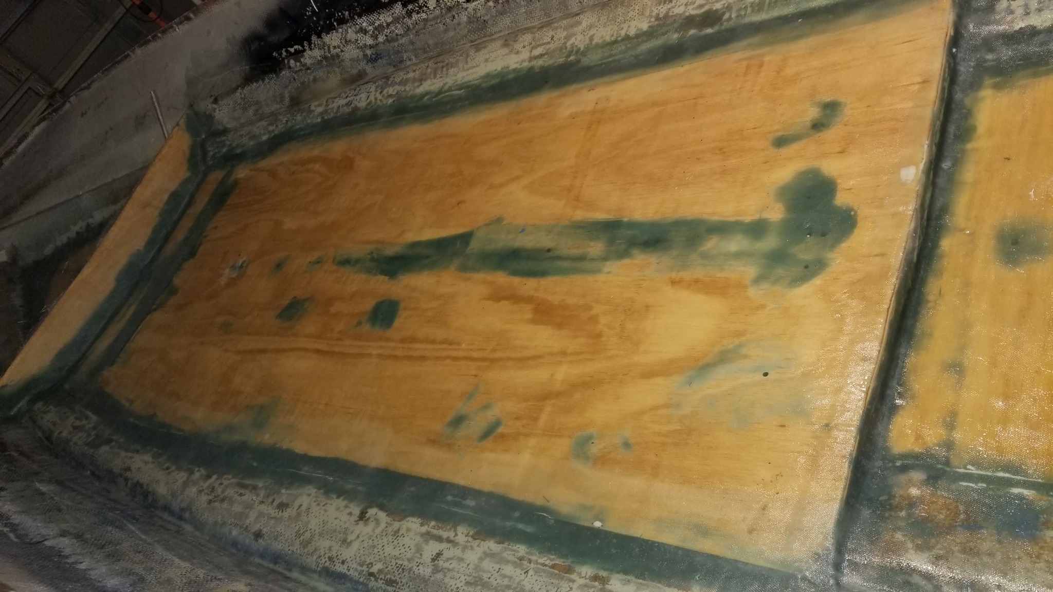

The wood is installed for the floor. We glued it in place with 5200 then mixed up some thickened resin and filled in and leveled any gaps around the edges of the floor. We ordered and received some more resin and fiberglass to glass in the floor. If all goes as planned we will glass the floor in tomorrow. Pictures to follow on this progress.
We plan on priming and painting the interior of the hull then call one of the kids to come help flip the hull over to work on any fairing needed on the bottom side of the hull then we can prime and paint the hull. Guess we need to get the paint ordered soon for the hull and the cap. Getting close, cant wait till spring!

Got it primed this morning, going to let her set up in the garage a couple days then a light sanding and paint the interior. This old boat has gone a long way in the last year. Looking back, on one hand, I wish I had more time that I could have set aside this last summer, could have been done, but on the other hand, this gives me something to do this winter as I dont like the cold, not going to do any fishing until its back up into the 60s at least.

Good morning everyone. We got the project flipped over in the garage. This was a fun task. Used a tiedown strap and a come along attached to the bow and transom and the ceiling. Lifted it up and flipped it over on to a 8 foot table that I set the legs on some old carts so I can still roll it around the garage as needed. Yesterday I re-sanded and cleaned off some repaired areas on the starboard side of the hull and and transom, using total boat total fair, faired out the transom and star board side. I have come back and finish sanded the fairing smooth this morning. Today I am repeating the process on the port side. Paint is on order and should receive this week. cant wait to try our hand on rolling and tipping. I figure the bottom side of the hull is a great practice point to see what kind of finish we will get, then I can determine if I am going to roll and tip the topside or get the sprayer out.

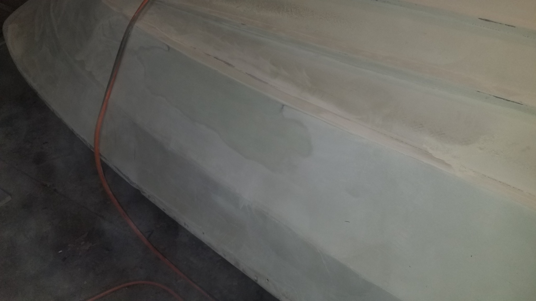

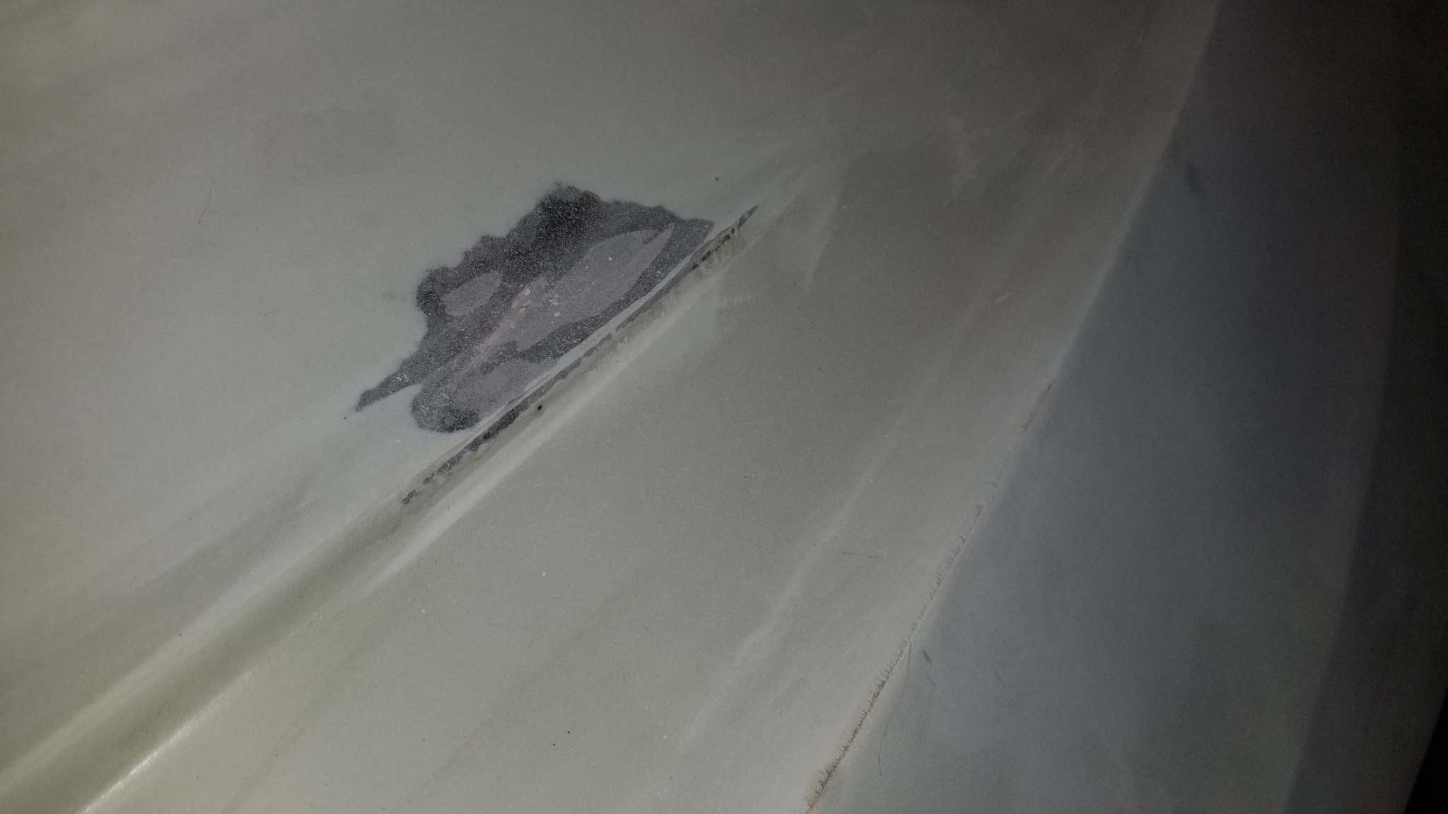

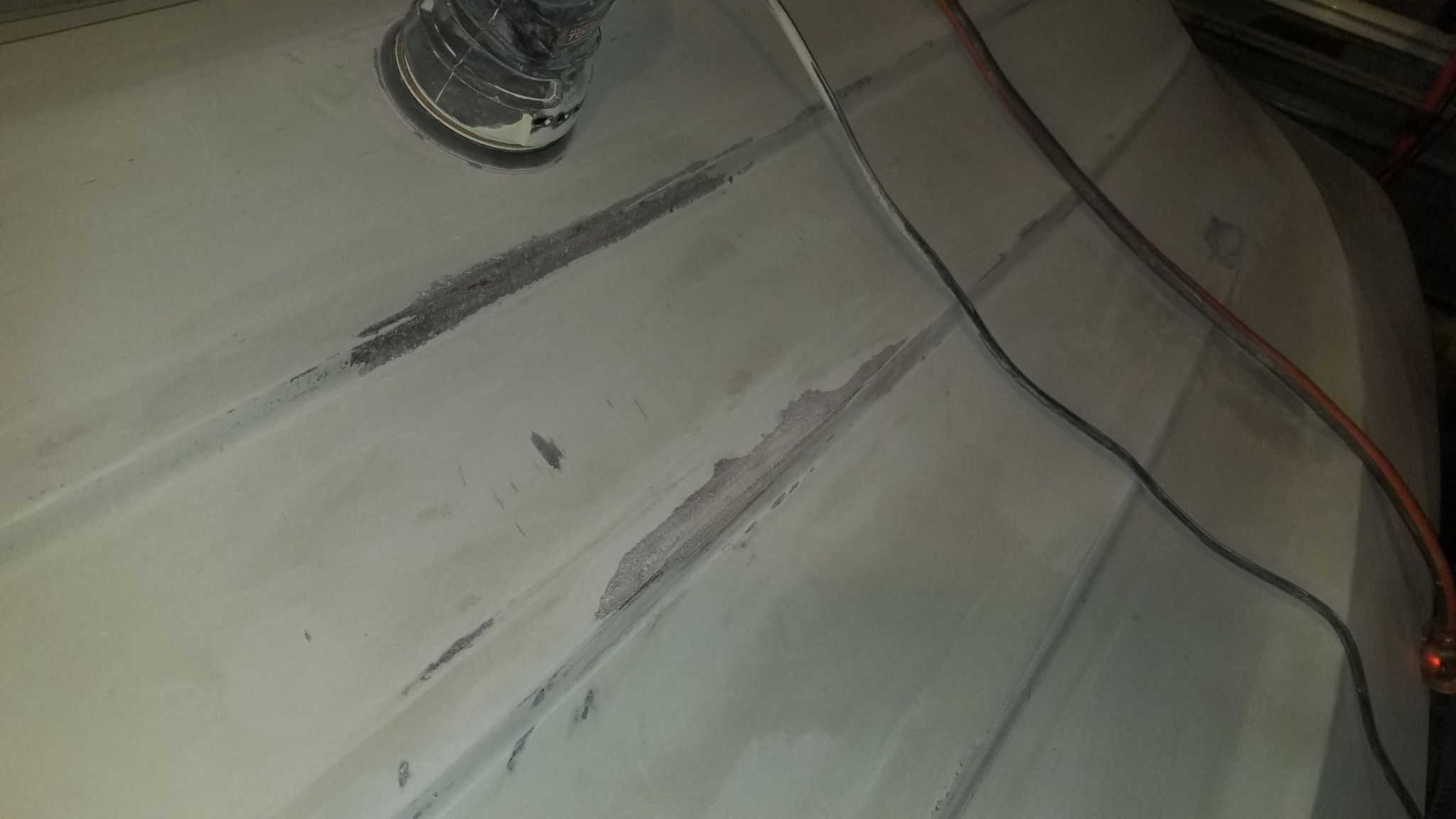

Just finished up applying fairing to the port side. Just have to wait for this to set up and sand down. Then we can scuff up and wipe down the whole thing and prime it. Fingers crossed that we dont find too much more that needs to be faired out after the prime. More to come this next week or weekend.
