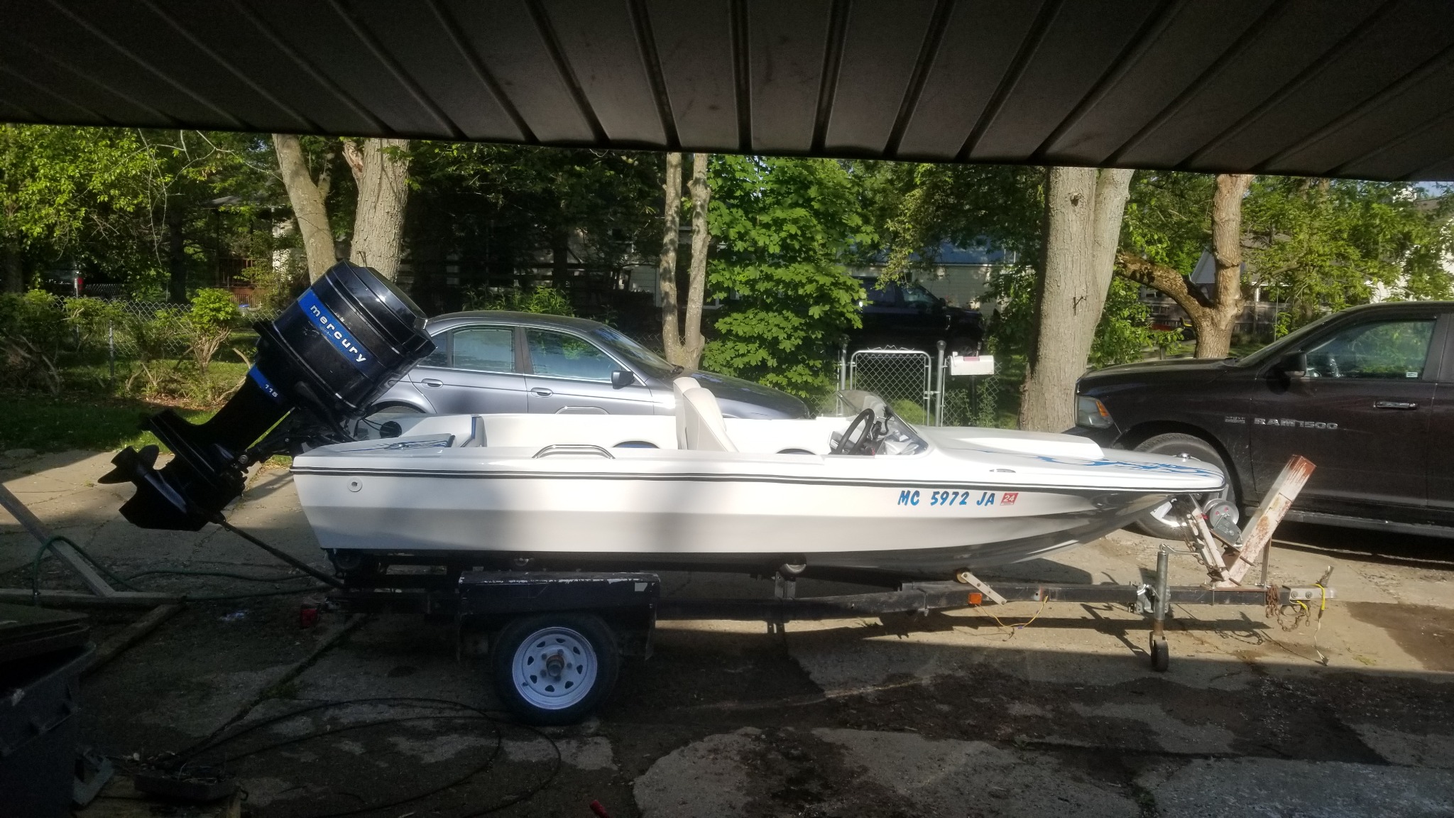

Updated, well back dated the motor. Picked up a 1979 1/2 Merc 115. This is a hoot to run now!

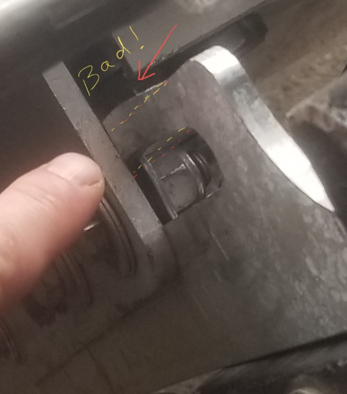

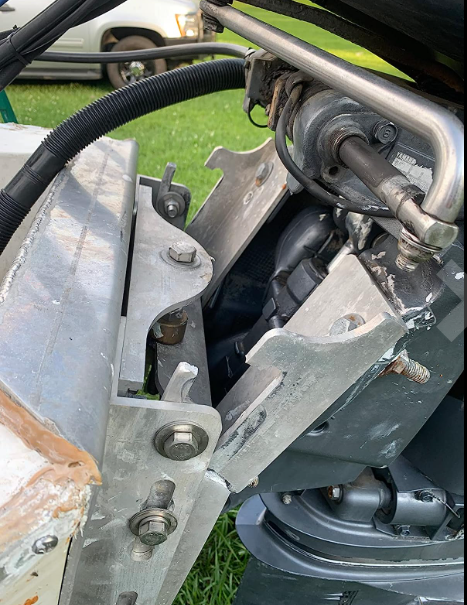

Well got home today and decided to move the jack plate up all the way gettin her ready for some testing tomorrow after work. Moving the jack plate up I saw something funny. Well not funny, but not right. Decided to look up reviews on the jack plate I bought off Amazon, and reconfirmed this jack plate was rated for 225hp max. I should have had no issue with my 115 right? WRONG! There must be some translation error from the china made jack plate. Maybe it was a typo and it was suppose to be a 25hp not 225. LOL. Well contacted Amazon ready for a fight because it was past the 30day return date. But to my surprise, they helped me out and got my refund going. I went back and looked at the reviews again because I seem to remember seeing mostly positive reviews, then I found the one hidden all the way at the bottom. This guy almost lost his outboard because his broke the same way mine is about to. This is what mine looks like. The bad reviewer is next photo down.
Now I have a few options, but I dont want to mount the outboard directly to the transom as it is the older bolt pattern and I would have holes to plug up.
Either im looking for another 4 inch set back jack plate that will work for me without breaking the bank.
I could just put the 10" back on it.
I could grab the jack plate off the bass boat. Not sure if that one is 4 or 6 inch set back but a much thicker aluminum and on the down side, not easily adjustable on the water.
Or finally I could use the brackets to build a transom riser like BOB'S sells. Only down side to this is the adjustability is not there at all.
Well tomorrow going to pull the jack plate off so I can get it returned, and hang the motor on the transom just temporarily till I figure out what path I am going to take. If anyone is local to Flint MI and has a 4 inch manual jack plate they want to sell or trade up for a 10 inch, Hit me up!

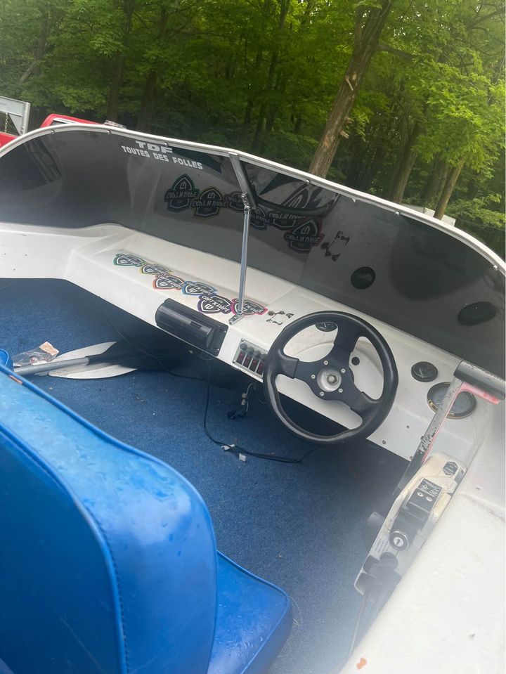

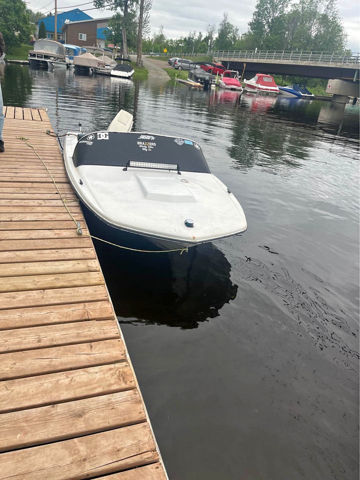

Good morning all. Still waiting for warmer weather to get the boats back in the water and have some fun. A small update on the make model year of this little fun project boat. A member from another forum sent me this link to a Canada facebook market place ad. This is defiantly the same exact model as mine but after a short conversation with the owner, he could only tell me it is a 1971. It was a bit difficult as he only spoke French and I had to play with google translate to converse with him. At least I know there is at least one more of these boats out there surviving. This find also increases my belief that this is a Canadian made boat.
https://www.facebook.com/marketplace/item/689099079746734?ref=search&referral_code=null&referral_story_type=post&tracking=browse_serp%3Aee4f0ede-7a24-4f82-a75c-5b8928a49bb1
restoration project make/mode/year unknown 2 years 8 months ago #148685
Always fun to find siblings for our old boats.
The light bar placed on the boat for sale must be blinding to other approaching boats!!
I wonder if that's the original interior?
