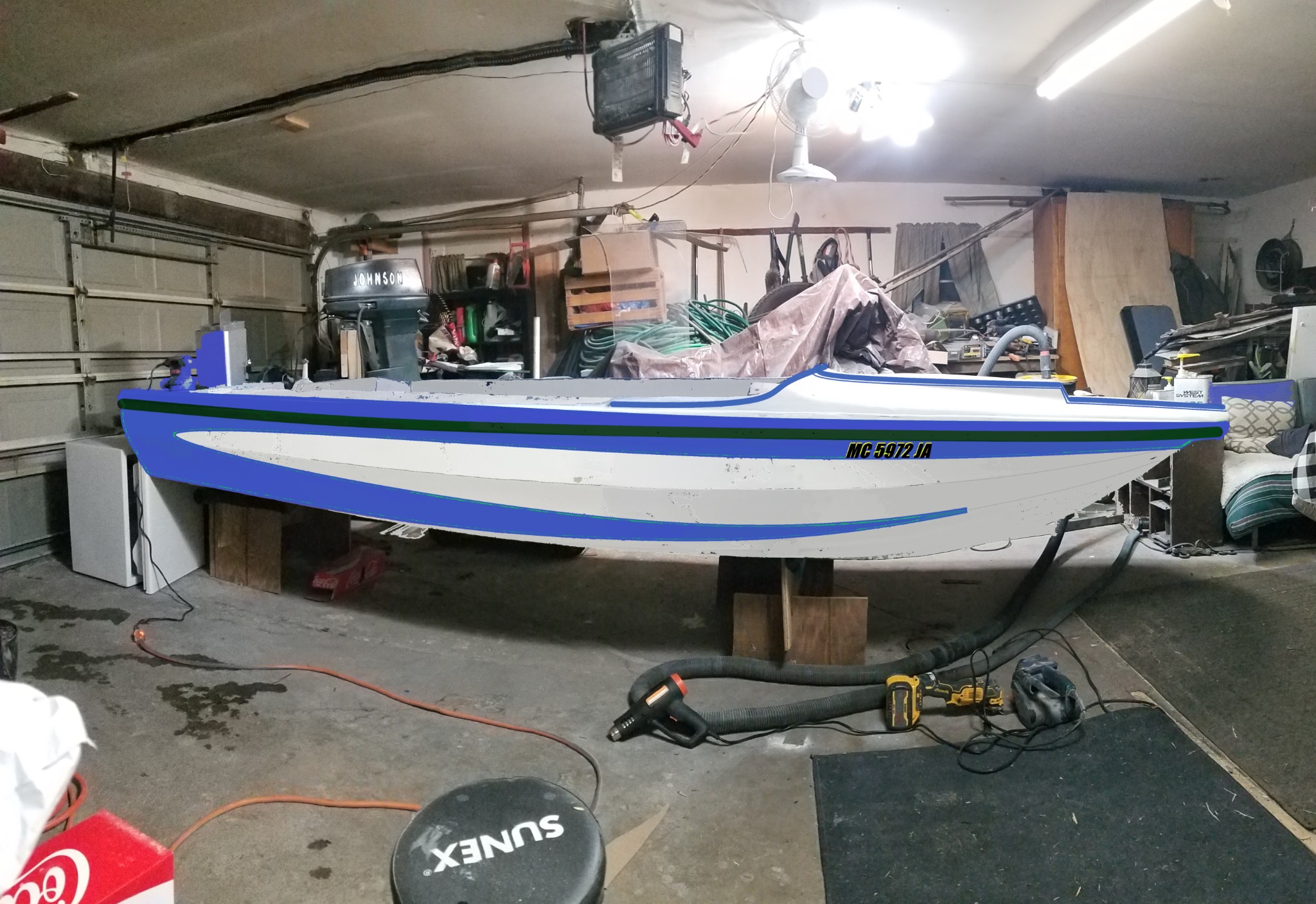

I went back and forth a while on color selection but I finally settled on the whole boat will be white base with some variation of a bright green accents (LIME GREEN), maybe just a racing stripe down the middle. I think it looks good on a car.
I have to ask, Why does the deck "have" to be white? I'm getting the feeling it is more than just an opinion. I know it is my boat and I can do what I want with any color combination I like. In the end it has to be something that some one else will like because I probably wont keep the boat forever and will want to be able to sell it eventually. May have a hard time if it was a dab green with multicolored polka dots. This boats factory colors was very simple, a white hull while the cap was a medium to dark blue. it don't appear there was any graphic or design to it, just split at the rub rail.

White is the most refletive color, coolest to the touchand so the least likely color to fade. Painting the topsides a different color, especially a dark color, makes the boat look top heavy. I am of the opinion that green, dark green, only goes well with antique mahogany boats. Screaming green looks OK on a race car or race boat, I suppose, but pretty stupid on an average car or boat. You should also consider resale value. It could take awhile to find a buyer with bad taste.

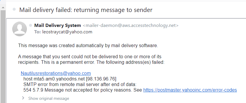

Nautilus wrote: Lenny: The email you have listed with Fiberglassics is a dud. Write to me: This email address is being protected from spambots. You need JavaScript enabled to view it.
I have changed my email to my main email This email address is being protected from spambots. You need JavaScript enabled to view it.
I try to send you a email through this forum and I got this message.

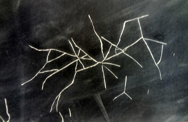

It has been a while since I have updated so I thought I would jump in and let yall know whats up. Still been working on sanding the old paint on the cap. This has been a real PITA due to the fact I feel I have to strip it down to the original gelcoat. There are places that the previous paint jobs have pealed up so I really would worry that if I just scuffed up what is there I would have more issues down the road. This is a slow process as there is a really thick layer of dark blue paint, then white, then a primer to get through before I hit the original gelcoat. Also work has been keeping me pretty busy. Covid really hitting our employees hard and have some major absenteeism. I have only worked on small sections at a time when I get home if I am feeling it. I would say I am about 3/4 done sanding/stripping the old paint off the top portion of the boat. (this is by far the worst part of this project so far for me, I hate sanding.) I have found a few more spider cracks that I will have to tend to along with filling old mounting holes that will not be reused. After I get any fiberglass repairs needed done it is time to get some fairing compound and see how it goes from there. I can't wait until I get to move on to more fun parts of this project.
restoration project make/mode/year unknown 4 years 10 months ago #146025
  • Nautilus
  • Nautilus's Avatar
  • Posts: 1580
  • Karma: 87
  • Thank you received: 58
The spider cracks need to be ground out with a dremel tool as seen in this photo.

After removing the previous finish on the boat I am seeing many spider cracks along with hundred if not thousands of tiny cracks in the boat. I understand how to take care of the long spider cracks but what to do with all these tiny issues? Will the primer fill these and dont worry about them or do I need to treat these just like the spider cracks and grind every one down? Or just cut my losses and just paint it as is. It will look much better than it did. (from a distance LOL)
restoration project make/mode/year unknown 4 years 9 months ago #146099
  • Nautilus
  • Nautilus's Avatar
  • Posts: 1580
  • Karma: 87
Since your boat will be a "beater," not a show boat, just knock all those little spider cracks down with 120 grit on a palm sander, fill with primer and sand fair. (You might have to do it twice.)

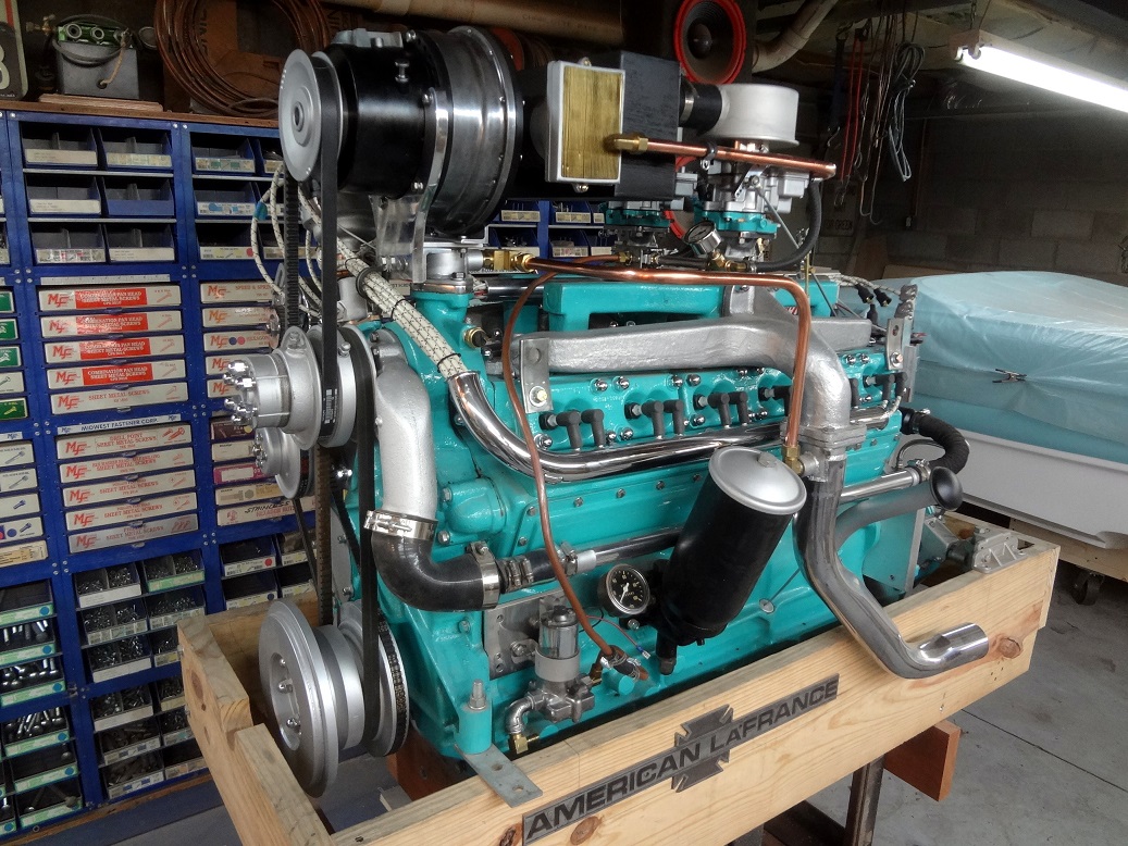

restoration project make/mode/year unknown 4 years 9 months ago #146106
That engine is spectacular!
What do you estimate the engine/drivestrain weighs for your project?
What RPM will it turn?

Larsspar: I figure the engine/trans weighs about 1,100 lbs. A Chris Craft M engine (what the boat had originally) weighs 940 lbs. I bought a scale to weigh it but haven't gotten around to doing it. The engine turns 3,600 RPMs and should have about 240 HP but the torque is way up there. I'll need to experiment with propellers.

I had the V12 running last week. She sounded really good and I got her to idle way down around 450-500 RPMs...sweet. I'm going to start on the hull as soon as the weather breaks. First thing to do is fit the engine and that won't be quick, easy or fun. You should drive up and give an old man a hand. I have beer.

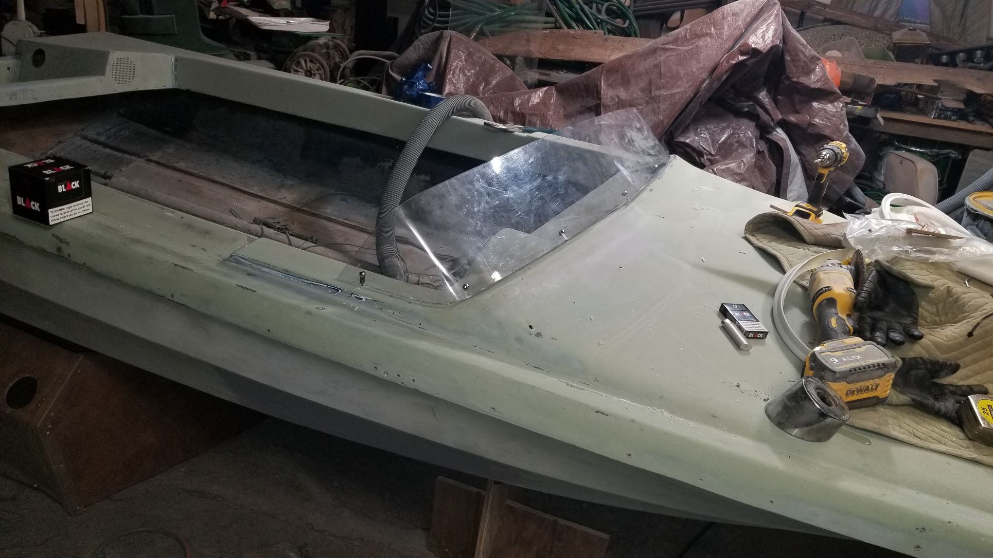

Good morning everyone, again work has been keeping me from working on this little boat much but I did finally finish the removal of all the old paint. I also have gotten distracted by trying to construct a short windshield from a piece of 3/16 polycarbonate I had laying around. I love the idea but am having a hard time forming it to the shape I need and about to just give up on the idea as I cant get it perfect. This is another reason I would love to know what year make and model this is to possibly find a windshield to fit it properly.
Next step I am going to take is to flip the cap over to do some repairs on the supports under the bow as the original fiberglass has separated in a few spots. I am waiting for my wife to feel a bit better to give me a hand flipping this over so I can get this step done. Then flip it back over and attack filling all the old mounting holes and grinding the spider cracks on the topside, fair, prime and paint my base color.
I think I will next set the cap aside and try to decide how to attack the hull. I am not sure if I should flip that back over, fair, prime, and paint that first or attack the reinstall of the stringer, transom, and floor first. I am leaning toward getting finish done first as the hull will be much lighter to be flipping over to make fairing and painting much easier.
I will add more photos soon. We only have a few more months of cold weather, I have to get busy. I cant wait until I am cleaning up the motor and getting her ready to put her in the water.

A member over on a Glastron forum suggested making a "Splash Special" emblem for the dash. This might be something to have 3D printed.
I did get sidetracked a little on the project and decided to work on getting the mini wind screen fitted before I flipped the cap over to work on the underside issues. I have purchased some Twin-Flap Vinyl Deck Channel and have it mounted. Now I can flip her over and get to work on the underside of the cap.
And Jan should be happier with my final color choices. She is going to be white and Blue. Something like this. Not set on exact paint lines, this is me just playing with ideas when I am too whooped to actually do any work on the boat.

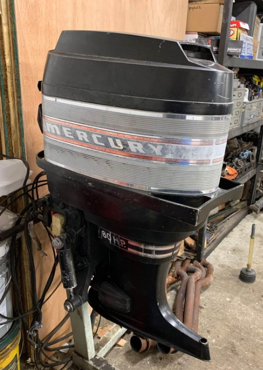

I have also picked up an old basket case of a 1971 merc 800 that is in need of some TLC. seems to have great compression but needs a lot of rewiring. There is a lot of brittle wires on this powerhead that is in desperate need of replacement. Had I noticed this issue when looking at it in the sellers garage corner I may not have bought it or talked him down a bit more. I got it now so I am the one to bring it back to life now. That project will most likely be down the road after we get her in the water with the Johnson.

I think winter drains the energy out of all of us in the north. I live across the lake from you and could really use a warm sunny day.
I think the old Merc would be great for your boat. I bet there are a couple members on this site that could help you with a remanufactured wire harness if interested.
Would love to see a picture of what you have.

Its odd because it looks like it is a short shaft with a long shaft extension. Has a small extension for the lower, and extensions for the Exhaust, water tube, shift shaft and the drive shaft. or is that a normal thing for these old mercs? I have all the parts for it, just have to put it back together. seller bought the motor in hopes to use the lower unit but it was not a match for what he had and never put it back together. He said the motor ran when he bought it. I didnt ask how long ago that was but it looks like it has been sitting a while. He was unsure of the year but looking at the numbers it is a 1971

I have the same year 6 cylinder with that same extension that can make it a long shaft. Mine had it all put together as a long shaft… I took mine apart and made it a short shaft with the help of the Merc experts on here. If I find the thread, I will post it for you as it was tricky for me to remove the short main shaft extension stuck up inside the motor. The experts gave me many ways to remove it. If you keep it long shaft, you won’t need to worry about that. I have the same wiring insulation issues as you mentioned and the Merc guys warned me about. I bought some marine wire, but haven’t gotten back to that project yet. I was thinking about replacing one wire at a time unless someone makes a new internal harness that would save me a ton of time. I will watch your thread to see if you you find a source or get expert advice to take care of the crumbling insulation/ re-wiring problem.

fiberglassics.com/forum/mercury-outpost/132218-115-lower-unit-changes-started.html Here is the link to the lower unit extension removal if you need it. Hopefully the link works when I submit this.

That looked like it was a PITA project. I think I will leave it a long shaft (I have a 20 inch transom) but the shaft extension is already out so if I did that I wouldn't have the issues you had. All that work, I am surprised you didn't just pull the power head. In hindsight wouldn't that have been much easier?
restoration project make/mode/year unknown 4 years 8 months ago #146262
I had a 1970 50hp Merc with that extension and it worked fine for years.
