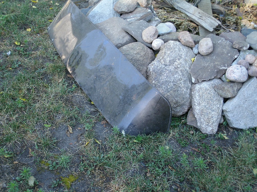

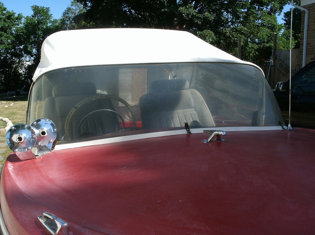

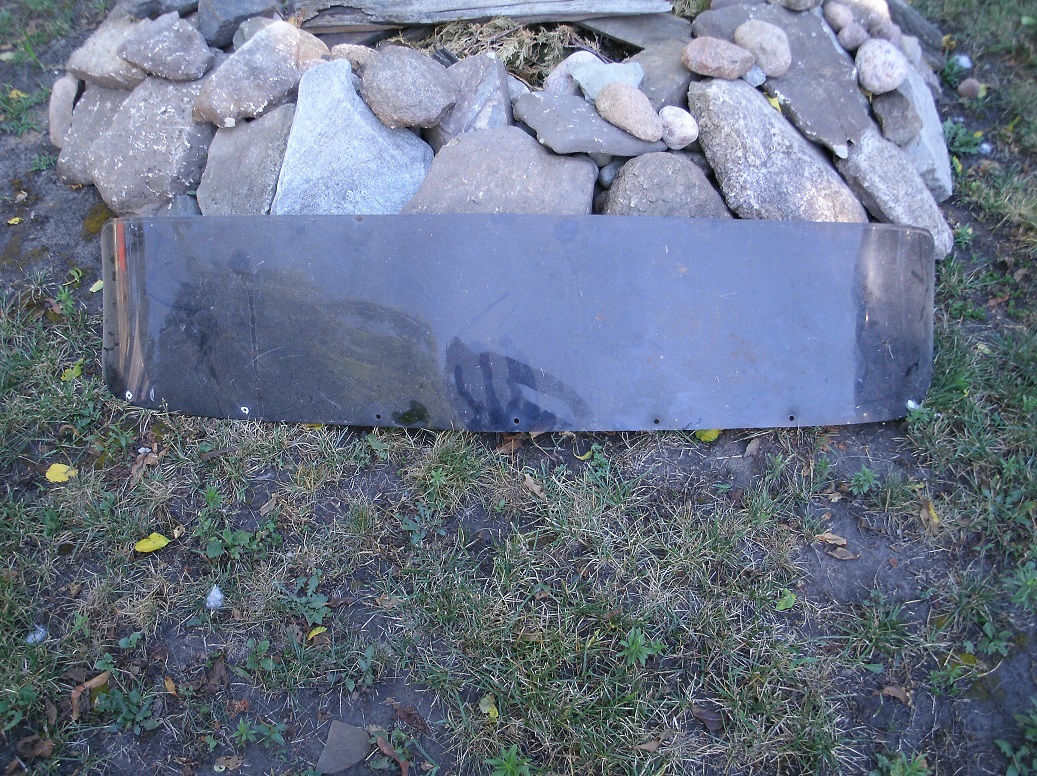

I'm looking forward to learning more. The top 2 pictures are of the windshield that came with my 1960 G-3. I know it's not even close to original and there's no mounting hardware so starting from scratch is probably the way to go. I'd like to ask is there anything that will buff the windshield on the 1960 Humber without doing more harm than good ? Thanks in advance. Mark.
Damn the torpedoes, full steam ahead !

ON those top two pics you are 100% correct that the 1960 G3 did NOT come with those. They are definitely remakes and not accurate to the original make.
On your Humber, if it has an acrylic windshield you can try using a 3 series product called Novus. Novus 3 is a heavy buffing compound that you use to get rid of the oxidation (I use it on an orbital buffer at 1000 rpm or less until is dries and then move to another area and apply more). Buff or wipe off the Novus 3 with a microfiber cloth and repeat the process with Novus 2 (a finer scratch remover). After using both of those products you can use Novus 1 or Brillianize to do a final cleaning. Both Novus and Brillianize should be available online or at your local plastics store. I get mine through a company in Placerville, CA that caters to fabricators. Not sure if I can mention their name in the forum, so I won't.
If these products don't work, I have another trick up my sleeve but the compound is about $30 and the technique is a bit more complicated.

Beautiful ! Thanks for the tip. I knew from looking at Member's boats that my piece of Lexan was a million leagues from factory. I might yet use it if I can trim it up with a little more shape to it. The jigsaw tip will be applied to that one and I'll have to try and find those products for the Humber. Much appreciation !

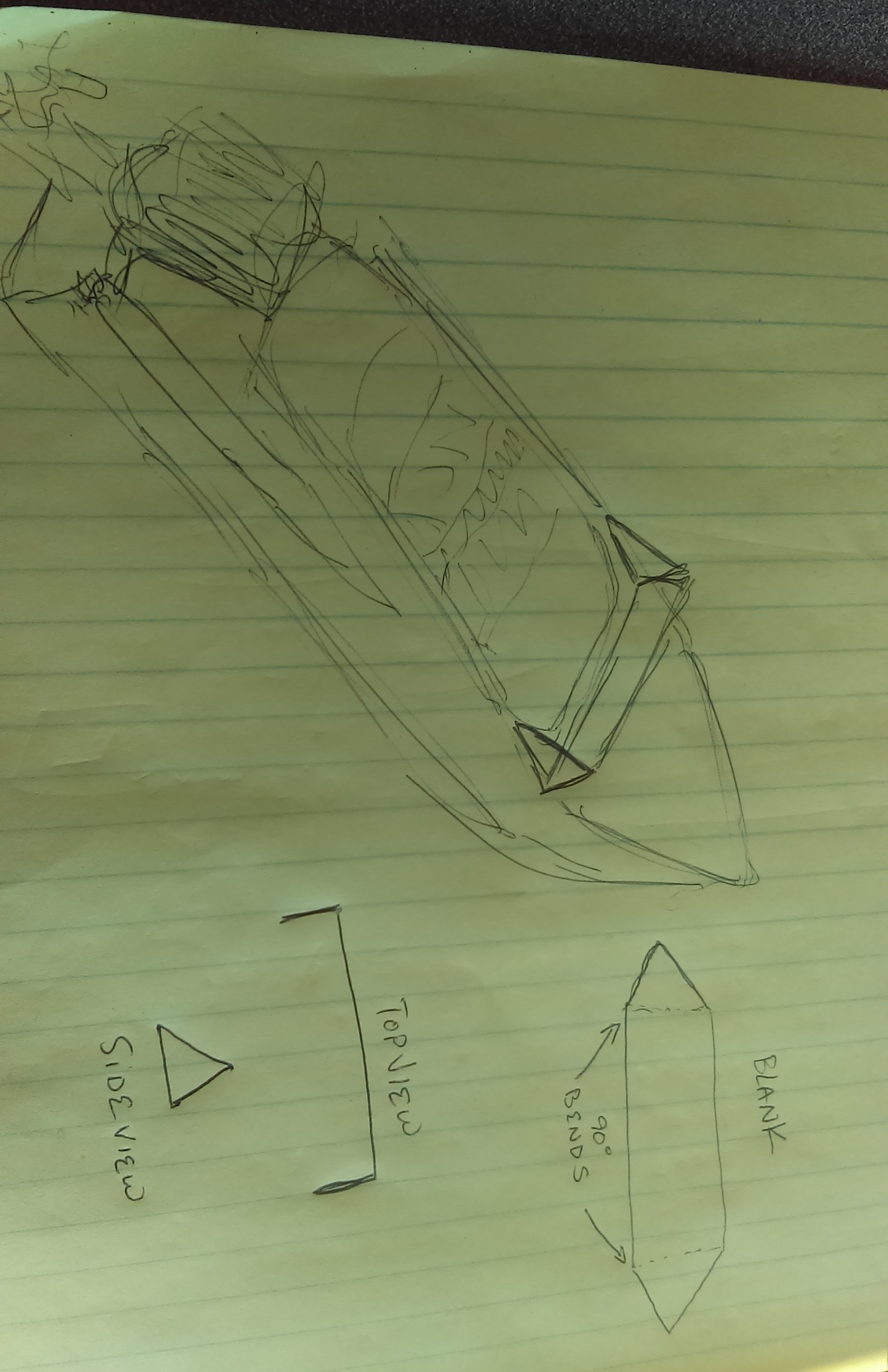

I'm trying to think of a way to make two for my 1960 G-3, one for the driver and one for the passenger. Low profile with a racy look of course :) I can't afford to restore it to original so that gives me license to tweek it a little. Mounting hardware can be a nightmare though. That's next years boat so I'm just dreaming.

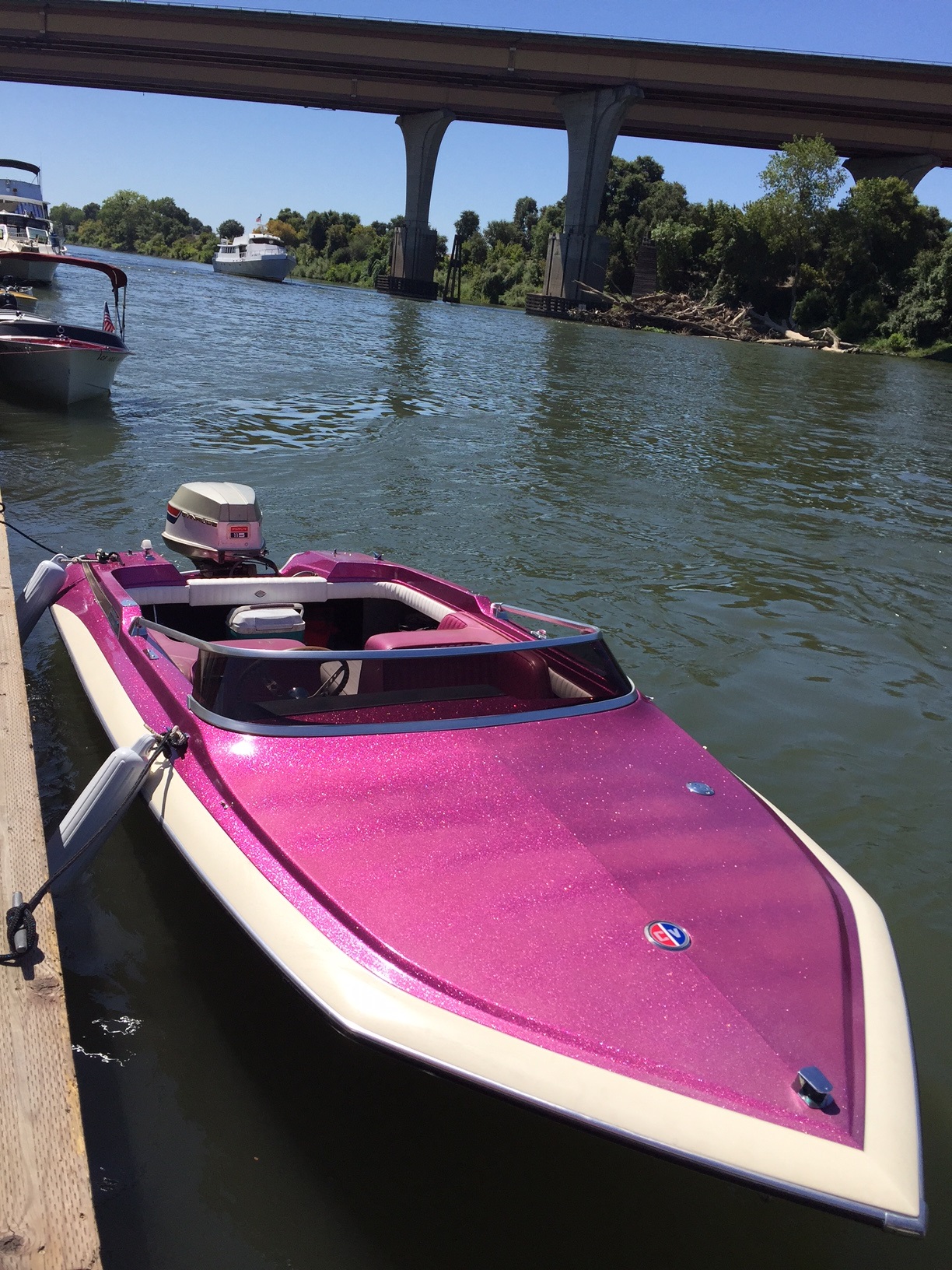

Brent made this windshield for my friend Kent on his '74 Glastron CV16

That's sure pretty ! I used to have a metalflake blue Glastron-Carlson CVX18 and always loved that bow point. For those of us at a distance I'm glad Bret is willing to take the time to tutor as well as create some nice windshields for those who are close enough ! If he does mail order I may just get on board and let a master do it right.

I think the easiest and cheapest way to remake a windshield for the 1960 G3 would be to use a strip heater and do 90 degree bends on triangular shaped corners (See attached sketch). It is by no means true to the original, but can easily be done by anyone with fairly minimal experience.
I am in the process of writing a post on plastic heating and forming equipment that will give you some technique you can use to make this on your own.
Once formed you can use basic mounting hardware and a bottom vinyl trim that are available on www.go2marine.com . Check out my post early next week that will walk you through heat strip forming.

Kent takes really great care of his Glastron. It was an honor working on it for him. Thank you Eduardo for posting that great pic.

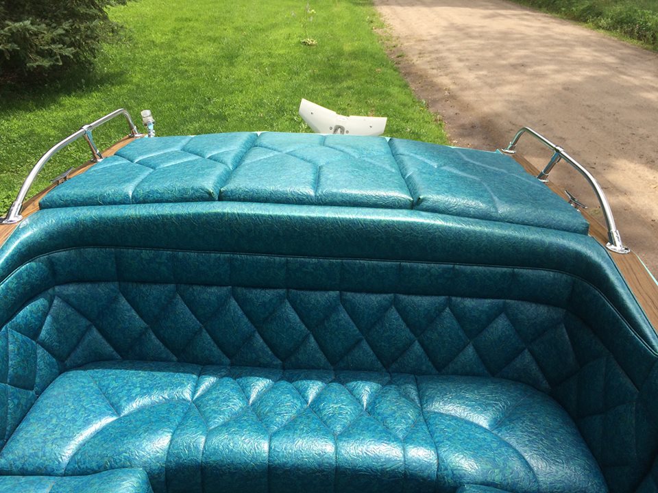

Hi! I was directed to you on my thread of how to restore a hazy tinted windshield on my 1971 Centurian. I really think I would prefer to try and clear it up before replacing it.
Thanks for any helpful hints!
Re:Acrylic vs. Polycarb windshield replacements 10 years 2 months ago #124915
That's a beautiful interior by the way :)

Re:Acrylic vs. Polycarb windshield replacements 10 years 2 months ago #124917
Thank you very much! We love it! One of a kind!

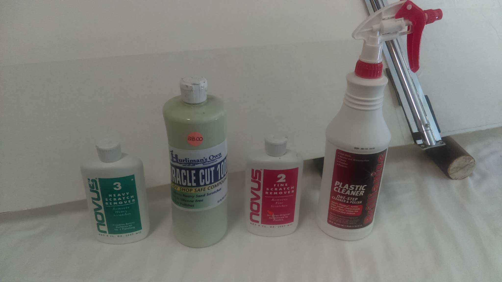

WOW!!!!! That is a beautiful boat. I replaced a windshield on an 80's model Centurian a few weeks back and it had almost the exact same metal framework as yours. I love how they built those because they are incredibly sturdy and easy to disassemble if you need to.
In regards to the haziness. The first step is to determine what has caused the haziness. Surface haze is usually caused by weathering and oxidation, or scratches from improper cleaning. This is the EASY kind of haziness to get rid of.
WARNING!!! DO NOT USE ANY OF THESE PRODUCTS ON POLYCARBONATE WINDSHIELDS OR PLASTIC THAT HAS AN ABRASION RESISTANT COATING. THEY WILL STRIP THE COATING OFF AND DAMAGE POLYCARBONATE.
Using an orbital buffer (or microfiber cloth if you don't have a buffer) apply Novus 3 onto the windshield. Buff it on no faster than 1000 rpm in a smooth fashion almost like you are waxing a car. Work in small areas at first to see how well it is working and then move on. After the Novus 3 dries you can wipe or buff it off with a clean microfiber cloth. Repeat this same process using Novus 2 (a finer grit). Once the Novus dries, wipe it off with a microfiber cloth and inspect for any trouble spots that need closer attention. Hit those spots again with just the Novus 2 applying pressure as needed.
Once you are confident that the haze and scratches are minimal, I suggest cleaning the entire windshield with Brillianize. It's a great daily use Acrylic cleaner that won't harm the plastic and keeps it looking shiny.
If the scratches are too deep for this process to get out, there is a product called Miracle Cut 1000 sold by Hurliman's Own in Penryn, Ca that can take out scratches up to 1200 grit sand paper. So I will literally wet sand the scratches out using 1200 grit and then 2000 grit sand paper, then buff the area with my orbital buffer using Miracle Cut 1000. THIS PRODUCT ALSO WORKS GREAT ON GEL COAT RESTORATIONS.
So that is the easy happy kind of haziness...the not so happy easy kind of haziness is called CRAZING. Crazing is actually inside the plastic and not on the surface. It is caused by chemicals like ammonia (found in Windex) and can also be cause by alcohol on Flame polished edges. Decades of sun exposure can also cause crazing, but your boat looks like it has been kept inside or covered, so I doubt that is the case.
