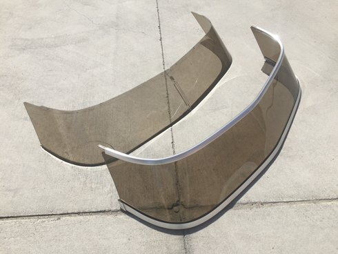

Attached photos are all acrylic windshield replacements, so show how they look when properly formed.

Hi Bret, welcome to FG. Super nice folks here; you will enjoy this site.
Kent shot me some pictures of his windshield after he had modified it a couple of weeks ago. Here is a picture when we were at Alamar Marina and restaurant this past Sunday. There were several of us that went out for brunch. More pics posted on the GSG on Facebook.
For the record, Bret, The Plastics Guy, has done several of our friends and Golden State Members' windshield, including this one. Quality work, a gentleman, and family man. For us local and nearby glassic members, we are lucky to have someone like Bret nearby for any windshield replacement work.
Brent made this windshield for my friend Kent on his '74 Glastron CV16

Kent takes really great care of his Glastron. It was an honor working on it for him. Thank you Eduardo for posting that great pic.

I have not had the privilege of making a '60 G3 windshield yet, but would be glad to. Compared to many of the windshields I have made it's actually rather straightforward.
Since there are so many folks on here trying to get replica's of that model windshield I'd probably ought to get to work on making a mold up for one of them, but need to find someone who has an original in decent enough shape that we can clone it.
Do you know of anyone in California, Oregon, Nevada or Arizona who might have one we could nab and use?
Brett

If I had a frame and a boat I could likely make the mold and pull a good part. I am sure we will come across one soon enough. I will keep my eyes peeled.
I am also looking for a 1957 Redfin Shark that has a usable windshield if anyone knows of someone who has one. It's for a restoration project in Albany Oregon.
