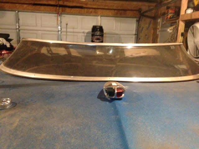

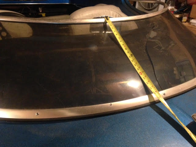

Is there an option to repair a cracked windshield using any of your methods. The "kids boat" is a 1974 Marlin that is in great shape with the exception of a big crack. We are trying to keep the costs down, and we are looking at a repair vs replacement right now, but I want something a little more aesthetic than the "duct tape solution" suggested by my daughter.
Here are a few pics:

Ironically, I was just asked to quote on this exact windshield last week...is this boat in the Sacramento area?
Remaking this style of windshield is never easy as a one off because it does require that some type of molding be made to assist in holding the reverse curve in place. The molding alone on something like this would run you at least a few hundred dollars.
You can do a short term fix by drilling a 3/16" diameter hole at the very end of the crack to stop it from spreading (NOTE: USE ONLY DRILL BITS DESIGNED FOR PLASTICS AND PRESS A PIECE OF WOOD BEHIND THE DRILL LOCATION TO PREVENT FURTHER CRACKING.)
After you drill your hole to stop the crack from spreading you can use an acrylic solvent like Weldon #3 or Weldon #4 to bond the crack shut. This solvent is applied using a needle applicator and will run through the crack via capillary action (basically the solvent gets sucked into any voids). The solvent will melt the two touching surfaces down and as they dry, will re-bond them.
You need to make sure the crack is aligned snugly in as close to an original position as possible and be prepared to clamp the crack to keep it completely stationary for 24 hours to allow proper bonding time.
After 24 hours I will sometimes run a bead of E6000 cement on the inside and outside of the crack and let that sit for another 24 hours. E6000 is a thick self leveling cement that dries perfectly clear. It isn't a solvent so it won't rejoin the pieces but will help strengthen the solvent bond you made with Weldon #3 or #4 the previous day.
Be cautious using Weldon products because they can mar the surface of the acrylic if any over spill drips away from the crack. Be prepared with a paper towel to dab any over spill right away. If you clean it up fast it doesn't have time to melt the surface, but we are talking seconds, not minutes.
One tip for using the needle applicator with weldon #3 or #4. I always only fill the bottle up half way leaving plenty of space for air in the bottle. Before I tilt the bottle over to squeeze solvent into the joint I am gluing, I squeeze air out of the bottle, face it away from what I will be gluing, tip it over and release pressure on the bottle so air sucks back up the needle tip and prevents the solvent from coming out until I get the needle in place on the crack. Once in place you can start squeezing the bottle again to force out solvent.
If you don't use this method, solvent will spill right out of the needle tip when you flip the bottle over to start gluing and you will make a mess.
Hopefully that was helpful. If you want me to post a video showing how I do this in my shop let me know. I have a few windshields in house right now which need this done prior to making replacements and could shoot a quick video and post it on YouTube.

That was awesome!! You probably can't tell from the pics, but the first thing I did upon getting her home was to drill a hole at the end of the crack. I did not do everything you mentioned, but I did make sure to use a sharp bit.
Posting the repair to YouTube would be an amazing help. I am not going for perfect, but structurally sound and more aesthetically appealing would be great.
