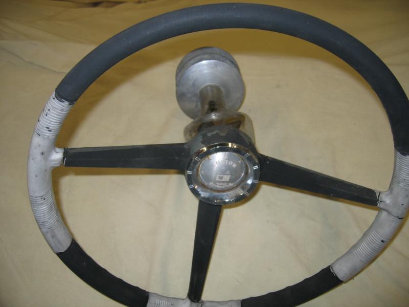

Here is a picture. Thank you for the comments. I have repair in mind.

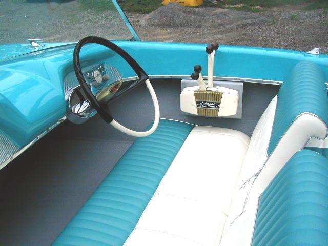

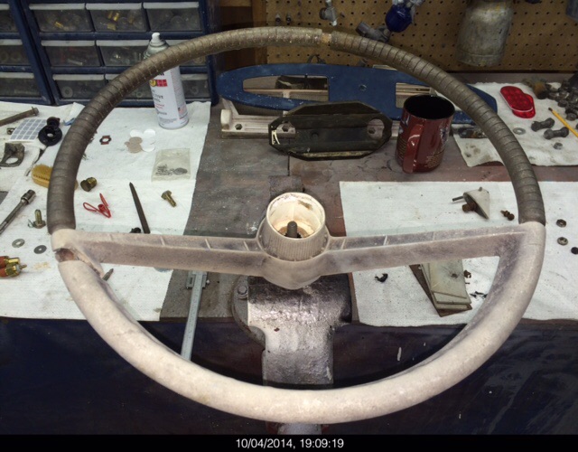

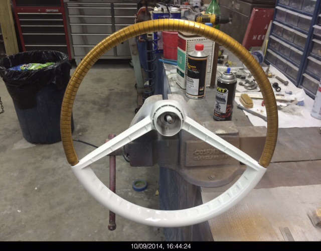

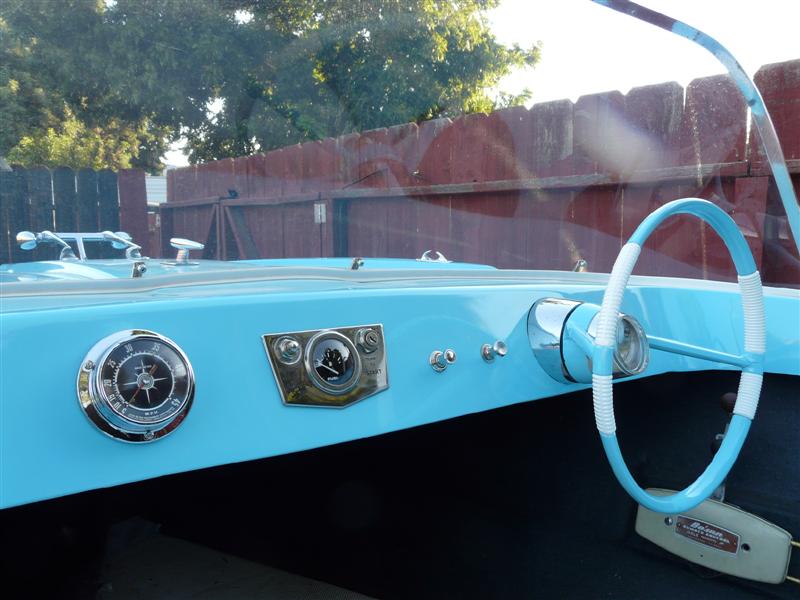

Here is steering wheel Resto I did for my 64 Deluxe...
Re:Steering wheel restoration 11 years 8 months ago #105699
Really nice job on that wheel Andrew - it looks sharp.

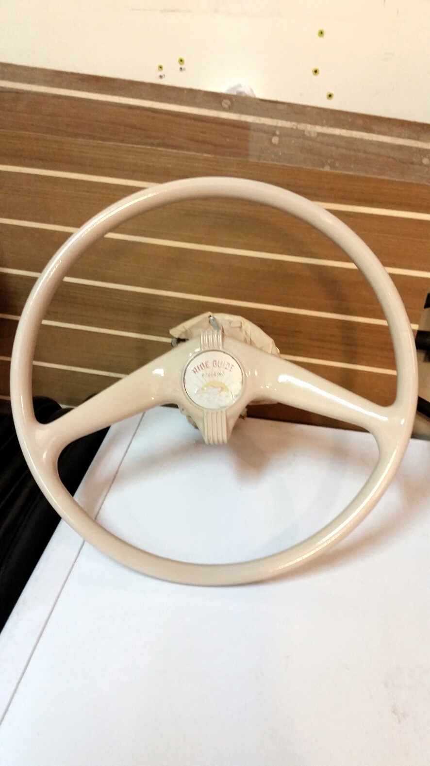

I had mine painted.

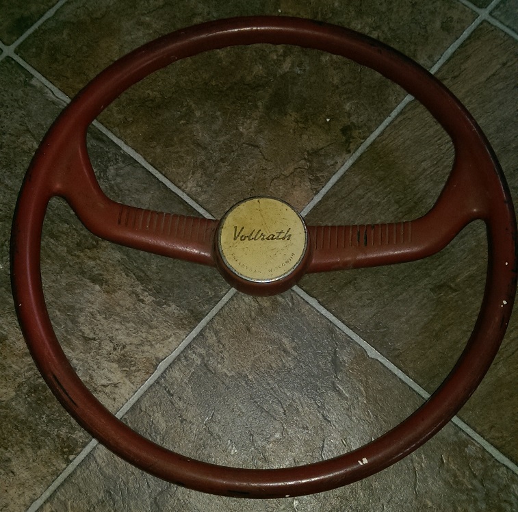

I have a cool Volrath I got for free but color is terrible but no damage so I bet it would look good painted, what type of paint do you use on that rubber?
Re:Steering wheel restoration 11 years 8 months ago #105731
I'm not an expert, but I recommend something that gets HARD. I used several coats of polyurethane clear coat to have a hard finish. Steering wheels get a lot wear.

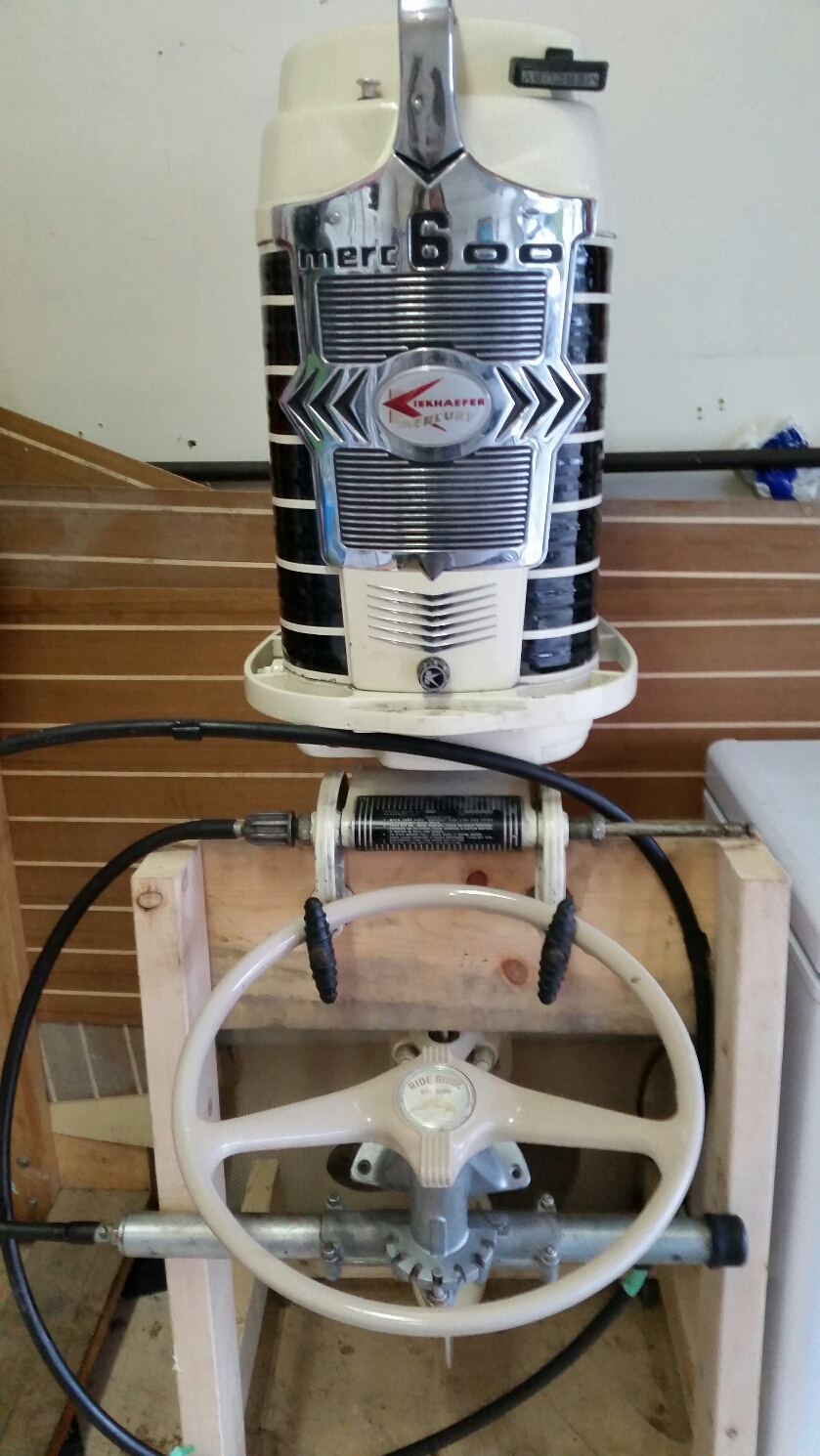

My wheel it's not the best but it's a merc wheel.

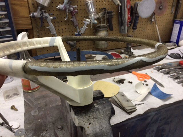

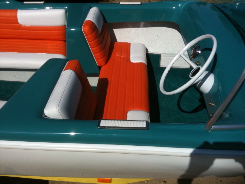

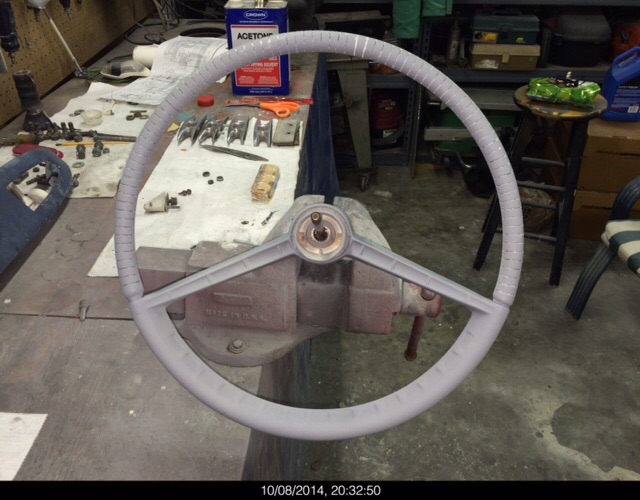

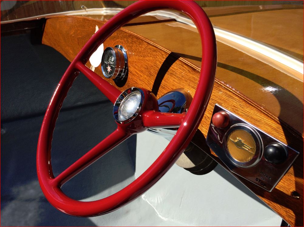

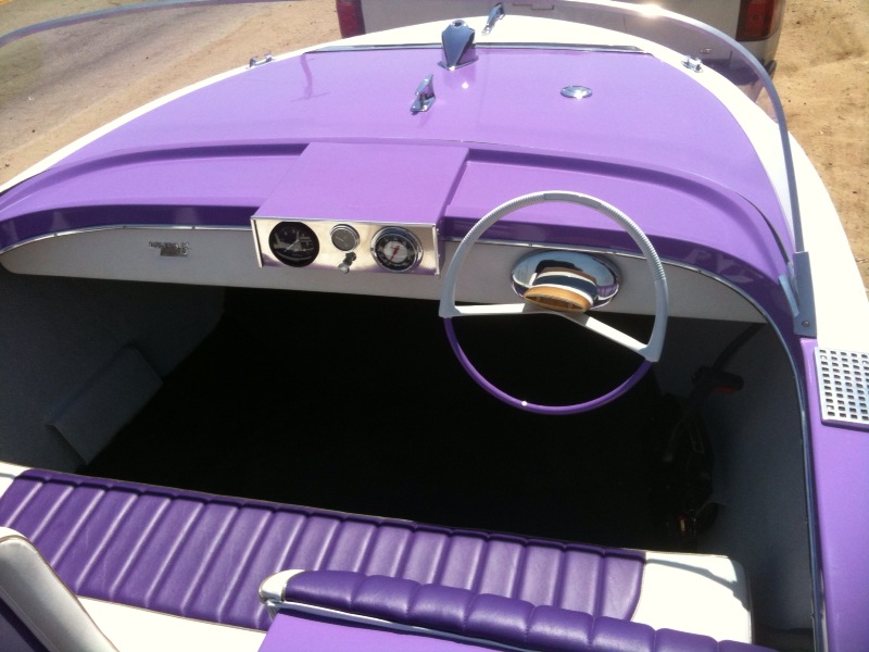

We grind out and open up all cracks and fill them with 2 part epoxy putty. They are then primed with epoxy primer and painted with single stage, two part, DuPont Imron polyurethane.
Here are a few that we have done.
Larry

That's one of the most classy wheels of the time period Bill, IMHO. If you can have someone shoot it with Imron as Larry suggests, you won't have to worry about it again. Although kinda "pricey", that stuff wears like iron! (Not to be attempted without the proper equipment, however.)
Re:Steering wheel restoration 11 years 8 months ago #105785
What the hell is Imron?I can apply it if I know what it is.anyway my merc set is also most complete just waiting for steering connection and my control and fuel tank.This whole set cost me almost $2000. I'm not a rich guy but who say this is a cheap hobby.ok I know now what Imron is but I think I just like it as it is it show the age of the wheel like my engine it's all original .

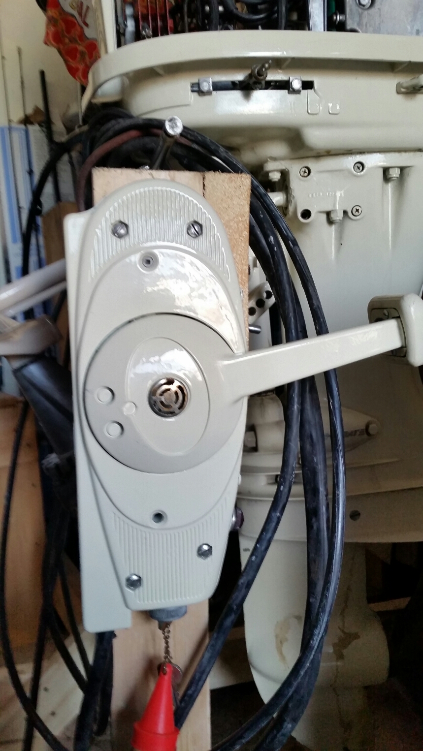

Are you sure it is suppose to be red? Cause that wheel is that color and it's look original.anyway i got my original merc control and my gas tank today hopefully my steering connection come next week so I can hook it up and start her.
