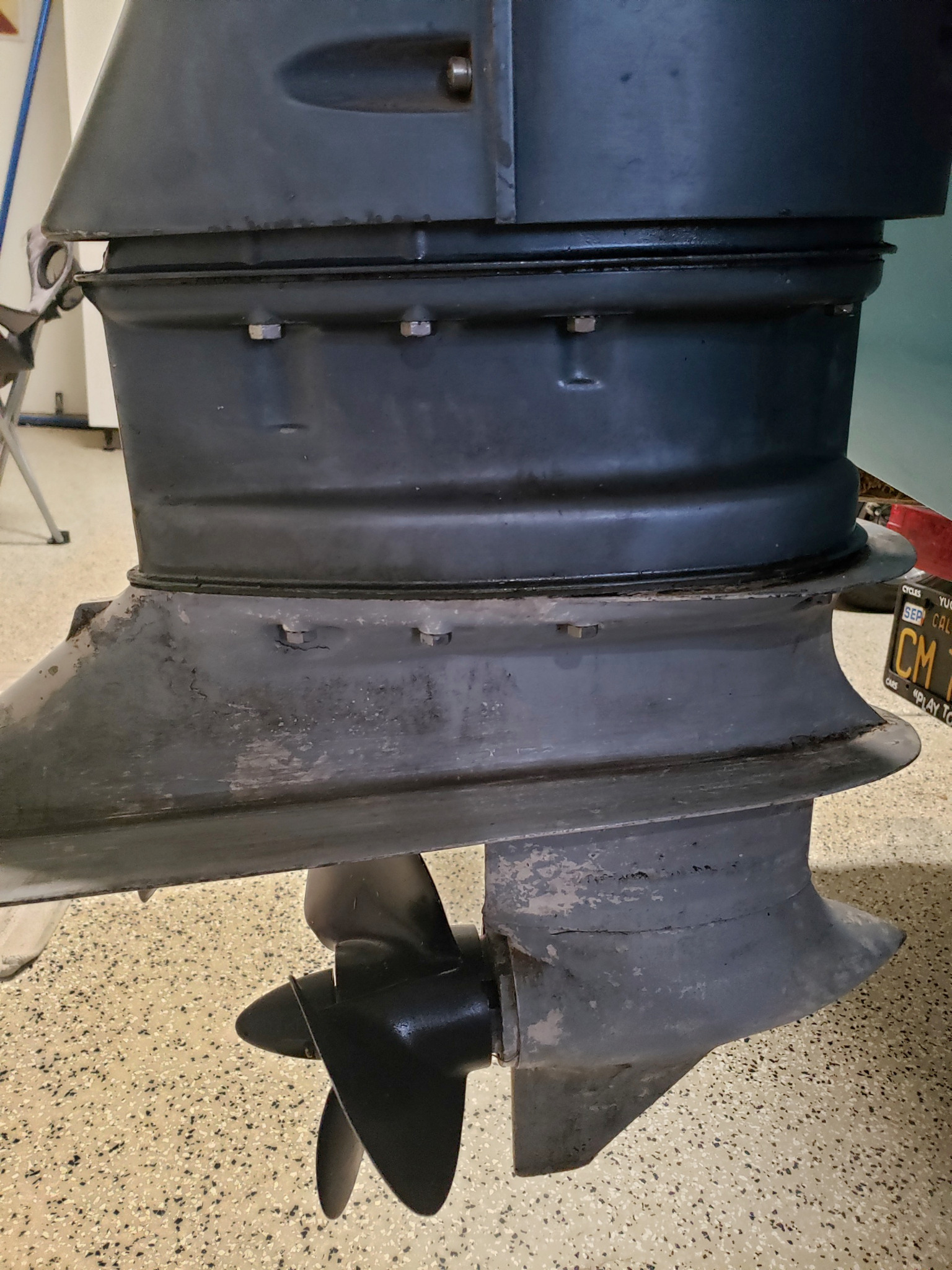

You have a long shaft engine, and it would appear it's sitting on a 15" (short shaft) transom. It's not gonna ventilate, but there will be a lot of drag and likely tons of spray.
A slipping propeller (or ventilation) causes an increase in rpm that's just about like a slipping clutch in a car. Rpm goes way up but no commensurate forward motion.
Slipping clutch dogs will feel like someone is hitting the transom with a big rubber mallet. And I'm not kidding on that, it's a quite startling thumping sound as the lower unit jumps in and out of gear. Once it's done that a few times, the clutch dog and likely forward gear are shot.
So there's 2 different issues to diagnose, plus the length on the transom.
If that motor came from the factory as a longshaft, it'd be a lot harder to convert. If it was done after-the-fact, it probably has extensions for the driveshaft, water tube, shift shaft, etc, and maybe can be re-converted into a short shaft.
Slipping gear or Prop 3 years 4 months ago #148163
First, thanks to all for the replies. This is getting my confidence up where I think I can actually do this.
About the long shaft, from the looks of the lower unit it is not factory, the paint is much more faded on one piece, So is there any advange / disadvantage to the longer lower unit? If I an taking it apart anyway I can certainly remove the extension piece.

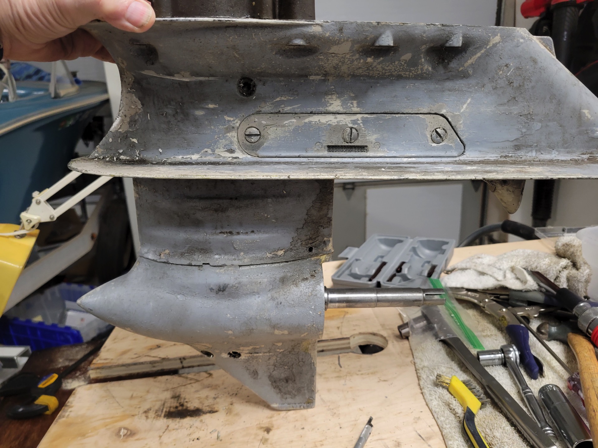

Slipping gear or Prop 3 years 3 months ago #148234

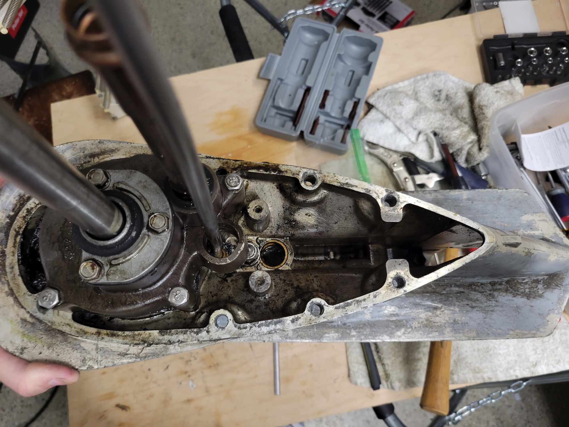

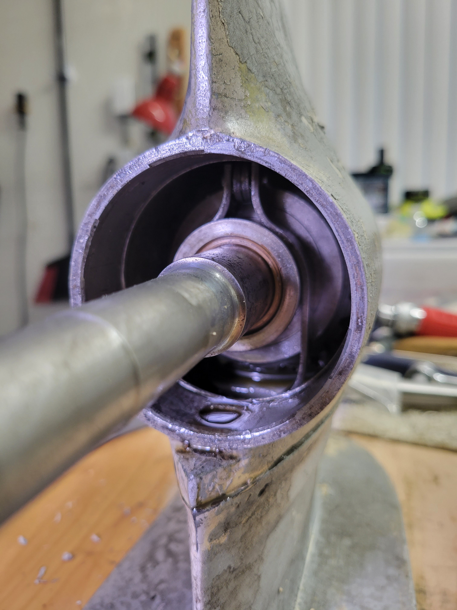

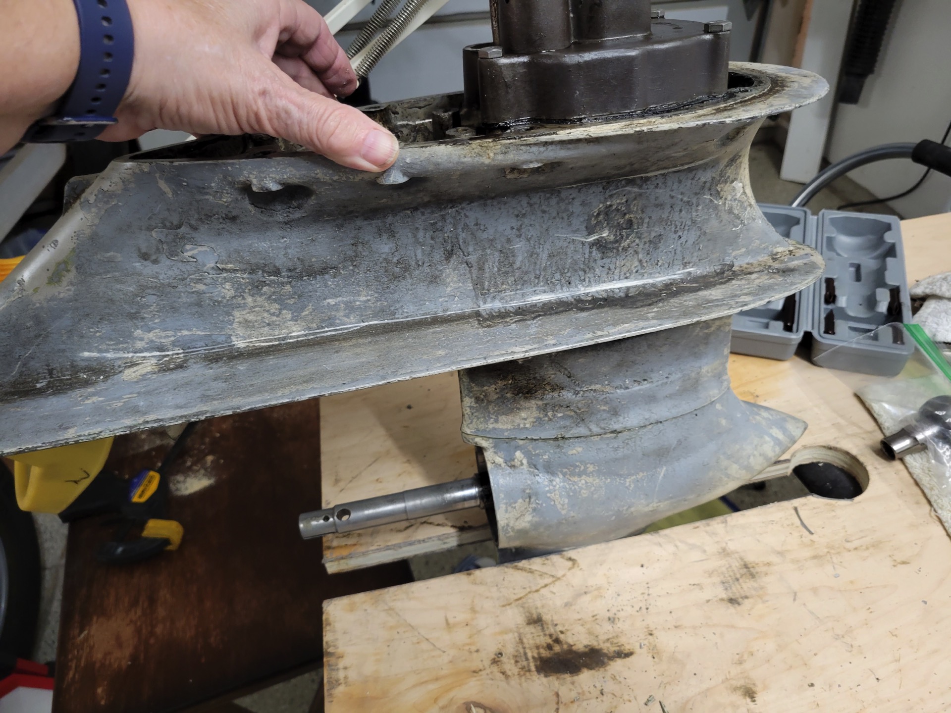

Well, still no go with removing the Yoke. There is no window on the starboard side. I have the Clymer shop manual for 1.5 - 125 HP 1956-1972 but it seems to be too generic for my engine. I just ordered the exact shop manual for my motor and hopefully that will help. At least my library is growing!
Slipping gear or Prop 3 years 3 months ago #148236
  • ed-mc
  • Posts: 1482
  • Karma: 235
  • Thank you received: 131
OK, thanks for the pics, that clears things up a bit. I thought you were talking about the shift link that ties the upper and lower shift shafts together. Obviously you're way past that.
So you want to separate the upper and lower halves of the gearcase! 1st you'll need to pull the water pump and get it out of the way.
Directly behind and directly in front of the water pump housing, you'll see a big, fine-threaded locknut. There are long studs that go from the lower gearcase, thru the upper gearcase, and the studs & nuts (with a flat washer underneath) hold the 2 halves together.
So you'll need to undo those 2 nuts. Hopefully you have a fresh-water lower unit, the cases should come apart easily. It's a real bugger trying to take apart a Salty Dog, because those studs get locked-into the upper gearcase with salt deposits.

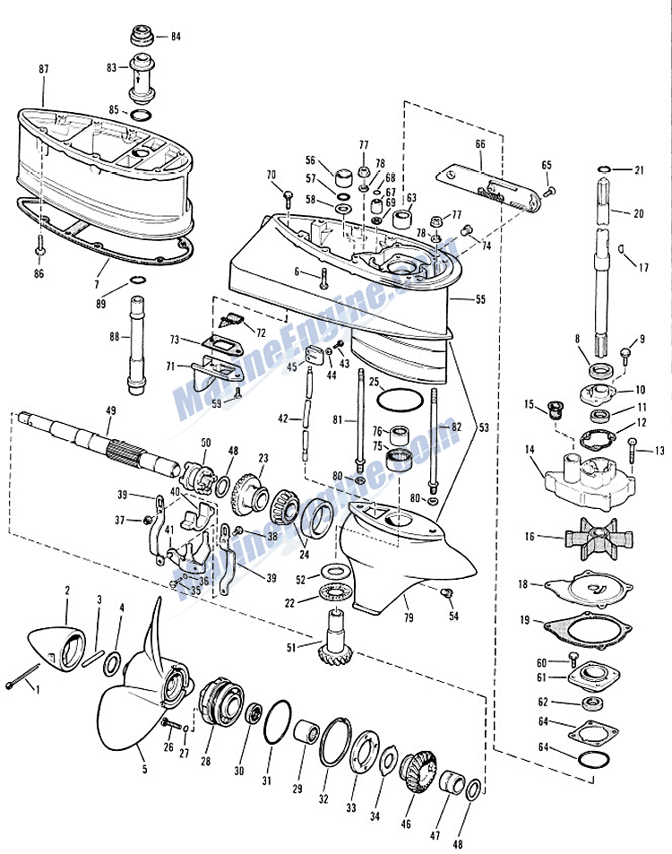

Referring to the attached diagram, let's go thru the high points:
The nuts are (77). The long studs are (81) and (82).
The O-ring that seals the upper and lower halves is (25). Best use something "sticky" to hold that in place, the O-ring is round and the groove it goes in is not!
Note the driveshaft bearing housing (61), it's held in with 4 screws. Replace the oil seal(s), also the gasket and O-ring there. The driveshaft bearing housing's gotta come off so you can pull the driveshaft out.
Note the shift shaft O-ring (68). You'll want to replace that. The bronze shift rod bushing (67) has to come out so you can get at the O-ring. This bushing is pressed into the gearcase. Some folks like to dig out the O-ring with a pick, but getting the new O-ring installed this way is really difficult and you can damage it. Best way is to pull the bushing and then you have ready access to the O-ring.
The way I pull this bushing is I take a 5/16" fine-threaded tap, and tap threads in it. Very easy to do, the tap is the perfect size to cut threads cleanly into the bronze. Once threaded, you can take a long 5/16-NF puller bolt and pull the bushing out of the gearcase.
2 ways to do that, one is to use a slide hammer. The other way which is pretty easy, is to put a chunk of angle iron or other stout material with a 3/8" hole (even a 2x4 would do if you have a long enough bolt) up against the flat machined surface of the gearcase, and with a flat washer under the puller-bolt's head, just screw the bolt down against the angle iron and let the natural pulling action yank it right out of the gearcase!
Once you're done replacing the O-ring, grease it with waterproof boat bearing grease or similar. Then slather some Permatex No. 3 Aviation-type non-hardening gasket dressing on the outside of the bushing, and drive it home.
One caveat on the O-ring replacement: once you've seated the O-ring in its cavity, run the greased end of the shift rod thru the O-ring. It's gonna be really tight, so work it thru carefully until all the way thru it. Wiggle the shaft around a bit to make sure the O-ring is properly seated. I've not done this before, and just pounded the bushing back in. Then, went to push the shift shaft thru and the O-ring was so squeezed-shut I couldn't get the shaft in. Had to mess around with it, very aggravating. Getting it all seated in place beforehand makes the job so much easier.
Note you can also use some OMC sealing compound or Mercury Perfect Seal on the shift bushing, O-ring, gaskets, nuts, studs, and bolts to help seal out salt & other deposits. They work as well as Permatex No. 3. This keeps things from binding up on the threads, and keeps salt/deposits out of metal-to-metal surfaces.
Useful Tip: With the driveshaft removed, and the case stud nuts off, you should be ready to separate the cases. Watch out for any loose needle or roller bearings coming from the split. One or the other of the pinion and driveshaft bearings (75, 76), IIRC, has loose rollers and you don't want any to get away from you!
Anyway, that should get you going! Post any other questions you may have as you get further into it.............ed

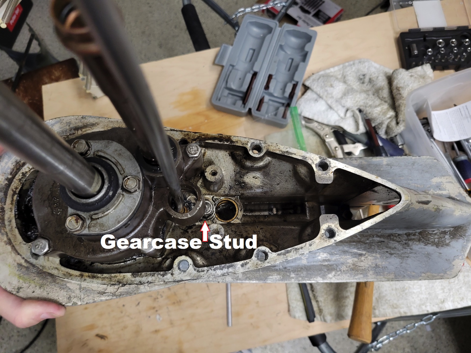

You have one pic that shows the gearcase rear stud, see the attached.

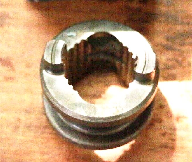

Slipping gear or Prop 3 years 3 months ago #148251
Update and new issue. Well, after several days I finally have the entire lower unit taken apart. As everyone predicted the clutch dog and forward gear need to be replaced. Anticipating this I ordered the replacements and now I have a new problem. Apparently for my model they did a service bulletin modification to the clutch dog. I purchased the correct part # 312054 but it does not have the groove in the center of the part that the modification calls for. My drive shaft has been modified with the spring and balls and the old clutch dog has the groove but I can't find a replacement with the groove. Any ideas? I have attached pages about the service bulletin for your reference. Thanks as usual for all of your help.

Well, it is good that you have the spring-loaded shift clutch, that was an upgrade that OMC made because of all the problems with the Big Twins and V4s kicking out of gear. The spring in the driveshaft, pushing on 2 little ball bearings, helps the clutch "snap" in and out of engagement instead of the clutch dogs "slowly, gently" engaging the forward gear and causing excessive wear, if someone shifts too slowly.
BTW on this and most any other outboard, you should never "Ease it In Gear", you should give a quick snap of the wrist so it engages fast. The Big Mercs don't have as much of a problem with gear and clutch dog wear, because they use a stronger design. All these screwy electric/hydraulic gearboxes were OMC's way of band-aiding the problem when they should have totally redesigned their gearboxes.
Just like Karl Kiekhaefer's "Dockbusters" with NO clutch at all, constantly engaged gears and running the engine backwards for Reverse, was their great idea for the time! Well, it just caused another host of issues, hence the prominent "Full Gear Shift" decal on the 1st Big Mercs with FGS in the early 60's.
Anyway, back to your conundrum, I'm surprised that OMC didn't include a part number for the upgraded clutch in their bulletin.
I did check at Marineengine.com and the parts breakdown did include the old P/N, which supercedes to the 312054 clutch dog. Typically when a P/N is superceded, that means there is an improved part replacing it.
In the case of the 312054 clutch dog, that is certainly true. I checked a bunch of 'em for sale on eBay, and the pictures show that the grooves for the ball bearing/spring setup are present on both sides of the clutch.
So whoever you bought the new clutch from must have just had the old part number and relabled it. Sometimes that doesn't make a lot of difference and the old part works just as well, in this case you've got to have the right one.
You should send that one back for a refund and tell 'em why. It's not the right part.
As I was saying, eBay has a Ton of these and the seller whose dog clutch picture I'm posting was only $17 shipped. Better than $140.60 plus shipping at Marineengine.com !!
I can't post eBay links here, as this site parses them for some reason that makes absolutely no sense at all. So go to eBay and use this search string:
312054 (Clutch, Dog, Shifter)
I'm sure you'll be pleased with that!
And while I can't post links, I can certainly post the eBay item # of that $17 clutch:
394649414546
If you plug that into the eBay Search box, it'll come right up.
I saw some cheap forward gears, there, too. You might find a steal there and return the other $$$ one if you already received it.
HTH...............ed
Slipping gear or Prop 3 years 3 months ago #148253
  • ed-mc
  • Posts: 1482
  • Karma: 235
Oh, Yeah, Brand New OMC forward gear, 377870, list at Marine Engine is over $305.00, eBay price $72 shipped!
Listing No. 391347374946
Another little secret:
1) Do you know what Forward gear is? It's a Reverse gear with a flanged bushing pressed into it.
2) Do you know what a Reverse gear is? It's a Forward gear without the pressed-in flanged bushing, and instead a floating bushing insert.
The trick in the old days was to find a good Reverse gear, because there was far less stress and wear put on them and usually no jumping-out-of-gear wear.
Then you just takes your press and presses out the old Fwd gear bushing, and presses it into the Reverse gear. Make sure the lubrication hole(s) line up.
Presto! "New" Forward gear. It's Magic!!
I think the later Reverse gears that came in Spring-Loaded clutch dog gearcases might have had the internal groove in them, too. If not, then it wouldn't be such a beneficial workaround. But in the Very Old Days when you were working with non-spring-loaded clutch dogs and they were jumping out of gear like mad, it was a good way to get it going again. Providing you had access to a good store of used parts. Which I did!! Lucky me!
