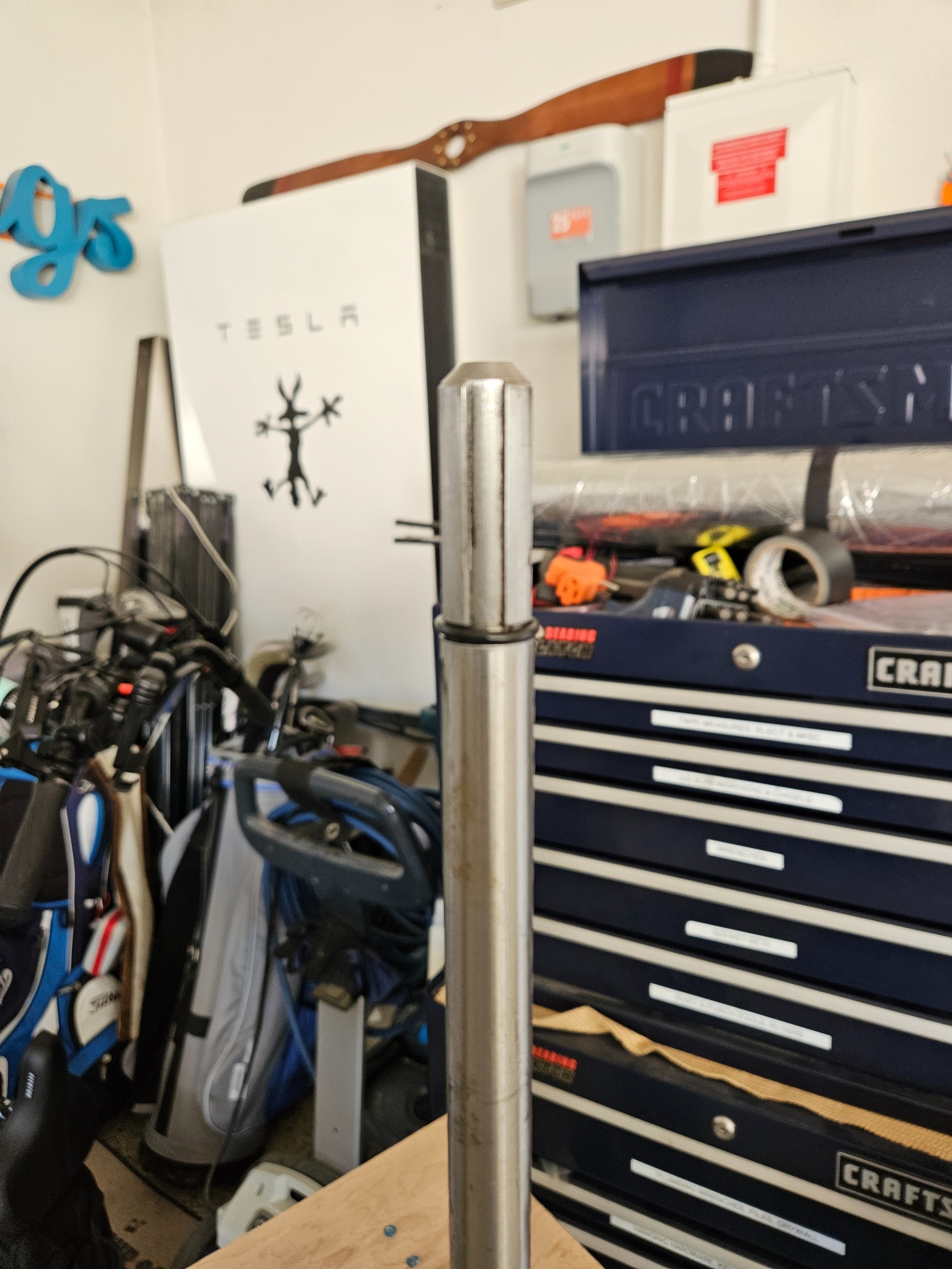

Is the o ring in the proper place or should it be at the top of the drive shaft? I am going to do vacuum test, pressure test passed.
Slipping gear or Prop 2 years 9 months ago #148602
Yes that shaft 0-ring is correct. the upper plug is not a drain but is mainly used to tell if you have the lower unit filled properly. When filling the lower unit you fill from the bottom with the unit down. Pump full of oil until it flows out the upper hole and then put the upper screw/plug back in while you still have the lower oil supply connected on the bottom. The "gasket" could either be the nylon type or an 0-ring that fits snug. I was never a fan of the nylon washer type but if that's what you have use it. Once you have the upper plug back in and snug you can disconnect the lower fill, you'll lose a smidgeon of lube but if your really fast putting the lower screw back in you're in good shape.
