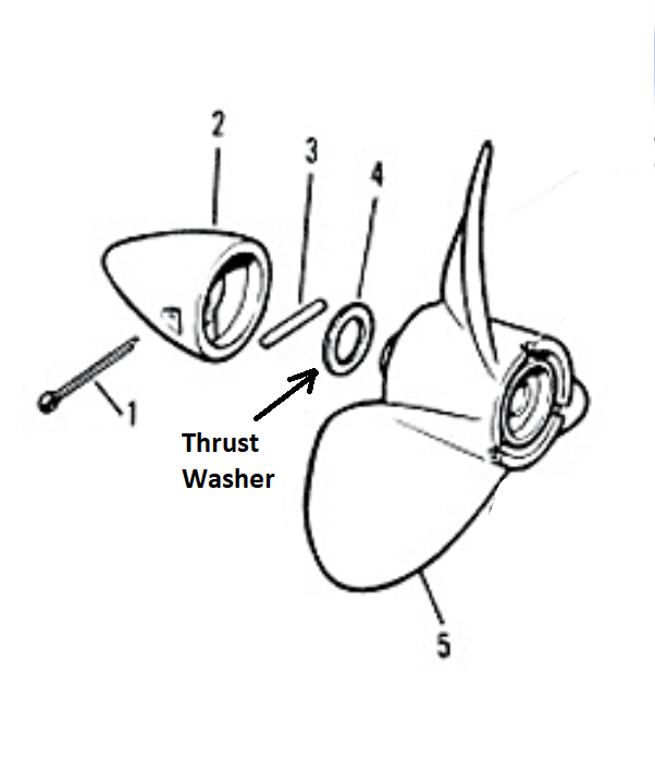

I recently took my project boat out for the first run. Motor started up, reverse worked, forward worked at low idle. Once past the 5 mph buoy I slowly increased the throttle although it accelerated for a few seconds then it lost power and made a grinding noise. I immediately returned to neutral, tried to accelerate slower again - same result.
Researching the problem and hoping it is not the gears I discovered that the thrust washer was missing from the prop. I purchased a thrust washer and have installed it (see attached drawing). Is it possible that the missing thrust washer caused the problem? I will need to test it in a trash can and I am not sure what would happen when I accelerate. I can take it to a lake but it is about an hour away and I didn't want to drag it out without first getting some advice.
What do you think?

Slipping gear or Prop 3 years 3 months ago #148251
Update and new issue. Well, after several days I finally have the entire lower unit taken apart. As everyone predicted the clutch dog and forward gear need to be replaced. Anticipating this I ordered the replacements and now I have a new problem. Apparently for my model they did a service bulletin modification to the clutch dog. I purchased the correct part # 312054 but it does not have the groove in the center of the part that the modification calls for. My drive shaft has been modified with the spring and balls and the old clutch dog has the groove but I can't find a replacement with the groove. Any ideas? I have attached pages about the service bulletin for your reference. Thanks as usual for all of your help.
Slipping gear or Prop 3 years 3 months ago #148252
  • ed-mc
  • Posts: 1482
  • Karma: 235
  • Thank you received: 131
Well, it is good that you have the spring-loaded shift clutch, that was an upgrade that OMC made because of all the problems with the Big Twins and V4s kicking out of gear. The spring in the driveshaft, pushing on 2 little ball bearings, helps the clutch "snap" in and out of engagement instead of the clutch dogs "slowly, gently" engaging the forward gear and causing excessive wear, if someone shifts too slowly.
BTW on this and most any other outboard, you should never "Ease it In Gear", you should give a quick snap of the wrist so it engages fast. The Big Mercs don't have as much of a problem with gear and clutch dog wear, because they use a stronger design. All these screwy electric/hydraulic gearboxes were OMC's way of band-aiding the problem when they should have totally redesigned their gearboxes.
Just like Karl Kiekhaefer's "Dockbusters" with NO clutch at all, constantly engaged gears and running the engine backwards for Reverse, was their great idea for the time! Well, it just caused another host of issues, hence the prominent "Full Gear Shift" decal on the 1st Big Mercs with FGS in the early 60's.
Anyway, back to your conundrum, I'm surprised that OMC didn't include a part number for the upgraded clutch in their bulletin.
I did check at Marineengine.com and the parts breakdown did include the old P/N, which supercedes to the 312054 clutch dog. Typically when a P/N is superceded, that means there is an improved part replacing it.
In the case of the 312054 clutch dog, that is certainly true. I checked a bunch of 'em for sale on eBay, and the pictures show that the grooves for the ball bearing/spring setup are present on both sides of the clutch.
So whoever you bought the new clutch from must have just had the old part number and relabled it. Sometimes that doesn't make a lot of difference and the old part works just as well, in this case you've got to have the right one.
You should send that one back for a refund and tell 'em why. It's not the right part.
As I was saying, eBay has a Ton of these and the seller whose dog clutch picture I'm posting was only $17 shipped. Better than $140.60 plus shipping at Marineengine.com !!
I can't post eBay links here, as this site parses them for some reason that makes absolutely no sense at all. So go to eBay and use this search string:
312054 (Clutch, Dog, Shifter)
I'm sure you'll be pleased with that!
And while I can't post links, I can certainly post the eBay item # of that $17 clutch:
394649414546
If you plug that into the eBay Search box, it'll come right up.
I saw some cheap forward gears, there, too. You might find a steal there and return the other $$$ one if you already received it.
HTH...............ed
