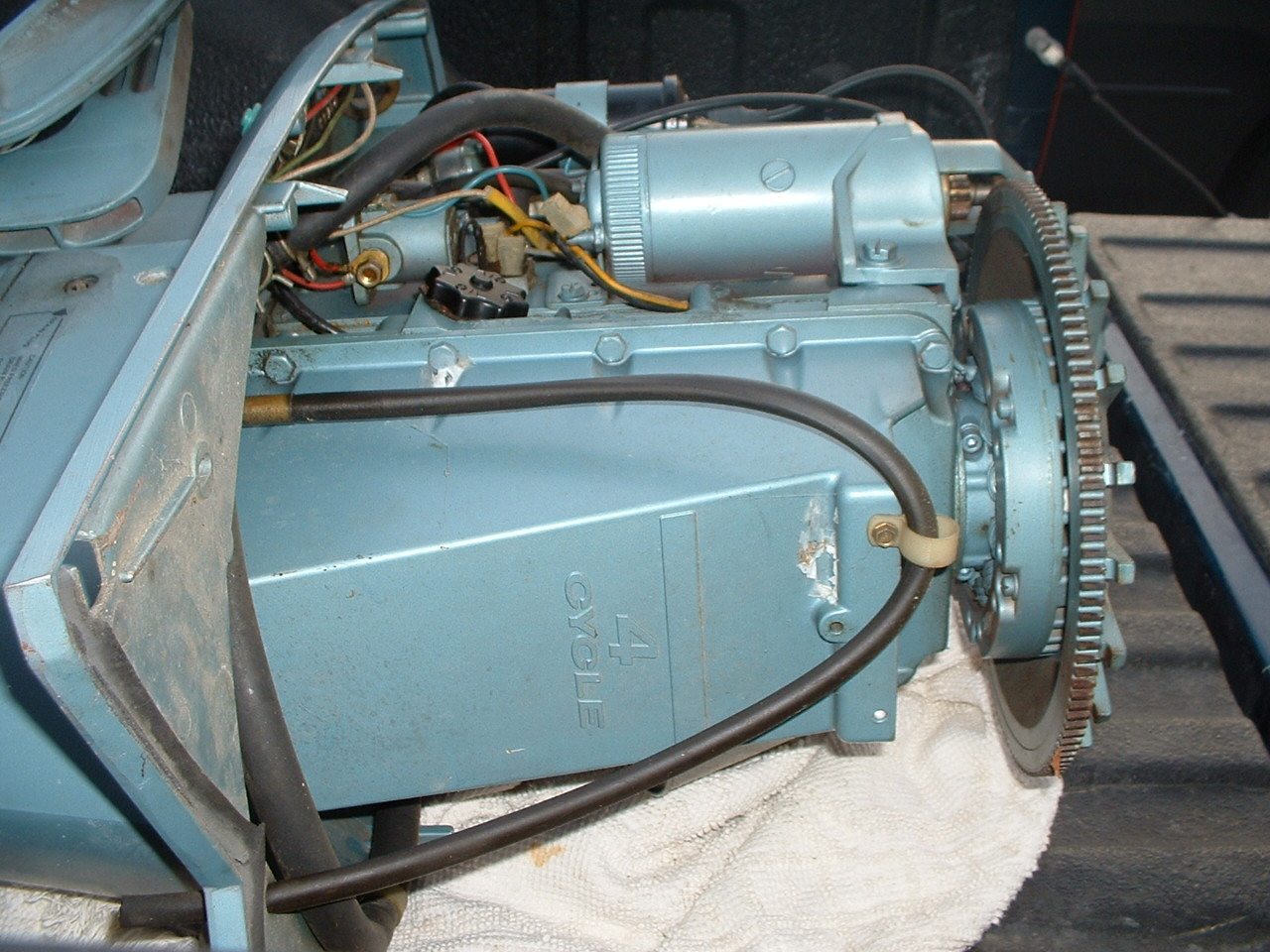

I have what looks like 2 tell tales on my homelite but the one on the port side a breather tube for to motor. check and see if the one on that side is coming out right were you add oil and fallow it down and see if that is the hose on that side.
Mike aka the pirate
Re:Working on Bearcat for the pontoon 14 years 6 months ago #61193
  • elgindave
  • elgindave's Avatar Topic Author
  • Posts: 683
  • Karma: 10
Hi Pirate,
My breather hose is in the back center.

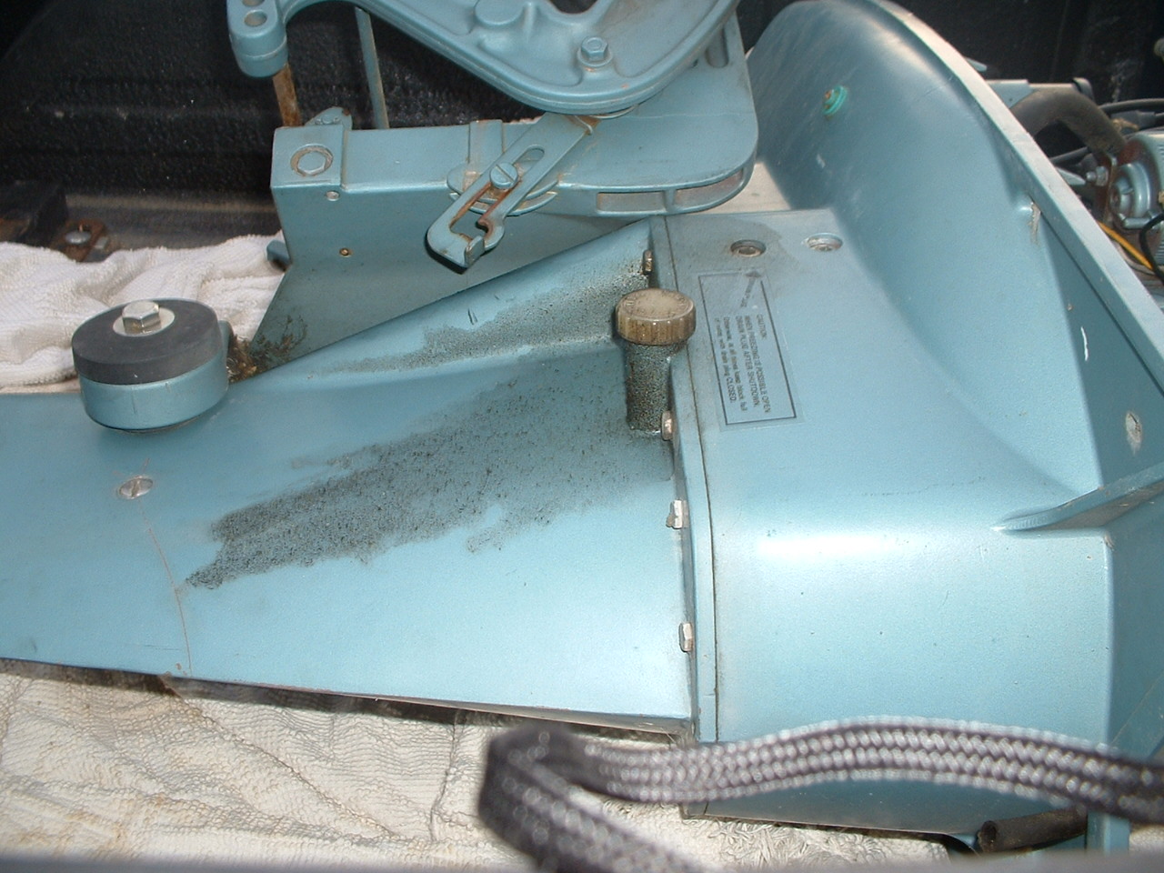

Here is a photo of where the winterizing drain is. It is a bluish color on the motor on the motor pan near the transomom clamps.
blow up this photo you will see it.
The hose that hooks on there comes from the water jacket on the port side.
And this is the one I'm assuming was also peeing water while you were running the engine?

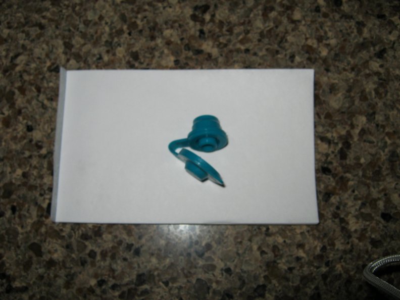

Nope. It was plugged up with mud dobber junk. so I cleaned it out. I think I'll have to pull the lower to see the whole picture.
Dick what kind of cap did they use for this port side drain for the "F" motor?
Was it some sort of snap on cap?
Dave
By the way your newest motor sounds great.
Mine starts and runs great. Just not pumping right
Re:Working on Bearcat for the pontoon 14 years 6 months ago #61201
  • 4stroke
  • 4stroke's Avatar
  • Posts: 291
  • Karma: 16
Yes snap on cap, picture coming.

Dave, yes I've also experienced the tell tale plugging up, I've got a wire in the boat that I'll run up the hose to clear it. A couple of my engines were pretty rusty in the water jackets and I'm sure some of this crud broke loose and restricted flow. after a awhile it cleared and has been fine. The powerhead I just replaced was like this.

Yes that is what thought. The snap on cap is missing to my winterizing drain. I guess I will just fix up a thing to plug it until fall winterizing time to drain the block.
