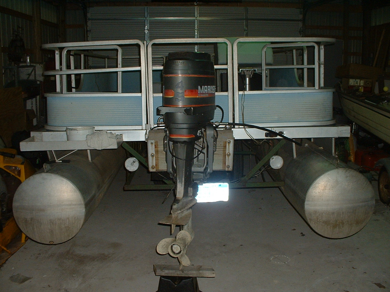

Tested the Bearcat today.
Sad to say. Not pumping.
Something is awry.
Will investigate :angry:

Pulled lower.
Checked the impeller. It is OK.
Didn't find the woodruff key!!! No wonder it wasn't pumping.
Working on that. Thought it was there when I installed it.
In the mean time I took the thermostat a part. What a mistake.
Lots of springs and other stuff flying out. Need 4 hands and two feet to get it back together.
Help! Any tips? :angry:
