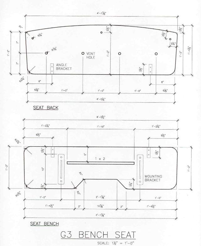

Jim, if you are redoing the plywood on your seats... here is a drawing that I obtained from one of the senior G3 guys. I did the same thing, mine were recovered years ago, without the proper plywood, but with these drawings, I was able to replicate the stock seat:
I did add 2" of foam (5" total) to the seat bottom for more cush...
Dean
Bandit - 1959 Glasspar G3
Re:G3 Identification 12 years 11 months ago #86663
Dean
Thanks for the seat info. It seems to be about the same as my seat but when I get the upholstry off I will double check against the drawings. Was there any kind of seating for the rear? I don't see any signs of any previous mounting. Did the 59 model have a foot rest, there was a short piece of angle on the floor under the dash. Maybe it was for a gas tank? Finally, I have seen a few photos with steering on the port side. Was the steering installed by the dealer? Again thank you for your post
Jim

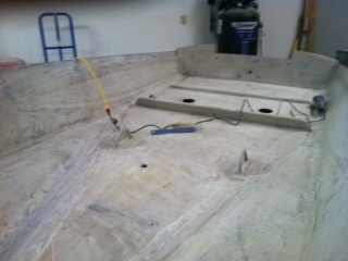

Another attempt at photo
Jim

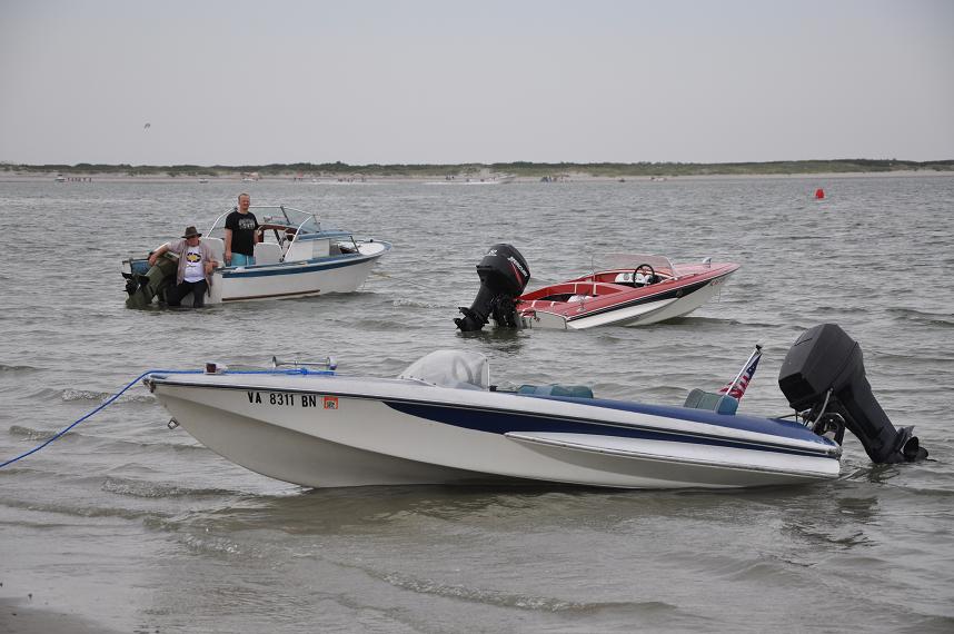

Re:G3 Identification 12 years 11 months ago #86675
  • morris
  • morris's Avatar
  • Posts: 393
  • Karma: 38

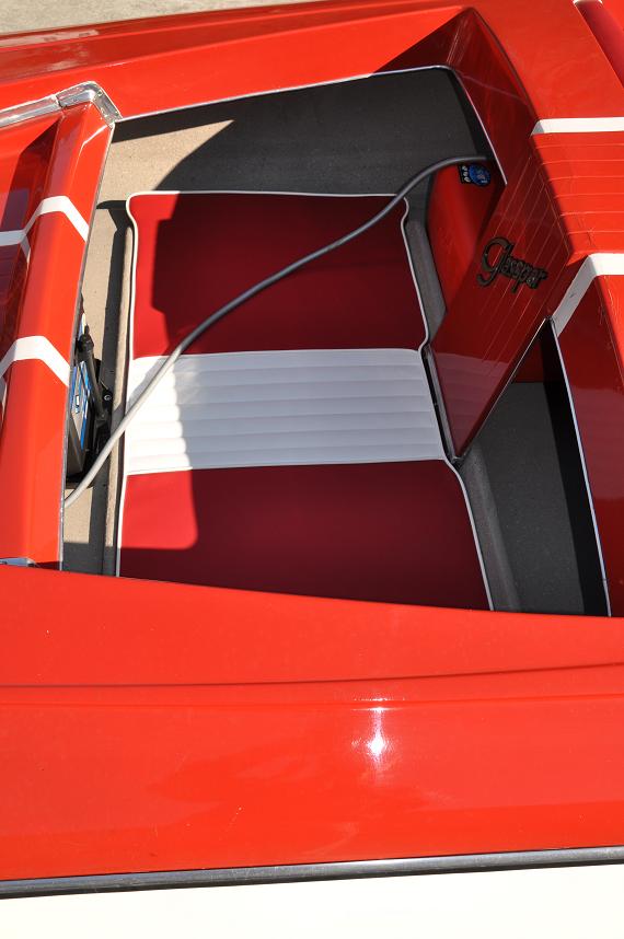

Hello Jim, And first off, Welcome to the site and congrats on finding a 1959 G-3. You are being coached by three of the best. Split, Ken and Dean. They have mentioned a fourth you may want to catch up with and that is 60REDG3 aka John. While I have seen center decks with two small jump seats added to the back of the center deck, I have never seen any information on them being factory. I am not saying that it isn't possible. There were other Glasspar models that had tuck-a-way jump seats. The 1959 and very early 1960 G3's had a factory kneeling pad that was available for behind the center deck. These are extremely rare to see today. Glasspar discontinued the kneeling pad during mid run of the 60 G3.
If you are not able to load the measurements that Dean has given you on the seat, I have it in PDF and would be glad to mail it to you.
I have attached a pic with John's 60REDG3 in it. John's boat is anchored behind my 67 G3. This shot was taken on the Inter Coastal Waterway near the southern tip of Topsail Island NC this last summer.
Please feel free to contact me at anytime.
Al Wilson aka morris
www.g3owners.com

Hey Al, would you mind sending me a copy of your PDF of the seat drawing? This email address is being protected from spambots. You need JavaScript enabled to view it..
Hey John... that pad is cool! I want one for the Bandit!

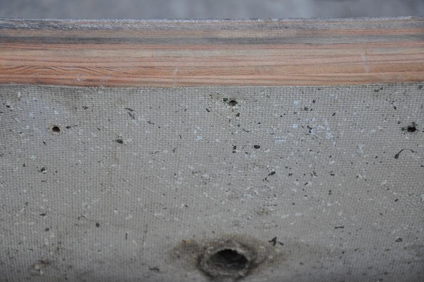

Re:G3 Identification 12 years 11 months ago #86797
Hey Jim,
So your transom is solid? Nearly every boat that hasn't been garaged its whole life (like John's) ;) has had rotted wood in the transom.
Very cool on the engine... I have a 1963 L6 850.

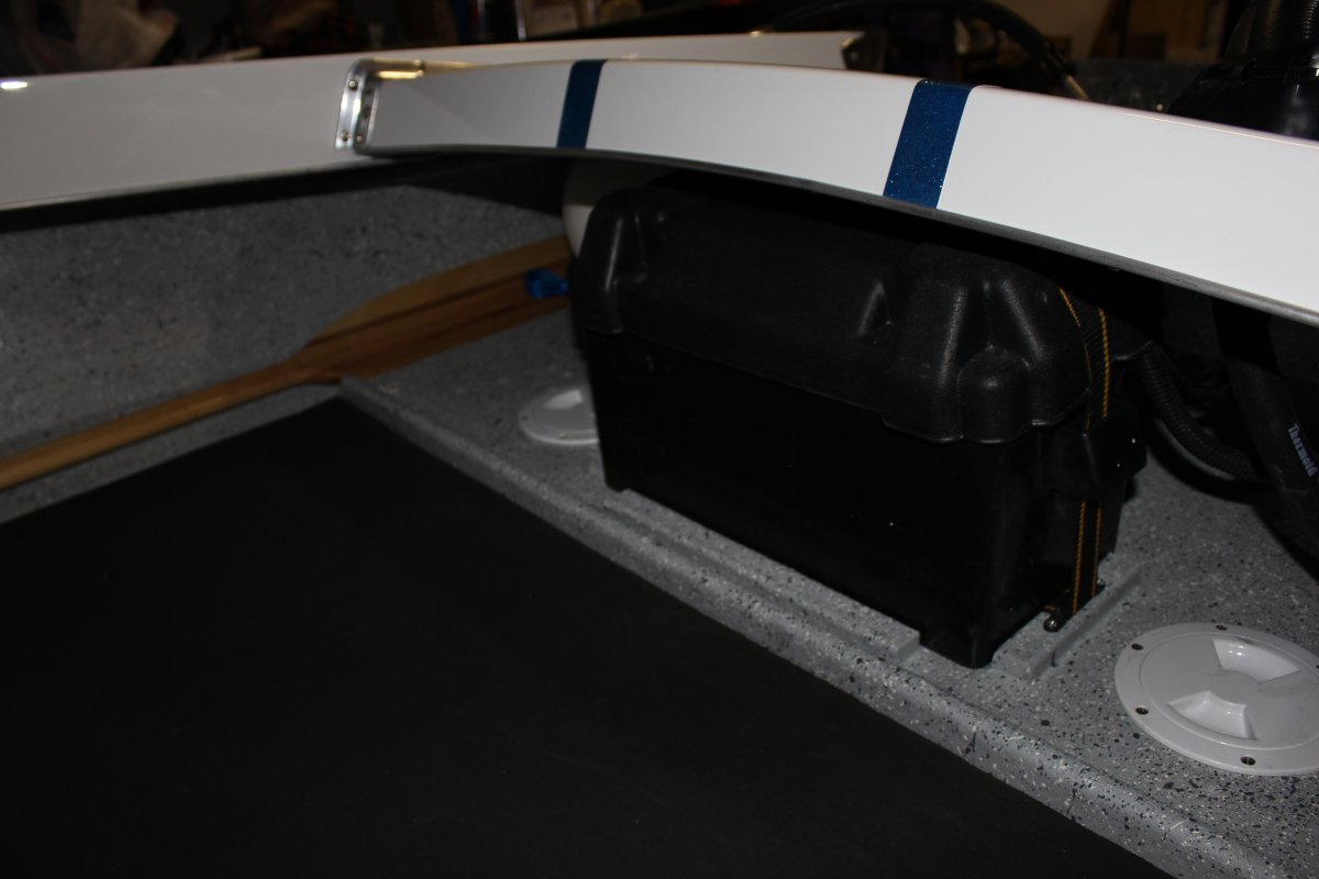

Re:G3 Identification 12 years 11 months ago #86798
Hey John,
Now I see what you mean regarding the drain plug. My '59 didn't have one, and after I bought Bandit and found the below deck space was flooded with rainwater, I had to have one! I drained buckets of water through a hole I drilled...
Then I installed a plug like yours once the hull was painted:
Now I have no holes in the transom, except those needed to mount the motor and the drain plug holes. Even that speed pickup is mounted to the CMC unit.
I've also installed 4" access plates under the splash well, so I can fully vent the bilge while the boat is stored in the shop. You cant have enough ventilation when a boat is stored ;)

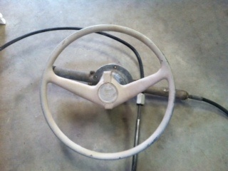

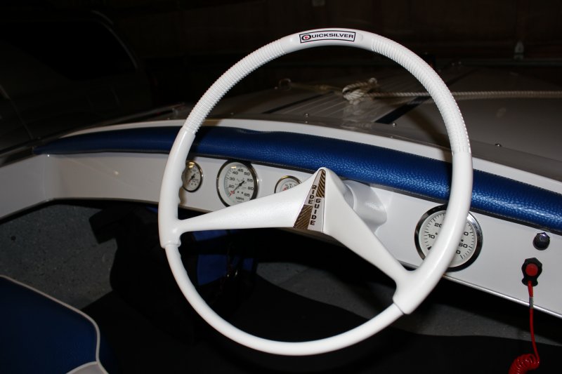

Re:G3 Identification 12 years 11 months ago #86817
Mr. Bandit
Thanks for the information. Here is a photo of the wheel I have it appears to be different from yours. There is only one badge in the center and it is very faded. This setup fits the only cut out in the dash but it hangs down a bit and the rack is visible. All of the steering is in good shape, but I'm not sure how it connects to the engine. I think a part is missing that the cable end fits to but I'm not that far along yet.
Thanks also to Dr. Frankenmerc for the propeller tips.
It's very cold here so I need to find some kind of shop heater before I can start painting.
Again, thanks to all, Jim
HAPPY THANKSGIVING
Re:G3 Identification 12 years 11 months ago #86818
deanlofall wrote:
Hey John,
Dean:
Thanks for your reply and photos!
Wow, I didn't realize that Glasspar made any of the G-3's WITHOUT that "air/flotation area" plug?? Ours has always had it, although I had to install a new brass plug (like yours) after a sorry thief STOLE my ORIGINAL plug from the inside of our G-3 at the 2009 "Sunnyland" Antique Boat Show in Mt. Dora, Fla.!! GRRRRR!
Unfortunately,...I could not find another one like the original
one that came with our G-3. BTW,.....I have never returned to that Mt.Dora Show with my G-3 and won't ever go again with a boat either.
I really like those "access plates" you installed under your splashwell! Good idea Dean. If I ever have to re-do our transom or floor I will definitely use that idea. Thanks buddy!

Re:G3 Identification 12 years 11 months ago #86908
Jim:
Here is a picture of what the fiberglass stringers look like in a
Glasspar Seafair Sedan. This is a boat our ECGOA Group is restoring at Al's house. The floor in this Seafair was badly rotted as well as the transom.

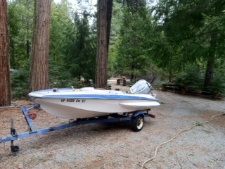

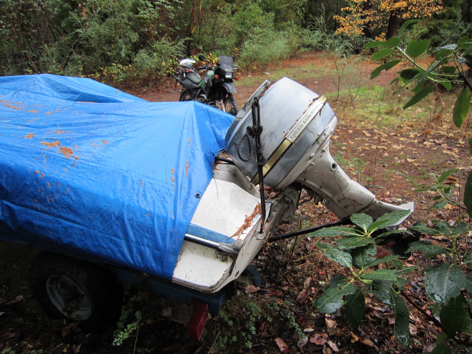

Hello
I took Al's advice and towed this home from our Thanksgiving visit. I got to tires from Tractor Supply, mounted them up with a couple of screwdrivers and off we went (200+) miles. It is a 1964 open deck with a 50hp Johnson that turns by hand. Owner had not seen it run as he got it abandoned off a job site. The transom sounds pretty soft but the floor didn't seem to move when he bounced on it. I will put it in a shed until I finish the 59.
I hope I'm not going down the wrong path but it seems there are quite a few classic boats out there just for the taking. Please intervene if you see signs of addiction. Thanks again to all for your input and advice.
Jim

Good evening
After some checking today the engine on the 64 G3 seems to be a75hp? The S/N V4SL-16A was on the engine base. The boat S/N is 13A4006. The foredeck is different as it has a raised edge and the dash top has a tray like area.
As for ongoing work I didn't know Zolatone was not locally available so I ordered it today. I am ready to spray when it arrives with recommended larger gun tip. I am having a struggle getting hull numbers off, any tips?
I guess I will use Awlgrip for hull painting, but I have not used it below the waterline. I hope it will be ok as the boat will not be kept in the water for a prolonged time. Any tips on my fishing exhibition here? Thanks
Jim
