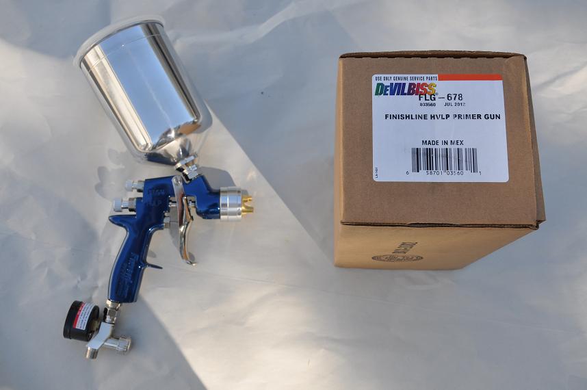

Jim, on spraying the Zolatone I would NOT recommend using an HVLP
(High Volume, Low Pressure) type spray gun! I had ALOT of trouble when I tried using one of those guns and it made a huge mess in addition to the small gun CONSTANTLY clogging up!
Here is a picture of what a HVLP gun looks like:
What I WOULD recommend is one of the older style "pressure pot"
type guns that Glasspar originally used in the factories to apply
"Zolatone." I found one of these spray guns at "Home Depot" although any auto body supplier has them too. Here is a picture of the spray gun I bought at "Home Depot":
I will get you the exact part number for this gun if you want.
For what it is worth, that gun is made in the U.S. right down in Florida and it was reasonably priced at about $65.00. This gun has a 1.8 spray nozzle in it and I think the larger nozzle you can find the better it is for spraying the Zolatone. As I recall,
Zolatone recommends nozzles from 2.0 to 2.4.

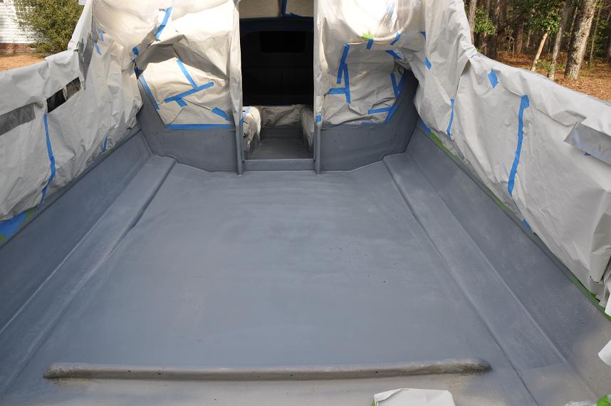

Also Jim, you will need to apply some primer before you shoot the
Zolatone. You should be able to buy that locally at most marine paint or boat dealers. Here is a shot of the floor in our 1960
Glasspar Seafair Sedan after I applied the primer to the inside cabin and outside floor:

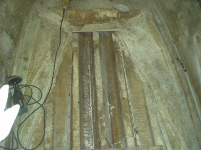

Jim, I know you are not going to work on the 64 until the 59 project is complete but thought I would show you the stringers used in open deck g-3's
www.g3owners.com
Re:G3 Identification 12 years 11 months ago #87203
Morris & Mr. Red
Thank you for the paint gun tips and view of the stringers. Maybe that's why floor seems solid, but I should try a couple of inspection plates as I have seen in your photos. I will wait until I finish what I've started. Was going to paint today but the deck was outside upside down and we had snow in the night. It's in the garage to dry so maybe paint tomorrow. I will use grey epoxy primer under the Zolatone. Will try to post photo of finished job.

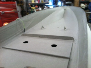

Finished the Zolatone today, hull, under deck and splash well. This was my first time and I am happy with the results.
Strange stuff the way the colors sort of settle in, it looks pretty much like the inside of a new boat. Now I just have to figure
a way to turn the hull by myself, (any ideas?) I did buy a heat gun to remove the CF numbers, worked great. As I was
removing them I discovered that someone had previously removed them with what looked to be the hammer and chisel
method. Soon I'll be off to get a paint match for the hull, think I'll take the splash well. Also had a tip on engine to steering
cable connection today, thank you.

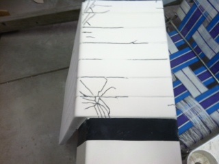

Re:G3 Identification 12 years 11 months ago #87295

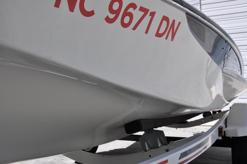

Hello again
We got the hull turned over today, my wife's very handy with directions. Looks pretty good with only a couple of small
depressions from rollers on the keel. Do any of you folks have advice on proper Awlgrip color to match original G3 white?
Hope to get that part done this week. The boat does have some crazing in the deck, I plan to sand and fill with high build
epoxy primer.
Would that be the proper procedure, I don't have experience with this type of defect? It does not appear to be from contact
maybe flexing. Anyway, time to go start sanding.

Re:G3 Identification 12 years 11 months ago #87299
Jkerrigan7373 wrote:
Hello again
epoxy primer.
Jim
Jim:
On our G-3 we had considered initially using "Awl Grip" but decided to use gelcoat to keep it close to original. But,...with that being said, our fiberglass boat restorers who did the gelcoat work felt that had we gone with "Awl Grip" that the color called OYSTER WHITE was very close to the original color. You can go to their website and look at the paint chip colors to compare.
Hope that helps you Jim!

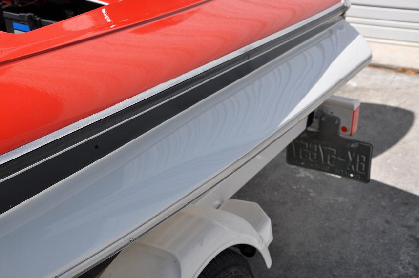

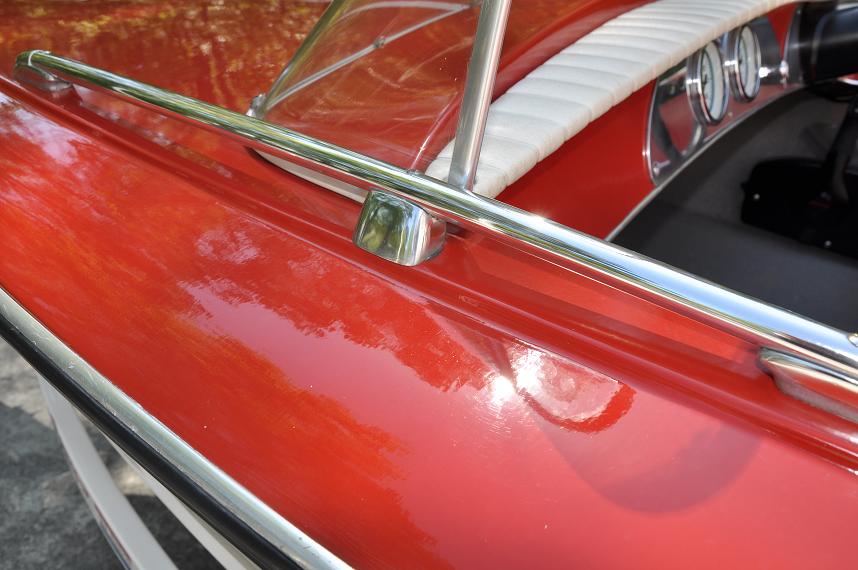

Jim,...our G-3 was gelcoated by a "father and son" fiberglass
restoration and repair shop who have been in business for over forty years. When they explained to me the whole gelcoat process I knew it was way over my level of expertise! LOL! There is ALOT of sanding involved to get the surfaces buttery smooth. I have also seen some re-gelcoat jobs that look good and others that don't look so great, so there is some special techniques to it.
But with all that being said I don't think "Awl Grip" or any high quality marine paint will hurt the value or appeal of your G-3.
I am posting some pictures of the new gelcoat on our G-3 so you can see what a good job my guys did for us:

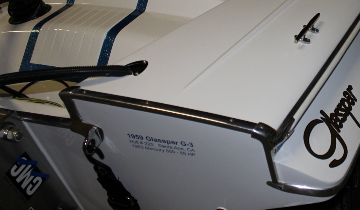

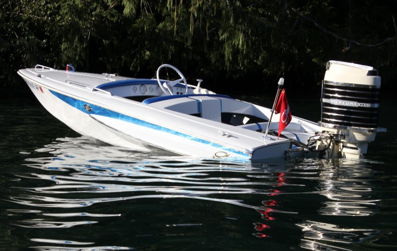

John's boat is beautiful, and I hope to see it in person one day.
On Bandit, I used Awlgrip. Like John's gel coat, to get the finish I was after, it needed sanding and buffing. Bandit was sprayed professionally by my auto body pro with the Awlgrip, then by his direction, I wet sanded it with 1500 then 2000 grit paper, by rolling it over a carpenter's pencil. It took a fair bit of time (though much less than sanding the boat during my prep to paint) but after I got it back from buffing, it was mirror smooth.
I don't have enough data points to recommend anything, this is just the route I went, and I am very happy with it. I can tell you that Awlgrip is used for new construction of large yachts, and is a durable finish.
I don't have any good up-close photos and its too crappy to get Bandit outside just now for close ups like John's pictures. I wouldn't think going either way has one bit of affect on value of your restoration.
Dean
Bandit - 1959 Glasspar G3

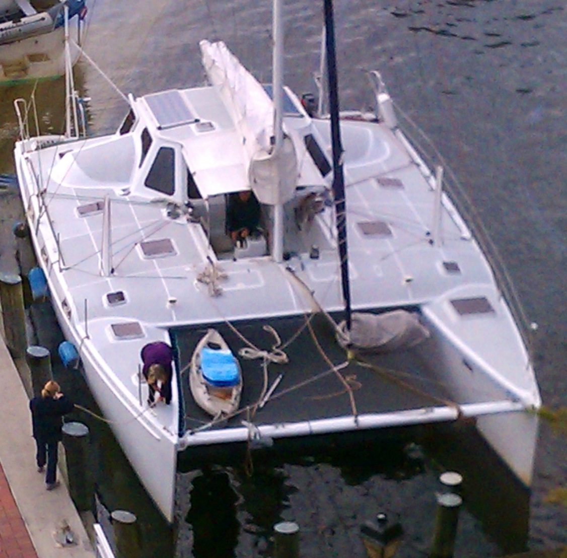

This is GRACE in Portsmouth at mile 1 of ICW

The Holidays are over and it's time to resume the boat obsession. The G3 is primed, faired and ready for paint. I took a road trip and came home with a 1957-58 Redfish Shark and a 1957 Herters Standard. Also picked up some Mercury motors Mk75, Mk58, Merc 400, Merc 300 all supposed to run. Plus a load of extra parts and a new dog.

Oh Yea Jim!! You have the syndrome for sure! Nice finds. Sandy would be envious of the redfish. and I of the Herters. You definitely have O. B. P. R. May I say "ain't" it great.
Al

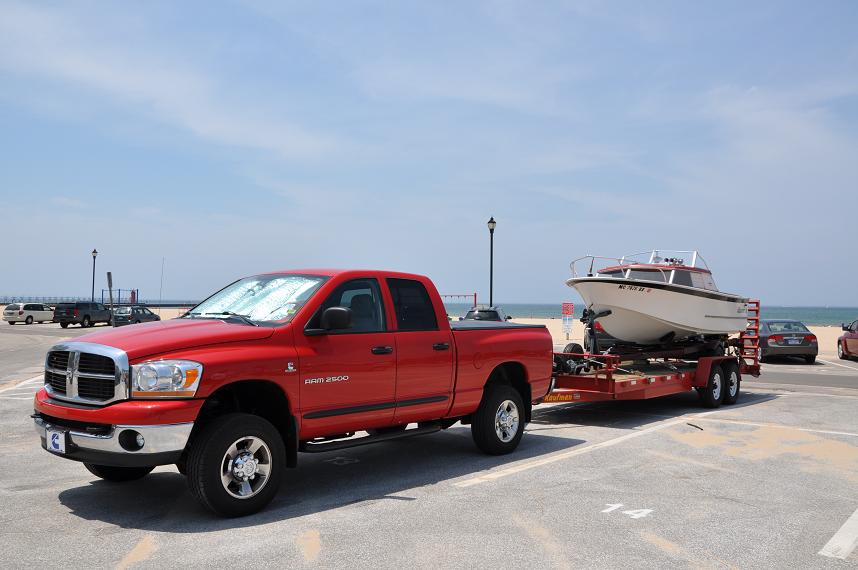

I know exactly what you guys are saying. We traveled almost 1,000
miles from N.C. to Michigan to pick up our 1960 Glasspar Seafair
Sedan. Here is a photo of that:

Good morning
I'm looking for suggestions regarding trim polishing. Any tips would be appreciated. In getting ready for assembly, steering and controls reconditioned but need seat redone. Thanks to all.
Jim
Re:G3 Identification 12 years 9 months ago #88743
Hi Jim,
On Bandit, I spent hours and hours in front of a polishing wheel that I put on my bench grinder. Starting with black compound and ending with white compound. Once the pieces were polished and washed... I brushed on straight Penetrol, and wiped it off... just like you would apply oil to wood.
www.flood.com/paint-additive-solutions/index.do
This stuff is awesome. Recommended to me by a mechanical engineer who seals all kinds of metals with it to prevent rusting. Bandit's polished trim looks just as good as it did when I applied it in 2011. I was warned about sealing polished aluminum with clear coat. It ends up tarnishing under the clear and then you have a mess to deal with. Penetrol can be reapplied with a rag as needed.
For the rub rails, sponson edge trim, deck aft-edge trim, and grab handles... these are anodized. If you put anodized aluminum on a polishing wheel, it just turns black. You need to remove the anodizing first. Search the web, there are techniques discussed in detail. I used a Drain-O solution in a big bath I made out of sheet plastic and 2x6... I soaked it for about 20 minutes and the annodization turned into gray goo. Washed it off then had clean aluminum to work with. (WARNING: do this outdoors and don't smoke... the process creates hydrogen gas)
My rub rails and sponson trim rails were dinged and scuffed... I sanded them before polishing... started with a light 200 wet sand... then went to 400, then 800. Then using a polishing wheel on a high speed drill, I buffed them with black then white compound. They came out great... watch out with a drill/polishing wheel... it will grab the rail if not careful.
Dean
Re:G3 Identification 12 years 9 months ago #88753
Dean
Thanks for the instruction for polishing the trim, I'll try it as the pieces in your photo looks great. I like the large Glasspar badge, is that an original piece? Also the decal on the transom is a nice touch. Again, thank you.
Jim
Re:G3 Identification 12 years 9 months ago #88755
Jim:
Like Dean, we also had to do EXTENSIVE polishing and re-coating to the hardware on our G-3 and also on our Seafair Sedan.
One product that I have used which I highly recommend is "BILLET"
Metal Polish made by "Mothers." You can buy this at most "Auto Zone" Stores and it works better than ANY product I have ever used personally.
Shown below is a picture of what the "Mothers BILLET Polish" looks like:
Jim, here is a photo of what our grabrails looked like after we polished them on the G-3:
As Dean also mentioned, our stock Glasspar Metal Rubrails along the sponsons were very nicked and beat up. I contemplated buying new ones for the boat but decided against it when I found the new metal rubrail cheap looking and not built as well as the originals. I was told by some other Glasspar owners that you could NOT refinish the original rubrail because of them being a
"potmetal" type material. Well Jim,....that advice was TOTALLY
FALSE and WRONG! I found a powdercoating company near my home with an owner and metalworker who is very experienced with older types of aluminum and metal like the Glasspars have.
He did a great job in sanding and working out many of the nicks etc. and then put on a fresh finish of powdercoating in a color he
called "CHROME" which has a nice bright finish, but not to where it looks like actual chrome.
Here is a picture of how those came out:

Hi Jim,

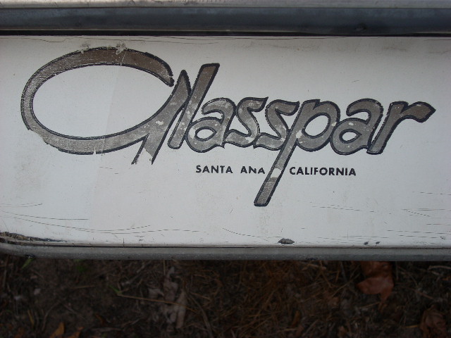

The Glasspar decal on the sponsons was proper on the 1959 and some very early 1960 models. It is the "old style" logo. Thanks to Ken from Australia "Downunder", he had reproduced the logo as a vector file... and thanks to G3Bill from SoCal, I got a copy of the Ken's file, and he also sent me some good photos of the factory decal to compare. We had a few minor tweaks to make to match them exactly... but we got the Adobe Illustrator files right and to a very good die cut decal guy who makes them.
G3Bill's original decal on his '59:
Re:G3 Identification 12 years 9 months ago #88785
John/RG3
Thanks, did you remove the anodization on the hand rails in your photo? As I try to remove some of the larger nicks I am sanding through the coating and creating two colors of metal that is noticeable even when polished.
What do you do to protect the finish? It's very fine.
Jim
Jim:
No Sir, we did not have to remove the anodized finish on our aluminum like Dean did. Fortunately, our G-3 is a "one-family"
owned boat which my Dad ordered brand new way back in 1959. The boat did sit in a garage unused for over twenty years but was well
covered with a very thick tarp. All the aluminum was heavily tarnished, but after alot of elbow grease and use of high speed
commercial polishing wheels (like Dean used) the aluminum (as you see it in the pictures) came out great! To protect the finish we are using a commercial grade aluminum spray which I will get the name of for you. A good friend of mine who runs a metal fabrication and boat shop helped me alot with how to do this.
After every use, I recoat the aluminum with the commercial
metal spray and preservative. So far it has worked very well and we do use our G-3 in saltwater occasionally.
Jim, if you can't get your aluminum to come out like you want, I would recommend sending it to a shop to be either chrome plated or powdercoated. I would be happy to give you the name of my powdercoating guy and I also have the names of some chroming shops that can handle the types of aluminum and metal we have on our G-3's. Don't let anyone tell you that the parts CAN'T be powdercoated or chromed because that is FALSE! As I said above, I was told the same thing by a few so called "Glasspar Experts."
It sounds like you are a guy like Dean and I that wants your G-3 to look as nice as it can! LOL!
