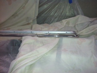

Dean and other polishers
I've been working away on all the trim but some pieces have small pits and scratches. Any ideas on their removal, or is something I have to live with?
Jim

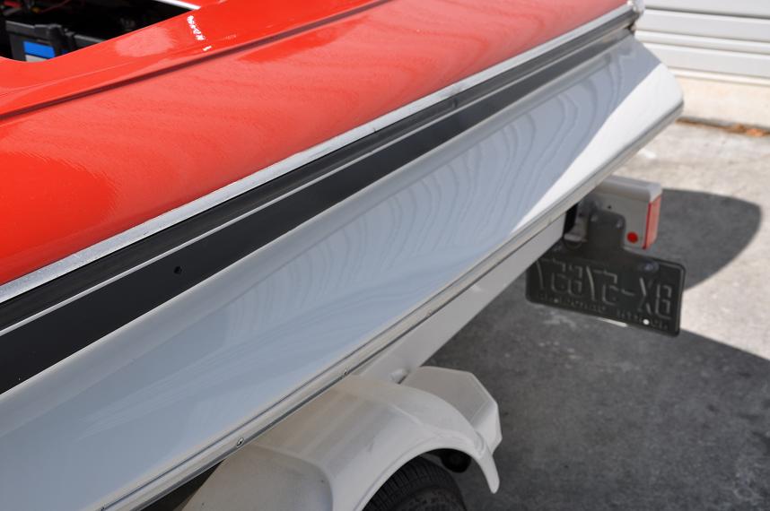

Jim:
As Al said, we tried polishing ALL of the hardware on our one-family owned 1960 G-3. While almost all of it came out excellent, the aluminum trim that runs along the edge of the sponsons did not.
I worried about HOW I was going to get that aluminum sponson trim to come out looking good again. Ours also had the "scratches and pits" you describe in some of your pieces.
I was initially told by a so-called "Glasspar Expert" that you could not plate or powdercoat these aluminum pieces on our G-3's
which was DEAD WRONG! Through a friend of mine who does ALOT of
metal refinishing and fabrication, I met a guy here locally who does alot of aluminum powdercoating. He looked at my sponson trim pieces and told me we could sand them down and then powdercoat them.
Jim, we started with 400 and went finer as the scratches and pits began to disappear. We finished with 1000 grit and then my powdercoater used several different bead blaster machines starting with rougher beads and working to finer as he went along. I am happy to report that the aluminum sponson trim came out GREAT! Those trim pieces have now been on the G-3 for over three (3) years with no problems whatsoever.
If you are interested in this please let me know and I can give you the name of my powdercoater near Wilmington, N.C.
Unfortunately, I don't have a "BEFORE" photo of the poor condition of the aluminum sponson trim, but here is a picture AFTER it was done:

Re:G3 Identification 12 years 8 months ago #90371
Good morning, thanks for the support regarding trim polishing. It's going good, just have to "Endeavor to Persevere". I've sander all pieces with DA or flap wheels to 600 then buffed with black and white compound to a good finish. Going to finish off with a green compound and Penetrol. As Dean said the remaining marks will add character.
Thanks again, Jim
