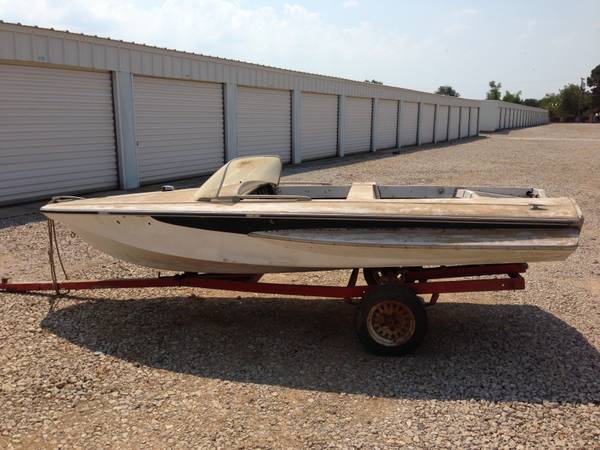

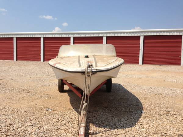

I decided to call her Lucky before I read the posts about the 59s. She was found in Texas without a title. It near impossible to get TPWD to issue a new title. Once i got to see her up close I noticed the Oklahoma vessel ID, hence the name Lucky. And the fact I got her for free when the Craigslisting asked for 285.00. I being born and raised in Texas had to Politely add my two cents. Letting the seller know of all the blood, sweat and tears I would have to let to get her back to even floating condition. And the Big Sweetheart gave her to me! For a promise to rebuild her. I will get her back. I promise and a real Texan will never remits to a promise. I might take a couple of years but she will look good again. Let me try to get pics of her on here. I have yet to get back to the storage and bring a flashlight to search for the Glasspar Serial number that will tell the tell. If any of you notice any tel-tel sign either way please reply. It will drive me crazy till I get back there Friday evening. Thanks Guys, See ya in the Creeks. The Lost Fisherman

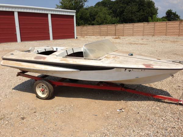

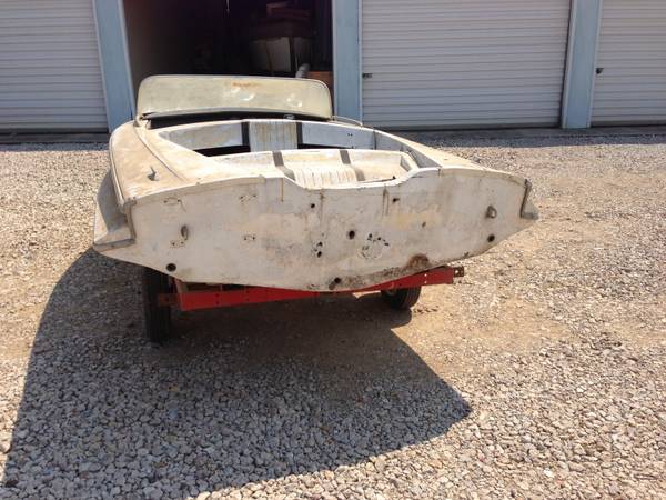

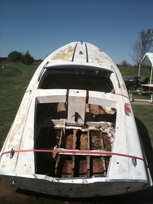

That's her Little Miss Lucky! Thinking Fighting Lady Yellow with the Dark Green stripes. And a Large Shamrock with her name on the stern beside the Jack Plate.
I'm Missing trim on top of the transom and the G-3 stars on her side anyone got extra Original?

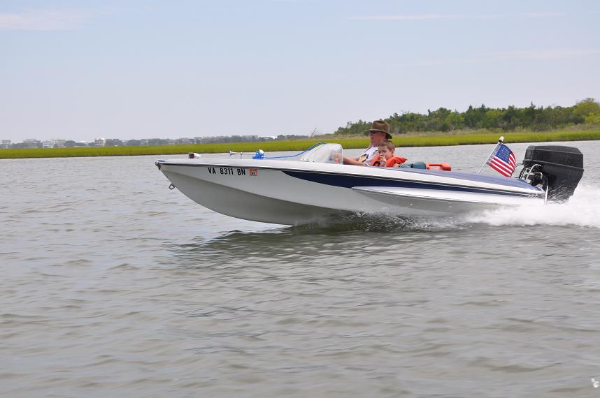

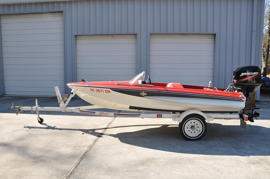

Here are some photos of our one-family owned 1960 G-3 which my Dad bought new for our family way back in 1959:

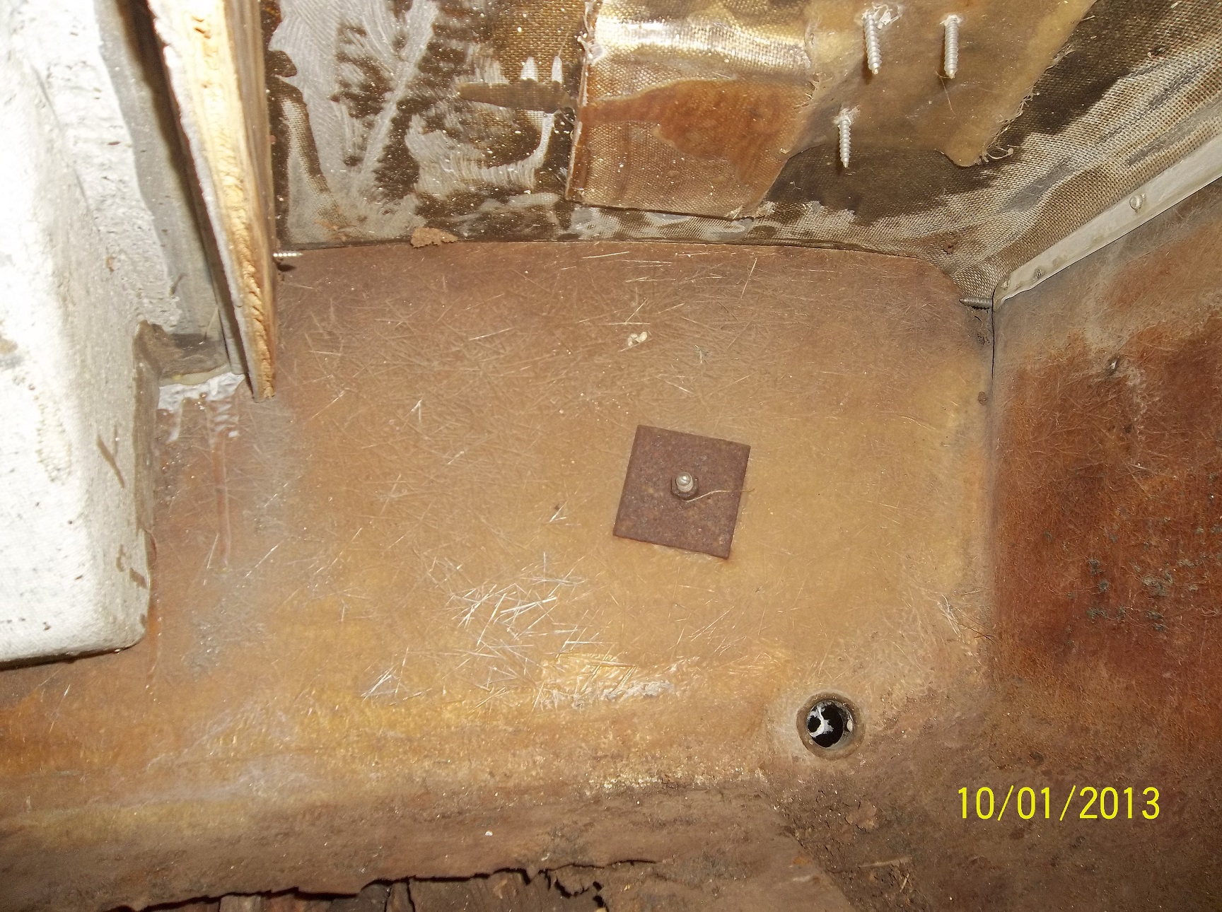

Back, I'll be dang still no HIN could be found. Heres the pics under the gunwale starboard then port. I can't even make the pic thing work i'll adjust the resolution.

ok wrong side but I got the pics working, now heres the starboard side

I reread Morris post and can see where I went wrong now I was looking the wrong direction. But here are two pics (maybe) of the center support No Number on it but there are several holes in it which might indicate a 60. Give it a look and see what ya'll think.

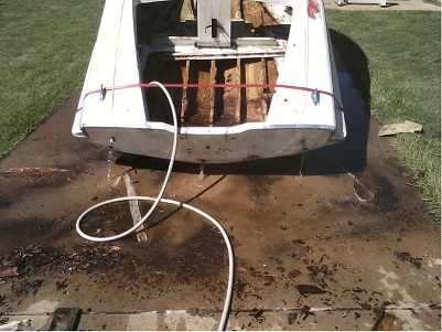

It looks like someone has done some very poor glass work. Unless it was the Glasspar dudes first day. Heck the way it looks under there he might have tied one on at lunch came back and worked on Lucky. Could have been his last day!
I started smelling a Copperhead and decided to clean Lucky out on the way to my shop in East Texas this weekend. Before I get back under there rolling around. Thanks for all the help! If anyone else has found there HIN in a hidden spot please reply. I'll make a list and find it for sure. Does anyone have a pic of their 59 G-3 HIN. If so please post it so I would at least now its shape. I think I've read its round.? The ones I.ve seen on other boats have all been retangle and in plan sight. The Lost Fisherman / aka Randall

Thanks for your kind words on our 1960 G-3! You should know that our G-3 was garaged it's entire life and NEVER sat out in the rain or in the water except when it was being used. Our Dad was hard on myself and my Brothers concerning this boat and to be honest that is why it looks like it does Sir. The red gelcoat on our G-3 is all original with the exception of a small area on the splashwell.
But, with a little elbow grease I know you can get your G-3 looking good too.

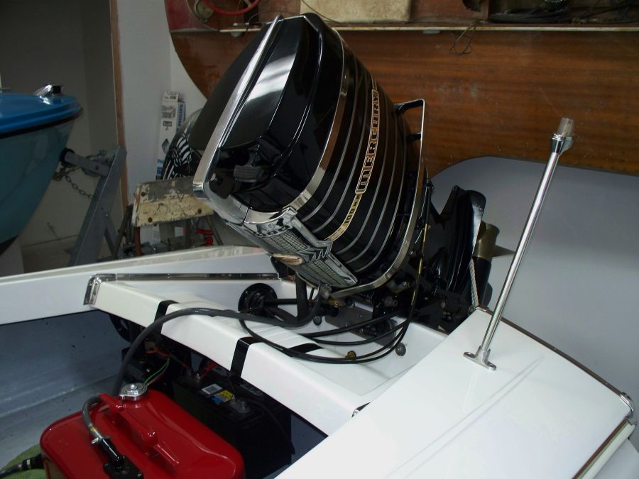

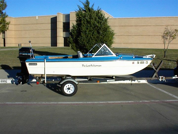

I really like your "Magnum Runabout!" It looks like you did a great job on it. You had also mentioned the jackplates for these older boats. I have a "Bob's Machine Hydraulic Jackplate" on our 1960 G-3. I didn't want to build up the transom and wanted a new outboard motor so that was why I went that route. I had several other Glasspar G-3 Owners tell me that a jackplate "would never work on my G-3" and that information was TOTALLY FALSE! It has worked GREAT on our G-3 and IMHO it has been one of the best
modifications I did to the boat. I can raise or lower it while I am driving the boat which helps alot for shallow water or high speed running. I will get a picture up here for you of how the jackplate looks in case you want to install one on your G-3 later.

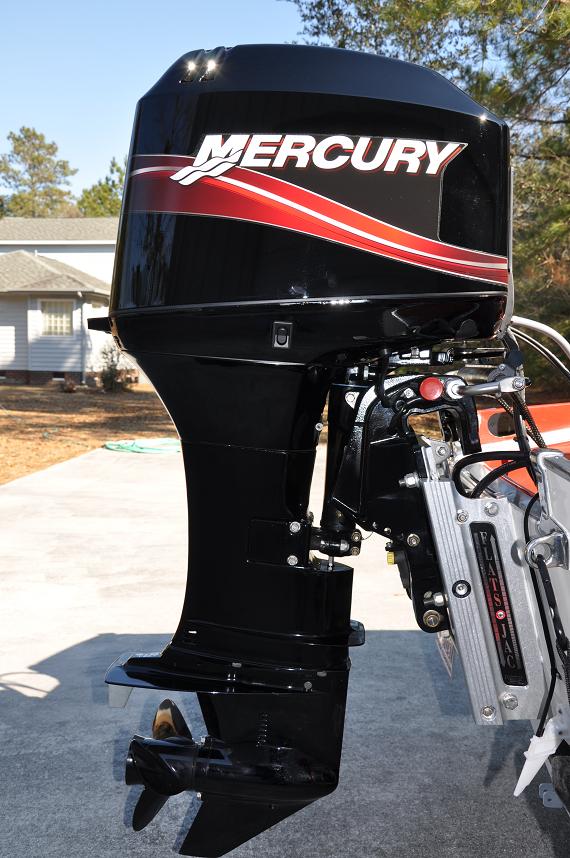

Randall:

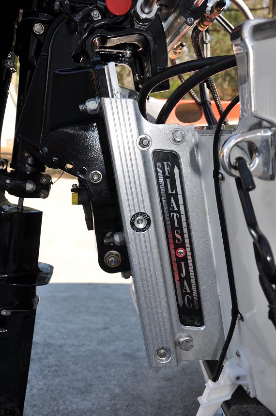

Here are a couple of photos of our jackplate on the G-3:
Randall, I liked this hydraulic jackplate because of the minimum
3 7/8" setback and low weight. It will take an outboard up to 115 H.P. and "Bob's Machine" down in south Florida has been GREAT to deal with.

John that is one sweet 60. I like the why the short jackplate looks on her. I will definitely use one on Lucky.
I was thinking of enclosing the splashwell. And making a high coaming across the stern that will turn the water back without a splash. An old trick used on low riding Kayaks. What I've heard from G-3 and Lido owners is the trouble backing their boats off the trailer or even trailering in a choppy water. They seem to overwhelming the splash or in the 60 Lido without the splashwell swamping the deck. Don't know, I will have to study it. The Jack Plate is a sure thing. I like the way it pushes you out of the hole and on to a plane almost instantly!

Randall, our "Mercury" is actually a 50 H.P. not a 60. But it can still run about 42-43 MPH with both my Wife and I in it with the motor trimmed up and the jackplate raised some also. Although alot of G-3 owners want to have the bigger engines we are pleased with the performance and mileage of our G-3 with this engine. Also, it is not placing alot of stress on the stock transom which is original to the boat.
You mention the splashwells on the G-3's and the tendency of the water to come over the back transom. On our G-3 with that Merc 50
we really don't have much of a problem with that as the motor only weighs 204 pounds. Now,....with that being said, back when my Dad bought the boat it had a 1960 "Johnson" 75 H.P. V-4 and with THAT motor we had water coming over the back! LOL! I think if you stay with a lower weight motor you will be alright.

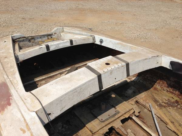

Got her cleaned out but no HIN anywhere! I took everything out. Cleared the dash, pulled both Aft tow loops even brushed the washers clean just in case but nothing! Looks like someone rebuilt the transom and bilge area. The port tow had a flat piece of steel instead on a washer it make me wonder? After looking and cleaning all afternoon Sunday I got tons of pictures of things to fix, redo, and customize, on Lucky. But first things first get a Title!
Any words of wisdom out there? Will The Coast Guard issue a new HIN if one was stolen? Just a thought! I LEAVE YOU WILL THIS IMAGE TITLED GETTIN THE JUNK OUT YA TRUNK!

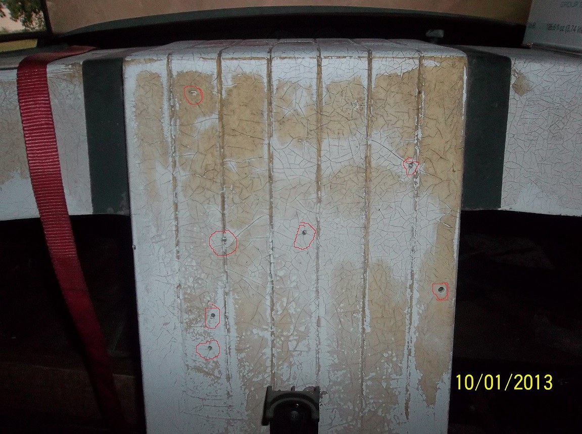

Thanks Dean, I looked for it everywhere the posts have suggestion and then some. all most 4 hours on my back removing everything. No number, someone must have taken it off planning to keep it in a safe place and forgot to return it. I have send an e-mail to the previous owner asking about the HIN.
Lucky appears to be a 60. I'll to get a pic showing the inside back of the center console where it had been cut out for attaching the Glasspar sig.
She not a 59 but still my next project.

Hey, I wanted to tell you that if your G-3 had that "Glasspar"
insignia across the back of the center deck support IT IS a 1960.
The 1959 models had them on the end of the sponsons, like it is on Dean's 1959 G-3. If you need one of those I think I might have one Sir!

Hey John, She Looks like a 60 I could see the center support plywood had been routed out from the inside for the sig. Must have had short bolts.

Hello Split, I looked through each hand full of junk pulled out for anything hard. I found almost 50 SS screws That once held in the deck. Nothing brass but I will keep an eye out Thxs for the heads up!
One thing I did think about and glad I did was to dump a gallon bottle of bleach in the hull just before starting my pressure washing. It worked it's magic. I alway forget my hand are flesh and wide up cut, poking, and stabbing them on something. Yeap, about a dozen different little cut and no infections. My work jeans really payed a price though! And she doesn't smell like mold any more Lemony Fresh. LOL, Ya'll have a Great Night.

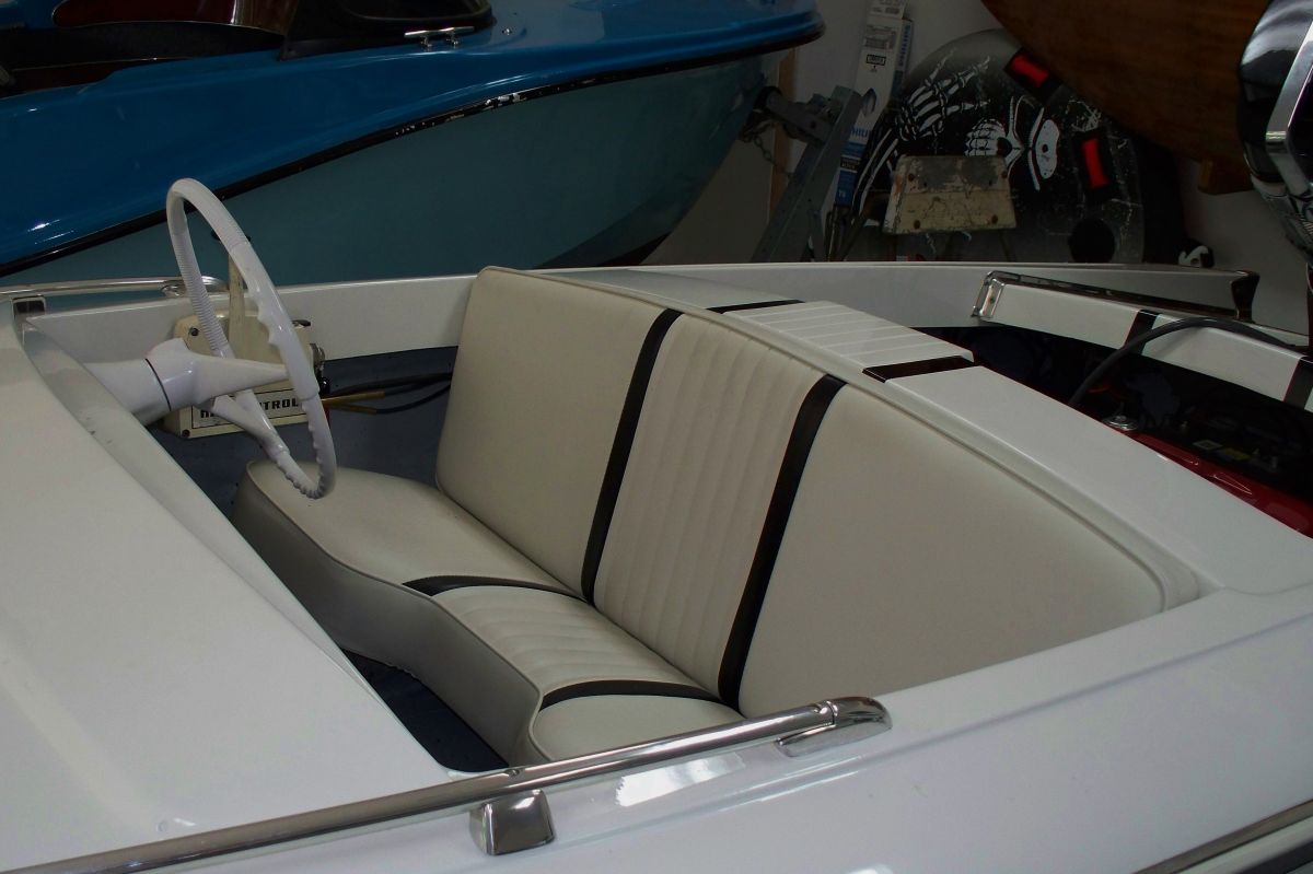

We also were lucky to find a 1959 G3 in Seattle. Here is a photo of the finished restoration. Congratulations and have fun with your new boat.
Re:Possible 1959 G-3 Found in TX 13 years 1 month ago #84903
RJW,
Your picture doesn't do justice to the excellent restore you did.
Hopefully you won't mind my posting some other pictures of it.

I'm thinking Double Merc 50s mounted on a pair of Hydro Jack Plates on Lucky. Do you think once rebuilt she can handle the weight?
I know can build a transom and stringers that can handle the power.

"Dr_Frankenmerc is that a 1973 1500XS on Wild Thinggg? A better question does it weigh 350#?
I'm thinking Double Merc 50s mounted on a pair of Hydro Jack Plates on Lucky. Do you think once rebuilt she can handle the weight?"
It is the same size & weight of a 1500xs, but is actually an '87 115 inline-6 power head with adi, high domes, tweaked reed stops, and 1500xs carburetors running .080 jets.
The last run was at 6200 RPMs, turning a 26p surfacing chopper at 65.9mphGPS.
The beast weighs somewhere around 270-290 pounds as a shorty with Merc PT.
I don't know if I have ever seen a G3 with twins. I'm not sure just how well that would work out. I think they would weigh in at about 130 pounds each, so weight wouldn't be of concern.
I'm betting that you might find that a single inline-6 would out-perform twins on a G3 - not sure.
I've seen G3s with v8-vee drive units, so why not twins. :-)
I attached a few pixs of a set of twin 400 Mercs I restored for my pal with a small power-cat.
When the twins are up and flyin' they sound awesome!!!
Doc F

I'm in the process of designing a double Hydraulic Jack Plate with trim. I have a few buddies in the machining business to help with design. With the weight of Twins around 270 it should be able to handle both weight and pressure at WOT. The look of the twins on one plate, just watching them raise, lower, and tilt would be worth trouble of building the plate. And the biggest Plus it's different no one on the lake will have anything close. I think I like that as much as bring these old beauty back.
I know you are right a single v6 would be hard to bet. And will be placed on her transom if I hit too many walls!
Thank you for your reinsurance on the weight, it was my biggest concern. Have a great weekend! I'm headed to the shop for the weekend to finish polish and assemble my 76 850 Merc. I'll post a few pics in the Mercury Outpost, if I git-er-done.
