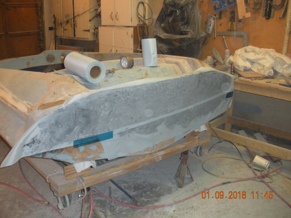

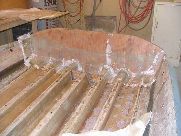

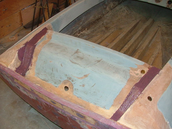

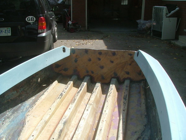

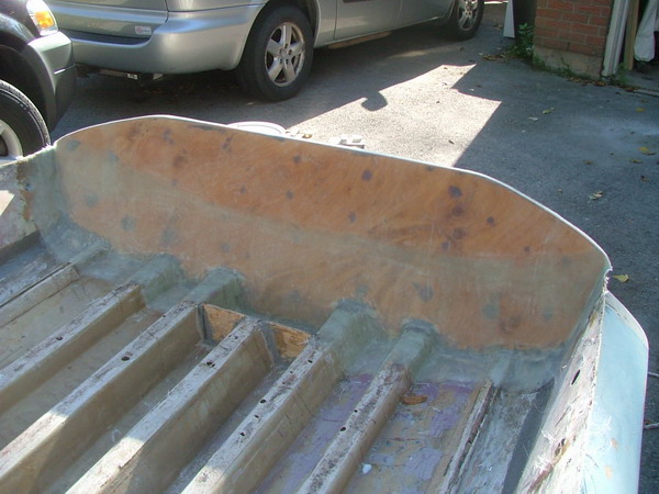

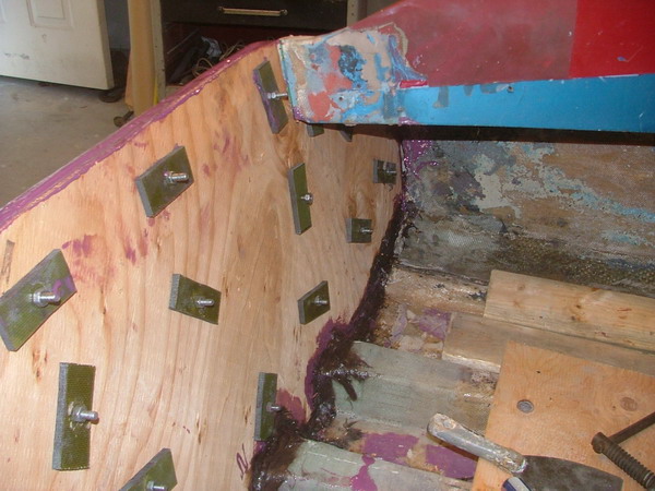

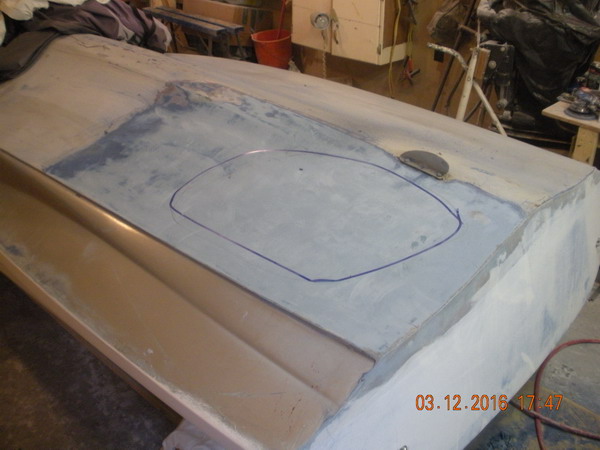

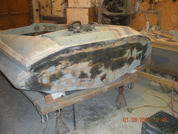

Finished up bonding in 4 plies 3/8 plywood in the transom . Then started sanding the down the paint to get to the gelcoat , three paint jobs and one had clear coat , try to sand but would have taken a week so I got the paint stripper out and got the paint of a lot quicker , finished with DA sander and 40 grit paper . This week will try to get splashwell bonded in a couple layers of glass on the transom and foam the floor stringers.
Will go back to same color when finishing , really like the baby blue and white original gelcoat.

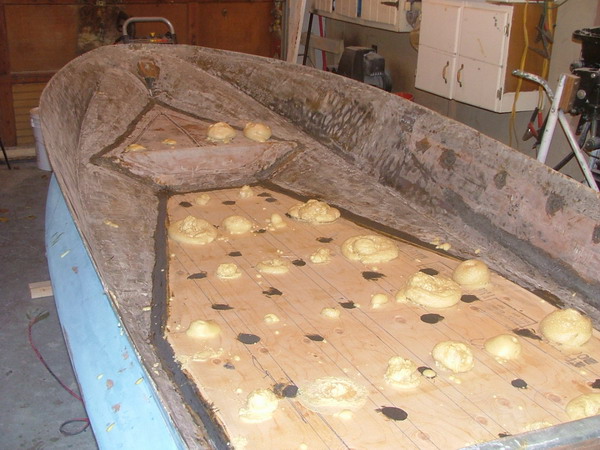

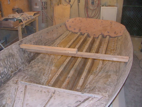

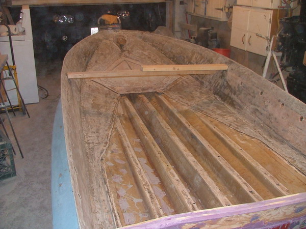

Split the deck and bottom on the weekend and started grinding the inside , two nights of grinding but finally got it done. Cut a piece of ply for the floor and will cover with cloth and epoxy .
Is it a good idea to fill the stringers with foam to make them stiffer , plan to foam floor after install and also fill the side sponsons with foam.

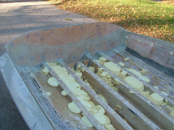

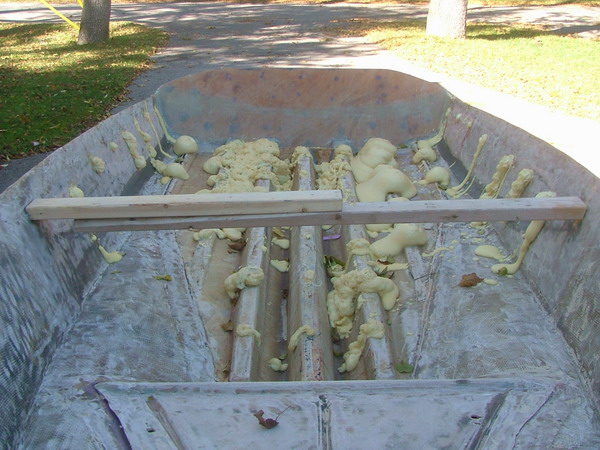

Trying to take advantage of the warm weather I was able to get a couple layers of glass on the transom
Also got a layer of epoxy and glass on the lower part of floor.
And then I got the foam poured into the stringers and sponsons . Tomorrow I hope to get the floor glued down.

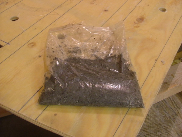

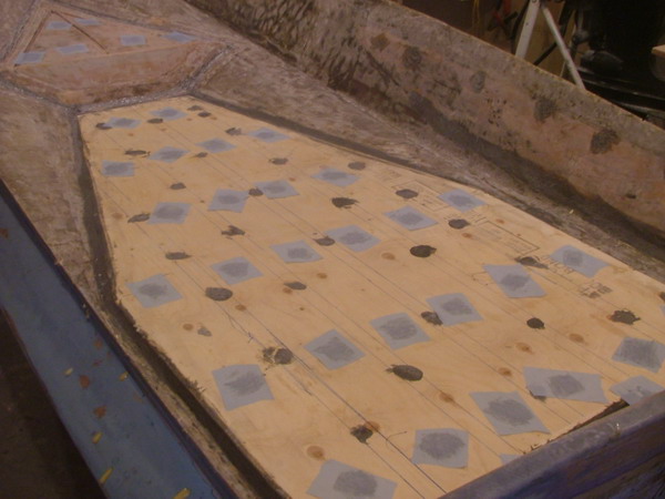

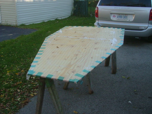

I got the floor and hull all ready for gluing down , mixed up a batch of epoxy with milled glass and milled carbon fiber and put it in a plastic freezer bag cut the corner and used it to spread on formers to glue floor down
then I screwed the floor down and cover screws with the resin and fiber let the resin harden then poured foam to fill any gaps under floor
when the foam cured I shaved off the excess and cover with resin and fiber . Next step will be to cover floor and any week spots with resin and cloth and get ready for paint

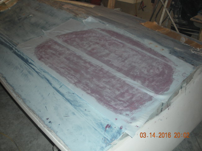

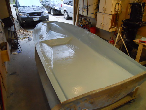

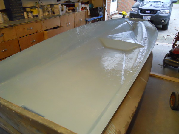

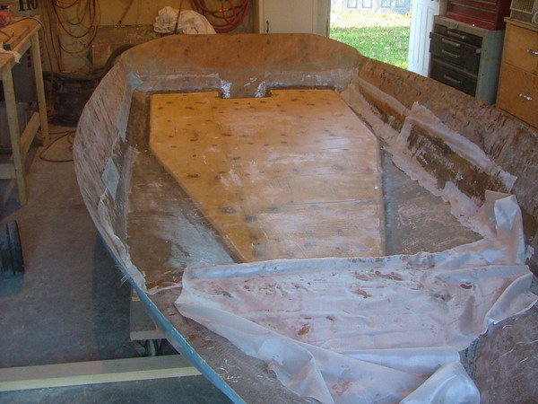

I got a couple layers cloth and epoxy layed up on the floor and covered with some peelply last night.
Came home today removed peelply and preparing to apply a couple coats of grey epoxy tomorrow .

Just finished getting a couple coats of polyurethane paint on the inside , was going to paint grey as I get expired paint from work but I added a little blue to see what color I could get . If I add a little more blue this might work for the outer hull very hi gloss paint when finished .

Hi Talbot
How I did it was I used four layers 3/8 plywood and I glued one layer at a time and let it dry over night before continuing . In the pictures you can see I waxed up about 20 1/4 inch nuts and bolts and made some flat squares so I could bolt each layer of wood and sqeeze out the excess resin , the first layer took the curve of the glass transom and each following layer easily took the curved shape.
Hodgify

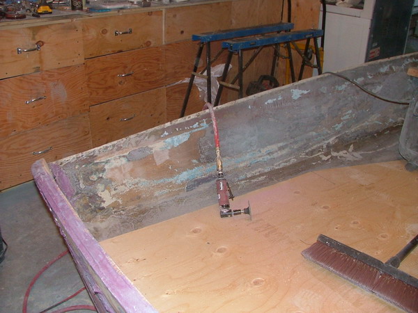

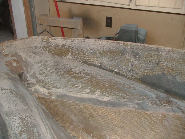

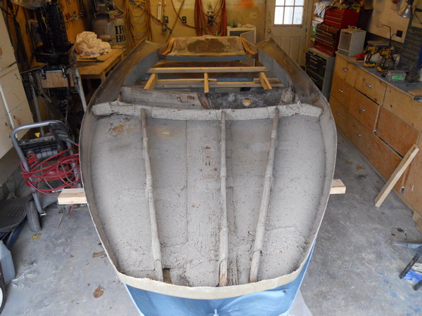

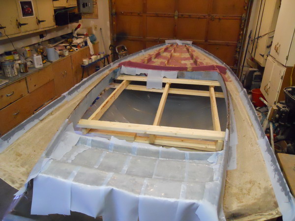

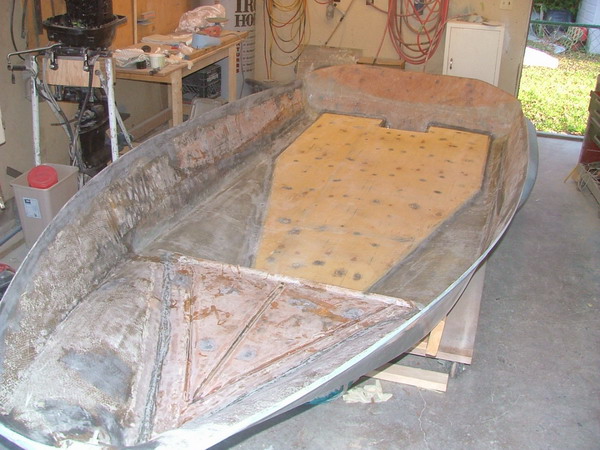

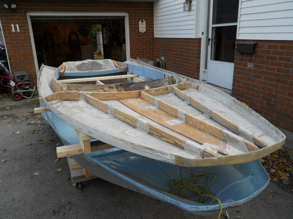

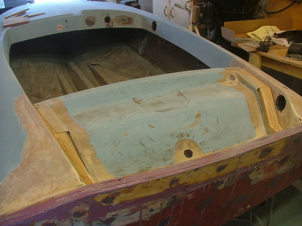

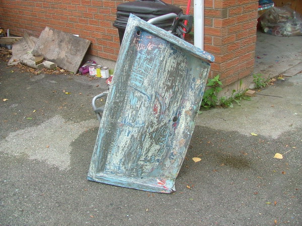

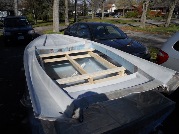

Started work on the deck today , all the bracing under the deck had come loose and made the top real flimsy , so before flipping to do the repairs I made some bracing while sitting on the bottom so it would keep the shape.
After flipping I ground all the loose bracing and cleaned all the wood so I could add more glass and resin and repaint before reattaching to the lower half.
after cleaning

Thanks hodgify, and sorry for the weird typo with you screenname. Gotta love auto correct. What is your method for flipping the deck?

Hey Talbot that's ok about the name. Flipping the top was pretty easy , even with the 2x4 bracing my son and I were able to just turn it on its side and then just roll it over. I think the trick will be when I rejoin it to the bottom and have to turn it in one piece, good thing I have two strong sons and a couple nephews that are always happy to lift and roll.
Hodgify

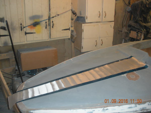

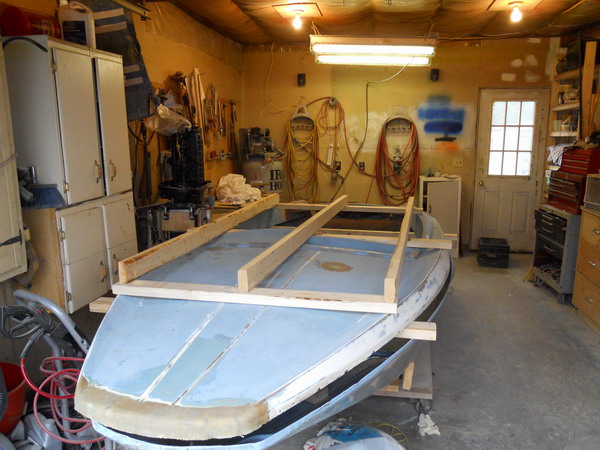

Got the inside of the top all reinforced with glass and epoxy resin then covered with peel ply and let dry
after full cure I pulled the peel ply and sanded were required so I could paint
Finally applied two coats of poly paint and let set for awhile , then applied Zolatone textured paint and am letting dry.

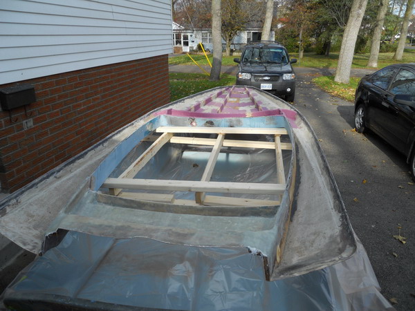

Came home from work early today and I got the top flipped over and then drilled some new rivet holes and installed clecos to holed things together , fit together perfectly happy I made the frame to holed the top rigid while I did the inside glass work . Now time to get started on glassing the transom and splash well.

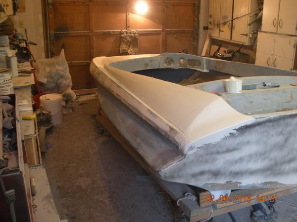

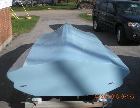

Has been a little slow working on the hull , have got some glass work done to the deck and started some filling and sanding . Also got a set of seats for fixing a friends transom and I am making some terry cloth covers for them as I will not be able to get them done with vinyl this year , might even look for a walking foot sewing machine so I can give it a try on my own . Also want to be able to make my own covers , heres a couple pictures

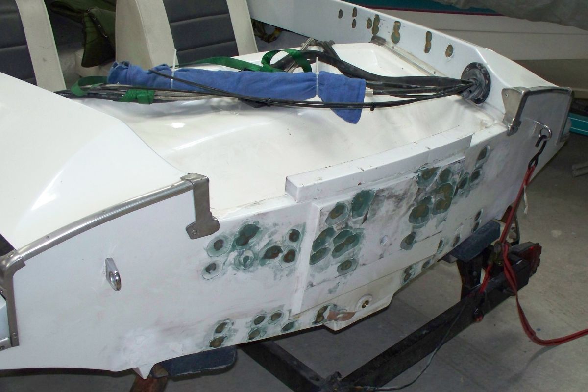

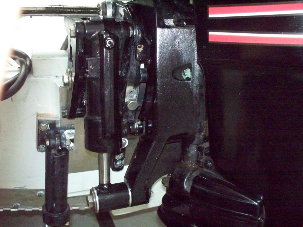

The reason I ask is since the transom has a curve to it, you may want to make a flat area on the aft side of the transom that is wide enough to give the motor a flat surface to fasten to.
I have attached a couple of old file pixs of what I added to Wild Thanggg to give the inline-6 Merc with power trim a flat surface to fasten to.
doc
Re:My 65 G3 Winter Rebuild 10 years 4 months ago #119728
  • hodgify
  • hodgify's Avatar Topic Author
  • Senior Boarder
  • Senior Boarder
  • Posts: 163
  • Karma: 8
Hey Doc thanks for the advice . I hope to be putting a 1978 90hp Tower of power that I rebuilt last year . I will be making a jack plate for it similar to the one I made for my 3 pointer but will bend angle to allow for curve of transom . My question for you is I see Wild Thanggg has a pad and other mods to the hull , did they help handling and top end speed and do you have more pictures of the mods. As I will soon be flipping and starting on my hull and may still want to do a pad if it will help handling and speed.
Thanks Hodgify

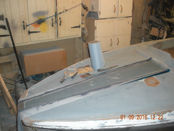

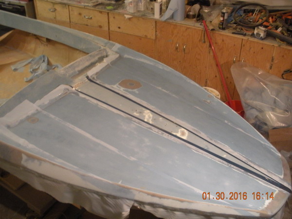

Got the deck all sanded and ready for prime . Hope to get a couple coats on tomorrow and then will let it sit for a week or two before flipping and starting on bottom . Used two types of filler , Not to impressed with the way the NAPA filler went on . The Axon filler was great to spread and sanded real nice.

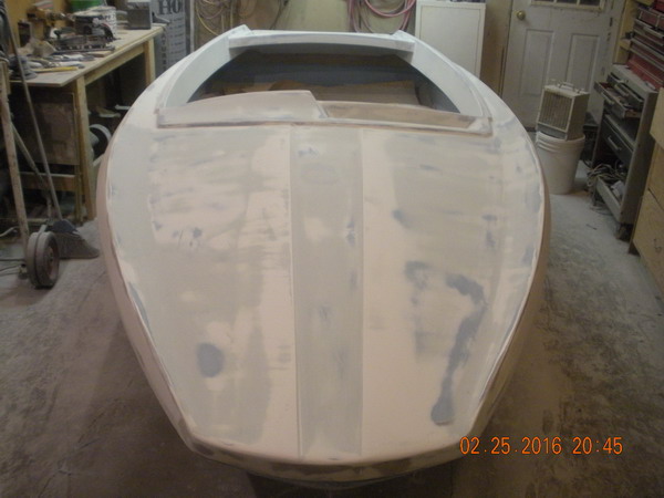

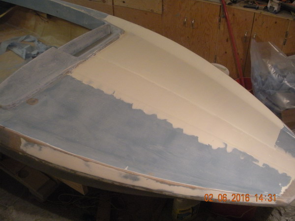

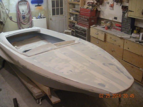

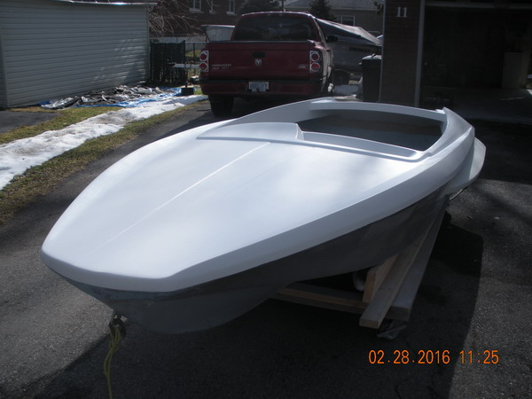

I got three good coats of Tempo epoxy primer on the deck Saturday ,looks smooth and lines look nice and straight . Will let it cure for the week and hope to flip it next week. Nice 50 degree weather so I got the hull out of the garage to clear some fumes and take pictures.

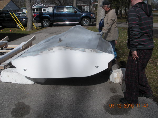

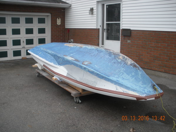

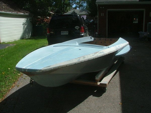

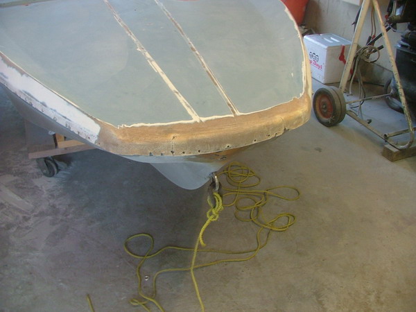

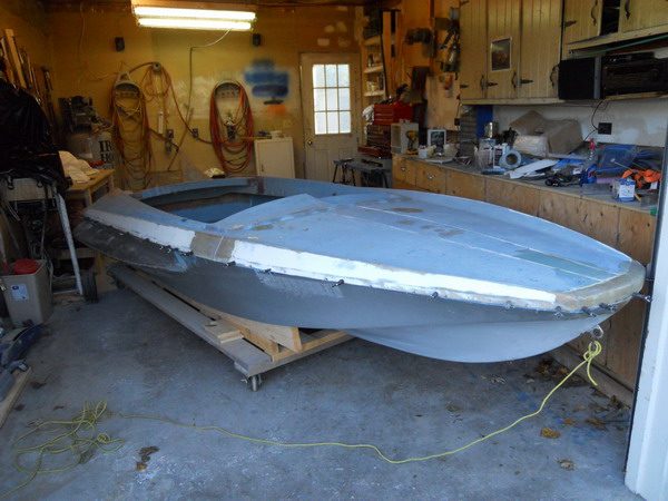

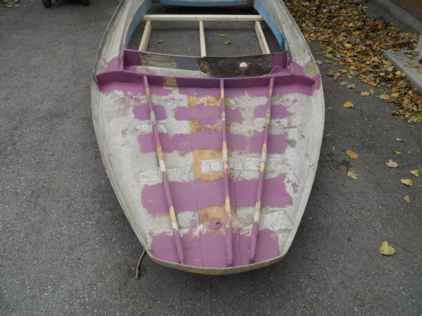

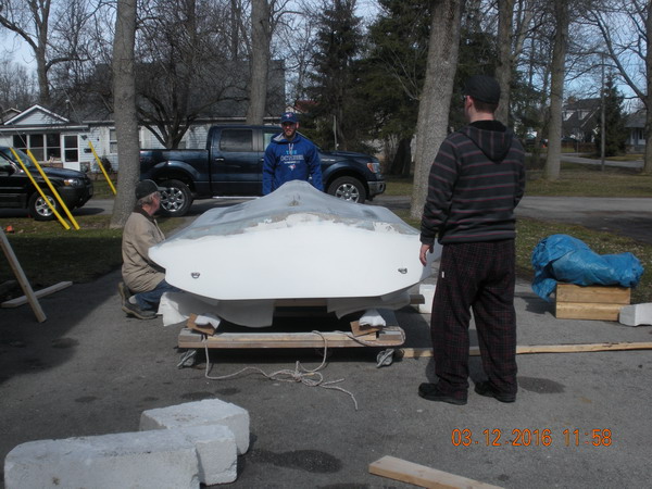

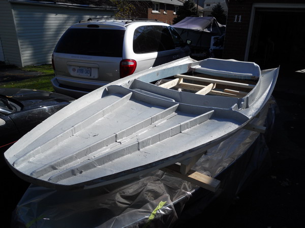

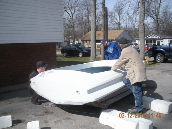

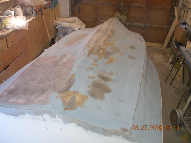

Today I was able to get my sons to help flip the boat so I can get started on the bottom . Pretty easy to flip with the three of us ,heres some pictures
then I put a couple of 2X6s across my wagon and then lifted the hull on to wagon
Started right into stripping layers of paint so I can get it in water before summers over.
While stripping paint I noticed one area that blistered up from when I poured the foam . Plan to cut out and replace the area . Anybody see a need for the fin or was this some ones attempt to make the boat turn better
Re:My 65 G3 Winter Rebuild 10 years 3 months ago #120661
  • hodgify
  • Senior Boarder
  • Senior Boarder
  • Posts: 163
  • Karma: 8

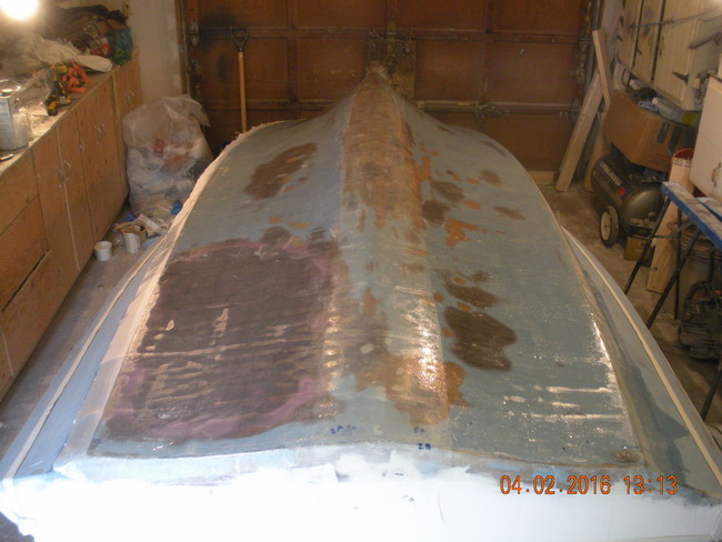

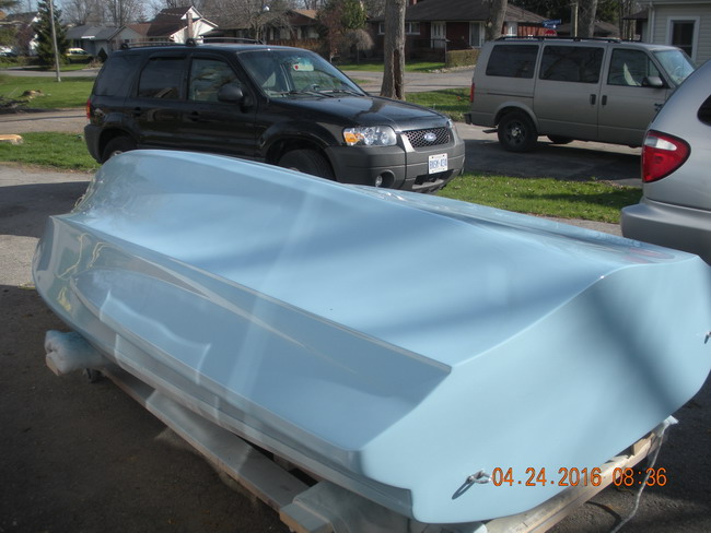

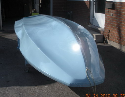

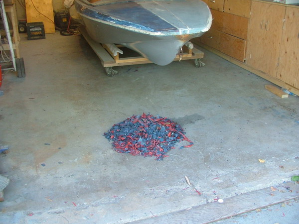

Instead of a lot of sanding I got a gallon of paint stripper and used it this morning to get 5 to 6 layers of paint and primer of the bottom and then washed it down with water to neutralize the stripper , saved a lot of sanding and cost of sand paper .

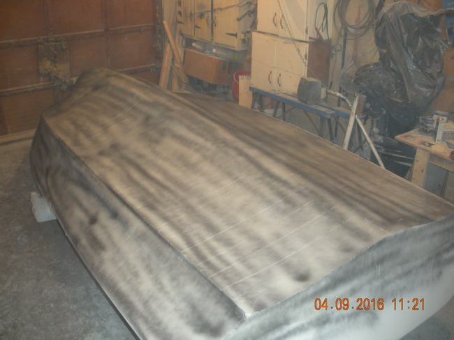

Re:My 65 G3 Winter Rebuild 10 years 3 months ago #121078
  • hodgify
  • Senior Boarder
  • Senior Boarder
  • Posts: 163
  • Karma: 8

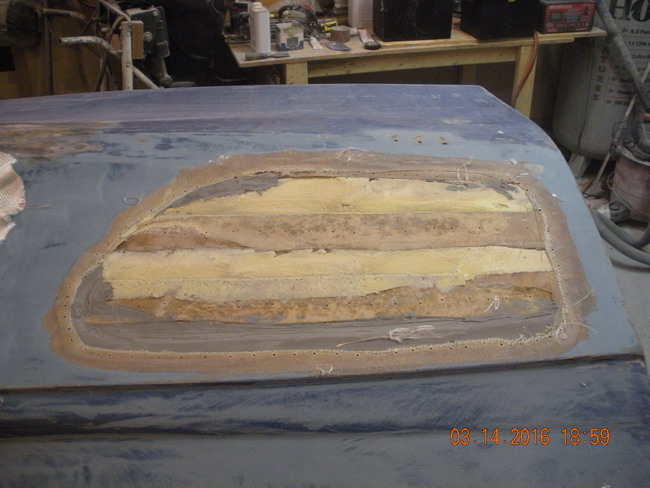

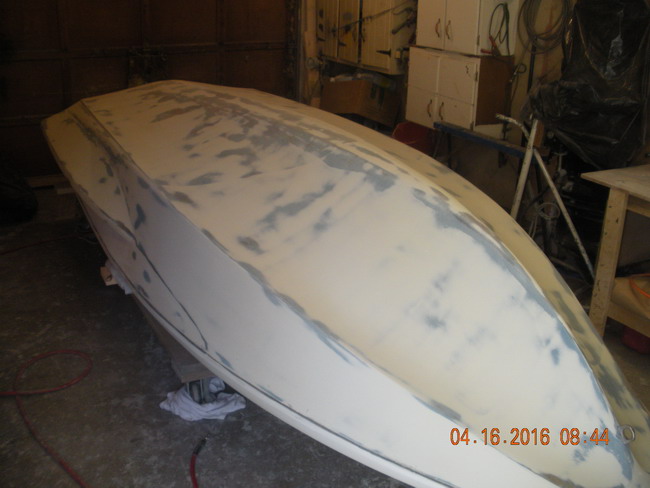

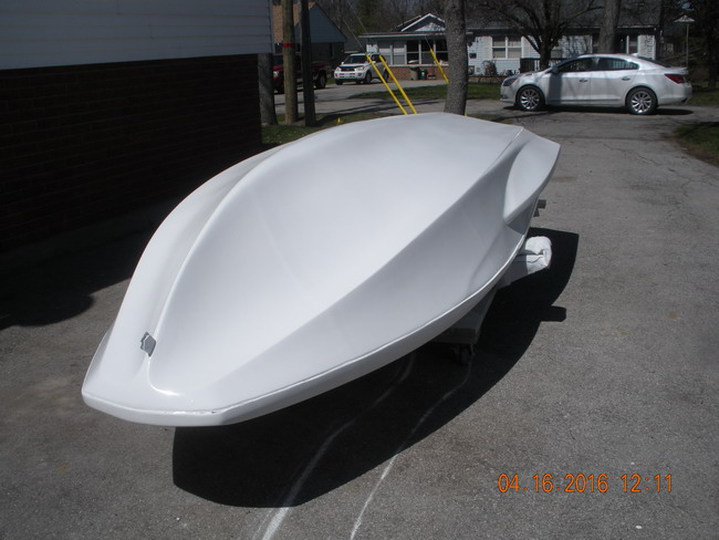

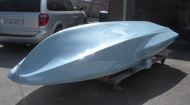

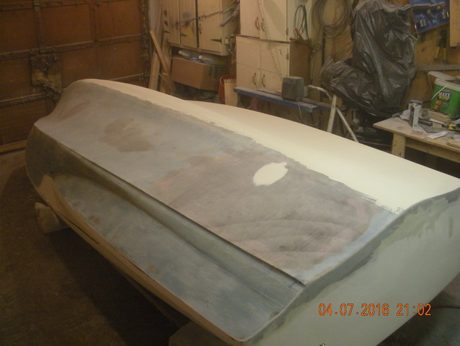

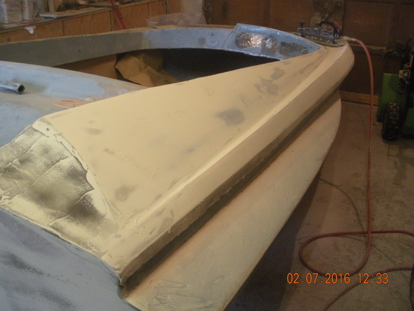

Happy to have site back up , missed coming and reading every ones comments on all the other forums ,I was able to get the bottom of the hull all glassed heres some pictures.

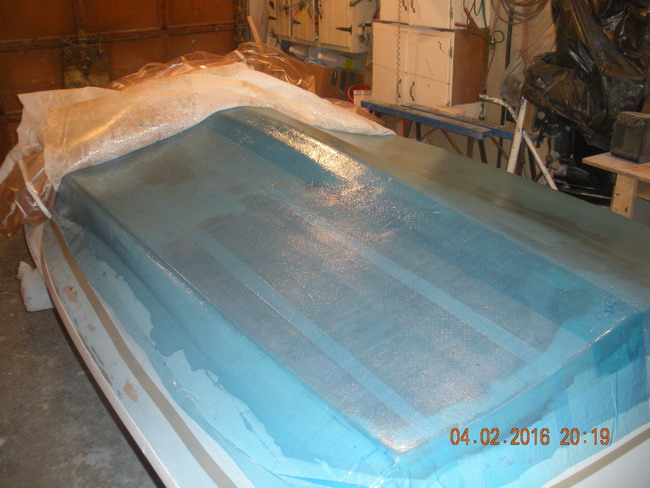

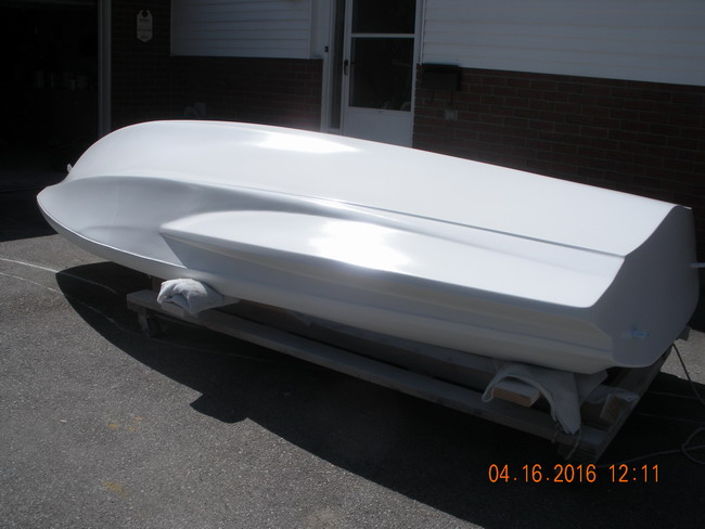

Had to cut out where the foam over expanded the hull ground the foam and applied layers of new glass
After the repair I sanded the hole bottom with the air long board and repaired any other bad spots

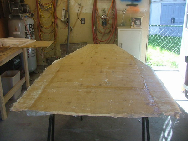

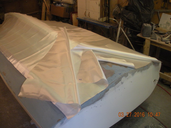

Cut two plies of 7781 fine cloth to cover the hole bottom
Then using West systems epoxy resin wet out the two plies of glass
Before resin cured I applied a layer of peelply and vacuum bagged the bottom and let cure overnight
next morning removed vacuum bag to reveal a nice void free surface. Hope to get to the two side pods this week and then sand and fill with bondo.

spent the last couple days sanding the bottom with 40 grit sand paper on an air long board so bondo well stick
then mixed alittle polyester resin in the bondo so I could spread a nice even coat to the complete bottom
and just finished spraying some flat black primer guide coat so I can start sanding and get it nice and straight

Spent the last week sanding with the long board trying to get the bottom as smooth and straight as possible
then got up early this morning and got three good coats of polyurethane prime on the bottom and now have it out in the sun baking the primer dry.
Will start sanding to get it ready for paint next Saturday

I got the hull all prepped and ready for paint last week and then got up early Saturday and got four good coats of polyurethane paint sprayed on the bottom , one or to runs that I will sand and buff out but got a nice shine . Will let it set up for a week and then flip and get the top painted .
