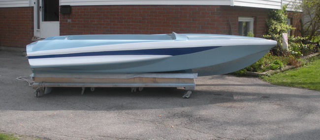

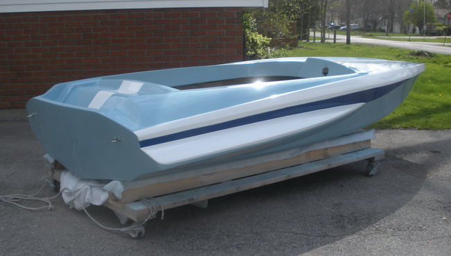

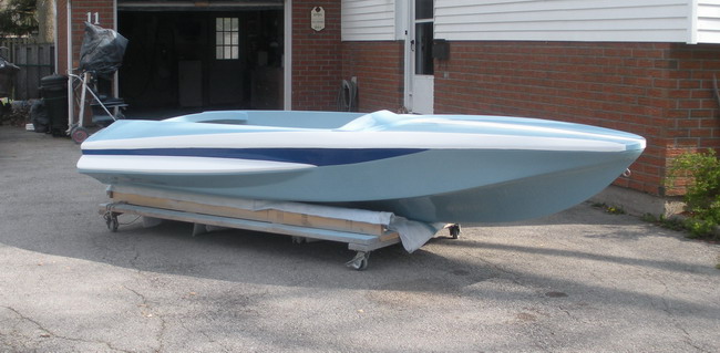

I got the hull all prepped and ready for paint last week and then got up early Saturday and got four good coats of polyurethane paint sprayed on the bottom , one or to runs that I will sand and buff out but got a nice shine . Will let it set up for a week and then flip and get the top painted .

Holey Moley Hodgify!!!
She is looking AWESOME!
I'm looking forward to the finished project!
Momma's '66 G3 had a similar color blue deck underneath all the paint jobs back when we rebuilt hers.
Thanks for posting all your progress!
Very cool!
doc F

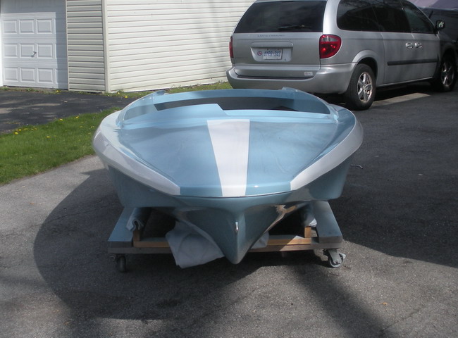

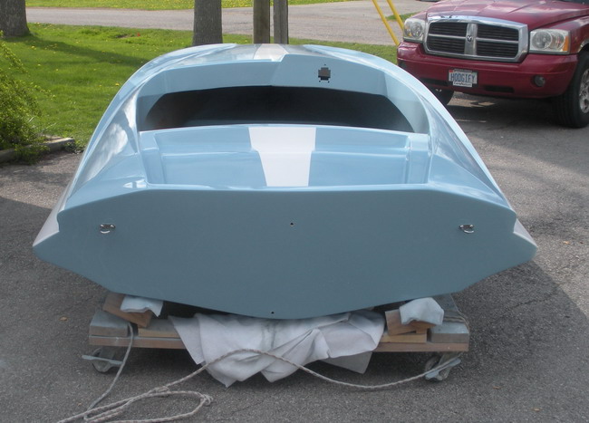

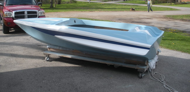

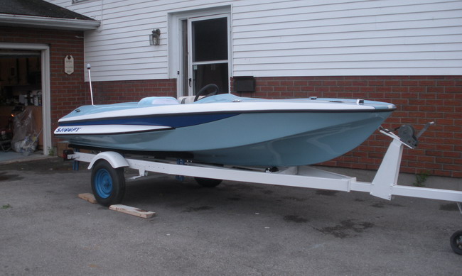

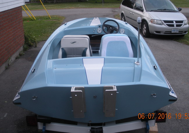

Got the painting finished last night and came home from work today and took some pictures of the results . Will let sit for a day or two and then will start putting it back together.
Re:My 65 G3 Winter Rebuild 10 years 5 months ago #121972
Looks great!

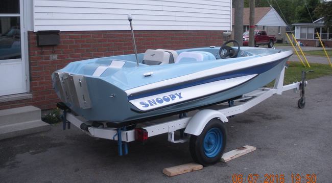

Had the trailer sand blasted and painted and pulled the boat on the trailer. Starting to install hardware , made the motor mount and finishing up the wiring. Had a friend give me a boat that has a 150 tower that has not run in two years but was winterized before storing , will try tomorrow to get it started .

Thanks Gene Hooked a battery to the tower tonight turned the key and choked it and it fired right up . Got it of the boat and repainted ready to install tomorrow . Wiring from the control box to the motor was pretty bad and will have to replace most of the wires .Hope to get everything finished for a launch next weekend.

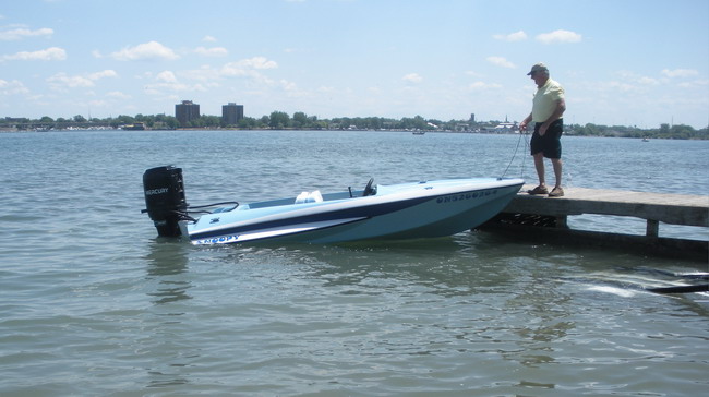

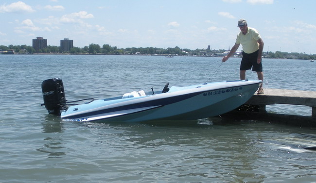

Got Snoopy wet for the first time today . Motor ran ok although I was only getting about half throttle and that was with pushing down full on the hi speed idle stick . I either have a bad cable or screwed something up in the control box , will look later when it cools down. Here are two pictures sitting in the water .

She looks great in the water!
"Motor ran ok although I was only getting about half throttle and that was with pushing down full on the hi speed idle stick."
You shouldn't be able to speed up the engine in Forward gear or Reverse by using the small high idle lever. That should just work in Neutral.
It is possible that either the spring loaded button that should keep the small lever down in gear might be worn out - or something else is fubar in the control box.
Dis-connect the control cables at the motor and see how the control box works then.
Lots of other things come to mind, but I'd start there.
doc

Thanks Doc , took the box apart today and found that the cable was binding at 3/4 throttle not in the best condition , will order a new one Tuesday will check the spring and clean up the box . Cannot do to much to it this week trying to get a pontoon boat ready to take north next weekend .

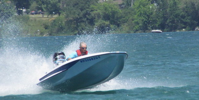

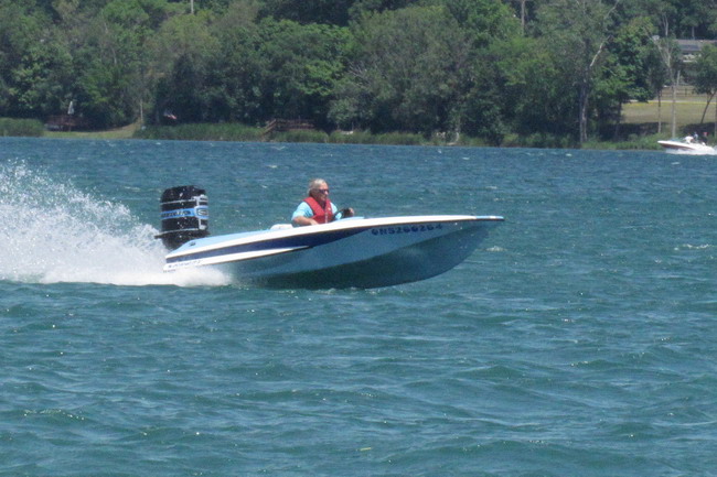

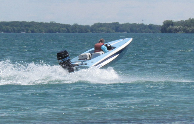

" WOW " had a problem all week no spark thought it was the switch box , but I read some old posts and read a lot about the trigger so this morning a switch out distributors and instantly had spark again , old distributor was pretty green inside , also got the tilt and trim working . Took it out for a quick ride and had the wife come and take pictures . Real rough and windy so I could not really open it up and motor needs to be jacked about 1 or 2 inches . Was a wild ride like the 150 but I think after the summer I will look for a nice 75hp , think it will make it alittle less wild but still a lot of fun.
Heres some pictures
wife had trouble keeping up with the camera
one more , top speed today 46mph but way to rough

Very cool pictures!
Makes me want to bring ole Wild Thanggg back to life.
You will find that the 4 cyl 75, 80, or 850 will be a perfect match for the G3.
The OMC 3 cyl 75-85 would also be a good candidate, but I'll deny I said anything nice about an OMC.
doc
