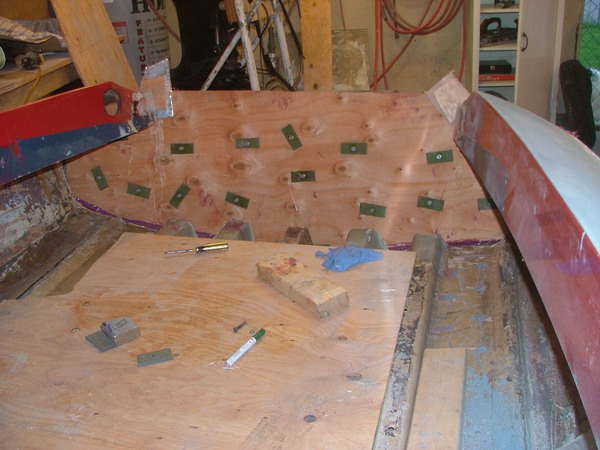

Started work on my 65 G3 restore this weekend . Cleaned the transom ready for new wood , using 4 layers of 3/8 ply that I have pre bent .Using aircraft grade epoxy resin to bond wood to glass ,applied resin and 1 layer of glass to the wood and wet out the transom with resin , placed the wood and am using 12 bolts with blocks to attach wood to hull , will let this cure and apply another ply of wood each night until I have the for plies.

Finished up bonding in 4 plies 3/8 plywood in the transom . Then started sanding the down the paint to get to the gelcoat , three paint jobs and one had clear coat , try to sand but would have taken a week so I got the paint stripper out and got the paint of a lot quicker , finished with DA sander and 40 grit paper . This week will try to get splashwell bonded in a couple layers of glass on the transom and foam the floor stringers.
Will go back to same color when finishing , really like the baby blue and white original gelcoat.

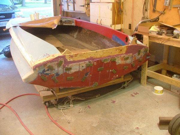

Split the deck and bottom on the weekend and started grinding the inside , two nights of grinding but finally got it done. Cut a piece of ply for the floor and will cover with cloth and epoxy .
Is it a good idea to fill the stringers with foam to make them stiffer , plan to foam floor after install and also fill the side sponsons with foam.

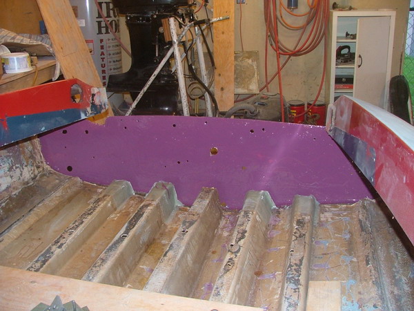

Trying to take advantage of the warm weather I was able to get a couple layers of glass on the transom
Also got a layer of epoxy and glass on the lower part of floor.
And then I got the foam poured into the stringers and sponsons . Tomorrow I hope to get the floor glued down.

I got the floor and hull all ready for gluing down , mixed up a batch of epoxy with milled glass and milled carbon fiber and put it in a plastic freezer bag cut the corner and used it to spread on formers to glue floor down
then I screwed the floor down and cover screws with the resin and fiber let the resin harden then poured foam to fill any gaps under floor
when the foam cured I shaved off the excess and cover with resin and fiber . Next step will be to cover floor and any week spots with resin and cloth and get ready for paint

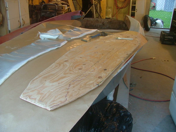

Started work on the deck today , all the bracing under the deck had come loose and made the top real flimsy , so before flipping to do the repairs I made some bracing while sitting on the bottom so it would keep the shape.
After flipping I ground all the loose bracing and cleaned all the wood so I could add more glass and resin and repaint before reattaching to the lower half.
after cleaning

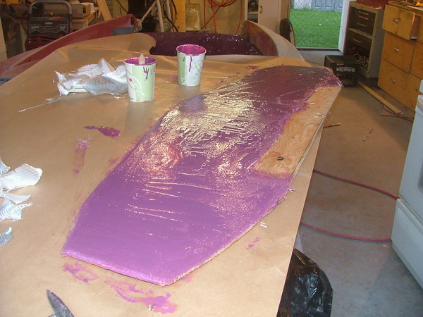

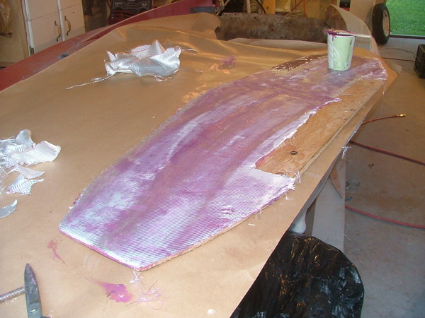

Got the inside of the top all reinforced with glass and epoxy resin then covered with peel ply and let dry
after full cure I pulled the peel ply and sanded were required so I could paint
Finally applied two coats of poly paint and let set for awhile , then applied Zolatone textured paint and am letting dry.
