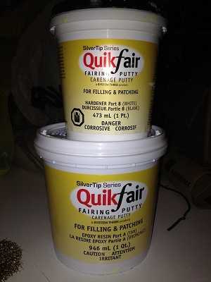

My boat had many dents and dings in it which I filled with an epoxy filler i got at the local marine supply store. "Quick Fair" fairing putty.

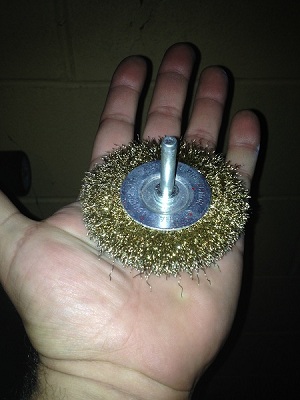

Also took a wire wheel drill attachment to all of the rivets and sealed all seams with Gluvit.
