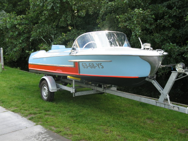

Hello there,
does anyone of you know the brand Spiboot?It is made in Switserland in the fifties/sixties and I have 2 of them. One just restored with a 40hp outboard and a new project with a 88hp inboard 2 stroke omc. For I know these engines where only produced for 2 or 3 years.It looks ok and I am mounting it together so I can start the engine and see if I keep this one or fit another engine.
Martin
Amsterdam Holland

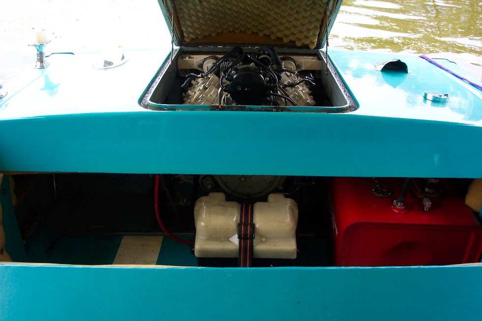

and this is the new one.
Re:Spiboot 13 years 1 month ago #84632
welcome aboard martin, very nice lummies.
(aluminum boats.
Re:Spiboot 13 years 1 month ago #84637
  • frog
  • frog's Avatar
  • Posts: 1431
  • Karma: 59
  • Thank you received: 3
martin, very cool looking boats. glad they are not close as I would have to have one. never heard of them before, but some one here will have info for you. frog
Re:Spiboot 13 years 1 month ago #84691
Welcome aboard Martin, great to see you over here. Gotta agree with the guys, very cool lummies! I've not seen anything like those on this side of the pond, but maybe one of the gang with more background here will be able to lend a hand?
Re:Spiboot 13 years 1 month ago #84704
tinus,
WELCOME ABOARD.
NICE boats!

Thank for the warm welcome. I will keep you updated with the progress of the second(red) one.
We now have installed the engine and z drive, connected the wires and next thing is to start it up. Hopefully it will run good.
If anyone knows more about these first inboards from omc and knows where to get parts,I would really appreciate that.
For now I need a lower engine mount and off course as much info as possible. Engine type is DU11-R.
Martin

Re:Spiboot 12 years 7 months ago #92032
I just stumbled across this posting today. Thanks Mark for the good word. I've been out of the business since November. A great relief to be sure. I'm now the parts manager at the Chrysler/Dodge/Jeep/Ram dealer in Rhinelander, WI.
As for the old 2 stoke DU drives;
They were made from about 62 thru 68. There is a bit of confusion exactly when because models years are introduced the year before. Most were put into OMC built boats. To be honest the only one I can recall ever seeing in person that was in a non OMC built boat is mine (the Shell Lake). I have however seen catalogs showing them as options in several brands of boats.
They were built with and without oil injection. I believe the 1st ones were the 88 HP with injection and later ones were 90 HP without. I was told that the timing belt drove the oil pump and was subject to failure. I do know that the timing belts were different part numbers, so that seems reasonable.
As for your motor mount, There were several models of transom mounted OMCs that used the same type mount. Yes, transom mounted. Some of the 2 stroke DUs hung from the transom and did not touch the floor. Actually, I think the mount as shown in your picture was early production units only. Mine has all four mounts thru the transom and no big bracket going forward. There were several years of V6 and V8 "stringer" models that actually had 2 different engine mounting options. Some had floor mounts only, front & rear. Others had transom mounts and a forward motor mount. I believe the motor mounts (rubber sandwich partion) from any with a transom mount will fit. These were used until about '71 or so when they all became floor mounts only.
Jim
