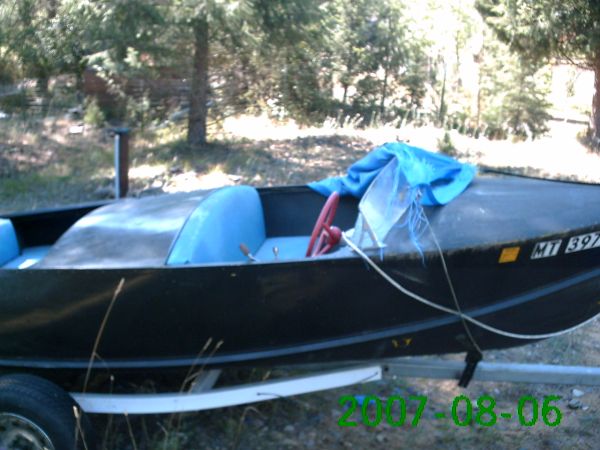

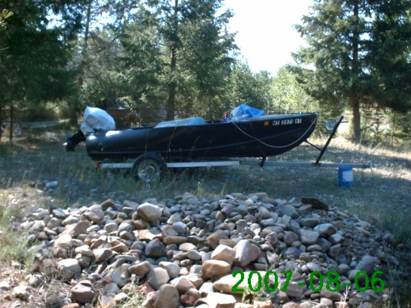

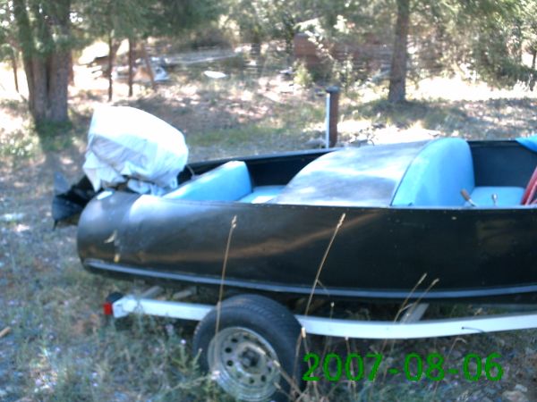

found one on CL that's along the lines of what i was thinking. it's just way too far away to even consider getting. i robbed a couple pics though, to give an idea.
did boats like this (dual cockpit) come with a walk through section in some models? is it possible to put one in if not? i'd be interested in being able to get front to back without climbing on top of the thing. or is that considered sacrilege?

That black Montana boat looks like a FeatherCraft Deluxe Runabout with a longer middle deck. I looked through all of the recent Montana Craigslist ads and could not find this one. Could you post the URL?
FC made several walkthrough models in the 14-16 ft range. Most of the catalogs can be found at Feathercraft.net

Well, you are aware of the variables. Condition, location, market all factor in. One other variable is how much do you want it. This looks like a Deluxe Runabout with a modified middle deck. To me the deck and the fact that the boat is painted black are warning flags. It is difficult to judge condition based upon these photos, but paint and fresh metal could be masking something.
If I were to guess, I would say $500-$700 based on what I see in the ad.
