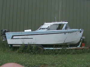

Lone Stars are great boats. I have a '60 El Dorado myself. Very well-built, roomy cruiser. Have had 2 others as well.
Like Handy Andy said, try to ascertain if the rivets are tight and if the trailer will get you home. Mine had 8" of water in it with no drips, so I knew it would float ;) . Also check to see if the transom is solid by rapping on it with your knuckles or a small hammer. You want to hear a consistent "solid" sound throughout. Even if it's shot, don't worry. Transom (or floor) on an aluminum boat is easy to replace compared to doing one on a fiberglass boat.
I would get it if I were you! Show some pics.
Here is mine "as found".
