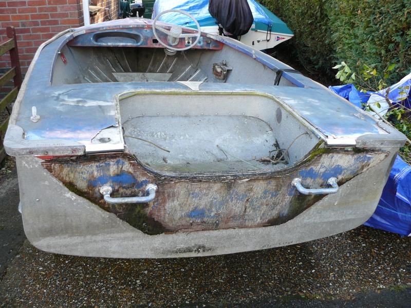

Been working on this every few days. Need to start riveting soon as that's really the only major work left. For those that have never seen this type of corrosion, this is what salt water does to ali over time. Am missing 45 or so rivets and more will let go over time when she's running, as the water has ingressed under the mushroom heads and weakened the shanks, such that banging the hull with a mallet makes the weak ones pop off - generally the shanks remain and have to be driven out, or drilled. I do have plans to fit a bilge pump... :laugh: Last in the water in '83. Link to pics below:-

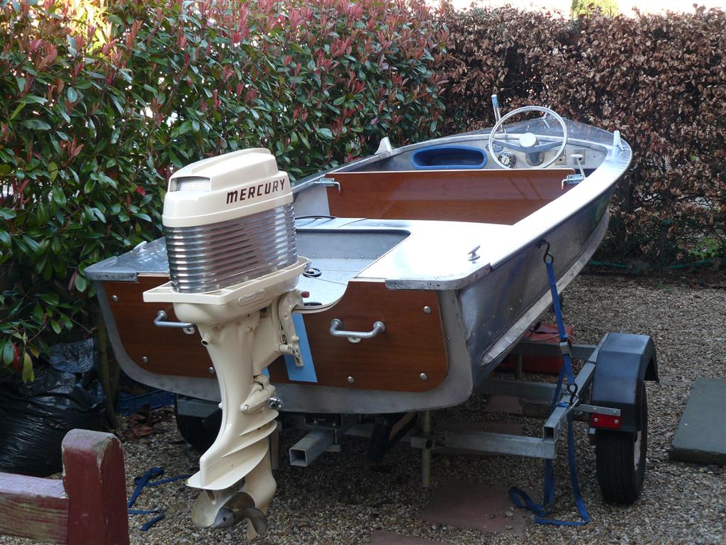

Just need to complete the windshield, but here it is after 110 hours of work.
