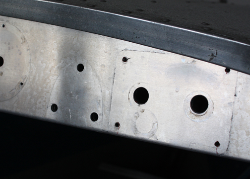

Several issues I am finding ...things like stupid owner choices to cut a hole in the dash for a radio/cassette deck and a mounted AM antena on the deck, some pretty good dings in the hull and various random holes punched etc.

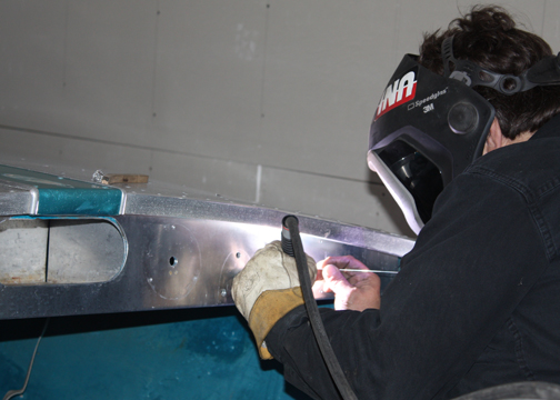

Don't sweat the holes. Large ones can be welded shut and the small ones can be filled with rivets or rivet look-a-likes.
Re:The 55 Feathercraft is Finally Home 15 years 2 months ago #38672
Tig
Re:The 55 Feathercraft is Finally Home 15 years 2 months ago #38673
filled
Re:The 55 Feathercraft is Finally Home 15 years 2 months ago #38675
ground and polished

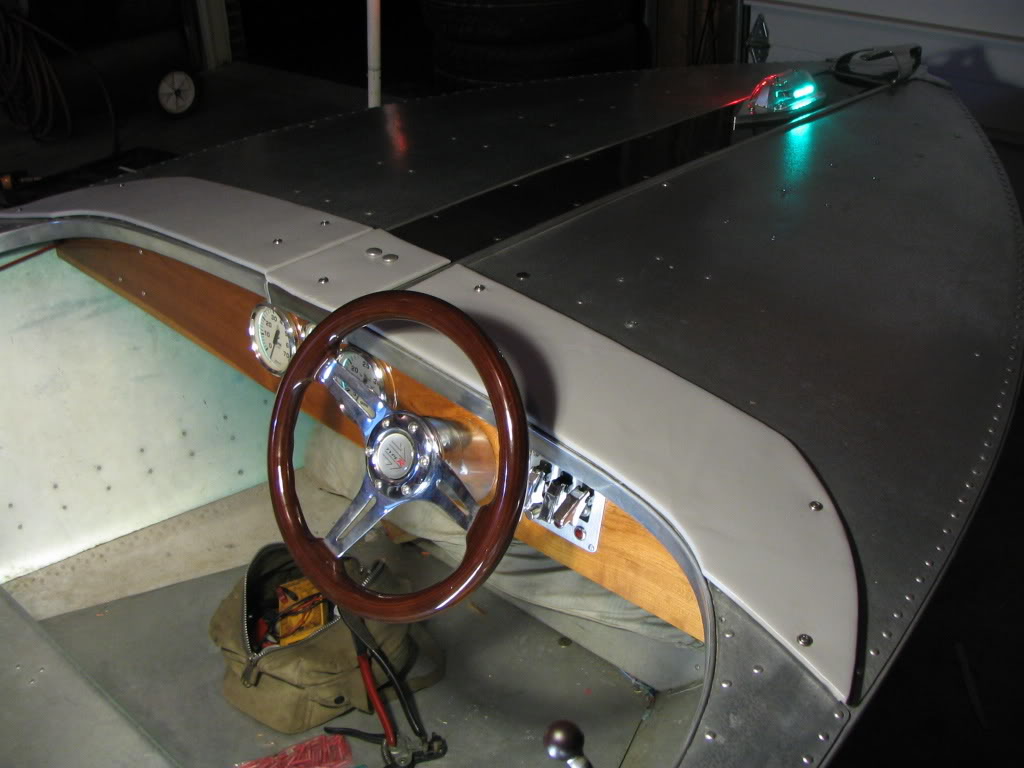

Wow, you have the much sought after front glove box. The panel is pretty bad. If you want to keep it looking the way it did, simply make a cardboard pattern and cut it out of 6061 or 2024 Aluminum. Rivet in place or spot weld in the same manner Otter did. Or make a replacement from Teak as I did. The area where the stern mount was located, needs stop drilled and a scab or flush patch installed. The dent on the port side will take a little skill to remove. Nice boat,,the seat back...I swear you should have to have a special license to buy a sawzall. You get a couple of rednecks together with a case of beer and power tools,,,no good is going to come from it.
