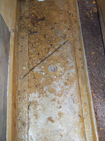

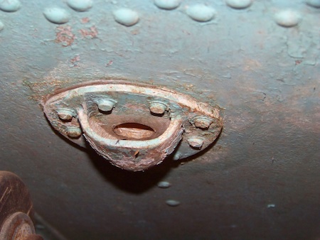

pic of bottom of drain & wider angle of original plug placement in reference to transom (slightly to the right side of center).
The drain cover "scoop" and old threads are one integral component that is riveted to the aluminum hull which is why I think it will be thick enough to hold the "upgraded/retrofitted" drain flange.

sorry - don't seem to know how to add more than one picture per post... :(
here is the third one.

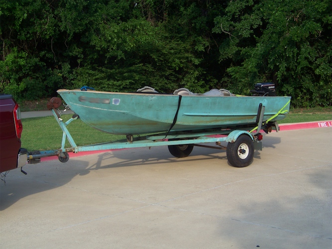

added pic...

That's a great little set up you have there CantFish! You should be able to catch lots of fish out of that, and a '92 Rude will give you years of service with just a little maintenance.

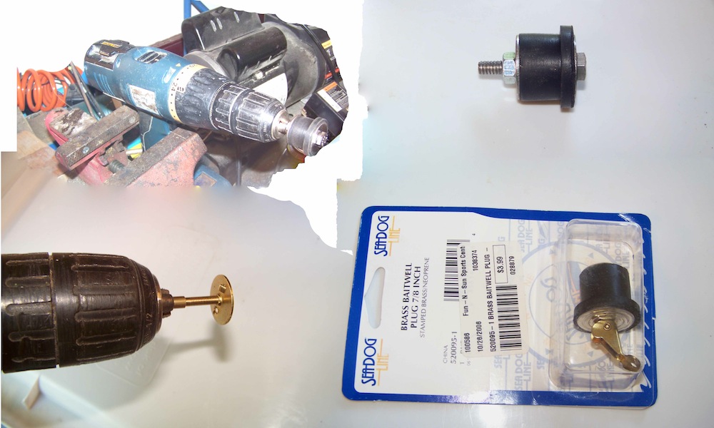

Thanks - I haven't actually done anything yet to the boat - I was able to take a 7/8 in rubber drain plug (like the kind that is used to put in live wells - as that is what it was listed for on the package) and "file it down" removing the stem chucking the rubber up in a drill with a 1/4 in bolt and two fender washers and running it next to a flat file to remove material. Then filed down the original bottom part of the plug to fit the hole as well and put it back together.
Re:Drain Plug / Mod for 1958 Texasmaid - need advice. 15 years 6 months ago #31417
rubber plug (originally 7/8 now roughly 13/16th or a little less)
pics (clockwise)
- plug/bolt in drill set in vise to hold drill trigger down at adjustable speed
- plug with bolt "mandrel"
- plug in original package (comes in set of 2)
- original plug base in drill to file down
from inside out the plug does not leak - the first "in lake" leak check seemed to go well. the plug seemed to leak less (if at all) than a couple of rivets on the aft port side- wasn't able to narrow it down very well at this point. (BTW - I filled the entire the lower seam of the transom with the green epoxy stick from Cabella's as there was a lot of old caulk of some form or another that was dried out - so I just cleaned it out with a pick and air nozzle and resealed it up from the outside.)

pic didn't upload... here it is (sorry for the repost rather than edit) still learning ins and outs of this forum set up and loading pictures...

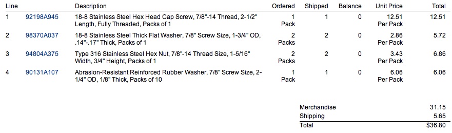

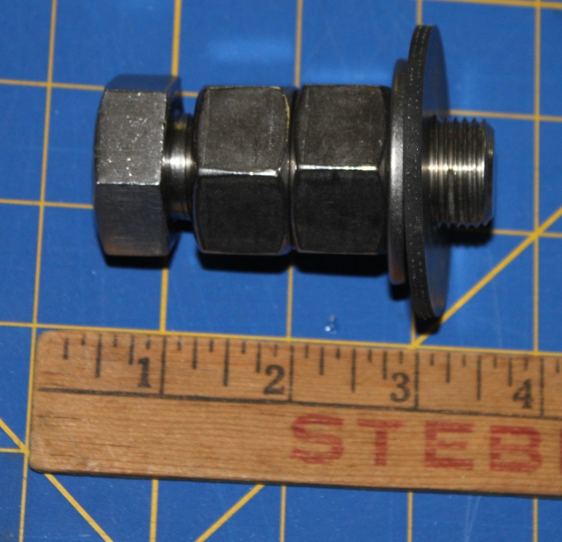

so I finally broke down last year and bought the stainless parts from McMaster-Carr they were easy to deal with and cheaper than just about everywhere else I looked.
I also updated my post on iboats
( forums.iboats.com/boat-restoration-building-hull-repair/possible-mod-texas-maid-drain-plug-make-more-standard-good-bad-idea-472236.html )
but here is the final result:
Finally broke down and ordered stainless steel parts from McMaster-Carr
Total of $36.80. Now working fine (needs to be screwed in a little tighter than I'd like but no leaks through the plug. I may need to get an O-ring to go under the steel washer rather than the Abrasion-resistant Rubber washer (or need to put a small strip of teflon tape on it just for the final seal. I initially bought two of the nuts and washers thinking I'd cut the bolt in 2 and make two plugs by using the two nuts as a jam nut type configuration for the second one. (I think 2.5 inch bolt was the shortest 7/8 x 14 tpi one they had at the time with threads all the way to the bolt head). I figured for $37 for 2 plugs it would be worth it. Though I have not cut it still at this time. It does stick up a bit right now, but does the trick. It takes a 1 5/16 socket (or I use what I have heard called a Ford Wrench to snug it down) - similar in shape to a plumbers pipe wrench but without the teeth that would constantly mar up the bolt.
Parts listed in image in next post $31 + about $5.65 for s/h for parts to make 2 drain plugs.
At first I used one rubber washer and still had a very minor leak. I think we had more water getting in the boat from the bait "trolling" bucket sloshing and for sure had more from choppy lake spray when underway than we did the plug.
I was not really able to use boat for last year but took it out this past weekend and the plug worked great which reminded me I never updated this tread with the new plug info...
The rubber washer is only sold in a pack of 10 so since I had extra I eventually used 2 under the steel washer to get a good seal to the aluminum boat bottom (also scraped the paint away with some scotch bright on a drill) but not sure if an o-ring would work better or not... )
Hope this helps someone out there working on the same problem.

image of McMaster-Carr invoice:
