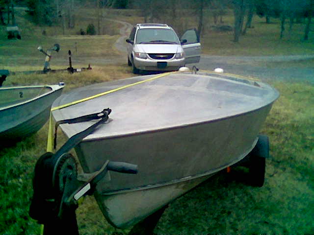

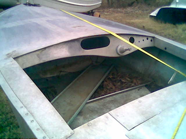

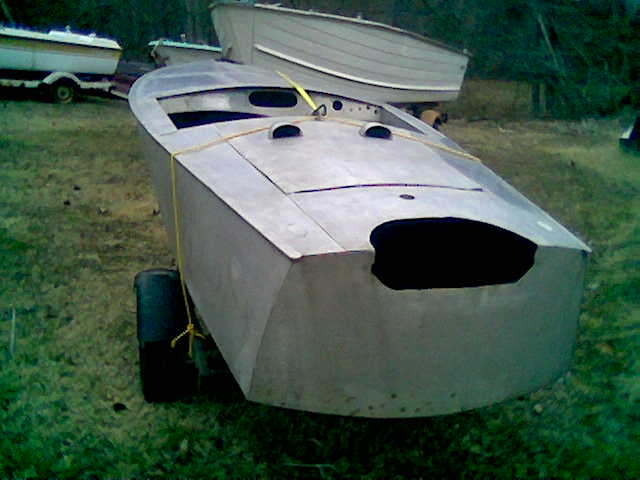

1954 or 1955, no engine, but a straight boat. needs to have two patches on it. the original engine set up was a DIRECT DRIVE flat head 4. i'm thinking about re-doing the original set up or close but that would take a ton of fabricating parts.
the quick solution to power, WITH a transmission may be a liquid cooled motorcycle engine.
definitely a neat boat. super low serial number of 113 or 115, i forget which but the plate is there.

Nice, despite the transom mods! Would have had a 4 pot Ford 100E in it, some are modded to pre-crossflow and some even had gearboxes, rather than direct drive..The best to get is the Coventry Climax engineed version.
Enjoy and if you need parts, ebay UK has a number available at any time, I think listed this week, and some of our CMBA club members ( www.cmba-uk.com ) can help with specs and badges, burgees, bowlamps that sort of thing. Check in Internet Finds on the site for marinising bits. We have one serious expert who has a list of most boat serials and an extremely quick series 1. Just be careful that they have a finite top end, given conventional shaft angle and propellors, so overpowering I believe causes the stern to rise out the water and the bow to dig in.

YES- i was lucky enough to bump into rod c. at a meet a week after i bought the boat and scrubbed his brain quite a bit on parts and possible engine combo's. coventry is too big for this boat as much as i'd love to do that.
a liquid cooled motorcycle engine might be the most cost effective way to get it back on the water in the short term but to quote a (in)famous US president, "i will not rest" until it has a flat head in it. the sound is too cool if the revs are too low.
i am very lucky that they DID NOT EVER bolt a motor to this thing once the hillbilly carving was done on the transom, no evidence of a transom board at all. there was no support network for outboard motor transom stress and i think even the back yard butchers realized that.
