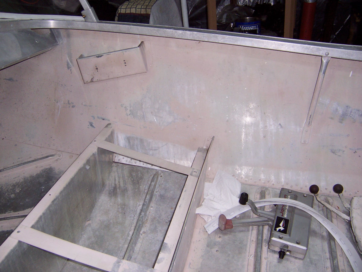

There are triangular pieces that come off the gunnel to support the back of the seat. If I can find a pic of my malibu Ill post it
Re:Lone Star Malibu seating 14 years 10 months ago #54224
The triangle pieces you reference were used on Malibus from thru 61. On the 62 and 63 models these were not used and the seat backs were redesigned. I believe these later models had thicker seat backs and no visable seat back braces attached to the sides of the boat. I have a pattern for the aluminium triangle shaped braces but was hoping to understand the original design before proceeding.

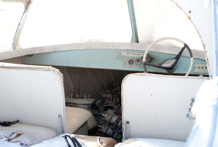

Very good. I wonder if they did the seats like this El Dorado I took some photos of.

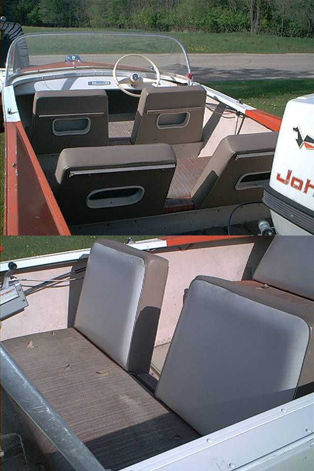

Here is a picture (I hope) of seats from a Malibu that was said to be a '62.
Ed
Re:Lone Star Malibu seating 14 years 10 months ago #54365
Wow completely free standing. It looks cool.
