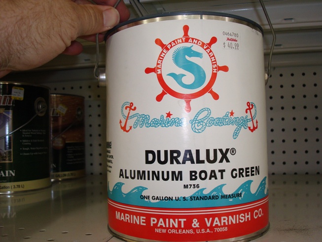

Hi, I have done some research on this. Ever wonder why almost all jon boats are green?...Because Duralux Paint makes a patented paint that actually bonds to the aluminum. Almost all aluminum jon boat manufacturers use this specific paint product. To my knowledge no other base coating or primer will actually bond to the aluminum. You can use this paint as is or as a base coat for their other 20? coatings. Duralux has been around for a long time, and they are very knowledgeable. Talk about harsh environments.....They make paint coatings for oil rigs in the Gulf of Mexico. I spoke to the salesman last year, he will steer you in the right direction. One thing that he stated that was critical was to get the alumimum very clean & very dry and prior to painting.
Other research....use the following:
