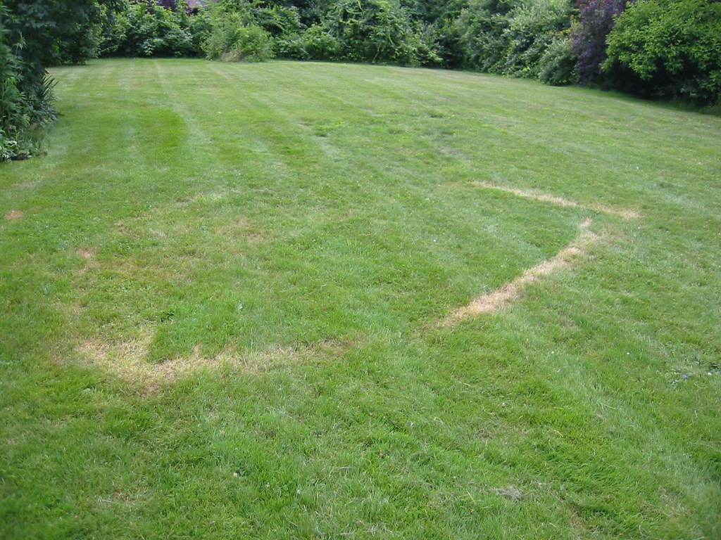

Done with proper care, adequate protection, and respect for the materials involved, this is perfectly safe ...just don't do it on a patch of lawn that you care about. If you're really only looking to get it to slide off the bunks easier, I'm not sure that any of this would help much. Maybe you need more slippery bunks? ;)

Deoxidizing and polishing aluminum hull 7 years 6 months ago #139109
Thanks, I'll check it out, I've been waiting for the warmer weather. Did you find out what it does to your lawn the hard way?

propnut wrote: ...Did you find out what it does to your lawn the hard way?
Sadly, yes...
It did eventually recover, just not before my wife got home. That it was boat shaped really didn't allow me much wiggle room. ;)
