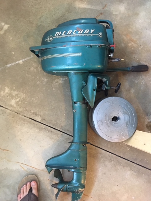

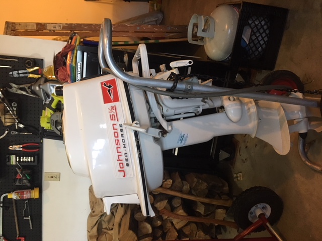

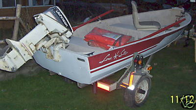

I bought this boat about 10 year ago and have used it sporadically as row boat. I had the opportunity to pick up a few cheap 6 hp outboards and decided that I would spend some time and money to get it fixed up and looking good.
In my prior use of the boat, it had leaked a little. So before I plan to spend some long days on the water I decided to look into how to seal the rivets.
In my research I found a repair kit that Cabelas used to sell that utilized a 3M product called Scotchkote 226p. In some other forums it had great reviews. Problem is, its no longer available for sale. I ended up having to buy a 5 pound box of the stuff for $160 opposed to a small $7.99 kit. My plan is to sell the rest on ebay to recoup my investment

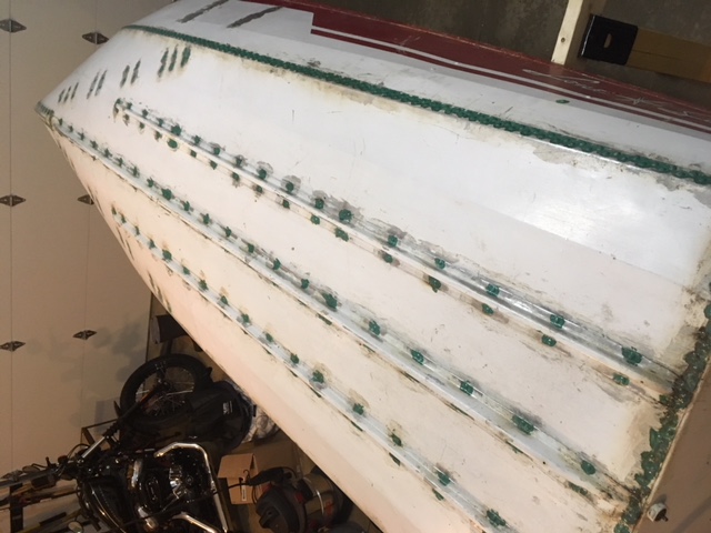

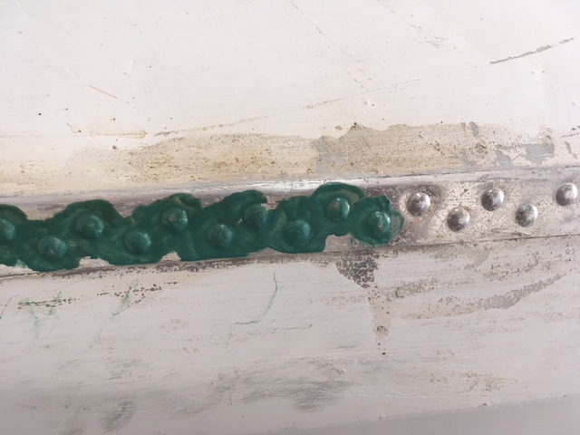

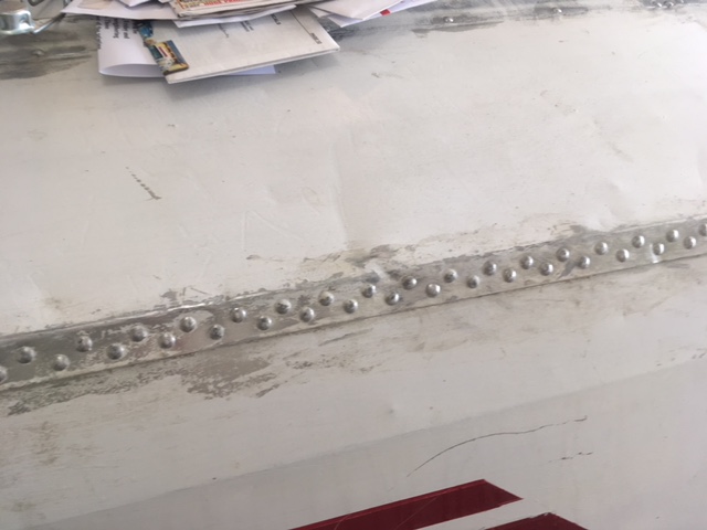

The 3M product showed up and I had to prep the boat. I made some wide saw horses and then got the boat on them.
The next step was to wire brush / strip the paint off all the rivets below the waterline.
The 3M product require the use of a torch to heat the rivets prior to the product being rubbed over each rivet.
Once hot the sticks covered the rivets really easily
Took an hour or so, but I got them all covered
