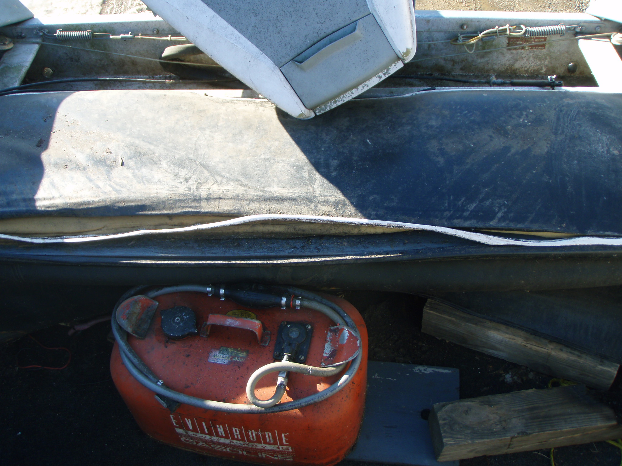

I bought this boat in the winter of 2008 from the Daughter of its Original Owner in Ohio for $500. I was in Iraq at the time and she gladly held the boat for me. I picked it up in the spring of 2009 and began work on it to just get it running and on the water. It had its original paint job, and 75hp 1960 Evinrude.
File Attachment:
File Name:
File Size: 0 KB
File Attachment:
File Name:
File Size: 0 KB
After a cleaning and a tune up, I hit the water with the boat and enjoyed the boat in her current condition that summer.

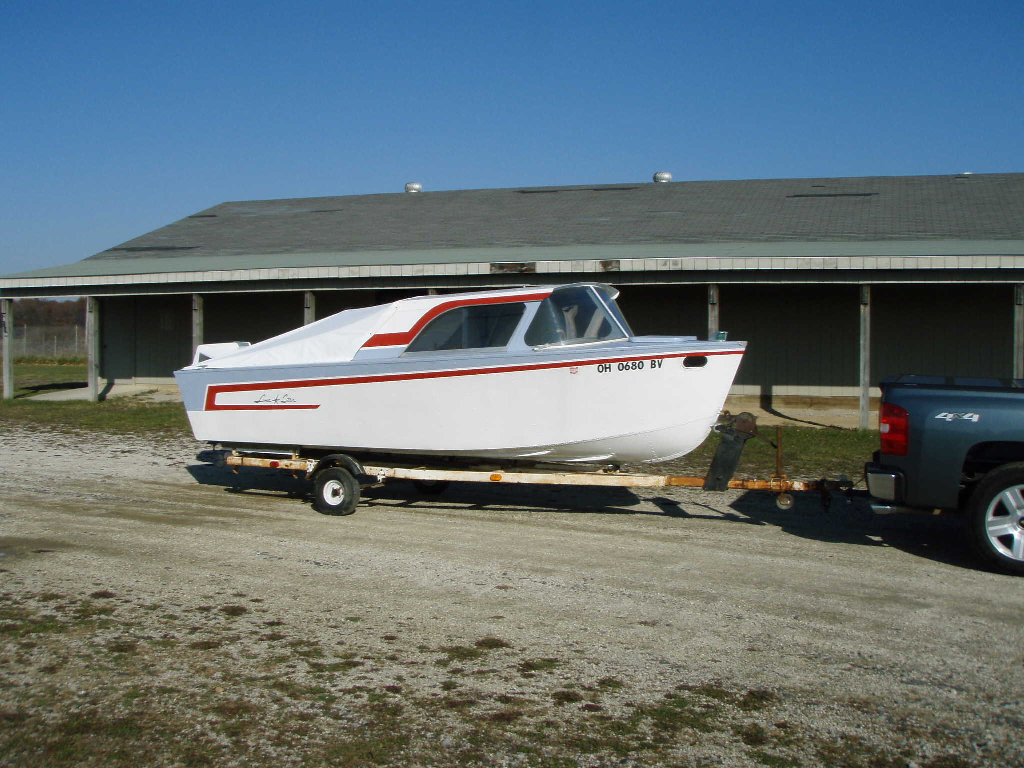

The summer of 2010, I decided the boat could use a face lift and I painted the boat. I masked off the original paint job and used a brush and a roller and some enamel paint from Sherwin Williams that I had matched the best I could. The paint job came out great. The boats old wood floor was also in need of attention and I pulled and replaced it as well as the masonite side walls in the aft cabin.

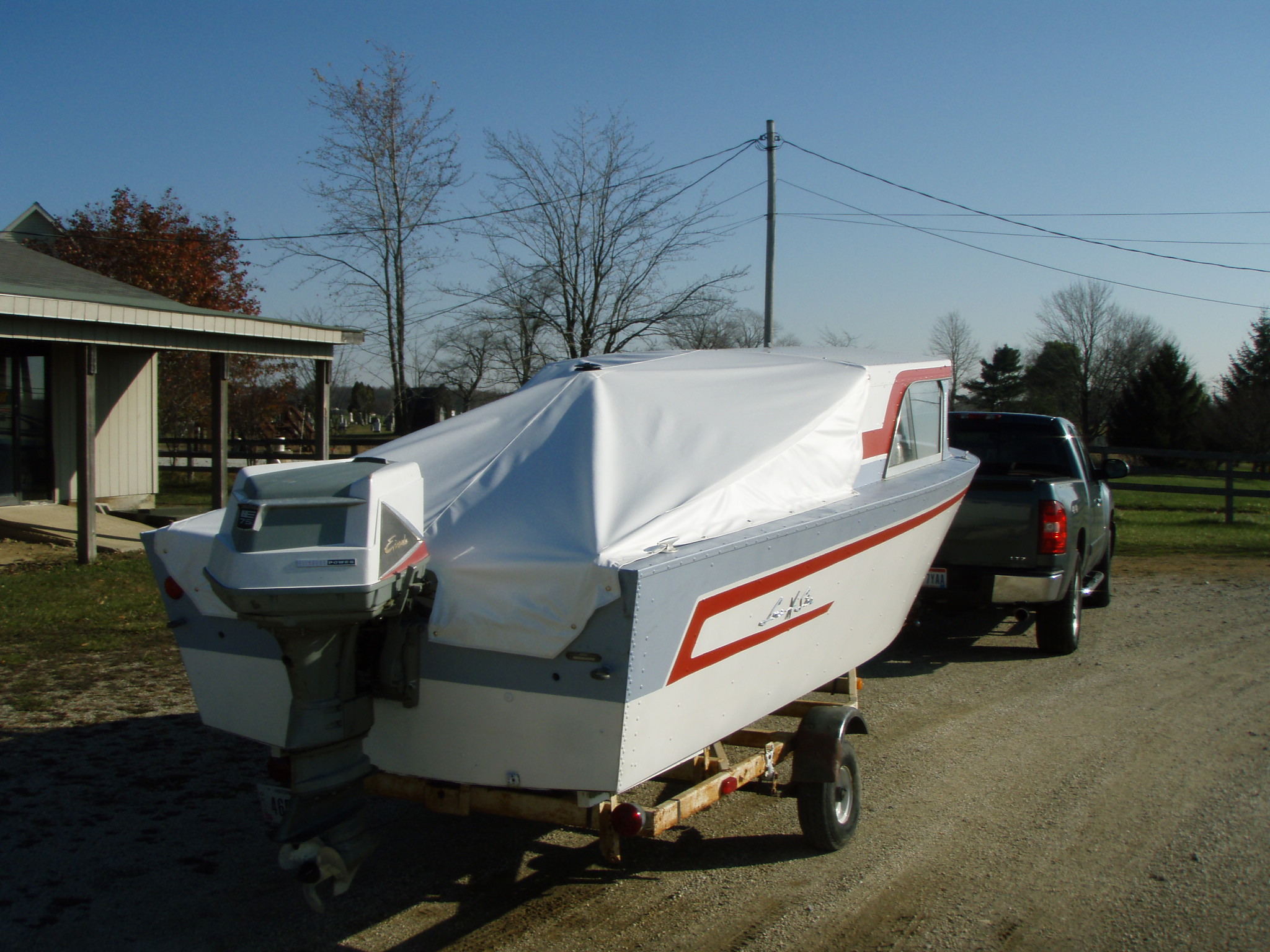

2011 I was preparing to head to Afghanistan and the boat was in need of a cover, I had plans to do more but I lacked to time to do much more restoring and decided to just use the boat as much as I could and enjoy it. Still I had a nice cover made to protect the boats new floor.

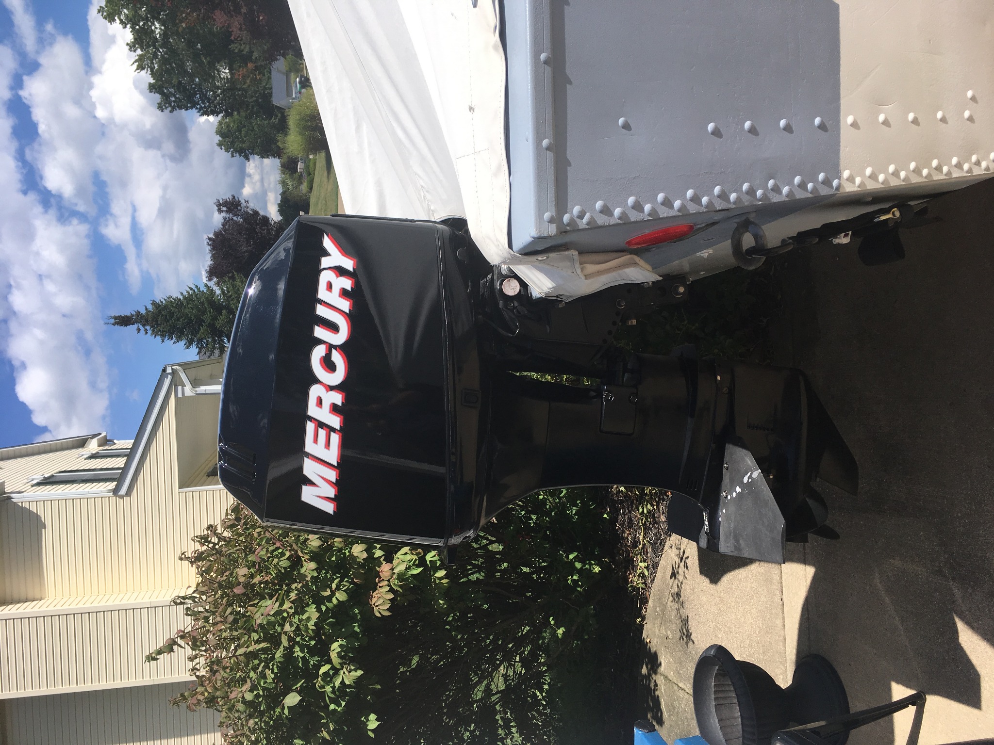

The summer of 2016, kept me off the water a lot. Work and travel just made it hard and the boat did not get much attention. I did splurge and purchase a 2004 Mercury 50HP Outboard. I decided as much as I wanted to keep a period correct motor on the boat, It was time to enjoy it more and upgrade to some newer turn-key technology that would be more reliable for me. The motor sat on an engine stand for a long time in my garage that winter with me day dreaming of finally getting the rest of the projects done on the boat.

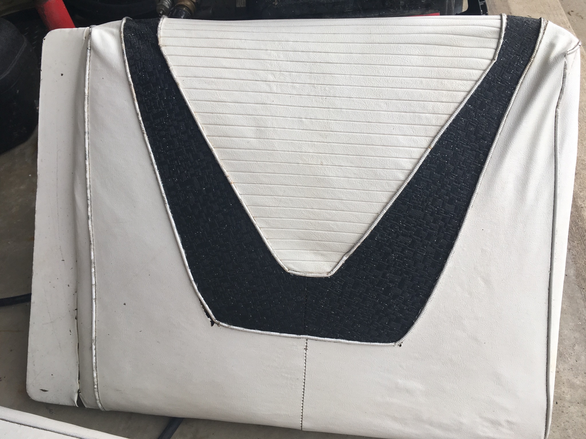

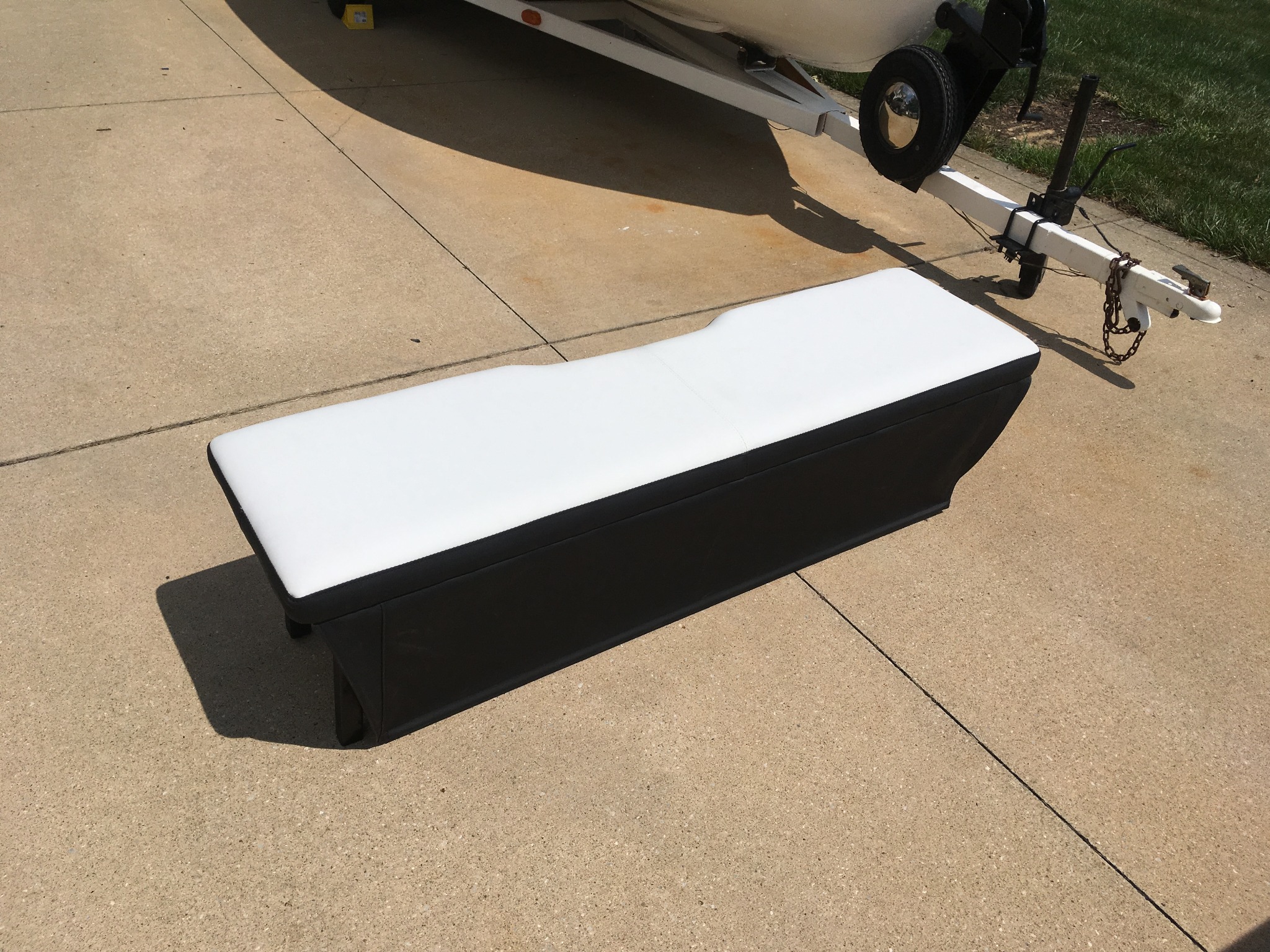

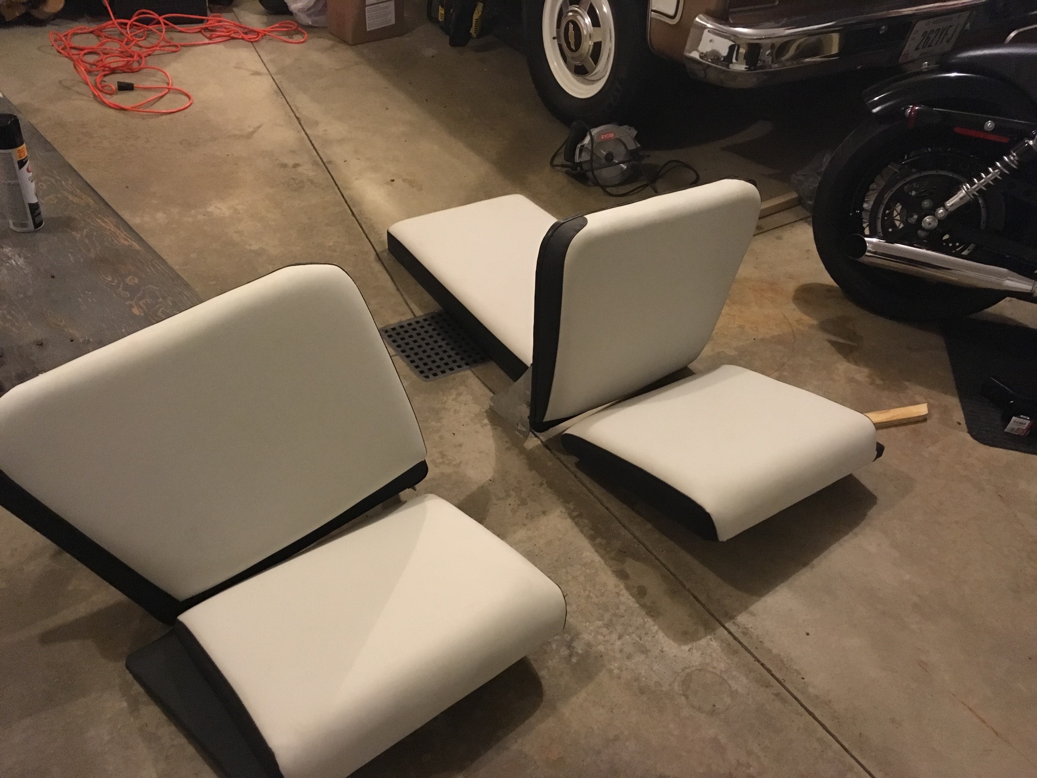

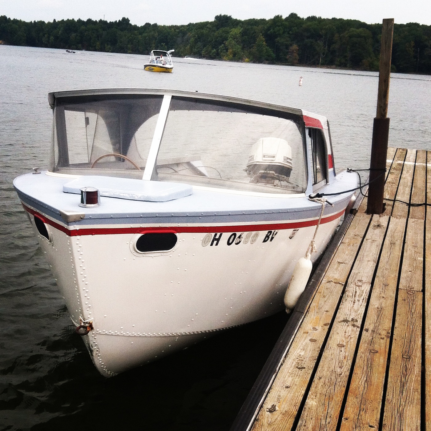

The summer of 2017 brought a lot of progress for the boat. I managed to get the old seats out of the boat and off to the upholstery shop to be redone. The old horse hair cushions were due for some attention and I wanted to start finishing the interior of the boat.
The new seats turned out great.

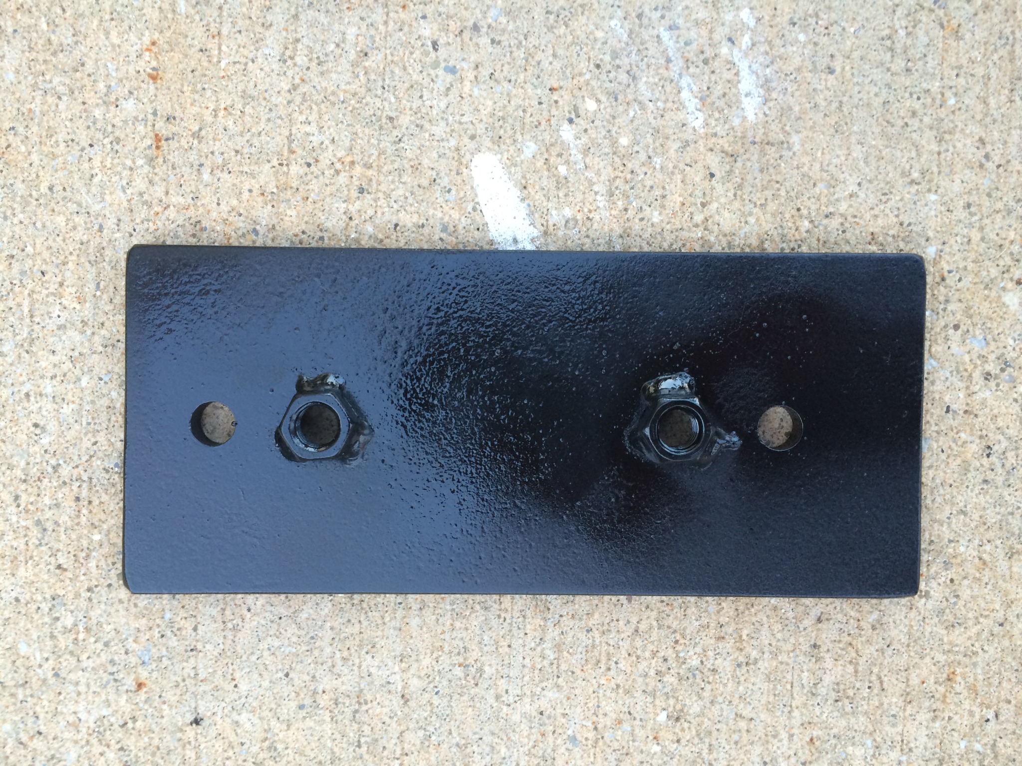

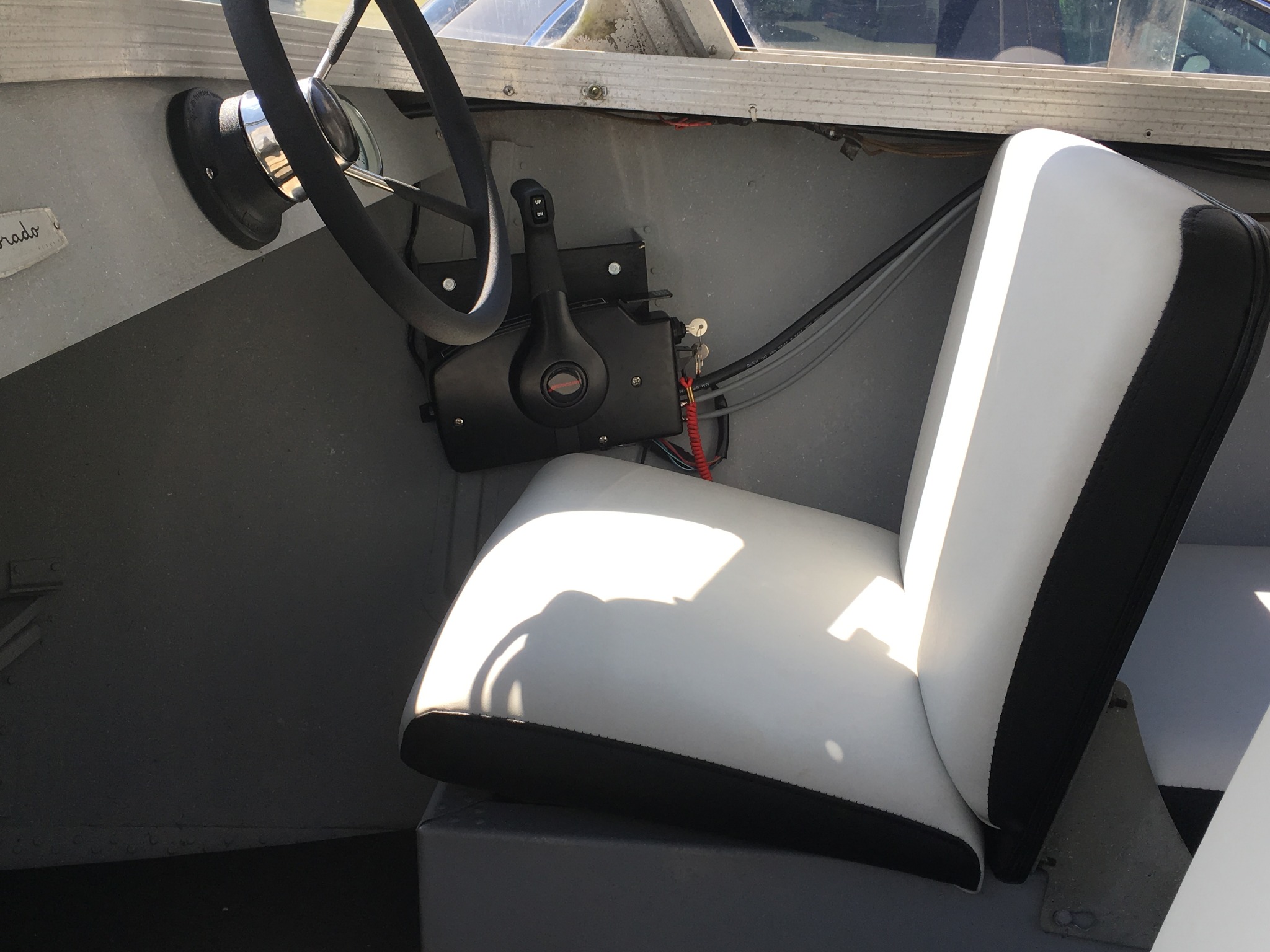

The new outboard, required me to remove upgrade the steering wheel and pulley system and I made use of this project to replace the old dash in the boat and add a tach for the new motor. I pulled out the original and used it to make a pattern
The dash, floor and masonite walls in the boat I had just brushed painted gray years ago and I decided I want them to be like the original splatter paint. I chose to use Zolatone Silver Gray and couldn't have been happier with the results, it sprayed on easy with my harbor freight spray gun.

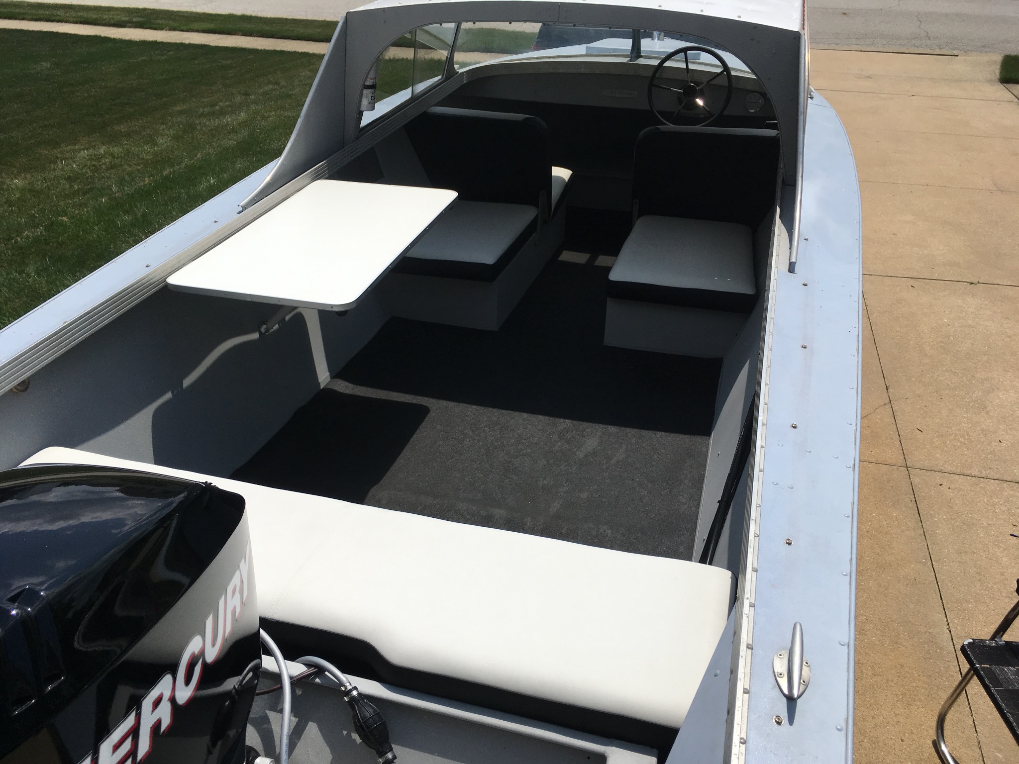

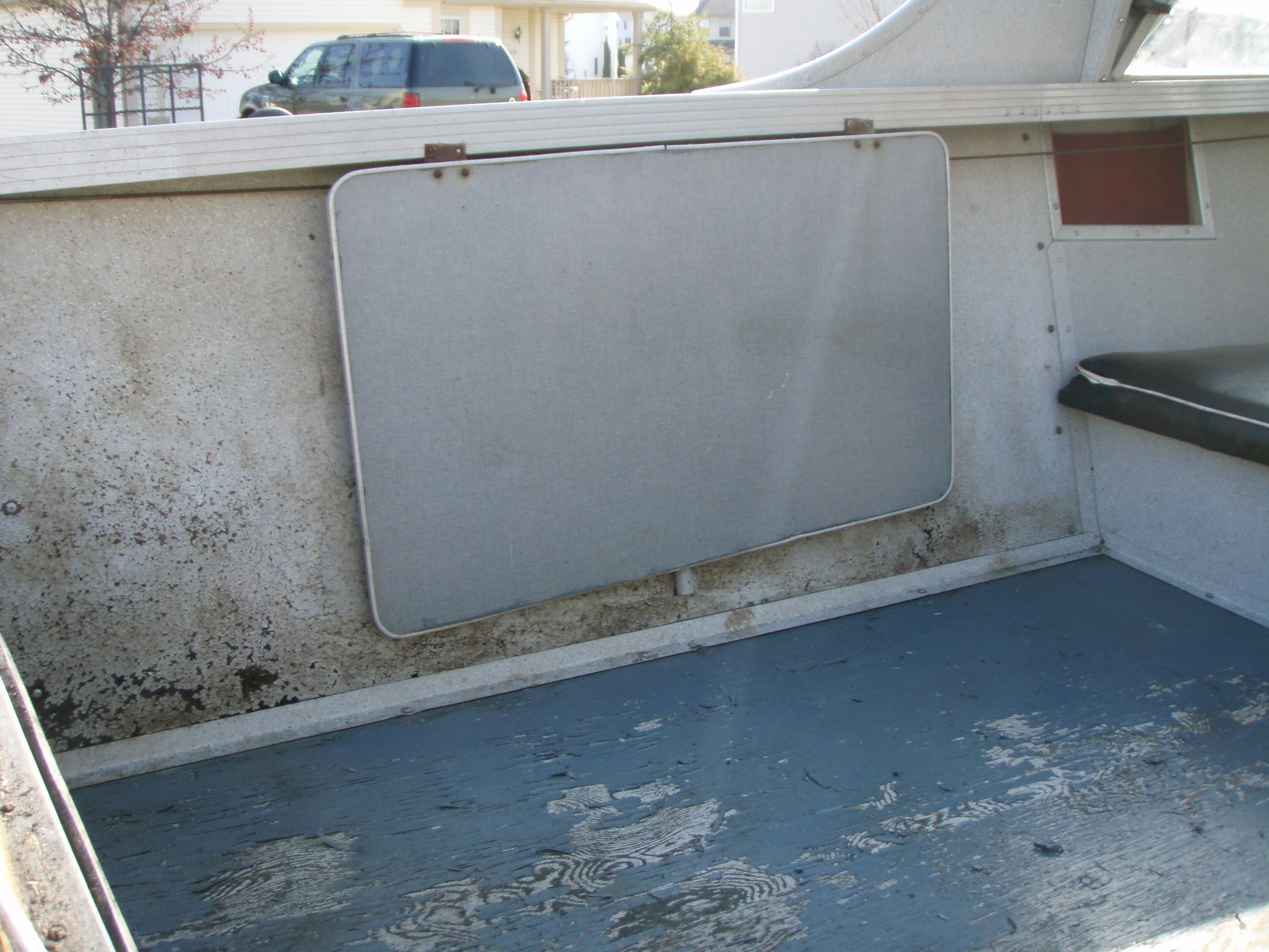

The boat had a table as an option in the aft cabin and I removed it and purchased a sheet a melamine from lowes, traced the old table and used my jigsaw and circular saw to cut out a new one. I trimmed it out with some aluminum counter trim I picked up at the local ACE Hardware.
The new motor mounted perfectly in the old holes in the transom, Its nice that the motors mounting holes are all standard.

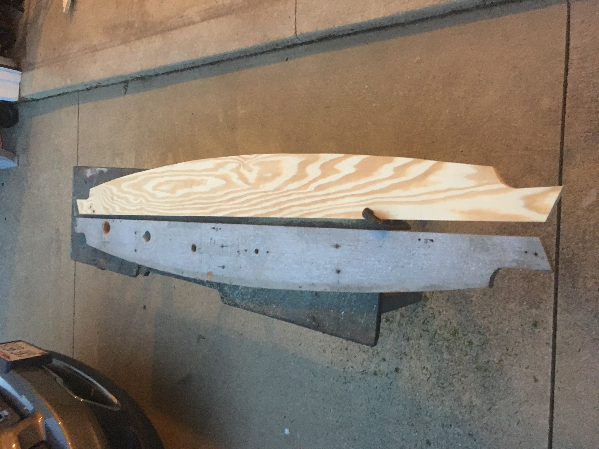

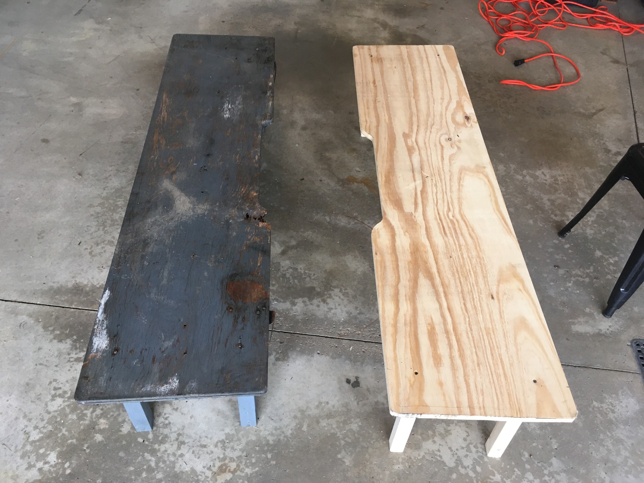

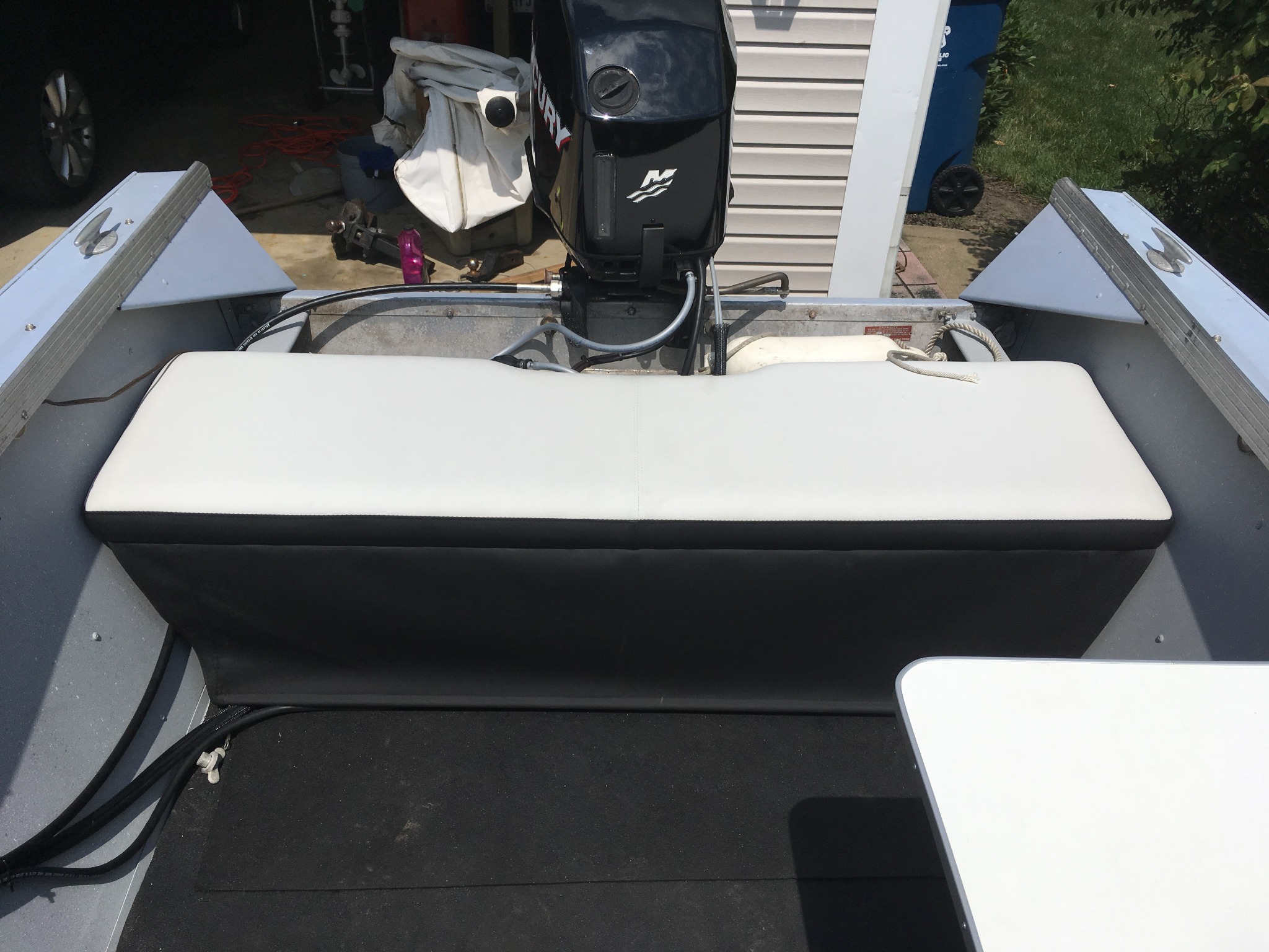

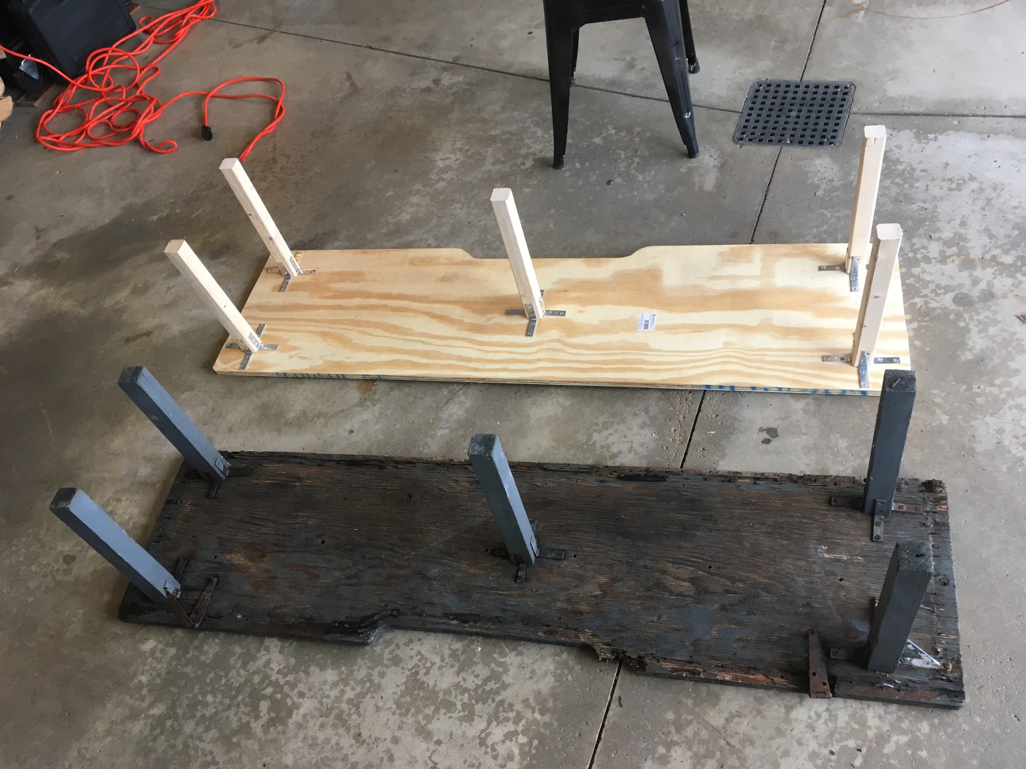

The last project I decided to jump on was the rear transom seat. This was not a stock feature, or even an option. The previous owner must had made this seat and I had removed it years ago but had saved it. After some thought, I decided that the extra seat may actually be kind of nice. So I decided to make a new one, just the like the old.
Here is a photo of the original one someone had made.
Here is the new one I made.

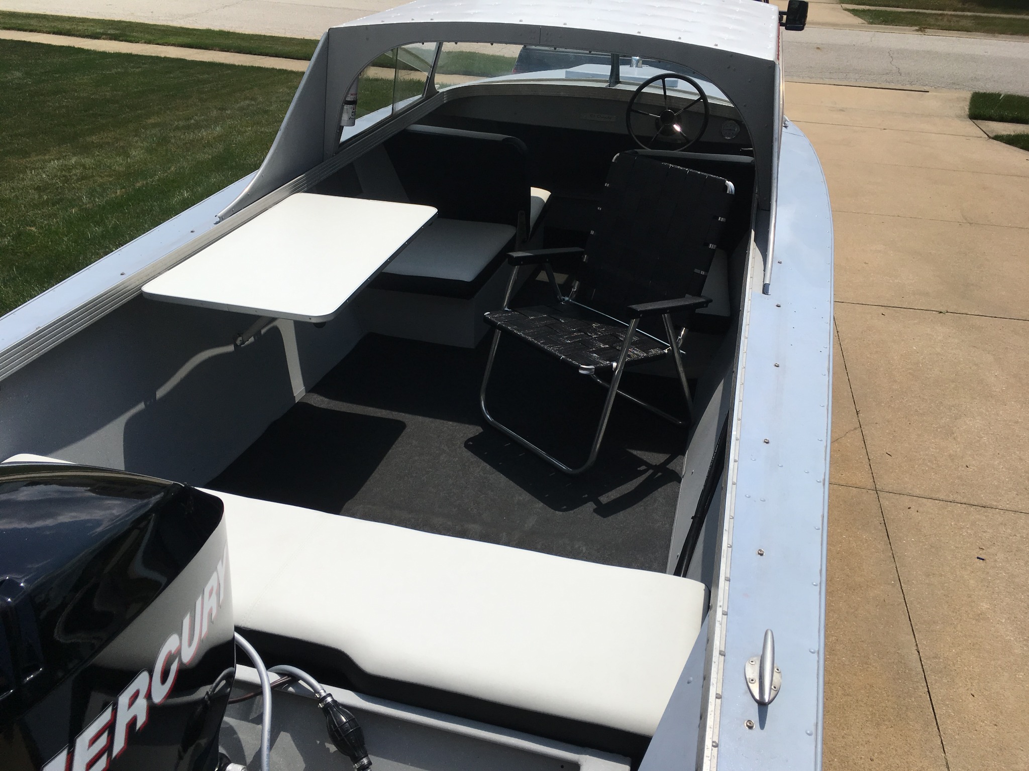

Once I got everything in the boat I was really pleased with how the paint, and new upholstery, rear transom seat and table really made the boat look fresh and new.
The rear cabin still had room for a folding chair, and I found a sweet retro style lawn chair in black from LawnChairUSA.
The old AD for this boat, has a guy fishing, sitting in a similar chair, so I figured I would copy it
The new controls for the outboard made me engineer a new wood bracket on the side console to mount them lower. A little delay to engineer that but the I was really happy with how it looked in the end.
The new dash with the tach and new steering wheel looked clean as well.

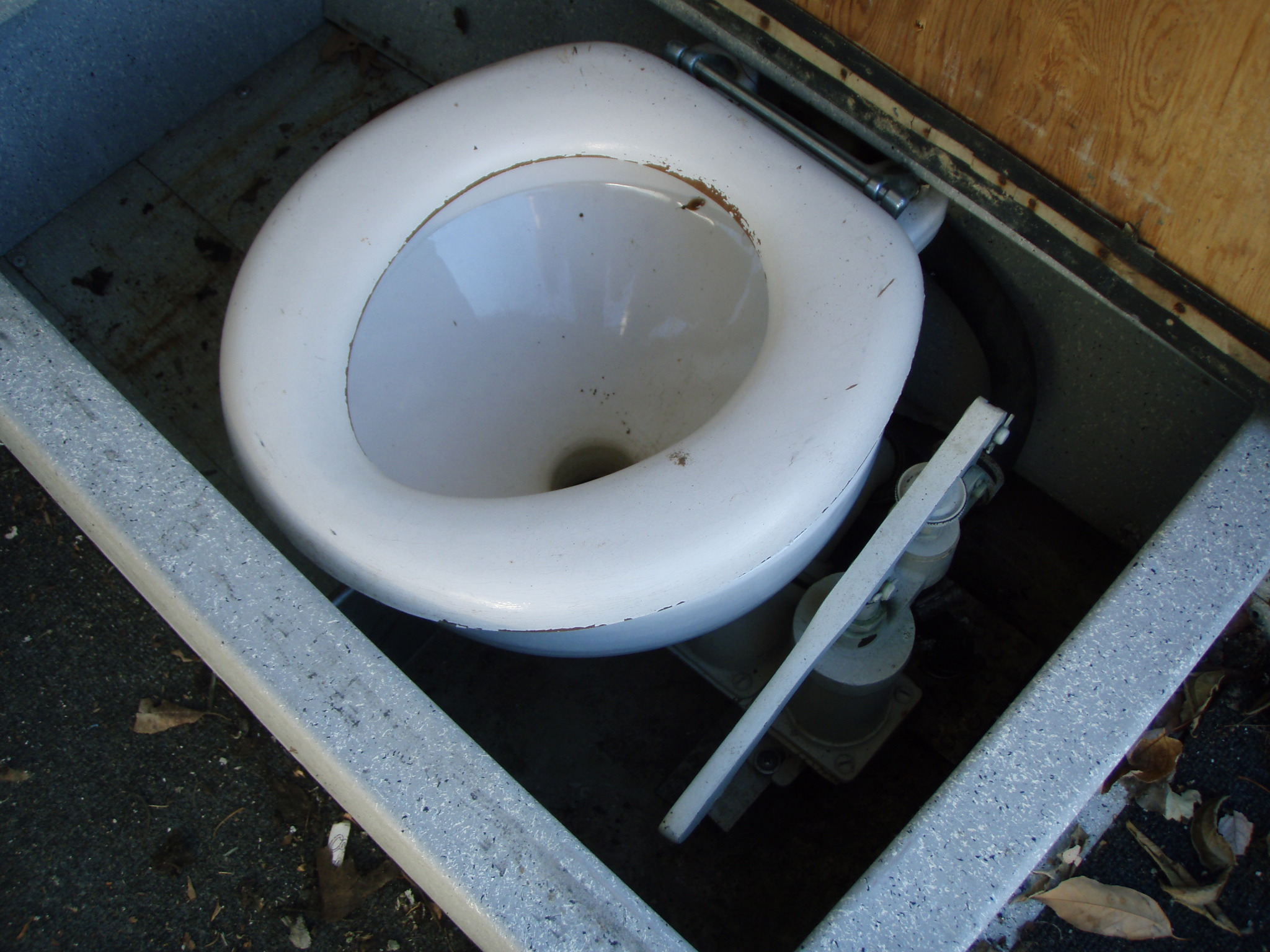

The boat also has a working toilet under the one seat, it pulls in water and then flushes into the water. Per all the regulations in Ohio, and I am sure elsewhere- I am supposed to remove the toilet and plug the drain accordingly. I just don't care to remove it. Not to say I am going to use it regularly or at all. But its not broke and I am not going to mess with it.

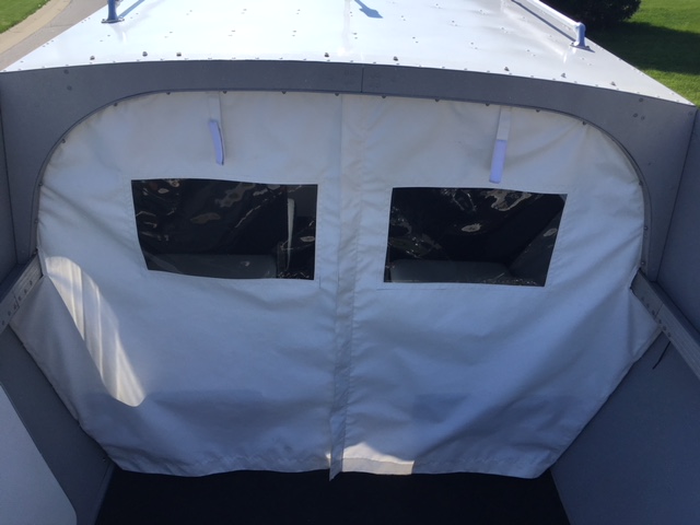

Well, the canvas shop came through super quick on the bulkhead door and they made it just like the stock catalog photo I showed them. The window was made larger but I appreciate the extra size.

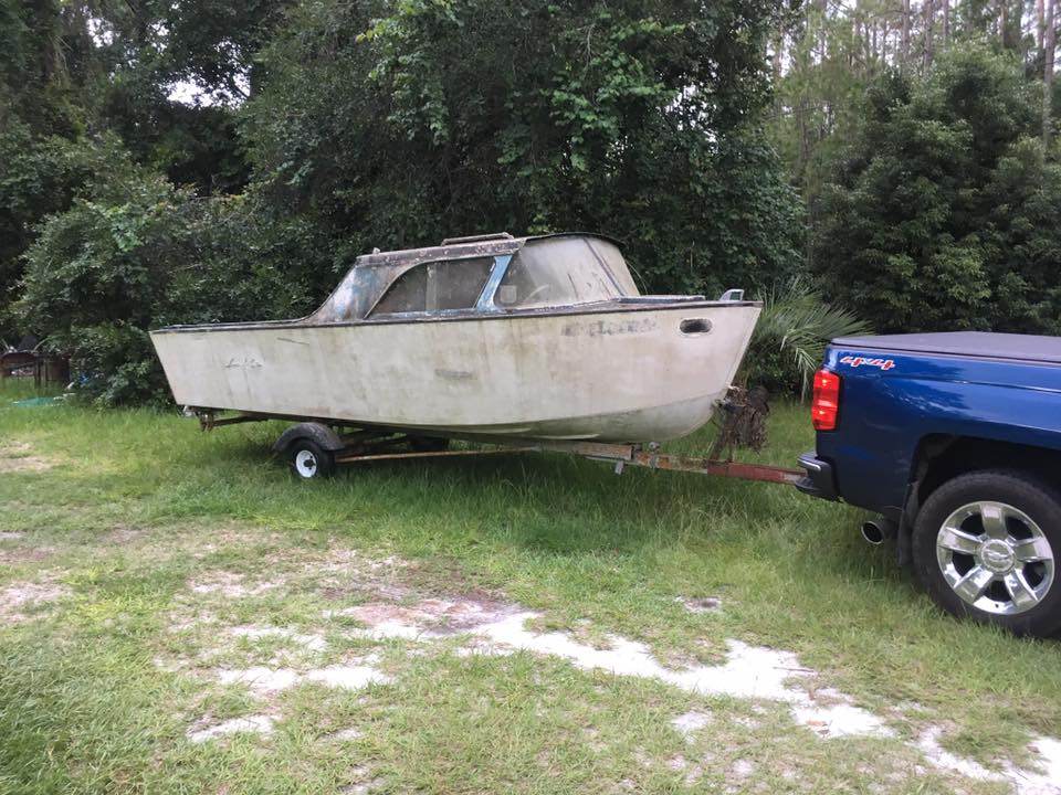

Well.....I didn't need it. It all started with a simple craigslist post in the local area of good old Ohio. The next thing you know I ended up searching the whole damn eastern seaboard. Then I saw it, another 1960 Lone Star El Dorado. Original seats, all the glass and windshield present, on what looked to be a vintage trailer. Boat was in Florida, near Lake George. I live in Ohio.....After a phone call to the boat owner and a little bartering- I bought it. I guess I figured what the hell. I have a list of other Lone Star's that need attention and restored but I just have little control.
Made some calls and a good friend of mine made the trip. We did some off shore fishing and had a really great time and we picked up the boat. Flat tire and the bearings were pretty shot on the trailer so we had some work to do to change out the hubs and wheels and tires.
Had a nice long weekend and Florida and got the boat home safe and sound 2000 miles later.

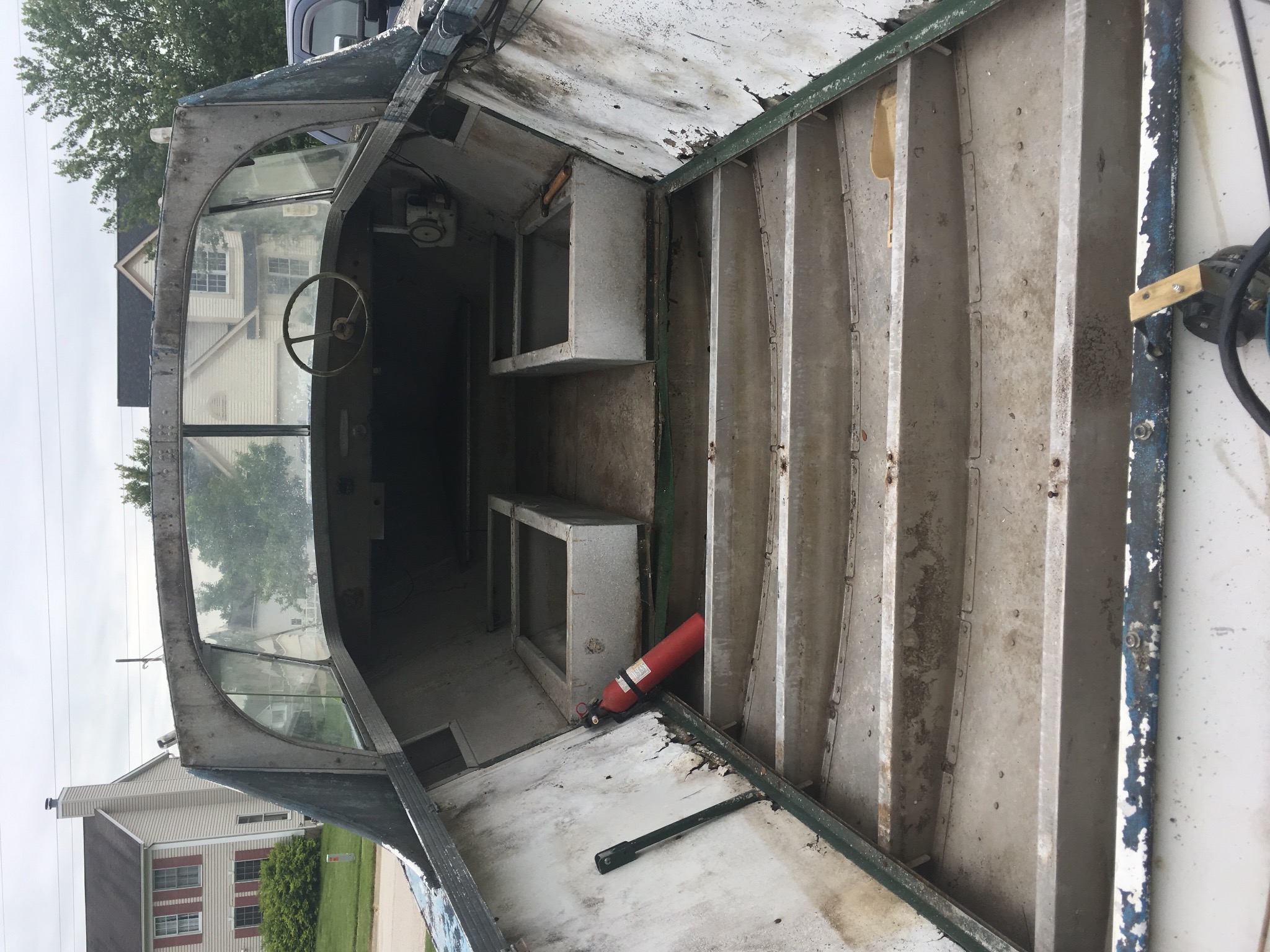

Well, I started on her. Got the cockpit and cabin cleaned up and removed all the junk. Drained all the water and swept out the floor.
1960 Lone Star El Dorado Restoration 8 years 4 months ago #136606
  • mgm
  • mgm's Avatar Topic Author
  • Posts: 17

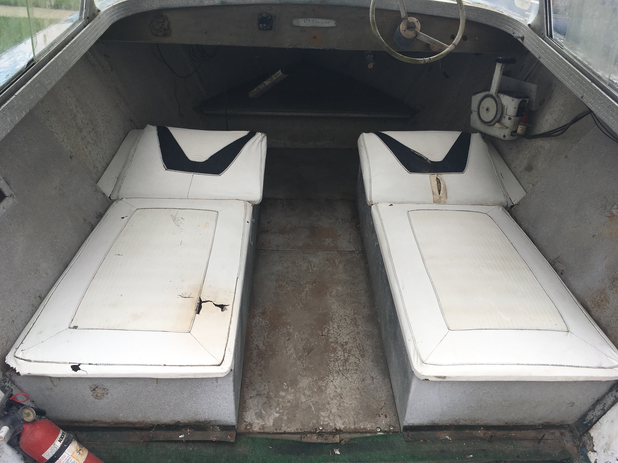

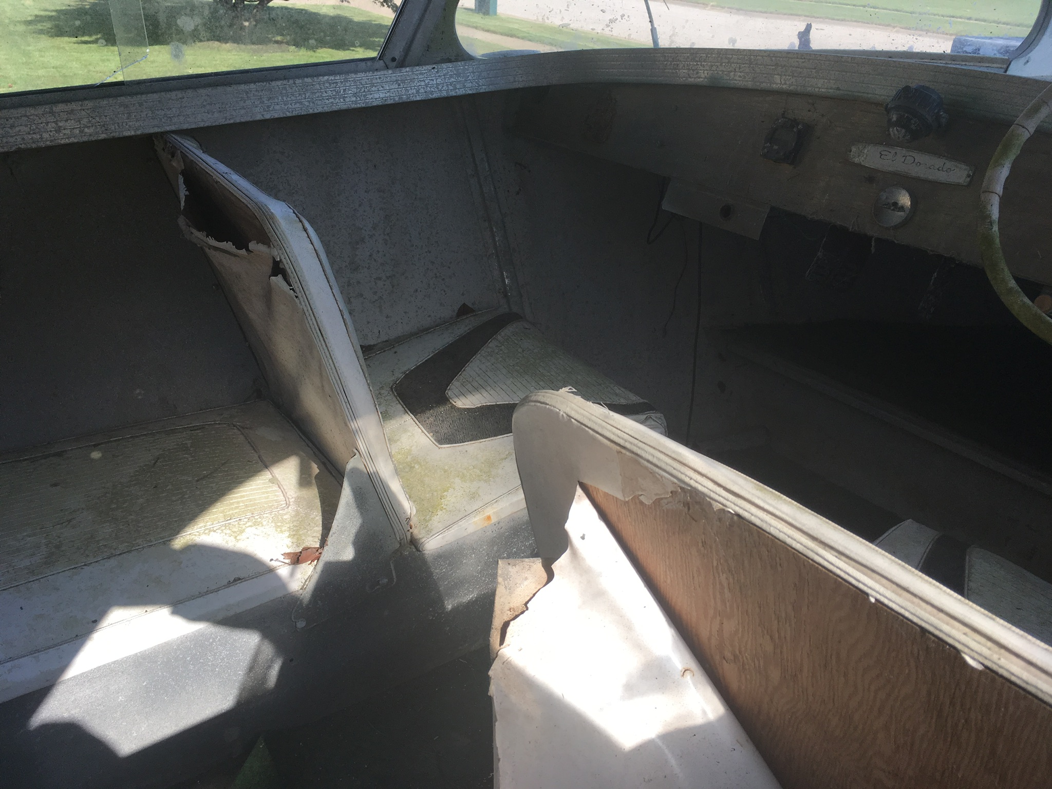

Someone had added an ugly wood bulkhead to the boat. It was pretty easy to remove. The only benefit to this is that I think it helped preserve the 58 year old original seats pretty well.
Going to see if I can find a place to restore them back to original specs with similar materials since these will serve as excellent patterns to copy
Some hot soapy water cleaned the grime off fast
