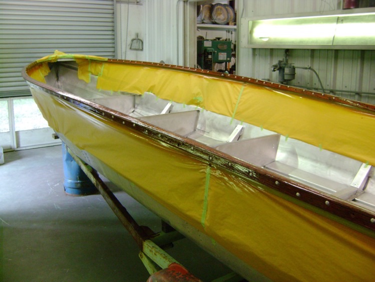

1953 Arkansas Traveler BF HD Utility 9 years 2 months ago #132946

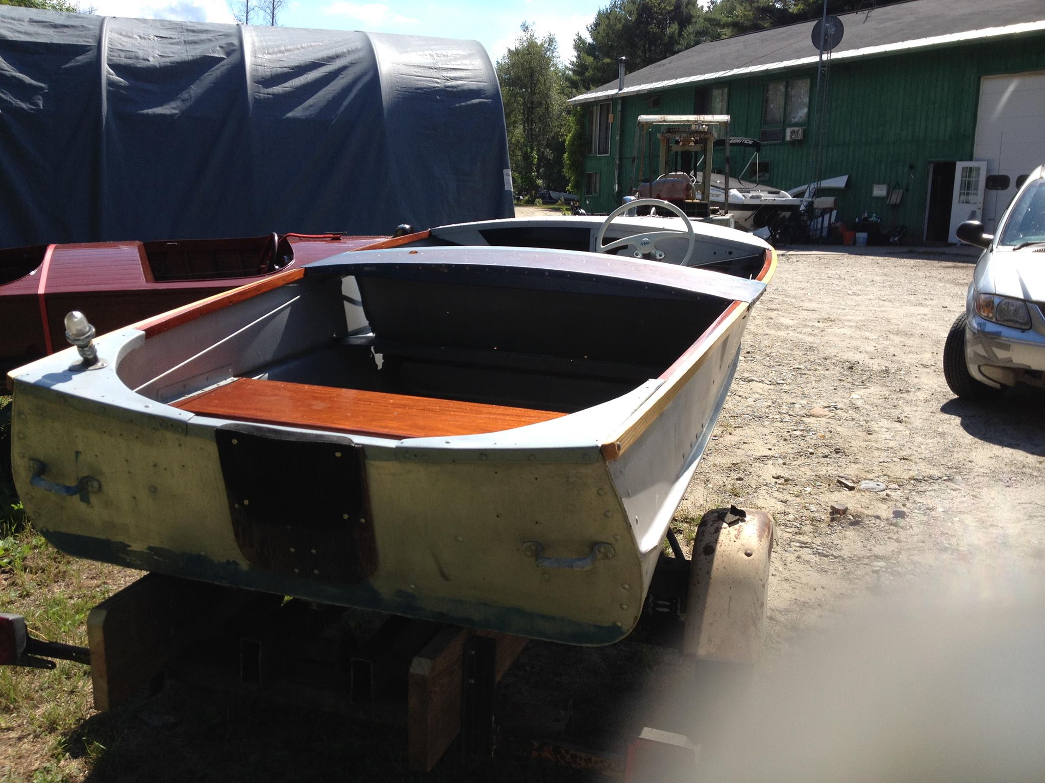

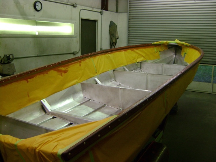

I heard you guys like pictures. Here is my first 15' 10" Big Fisherman AT that I got last year. This is the boat I plan to put the 1957 EV Lark on.

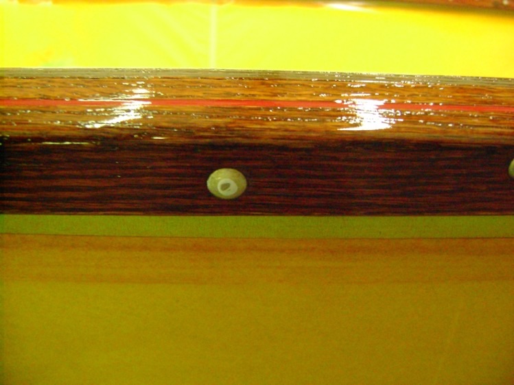

(See posted in J.E.G.O.) This boat was in excellent original shape, but I am having it redone as far as wood finish and floor paint. The aluminum has been stripped & defouled. None of the original wood has been replaced. What we thought was mahogany turned out to be tulip poplar with a great stain job. We have tried to duplicate that.

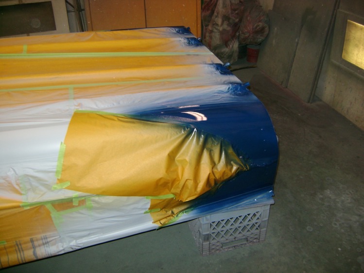

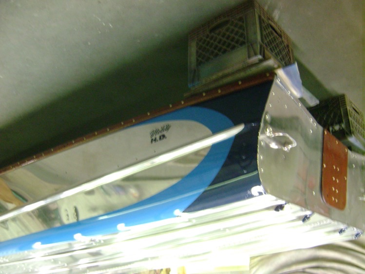

1953 Arkansas Traveler BF HD Utility 9 years 2 months ago #133060

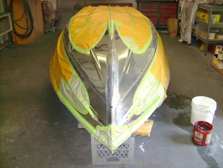

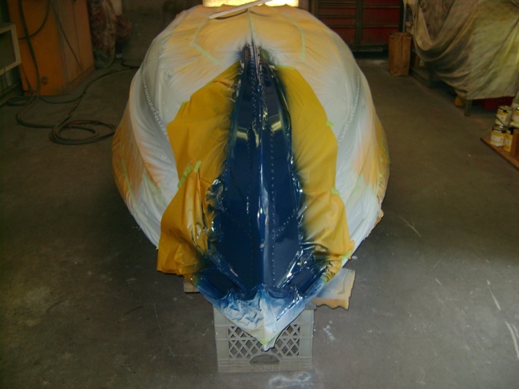

Heading into the priming & painting areas. Plenty more pics to see. I think some pin stripes are coming as he mentions he is fixing to get stylish. No telling what that means, but I am excited to just wait & see. More to follow.
Dan in TN

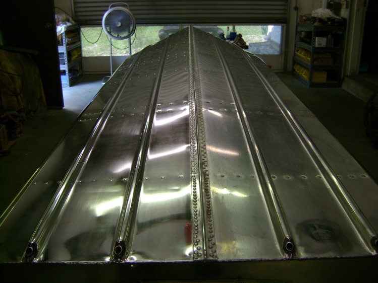

Didn't know if y'all had seen the mods to the drain plug? He removed the vertical drain plug (see patch on right side of bottom at rear) & added horizontal drains at the rear. This will make it much easier to get all of the water out of the boat.

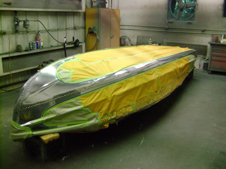

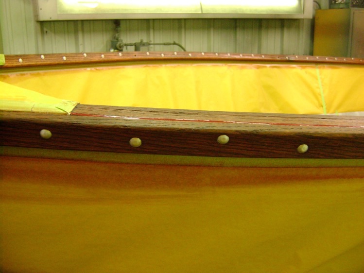

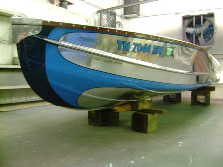

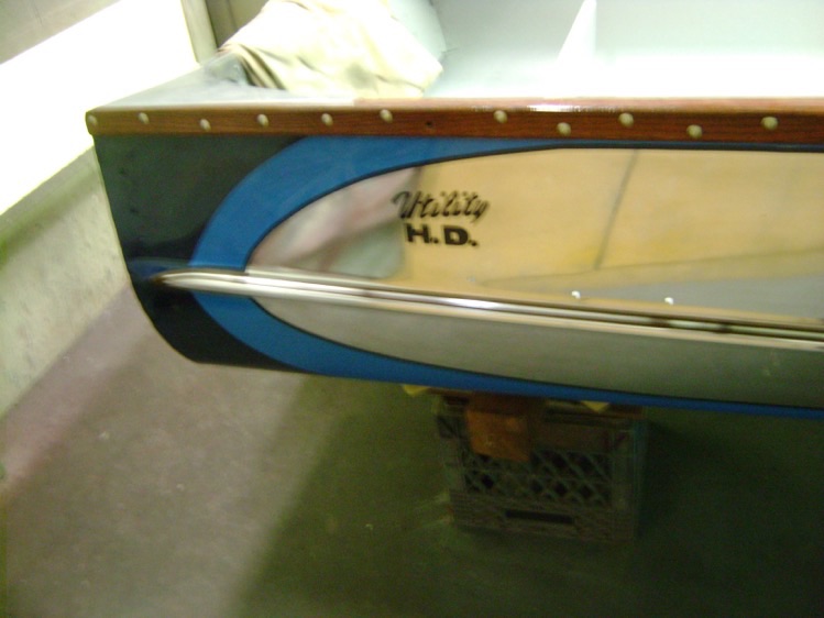

1953 Arkansas Traveler BF HD Utility more paint. 9 years 2 months ago #133094

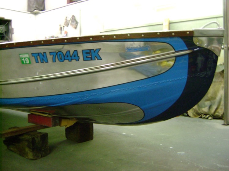

Painting continues. Says he is going for the '50s Art Deco look. Pin stripes to follow & then off to the trailer.
Dan in TN

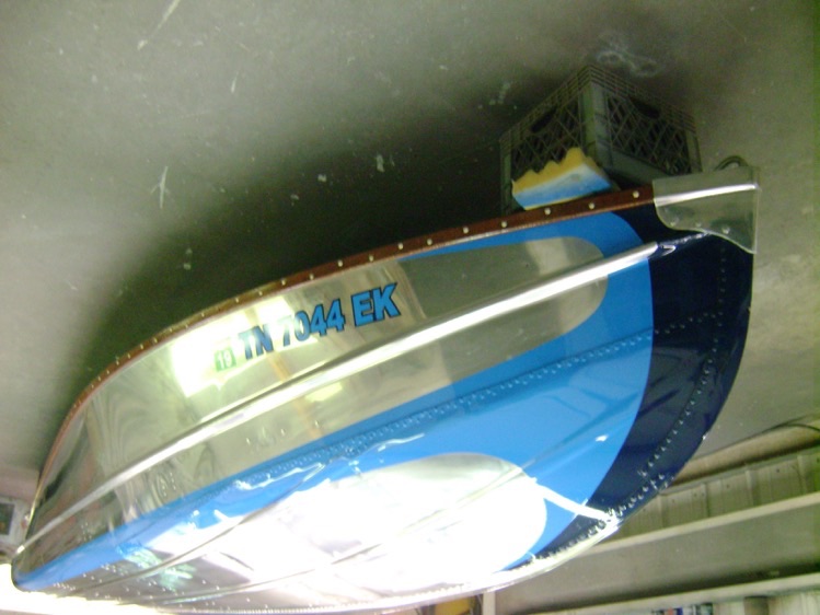

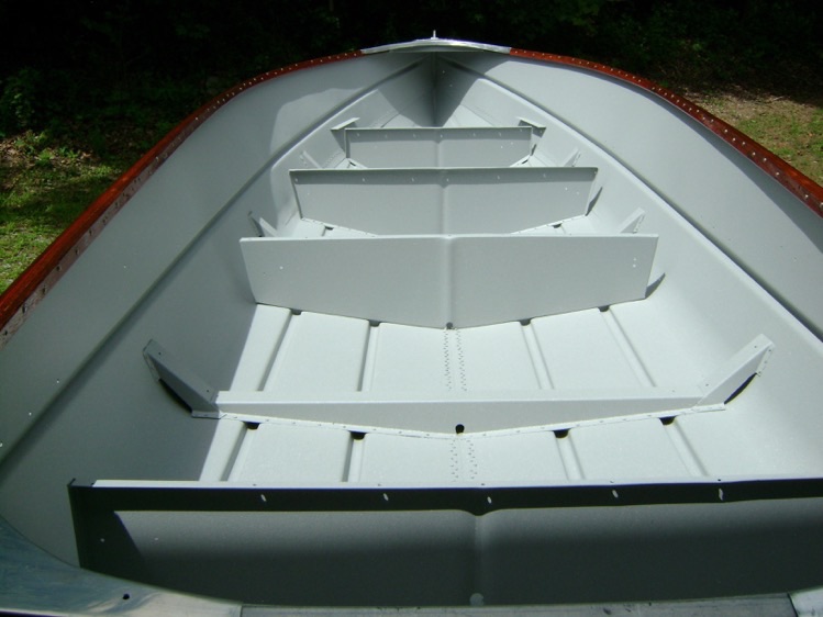

1953 Arkansas Traveler BF HD Utility 9 years 2 months ago #133352
She's upright now & got the pin stripes. Starting to look complete. Putting the floors in now. I need flat floors to walk on for balance issues. Trailer work begins next.

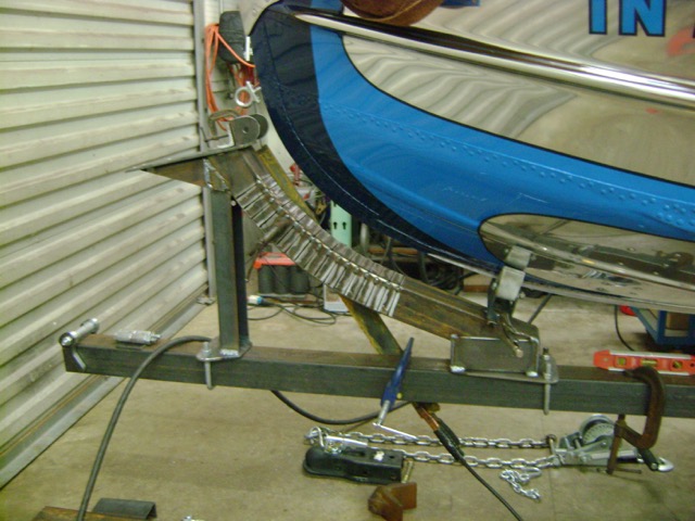

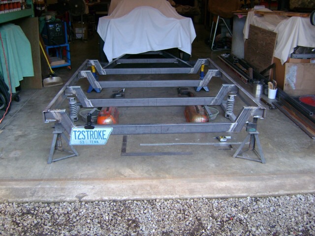

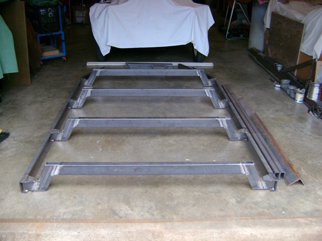

1953 Arkansas Traveler BF HD Utility 9 years 2 months ago #133485

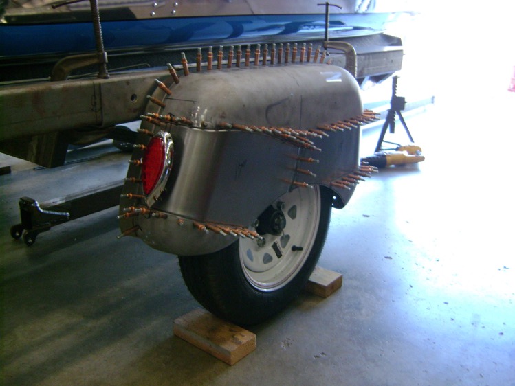

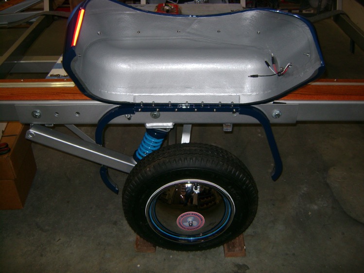

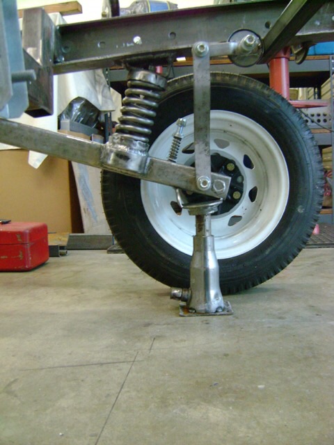

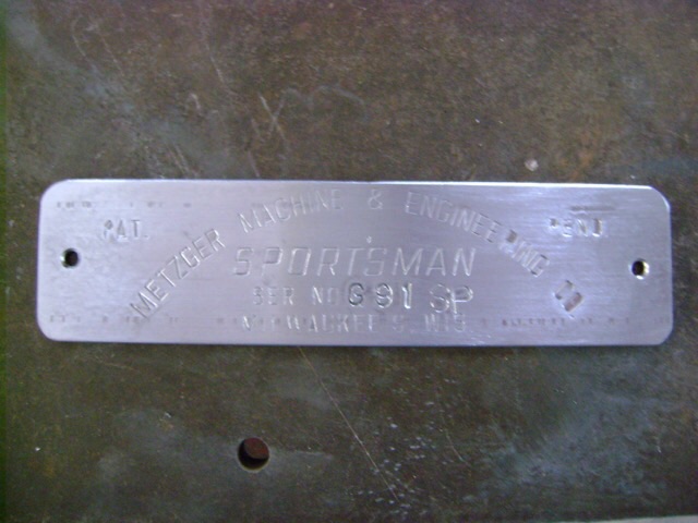

Here we go with the trailer. Discovered the trailer was not a home built as told by the seller! If I had known that I would have kept it for a smaller boat & never have cut it up for modifications. Found the tag after we started. It was a Metzger Sportsman 691 out of Milwaukee. I had never heard of them, but an interesting story of the owner & he wrote a book. Anyway several modifications are being made to incorporate the independent suspension. A sway bar has been added. Jack pads were added to make it easier to jack the boat up. The arms were so close to the wheels it was hard to get the jack under the frame. The pictures of the fenders show how they will be sectioned for the larger tires (4.80 X 12"). Since several different power plants may be used on the boat the carriage can be moved to change the tongue weight. Enjoy!
Dan in TN

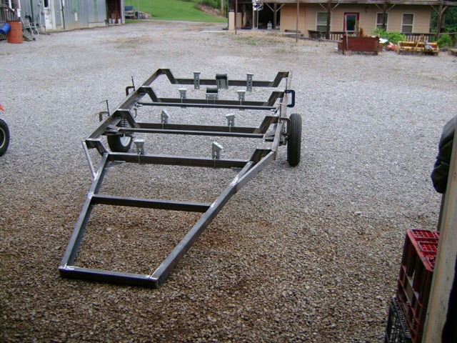

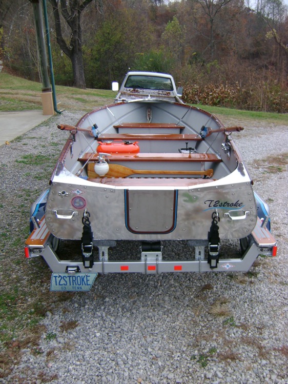

1953 Arkansas Traveler BF HD Utility 9 years 1 month ago #133925

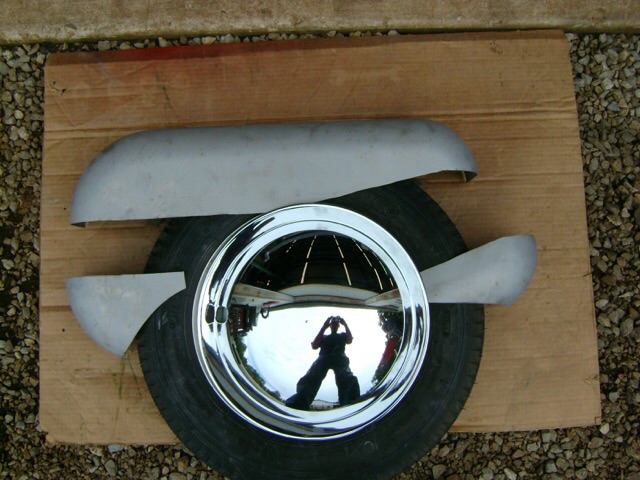

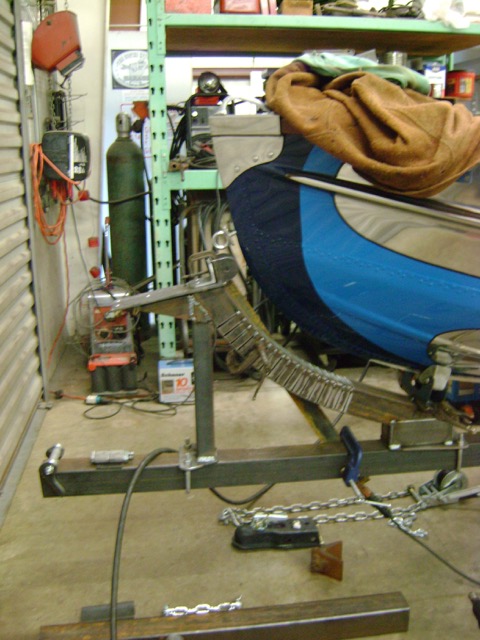

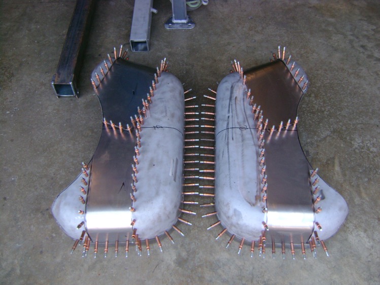

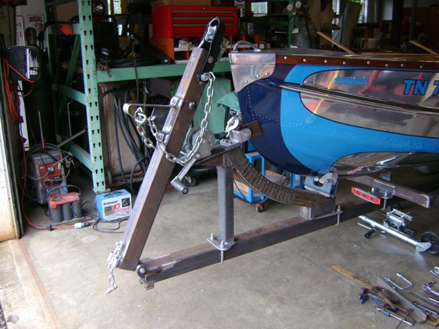

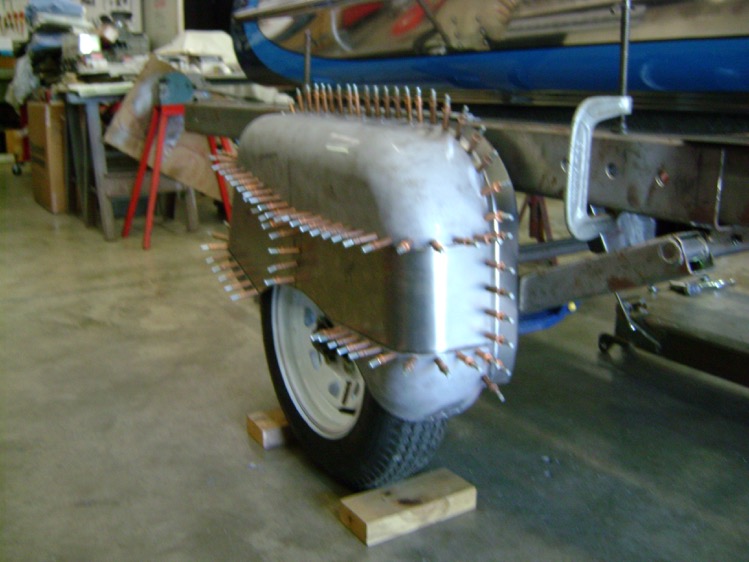

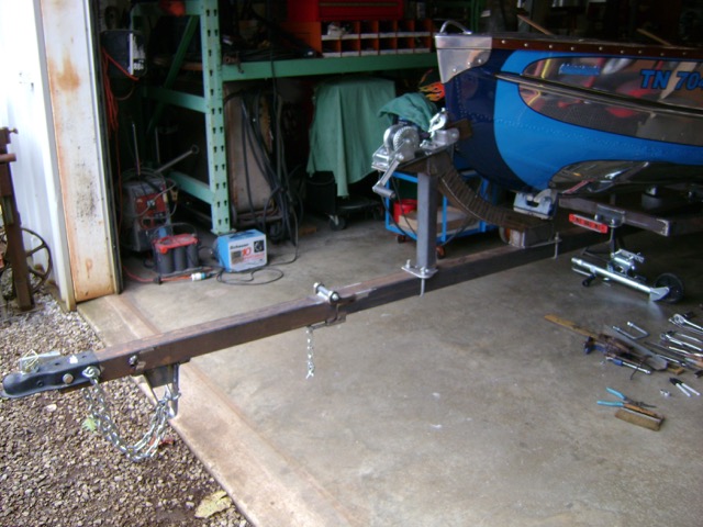

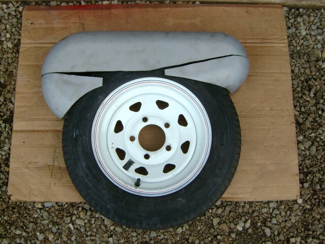

Next installment on the trailer as the weather is getting better & progress is being made. The bow arm has been fashioned with the winch post & the long tongue has been added. By making the tongue fold up the LOA is 19' with engine so the rig will fit in a standard garage. The fenders have been sectioned & will fold up for tire changes. Enjoy the pics!

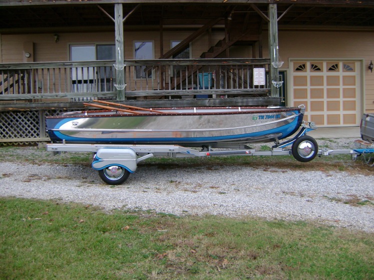

1953 Arkansas Traveler BF HD Utility 8 years 10 months ago #134939

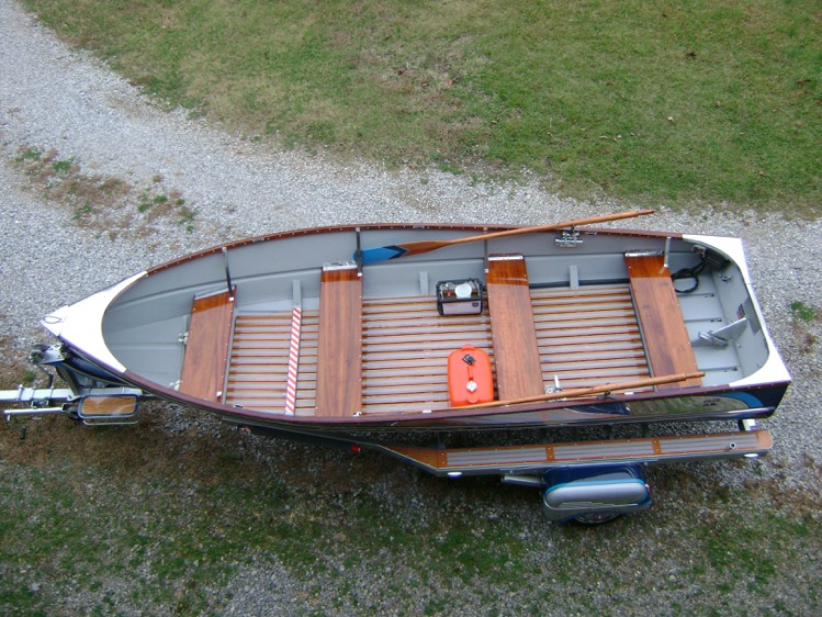

The boat is finally done. Took about 6 months. Engine is about done & should be ready for spring. Maybe get some running this winter if we keep getting these breaks in the weather. The boat & trailer turned out great. The trailer became a custom affair with many touches. I haven't been on the site in a while. Enjoy the pictures.

Thank you. I have plans & reservations to be there. I get there early & stay to the end. It will be in the water at the first of the week & hopefully in the arena later for display. That's the plan anyway. The trailer actually turned out to be more work than the boat. We used the independent suspension from the original trailer, but everything else is custom built. Much wider & longer. The fold up tongue makes it fit in a regular garage (19' LOA).

The boat was in excellent shape (better than me since it is the same age)! No metal had to be straightened. Only one small spot of battery acid staining. Easily removed. All of the wood was in good shape. We changed the paint pattern a little as it made the boat look fat in the bow (it is)! In our opinion now it looks a little sleeker. I go to a lot of AOMCI meets so had to have a good trailer. Ended up with a complete custom trailer that was overkill, but wanted something that would be a great ride for the boat. We thought we had a home built trailer, but turned out not to be the case (see other text). We used that design for the under carriage. Everything else is custom.

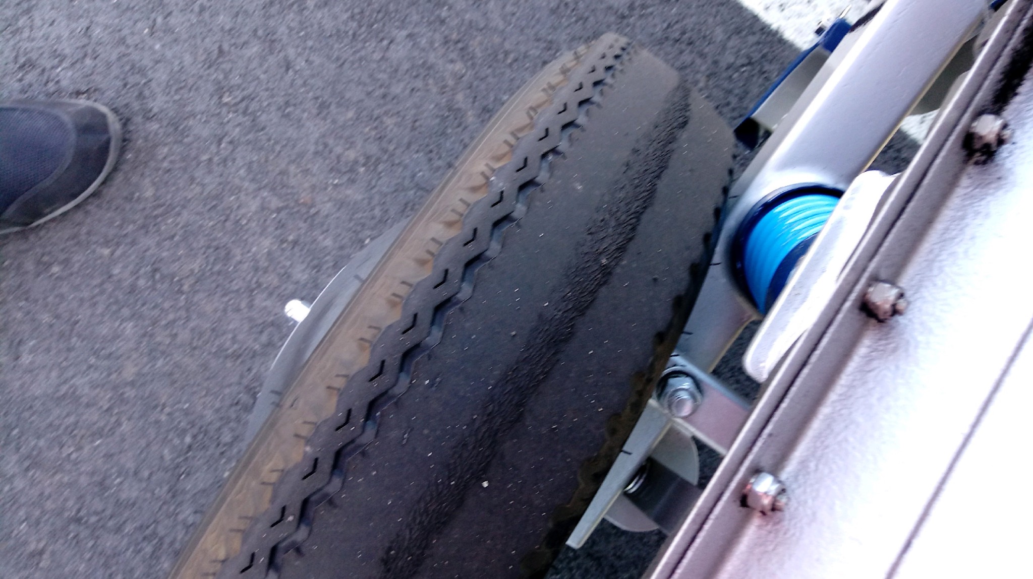

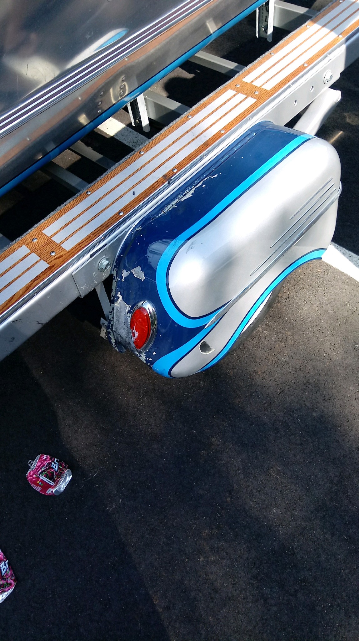

We are at Tomahawk! Made the trip fine until 2.5 miles from hotel. Suffered a blow out. Damaged the right fender. Next morning found out we have a wear issue with the tires. Got new tires to come home on.
Rained yesterday, but looking forward to running boat today. Hope to see you Dr. Go.

1953 Arkansas Traveler BF HD Utility 8 years 2 months ago #137161
