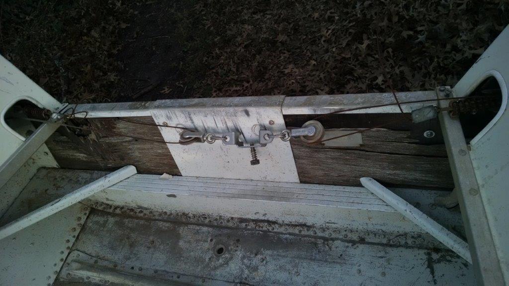

Hello all, my first post here. I recently took a Sunday drive into Oklahoma and this tin boat followed me home. I am going to give it a home and feed it regularly with some care and attention, but before I can give it a name, I need to figure out what it is. The guy I bought it from received it from his uncle who bought it new.
The title (yep he had a title) said 1957 Lone-star. But it measures 14.6" in length which fiberglassics library only lists this length in 58.
So i have located the hull ID 3420011, and was hoping someone would help me with the logic.
Thanks

Thanks amreame, After seeing this on craigslist for more than a month I decided to offer 60%. Did you have to replace the wood in the transom? I will need to do this and don't want to drill any more rivets than i have to.
I just took a closer look at the photo of the hull ID number and it looks like an 8 is leading the number, so 83420011. So I feel pretty good about it being a 58, but what does the rest of the number indicate?

Re:LoneStar malibu 195? 9 years 8 months ago #130751
Between the fins, the lower supporting "shelf" the transom ply should be in/on, the rounded hull sides and the corner braces, the Malibu transom ply isnt an easy pull and replace.
I cant remember, does the Malibu also have a transom knee brace connecting the transom to the bottom of the hull?
I wouldnt want to piece in a transom, all in 1 piece of ply is going to require some rivets to be removed and replaced.....
Re:LoneStar malibu 195? 9 years 8 months ago #130755
  • Laker
  • Laker's Avatar Topic Author
  • Posts: 32
  • Thank you received: 4
Thanks guys, for the information. I am hoping to replace the transom with 2 3/4" plywood pieces laminated together. I would also like to come up with a heavier sleeve that in cases the transom where the motor sets.
There isn't a vertical knee brace that connects to the floor, but there 2 horizontal braces that attach to each side. Actually the transom doesn't go all the way to the floor. It sits on a ledge about half way down.
My current plan is to remove the motor mount sleeve, top rail and bracing from one side. Then if I remove the ledge that the bottom of the transom sits on, I may be able to get new wood in place and slip it up into position.
Sounds so easy, right...

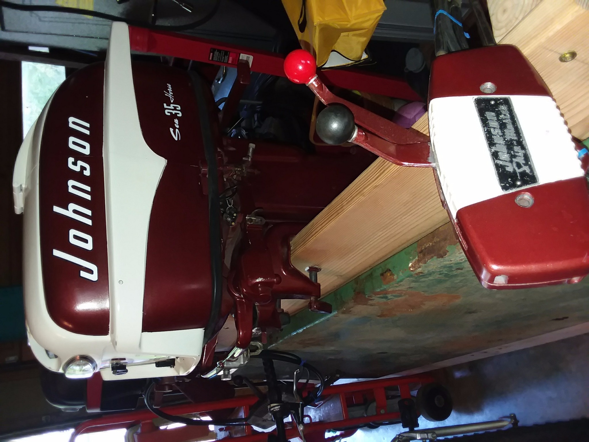

LoneStar malibu 195? 9 years 5 months ago #132117
  • Laker
  • Posts: 32
I ran across this Johnson 35hp motor that I think will work well on the back of the Lone Star. I can't say that I was really in the market to buy a motor yet, but I wanted an electric start and when I got to looking this thing over, I noticed the electrical connection box was larger than most. When I opened it up, it had a voltage regulator inside, that's when I got a big grin on my face and went ahead and bought it. I'm pretty sure the generator was an add-on option that year!!!
LoneStar malibu 195? 9 years 5 months ago #132121
  • Dr.Go!
  • Dr.Go!'s Avatar
  • Posts: 1719
  • Karma: 19
  • Thank you received: 125
Wow - what a nice motor! Don't see that condition every day.

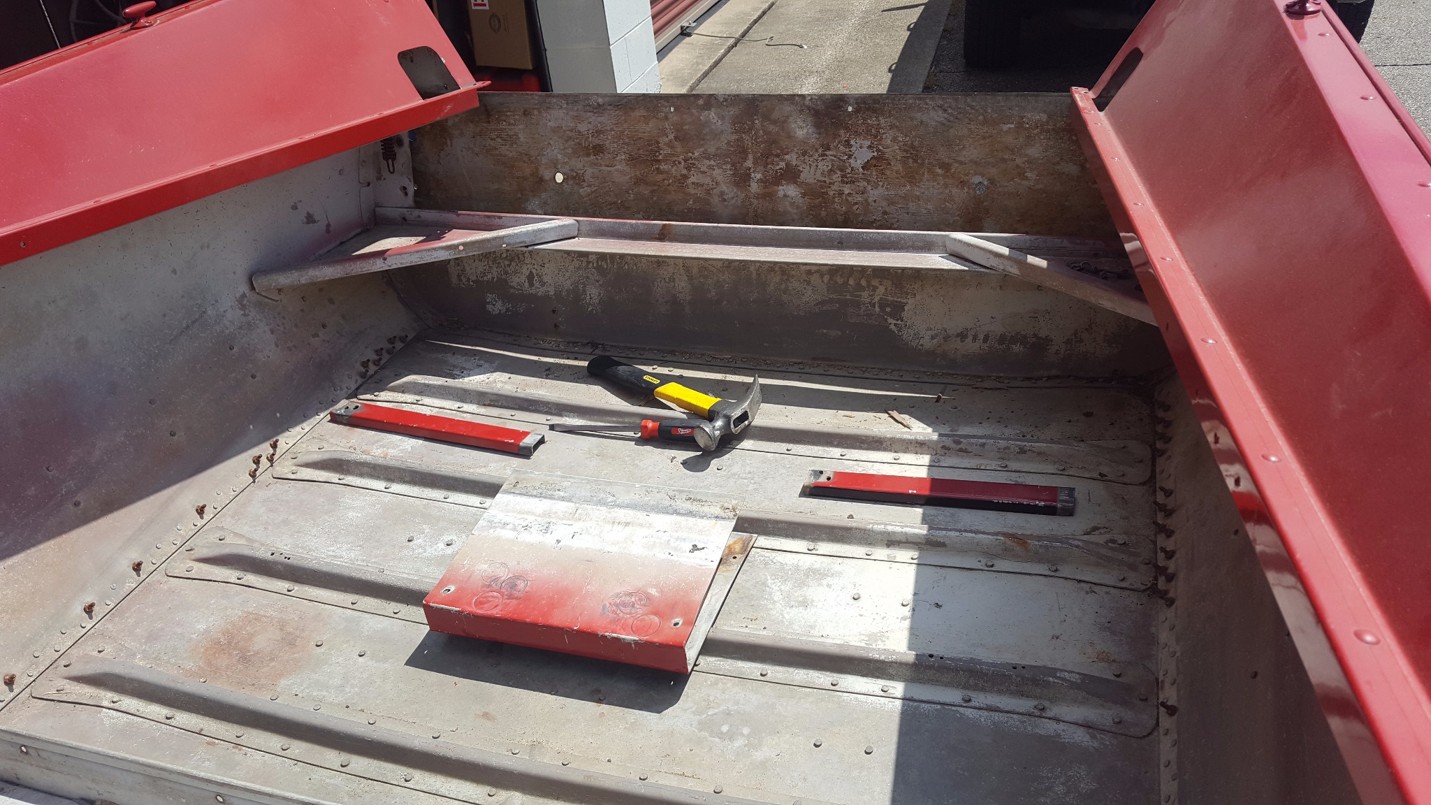

LoneStar malibu 195? 9 years 5 months ago #132126
Have you had a chance to dig into the transom yet? I finally started on mine this past weekend. It had been replaced (poorly) before so it came out surprisingly easy.

LoneStar malibu 195? 9 years 5 months ago #132133
  • Laker
  • Posts: 32
Dr.Go! wrote: Wow - what a nice motor! Don't see that condition every day.
That's why I had to go ahead and buy this one. The guy had it on the back of a restored Speed Queen, but sold the boat separately. He guaranteed it to run well and it came with all control and electrical cables. I probably paid to much for it, but it was one of those "I gotta have this"...
LoneStar malibu 195? 9 years 5 months ago #132134
  • Laker
  • Posts: 32
amreame wrote: Have you had a chance to dig into the transom yet? I finally started on mine this past weekend. It had been replaced (poorly) before so it came out surprisingly easy.
I did start on it, but it isn't completely out yet. But actually, it's the going back in that I am concerned with.
Did you do that rivet work in the bottom?

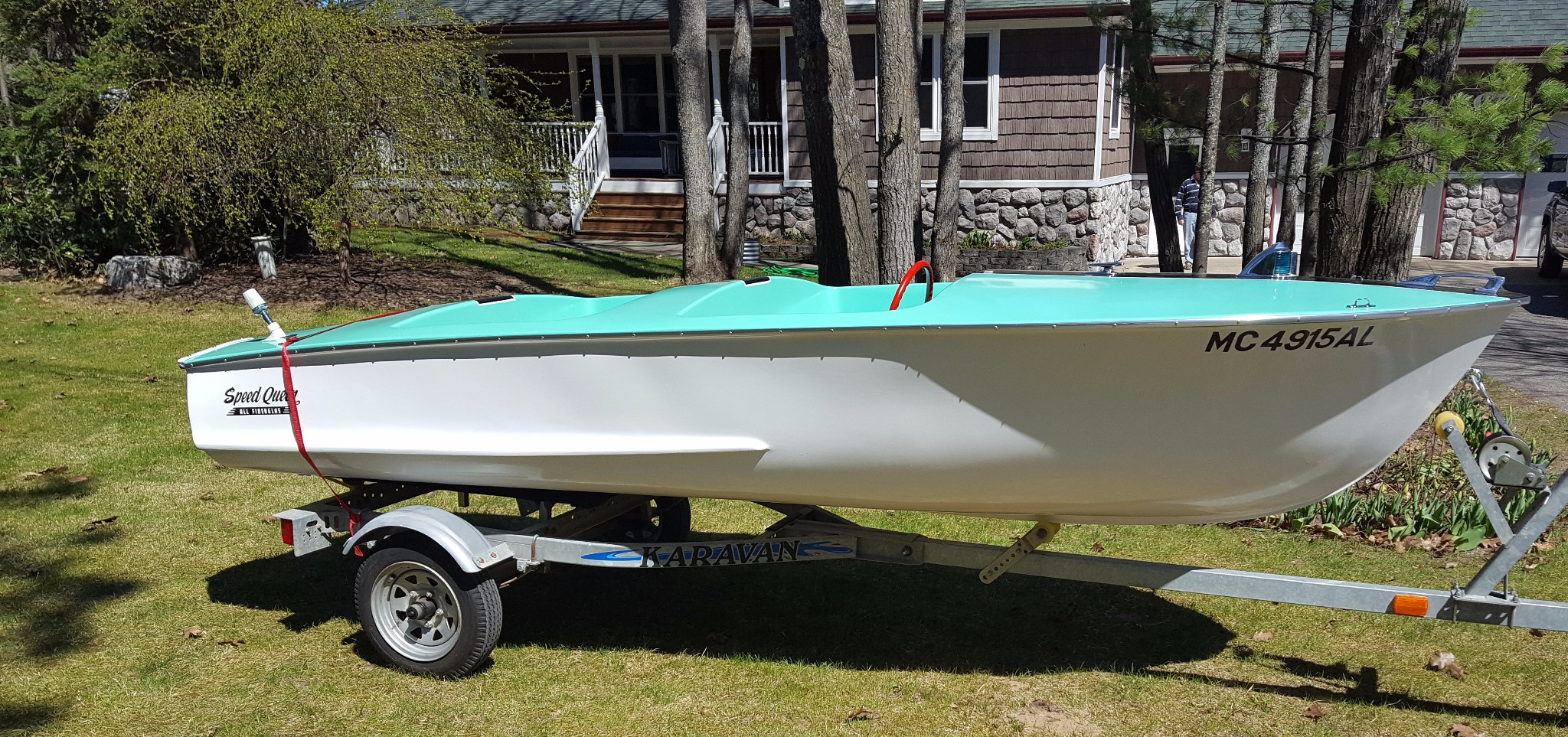

LoneStar malibu 195? 9 years 5 months ago #132139
Ha! I knew I recognized that outboard. I'm the guy who bought the Speed Queen. I paid too much for the boat too haha. I don't mind paying a premium for quality though.
Regarding the rivets, those had been done before I picked it up. I actually haven't float tested it yet but the guy before me said he'd been out on it and it was dry.

LoneStar malibu 195? 9 years 5 months ago #132159
  • Laker
  • Posts: 32
Wow... that is just way too funny, and to add that we both have Lone Stars that we are working on!!:laugh:
Thanks for sending the pic. I was wondering what that Speed Queen looked like. That is the house I picked the motor up at.
