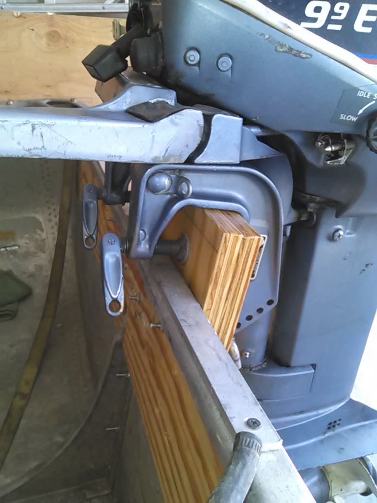

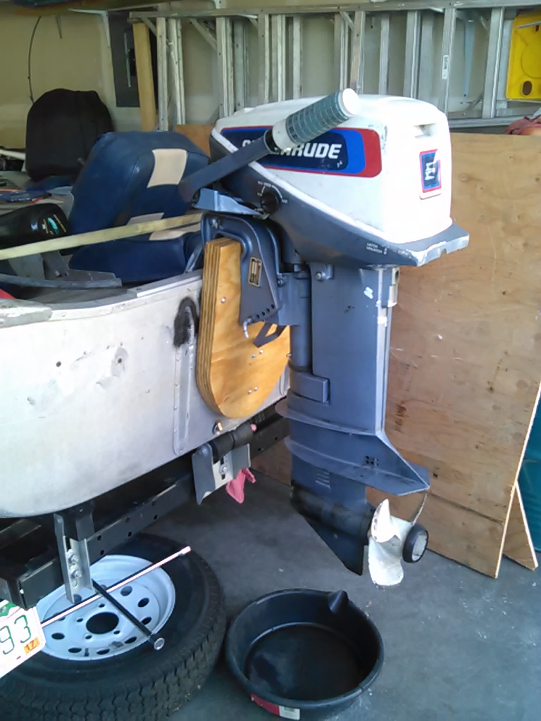

Wondering if anybody else has a similar setup. I tried it the other day and almost flipped. It just wanted to raise the nose and wallow around.
The boat has a 17" transom, and the motor is a 20" shaft, so I made a jack plate with 3" rise to get the cavitation plate right at about the same height as the bottom of the boat. The jack plate is also about 2.5" thick, so it puts the motor 2.5" back.

Re:1958 alumacraft semi V with 15hp evinrude 10 years 3 months ago #124824
Jackplate.
Re:1958 alumacraft semi V with 15hp evinrude 10 years 3 months ago #124825
Prop height relative to hull bottom.

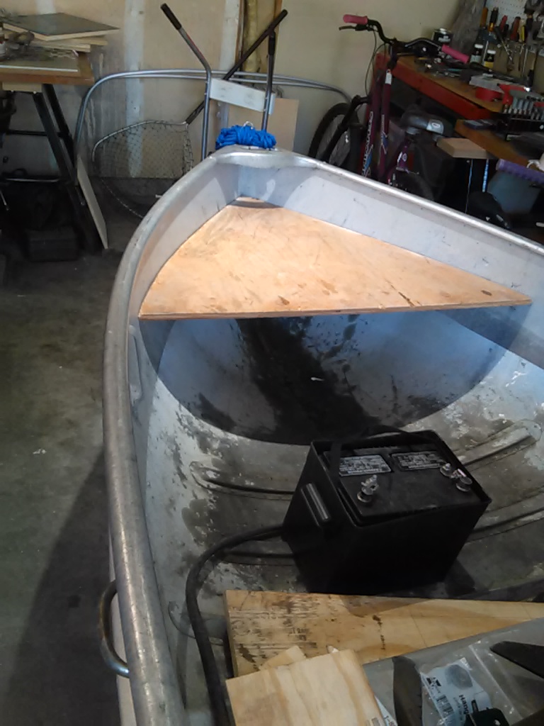

Heres where Im going with the front end. Ive removed the front seat, and replacing it with a simple plywood platform. Will bolt to same flanges that the stock seat was riveted to. Stock seat can be put back in. Im also planning a plywood floor under the plat form to hold the trolling battery and fuel tank. In test runs, I got fuel leakage onto the floor, and it looks like that could eventually cause a leak. So, gas and battery get a plywood floor, but rest of the boat stays bare.
Any suggestions?
Im also looking to add controls, and steering eventually. If this thing trims out well, then I would rather drive it in a conventional manner. Tiller steering was kinda scary with 15hp so far.
