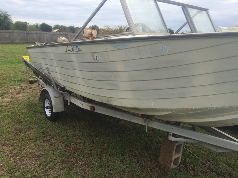

Re: 1964 Lone Star Medallion Transom Needs Replacement 10 years 8 months ago #120511
Starboard hull...
Re: 1964 Lone Star Medallion Transom Needs Replacement 10 years 8 months ago #120512
Port Hull

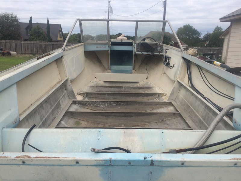

Re: 1964 Lone Star Medallion Transom Needs Replacement 10 years 8 months ago #120513
Gutted interior...
Anybody have a pattern for the deck? Please PM me...thanks!

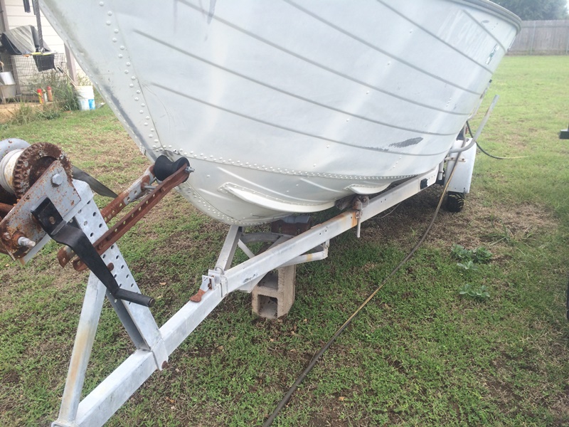

Re: 1964 Lone Star Medallion Transom Needs Replacement 10 years 8 months ago #120514
Stern

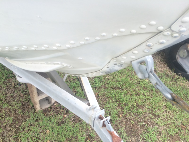

Re: 1964 Lone Star Medallion Transom Needs Replacement 10 years 8 months ago #120515
Ugly dent...

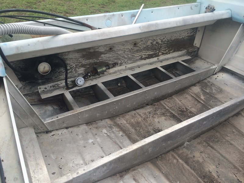

Re: 1964 Lone Star Medallion Transom Needs Replacement 10 years 8 months ago #120518
View from inside the boat...the rotted transom.
BTW...I found out exactly what I must do to gain access to replace. I'm going to have to drill about 100 or so buck rivets from the stern to the rear windshield support frame. Most of the rivets are along the gunwales.

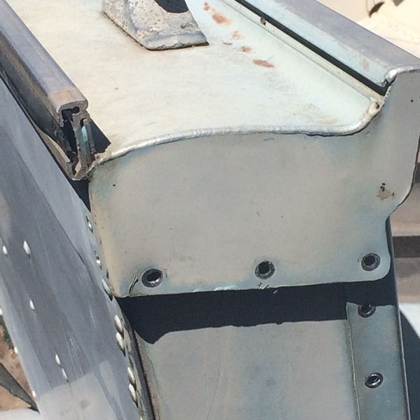

Re: 1964 Lone Star Medallion Transom Needs Replacement 10 years 8 months ago #120519
Project underway...port side stern view of the gunwale. This is going to take awhile...
