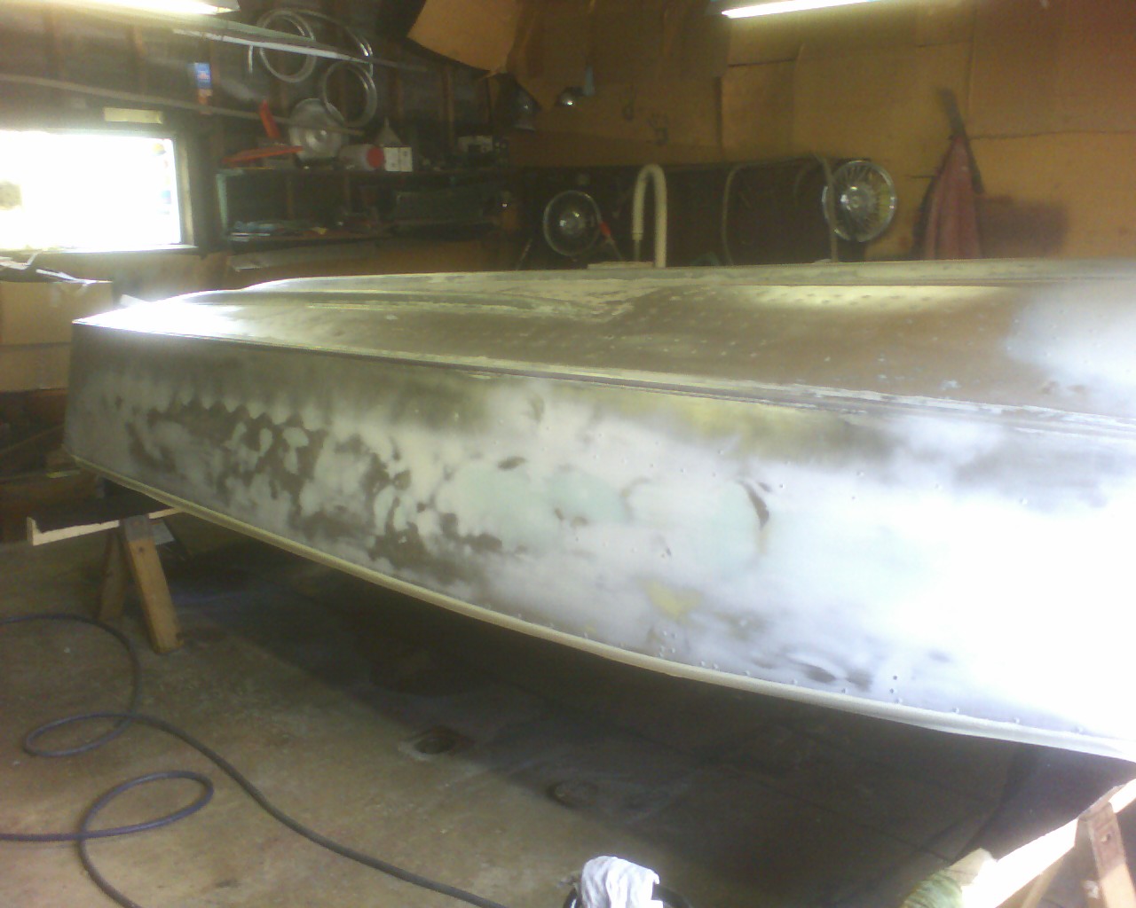

I have had an on going project boat with my 1965 Texas Maid and was wondering how far should I go with the dents in the aluminum. There are many of them and I would like to paint the boat but I know the dents would show up if I was to paint.
Alot of the dents I am unable to reach both sides to beat them out and I know filler is not that answer so this goes out to all of the lumies. Most of the dents are small shallow but still show.

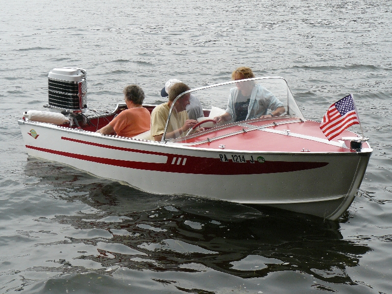

It depends on whether you're looking to restore for show, or, for your enjoyment. I did attempt every dock-dash, ding and indention I saw. I did use filler- evercote has a product that specifies for use on aluminum - be sure to get it level, or a small ding becomes a large 'ring around a ding'. And 4 years later, its holding up really well.
That said, every rivit is still an indention, and there are gentle waves throughout, so it will never be mirror perfect. Against a white paint, its not noticable, unless you look. But, I'm not out for trophies, just the pride of having restored dad's old boat for my enjoyment.
So, my two cents, make the attempt, use the right fillers, and don't be too upset if you end up less than perfect.
Hmmm, the photo really doesn't show how much of that is the filler [light green color] vs. the primer, but yeah, it was banged all over. now its done...
