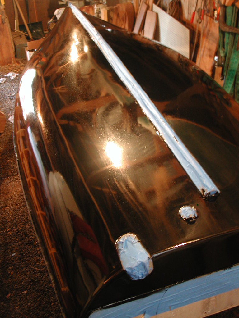

“I see a red door and I want to paint it black.” I’m dating myself here. Paint It, Black was a Rolling Stones hit of 1966. I remember it well, along with Ruby Tuesday and a line from that song that is my motto “Lose your dreams and you will lose your mind.” “Paint it black” strikes fear in the hearts of anyone who has ever tried to get a good finish with this color. But wait! Black is not a color. By definition, the absence of color is, well, black. Are we confused? Color or not, painting a boat black can be an absolute nightmare. But a good black paint job (or any other dark color) is a beautiful thing on a boat. After restoring many boats and applying a rainbow of colors (including the not a color – black) I have developed a technique that I think will work for anyone willing to give it a try; wood or fiberglass. So I will describe, probably in more detail than need be, how to get a really nice finish using the high gloss paints available to us. In particular, I will focus on the Interlux Brightsides line of paints as I have developed a love affair (shows you how needy I am) with this line of paint.

The finish you will end up with will be as close to a sprayed appearance I think possible. If you can get a great paint job in black, you’re ready to handle any color of the rainbow. Good luck!
