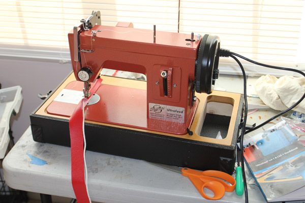

The ultimate, though, is to use a true industrial machine- especially one with a walking foot. Keep an eye out for used ones- I see them on Craigslist all the time. New ones are not cheap, but in my opinion worth every penny. This is my machine, a Sailrite LS-1-
It is a compact, portable industrial walking foot machine designed specifically for this type of heavy sewing. The top foot 'walks' as it feeds the material through, which results in easier feeding and far more consistent stitching.
Use the best machine you can get your hands on, but don't let not having an industrial machine stop you- There is a lot that can be done with a heavy household machine.

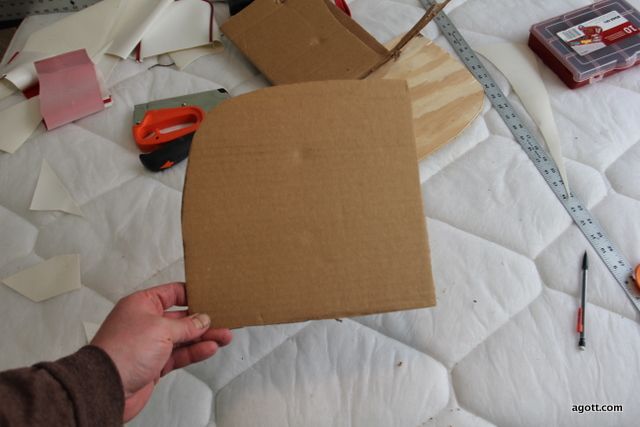

First, you are going to need a pattern in the shape of the cushion that you want to make. I like to make mine out of cardboard, since they hold their shape well. Get the pattern PERFECT- The finished cushion will only be as good a fit as the pattern that you start with.
Here is the pattern we're using-

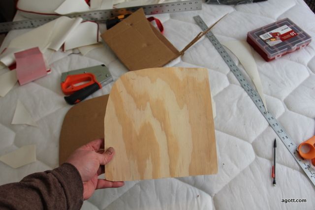

This cushion will have a plywood base, so we need to cut a piece of plywood to size-
You should use a decent plywood, and certainly an exterior grade. 1/2" or so is sufficient. If I were actually going to use this one on a boat, I'd paint or coat it somehow... But for this demo I'll just leave it raw.

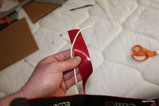

First, you need to cut a LONG strip of vinyl. If you cut it across the width, you'll only get 54" strips... You can cut them along the LENGTH of the material, to get them longer, or you can join multiple strips together to get whatever length you need. They need to be about 1 1/4" or so wide. Mark and cut them accurately, as it will make sewing them a lot easier. For this project, we're going to use a flashy red glitter vinyl for our piping-

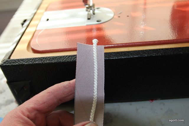

The piping cord is what we're going to sew the vinyl around. It will provide the form, shaping the vinyl, and adding structure to it. In this example, I'm using 1/8" nylon rope. Just make sure you use a synthetic material that won't rot...

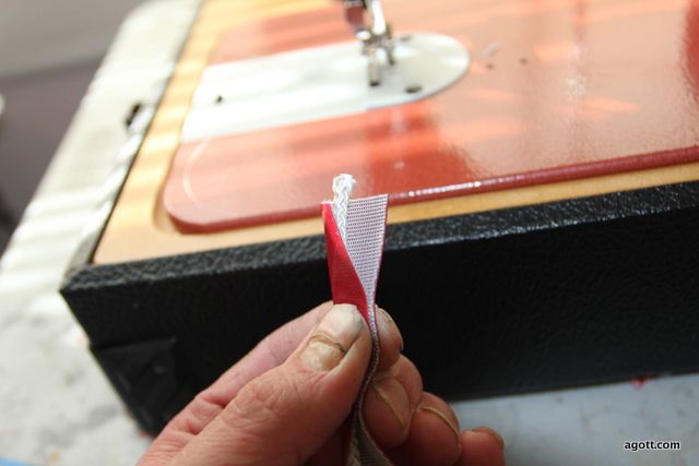

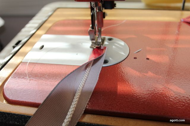

Lay the cord down on the strip-
Then fold it over-
And place it under the foot-

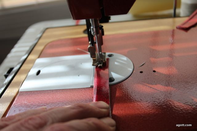

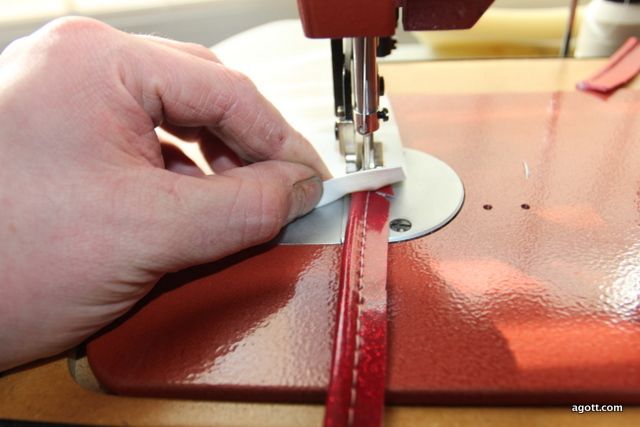

You want the needle to be as close as possible to the welting cord- which you can only do with a welting or zipper foot. The closer, the better-
Start sewing it, feeding it into the foot as it pulls it along. Use a relatively long, straight stitch. With a piping foot, it'll pretty much feed itself, your job is to keep it even and lined up. Go slow, you'll be fine. This is the end result-

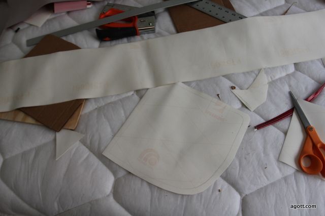

Next, We'll need to cut the material out for the top of the cushion... The 'technical' term is the PLATE. We'll use our template-
Mark it on the BACK of the vinyl. I like to use pencil. You can also use permanent marker, but make sure it's not going to bleed through! Some 'migrate' over time and will show up on the outside of your finished work.... That'll ruin your day.
You'll notice that I did NOT cut it on the outline- That's because I need a SEAM ALLOWANCE in order to join the pieces together... It needs to be at least 1/4", up to about 1/2". It's better to cut a little too much, since you can always trim it later.
The sides of the cushion will be made from a 7" wide strip of vinyl. This gives me plenty to work with to sew it on, and then stretch it over the foam and plywood when I staple it.

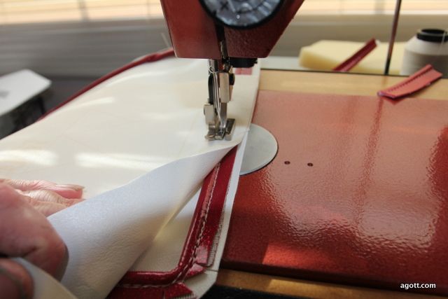

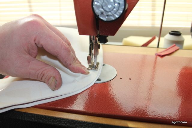

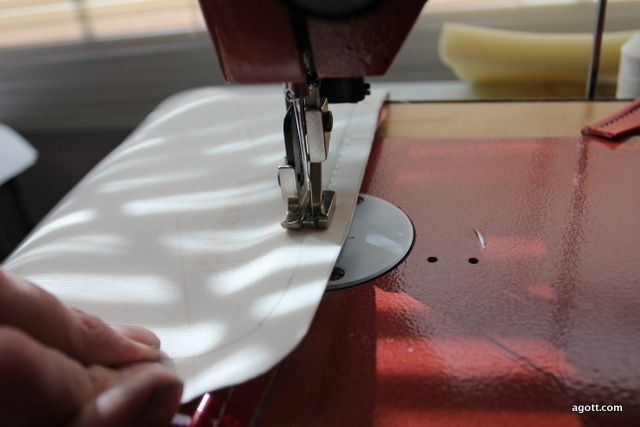

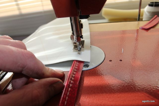

Start on one of the back edges of the cushion. This is how you'll run it through the machine-
The finished side of the vinyl is facing DOWN, the piping on the bottom, and the line to sew along is on the top. The piping foot is still being used- It'll 'feel' the piping through the vinyl and help you to guide it. You'll need to feed the piping cord into the foot, and keep it all aligned on the line you marked as it feeds into the needle.
Don't start at the very end of the piping- Leave a small (2" or so) tail. You'll be tucking this inside later to hide it.
Keep sewing down your line. Use a straight stitch, with a medium length-

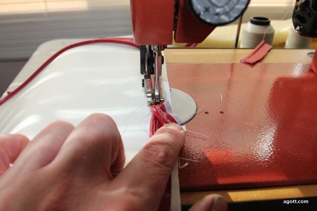

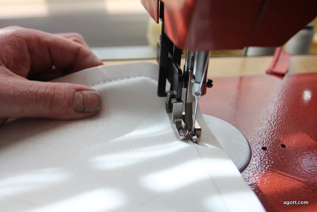

The 'straightaways' are easy, but curves and corners are a bit tougher. This corner is the gradual curve, which isn't too difficult. Just feed it into the foot, keeping the piping lined up with the pencil mark... just turn your work as you go.

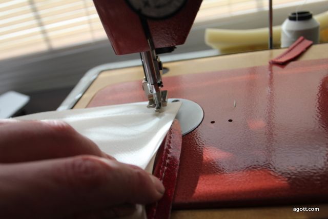

The sharp corners are a BIT tougher, but still not bad. You'll want to cut a 'relief' cut in the piping, as shown here-
the cut is right at the corner, and it allows the piping to make a sharp bend. Sew right up to the corner-
With the needle still down through the material, lift the foot-
The needle will hold everything in place.
With the foot lifted, pivot your work 90 degrees as shown-
Now, you've got a 90 degree corner. Keep sewing down the straight edge-

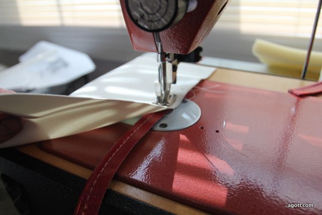

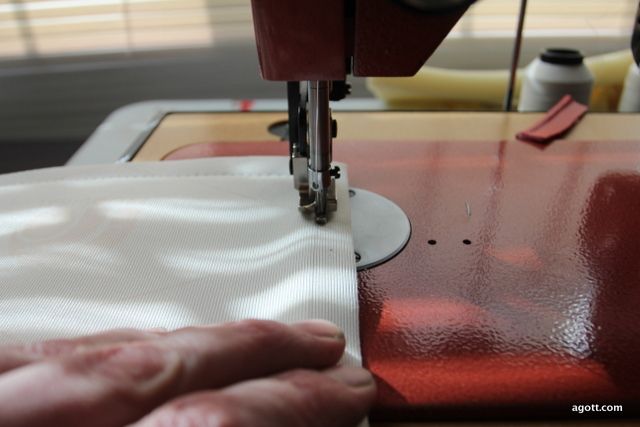

Just as with the piping, start on the back of the cushion, since you'll have a joint here. Leave a tail, just like with the piping, about 4 inches or so long.
Sew along the edge, to the corner-
Then, just like when you were putting the piping on, sew right up to the corner.... Leave the needle down, then pivot it around the corner like this-
Keep sewing it like that all the way around, stopping about 6" or so short of where you started.

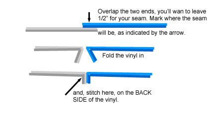

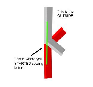

Now we need to join the two ends of the side panel. Now, Some people will do this differently- They'll measure it accurately, add a seam allowance, and stitch it before hand. But, I find it a lot easier to do it this way.
Overlap the tow edged, mark them, and cut them like this-
Here's how it'll look when you're done-
Hopefully, it'll make sense to you. Once you've done it once or twice, it's easy.

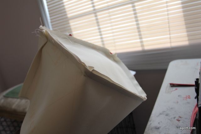

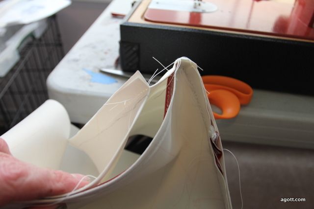

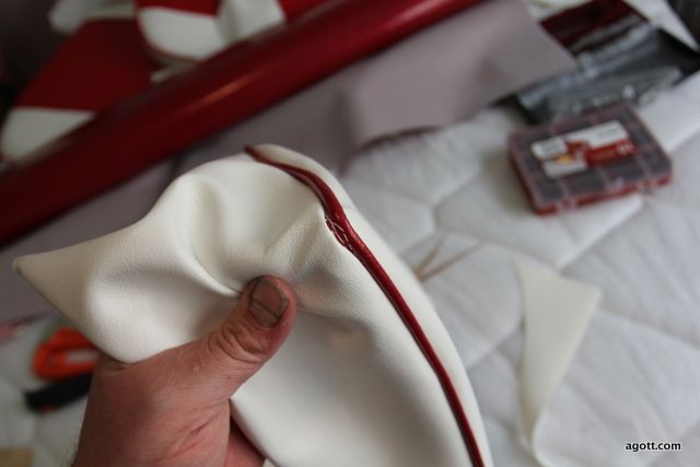

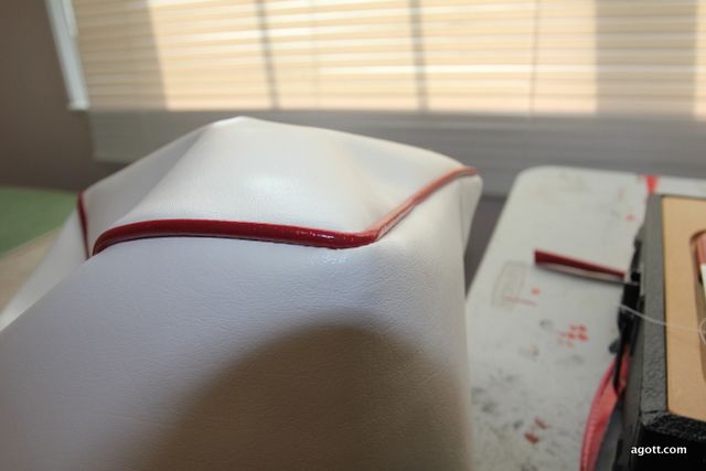

Now it's time to flip it 'right side out' and check our work. With luck, It'll all be perfect. But, odds are, there will be a spot or two that aren't quite tight, and look like this-
you can see some of the stitching on the piping, since the seam wasn't close enough to the piping. That's OK, though- Just flip it back over, stitch it closer, and flip it over again. Now it's right (and tight!)-

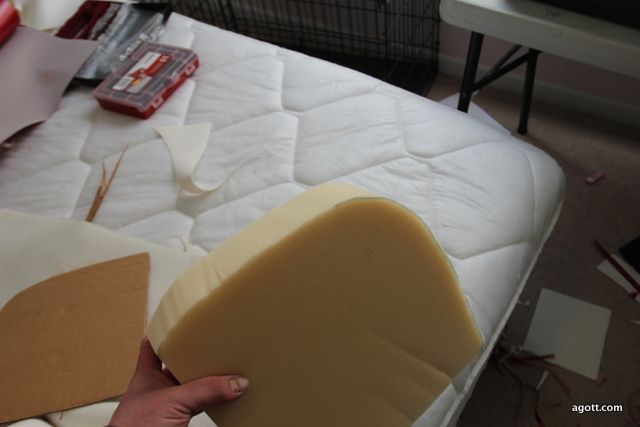

I'm going to use 3" foam for this. In a medium stiffness, it is great for seating- Firm enough that it doesn't bottom out, but soft enough to be comfortable. We'll use our template here, too-

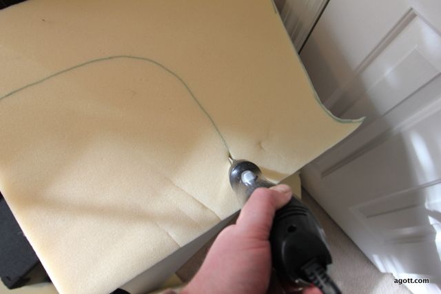

A sharpie is the easiest way to mark the foam. Notice I didn't follow the outline- The key to a full looking cushion is to overstuff it a bit. Just how much will depend on the size of the cushion- for one this small, about 1/4" to 1/2" all around will be sufficient. For larger and longer cushions, you might want to use an inch or more.
The easiest way to cut the foam is an electric carving knife- So start scoping out the local thrift stores for one if you don't already have one around.
They aren't very expensive, about $15- $20 new, and WELL worth it. There is simply no better way to cut this stuff!
Cut out the foam insert, being careful to hold the knife at a 90 degree angle to the foam, so you have a nice, square edge-

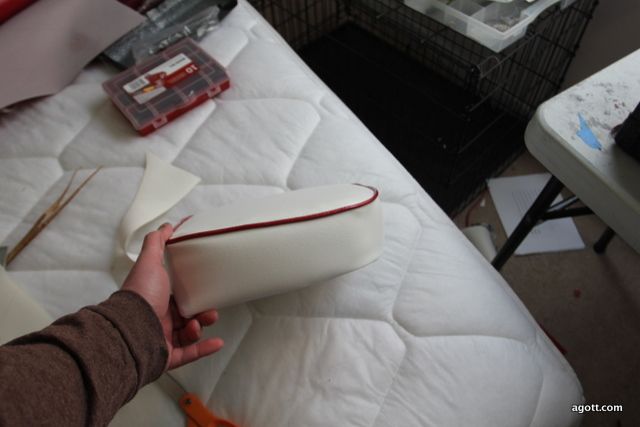

Once you're done cutting, you will have this-

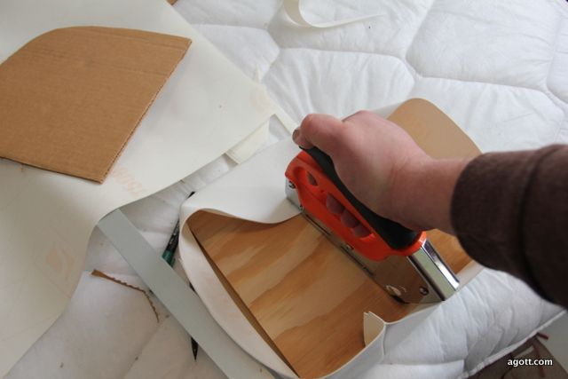

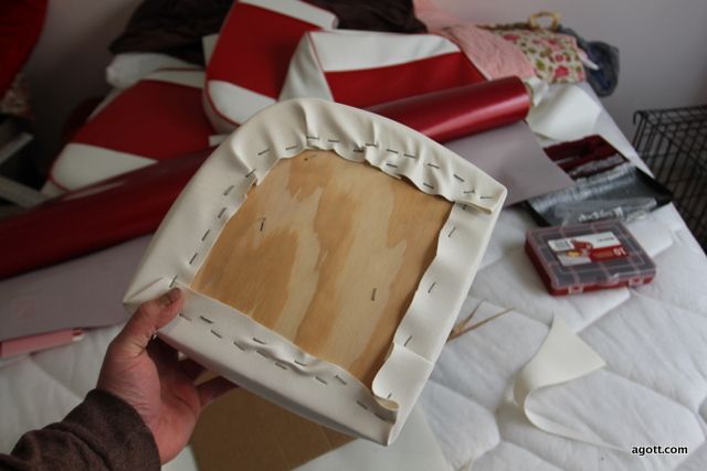

Put the foam in the vinyl, then put the plywood on top. Make sure you've got the plywood centered. Pull one side tight, and staple it to hold it-
Start on the front of the cushion, since it's easier to get it tight and straight, and that's what will be showing.
Now, go to the opposite side, pull it tight, and staple it again-
Keep pulling it tight, then stapling, alternating sides to keep it all tight and even... You'll want to use plenty of staples, to hold it all in place... Then you can trim off the excess-

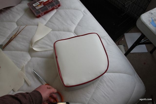

Now, it's DONE!
Wasn't that easy?
Here's how it looks-
