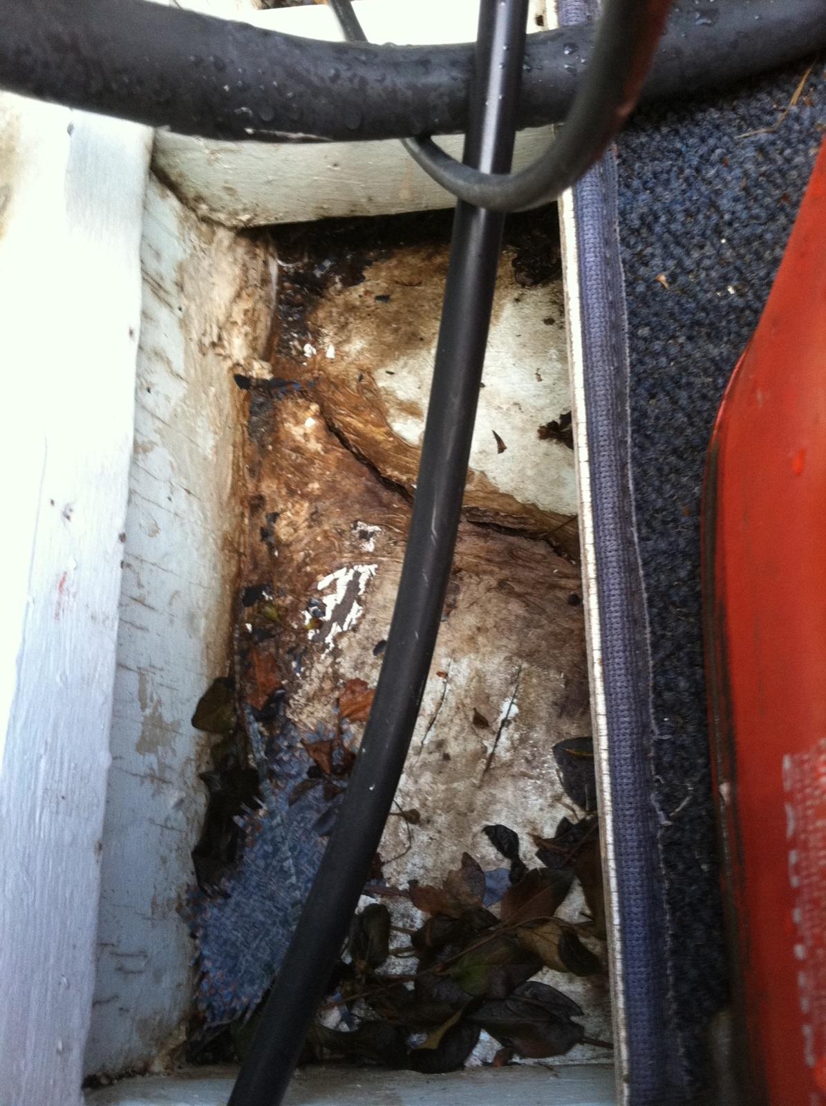

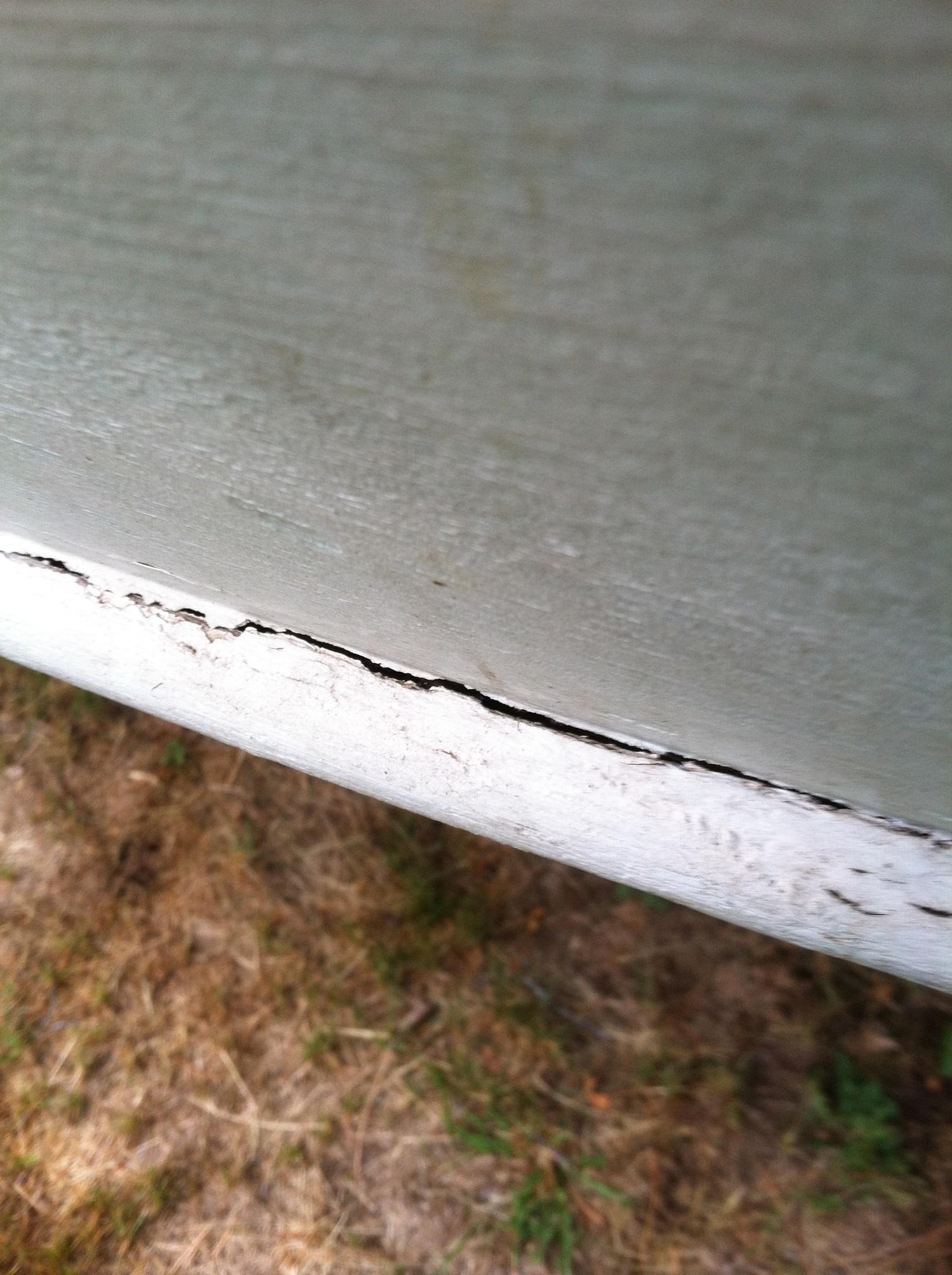

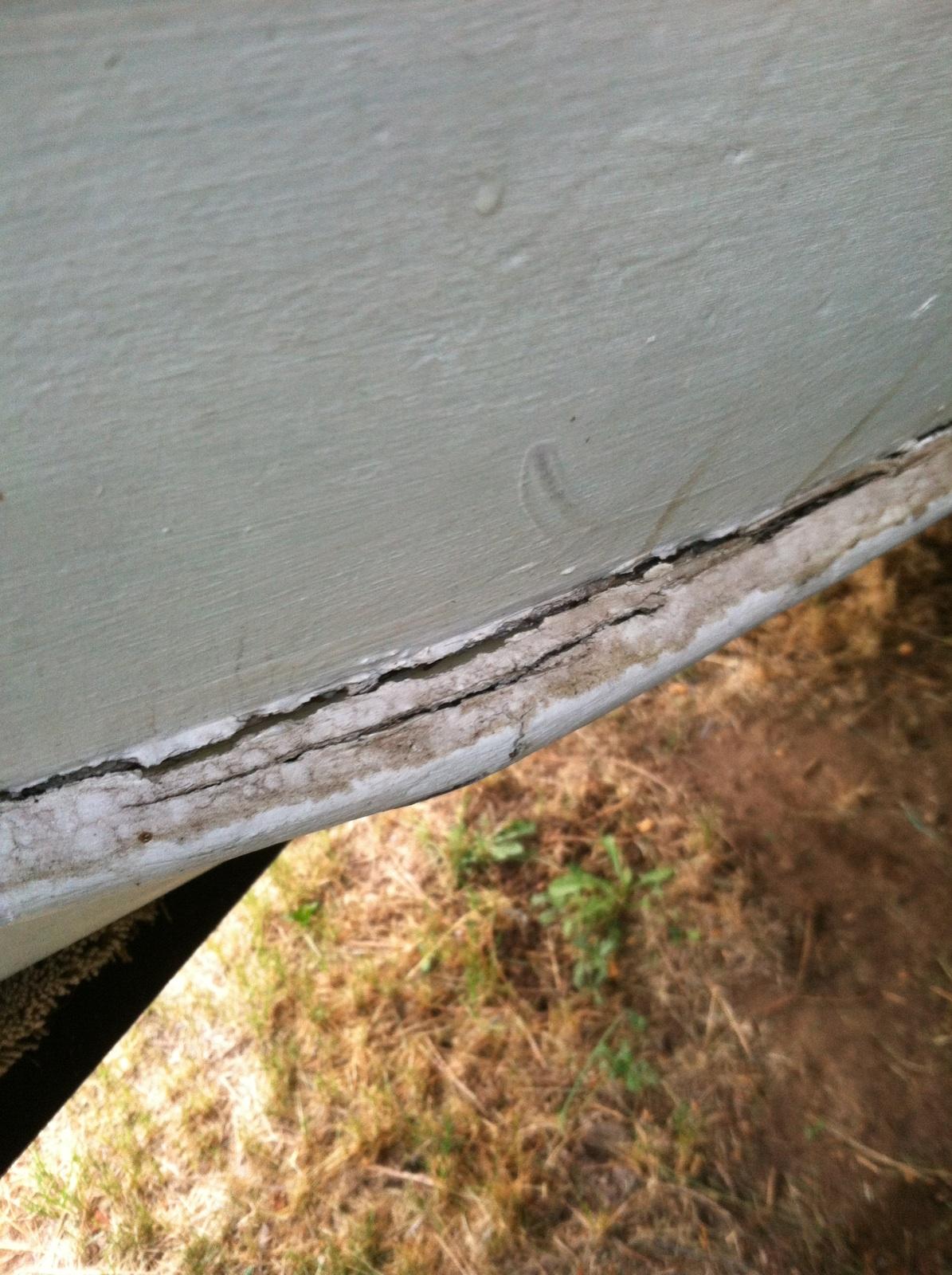

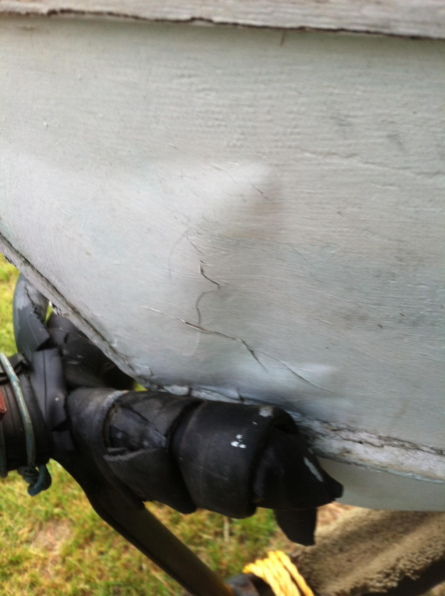

Was having trouble with images, but I think I have it figured out. So looking at buying this 1950's yellow jacket as a project boat. If any yellow jacket guru's can help me out with some identification I would be very happy. Also I don't know an awful lot about fiberglass repair so I will attach some pictures of some hull problems.
Let me know what you think seller is asking $500. It has a 1959 35hp Johnson

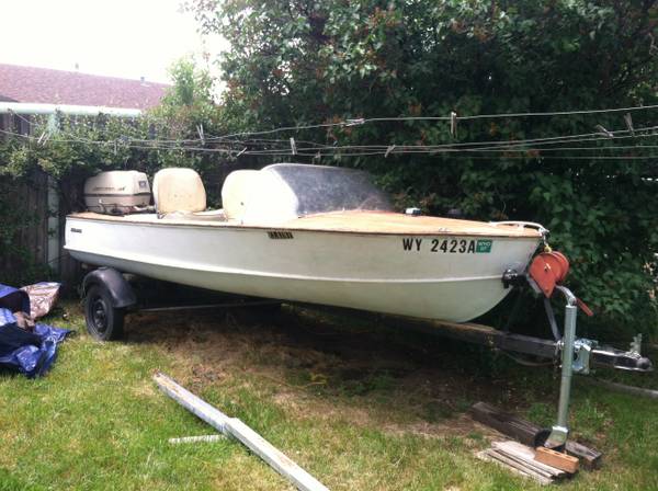

Without photos of the top of the deck it is hard to tell the year. The metal tag on the back along with a painted hull, tells me it is a 1951 through 1954..
In it's day it had a dark green painted hull. From what I can tell the 1953 was painted inside white from the factory where the 1954 were varnished.
Fiber glassing these boats will not work out. they flex too much that glass will not stay. A bit of TLC and time you can repair them using wood.
A good shot of the deck will tell me more about the year of being a 1952, 1953, or a 1954 (if it has not been changed)

NO the hull is not fiberglass it is plywood.
Someone may have glass over it (that was big in the late 60s).
The deck photo is a bit small and hard to see however it takes out the 51 52 years. I am thinking that the inside being painted it may be a 53. If it still has the darts on the deck rounded ones make it a 53 for sure, and pointed ones make it a 54.
The first glass Yellow Jacket came out in the latter part of 1957,
They do not look anything like the plywood boats.
The shot of the bow the worst spot. however being the boat is painted it is fixable. The area that you shot of the boat and the spray rail separating is no big problem. They are screwed in from the inside. I would take them off and make new ones. You can have them made of white oak, again because the boat is a painted hull...just watch your grain as to be sure it does not run across the piece for you will have to bend it. Start if from the bow and work back.
A lot of work...try to talk him down for you will really need to remove the glass coating added. It traps and hold water causing rot
BTW the seats are add ons as is the windshield

wyoming.craigslist.org/boa/4540980993.html
also hear is a link to the craigslist ad. there is a better picture of the deck. I don't see any arrows, but it is awfully worn.

That boat has a king plank so I betting it is a 1953 model
