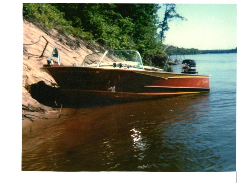

This was the boat that I honed my skills on. It was a boat that my father built in 1959 from a kit using a hull from U. S. Molded Plywood. I got the boat in about 1980 and had to learn to strip, bleach, stain and varnish the deck. For a 16 ft boat it had a lot of varnish. My skill definitely improved every year after that first experience. With practice and sites like this it gets easier every time.
Bill

Re:WHICH IS THE BEST VARNISH FOR BEGINNING RESTORERS? 12 years 7 months ago #91062
Thanks,
It was a great little boat. I got 11 years out of it before rot at the base of the transom took over. Being a molded hull,it was beyond my skill set at that time to repair it. It sat with water in it for a couple years before I got it. My dad sold it to the son of a friend after the original motor threw a rod. So there it sat, half covered for a couple years until the guy realized he wasn't going to do anything with it. He called an asked if I knew anyone that wanted it. I went and picked it up thinking I could at least salvage what I could, such as hardware and the glass windshield. Once I got it home and started digging into it I decided it was usable. I spent a couple months on the boat and found a power head for the motor and the rest is history - I was hooked. Half of the bow hangs on the wall behind the bar in my basement, and the bar top is made from other parts including the part with name painted on it.
Bill
