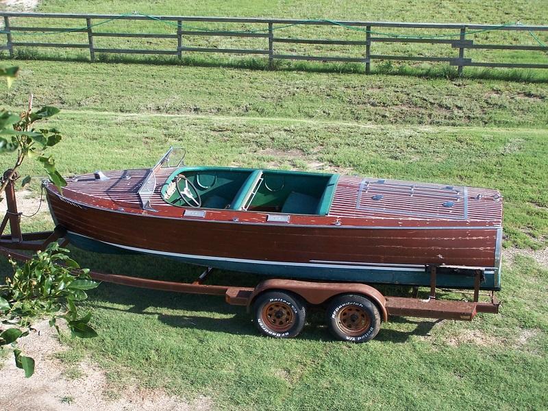

We have a 1929 Dee Wite arriving soon. We're really looking forward to the complete restoration and re-power of this rare mahogany thoroughbred. Of course, I'll post before/during/after photos.

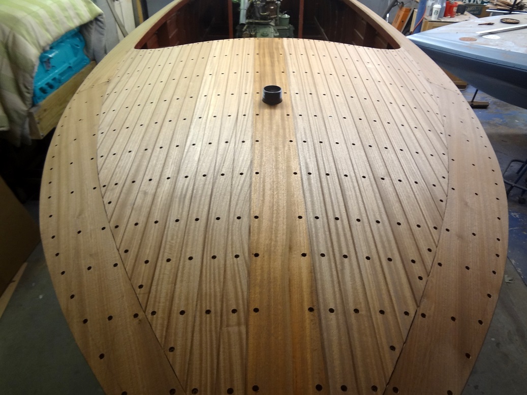

Finally finished the wood replacement...about 65% of the framing and 100% of the planking: bottom, hull, topsides and transom and about 4,000 bungs. I suppose it's still a 1929 Dee Wite but there's a lot of 2015 in it.
Now all I have to do is some semi-serious sculpting with a sander to fair it all together. That African mahogany is some hard stuff so I'll rough it in with 40 grit...or maybe 6 rocks glued to a hunk of cardboard.
