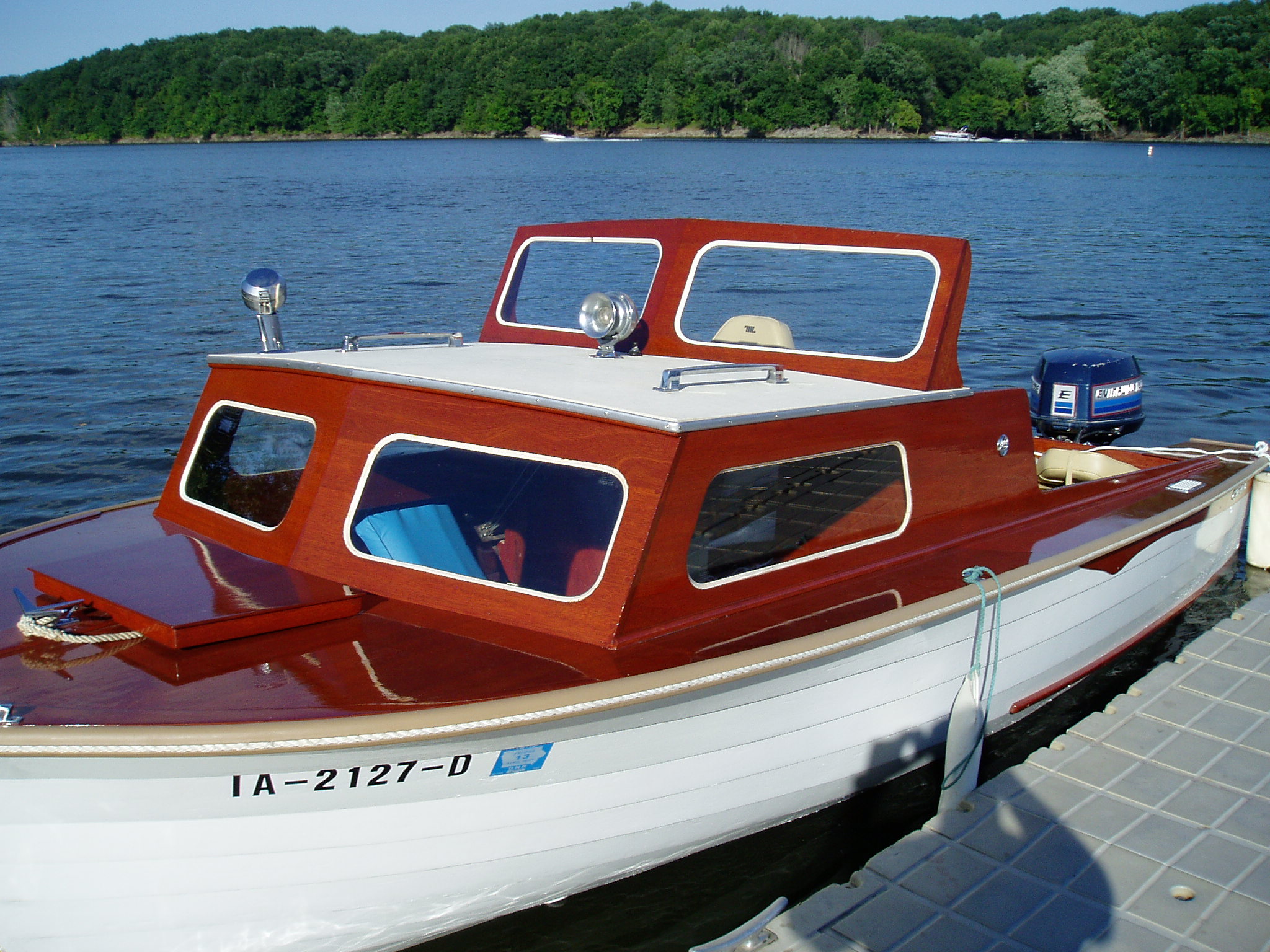

Shipster,
You tell me, 12 coats of Epifanes.
10 coats of the newer fast build stuff and 2 of the older original blend UV protective stuff.

Hi again.
Bob, Beautiful boat!! TWELVE coats?! I think I now know why my paltry FOUR coats of spar varnish looks crumby after only 2 seasons. Zoicks. Anyway I picked up a quart of extra UV-filter high gloss clear Epifanes for about the same price that I was getting Coronado Marine Spar Varnish for. I'll use up what spar varnish I still have and then jump to Epifanes. I'll report back in another 2 years to let you know if there's any improvement. 12 coats...
Re:Epiphanes 14 years 7 months ago #58228
Yeah I didn't want to have to do it again for quite a while. ;) I'll tell ya, with that many coats it makes a nice valley of fillet where the King board and others meet the bow deck. I don't have to worry about water accumulating there and getting under neath . Also makes it nice when I hose it off with fresh water. Just hit it with the towel and cleans up nice.

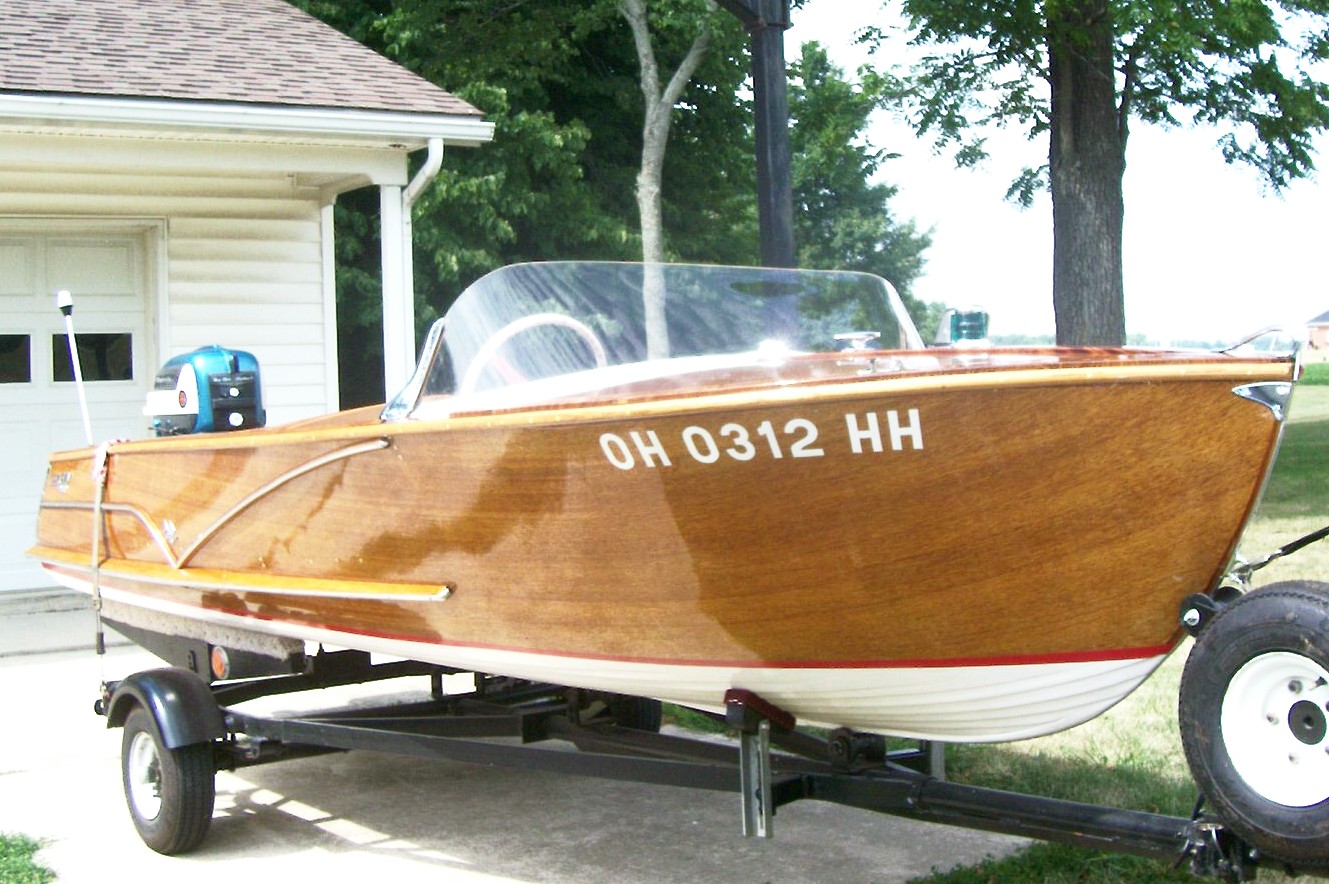

Personally, I think Epiphanes is prone to sagging, over-rated and over-priced. I use Easypoxy high gloss exclusively. It's user-friendly, gives great results and very reasonably priced. Wholesale Marine has it on Ebay for under $30/quart! Check it out:
Here is a shot of a GarWood I refinished with Easypoxy...only five coats.

Nautilus,
Exquisite boat, excellent work! I'll have to keep that Easypoxy in mind for my Century. Everyone has their favorite so to speak. I have to admit the Epifans can sag, did for me in a few spots. Also 12 coats is definitely overkill but like I said I didn't want to have to do it for quite a while. ;) Classic Boat Connection has it for $28/liter, even cheaper if you buy the six pack. It was just my choice at the time. Don't know if I'd use it again just because it goes on finicky. I think I want to try something a little less temperamental next time.

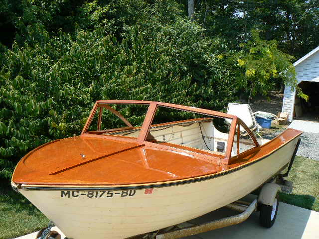

There is about 18 coats on this hull. But, I sanded many of them off as I built up coats of varnich to fill the grain. I am pleased so far.
Re:Epiphanes 14 years 7 months ago #59062
Beautiful work!
