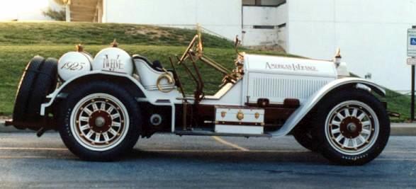

I used to be a home improvement contractor and self-taught cabinetmaker who restored antique cars for a hobby. Then I restored a 1980 CC Scorpion but went crazy on the custom woodwork...it drew crowds. After that, I restored the Elco 57...then did the 1961 Century conversion. After THAT, people were coming out of the woodwork asking if I could do their boat. A new career was born. So...I hire a helper, build a website and suddenly I'm a marine mogul! HA! It's like retirement with pay. After all, if I was really retired, I'd be restoring old boats, right? "Give me your tired, your poor, your huddled masses"...of dead boats.

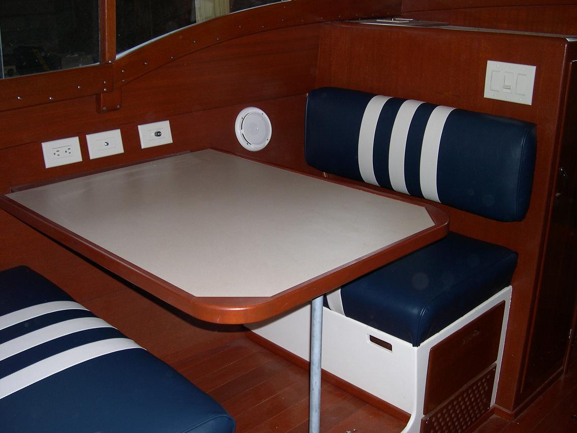

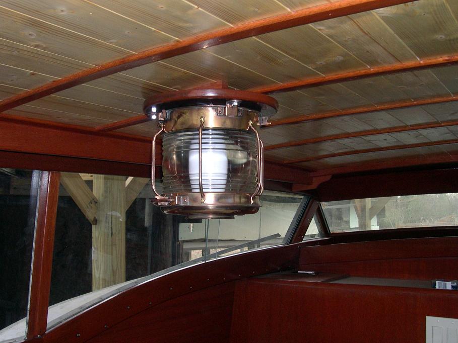

Found this red brass ship's light with a Fresnel lens on Ebay...cheap. Polished it up, re-wired it for 110V and built it in over the dining table this afternoon. Not original CC but the owner loves it.

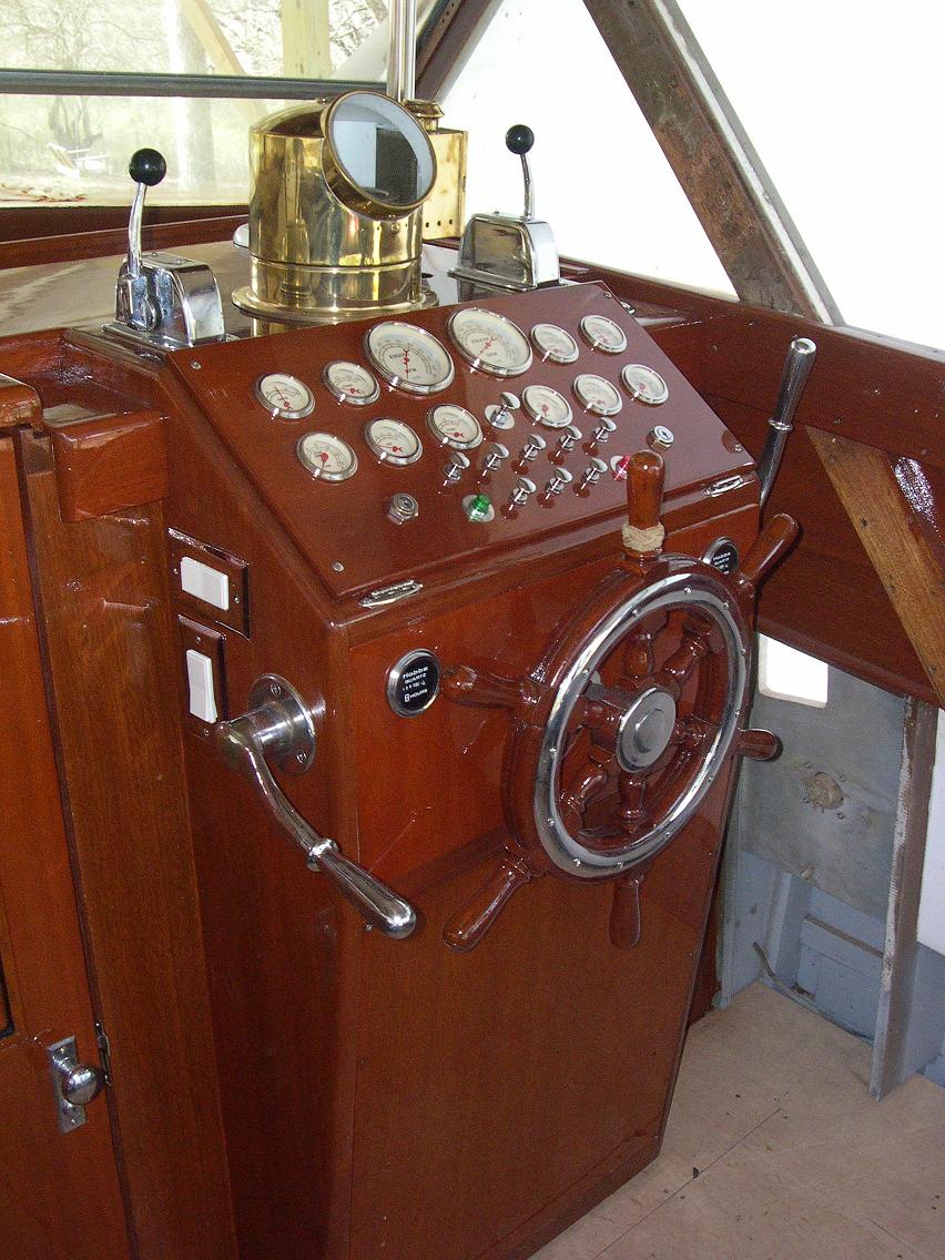

Helm has been completed:

Wow, beautiful work Nautilus! Sure would like to take a ride over there to your place someday and check out some of those beauties in person. 'Course the way gas prices are going.......... :S
I noticed that you're now an advertiser here on FG, THANKS for supporting this great resource.
Re:1958 CC Commander restoration 13 years 6 months ago #56967
Excellent work my friend, that looks awesome!!!!!!!!!!!!!!!!!!!!
Re:1958 CC Commander restoration 13 years 6 months ago #57139
  • Posts: 4709
  • Thank you received: 167
Beautiful! Love the mahogany look, just can't be beat. Fun wood to work with also.

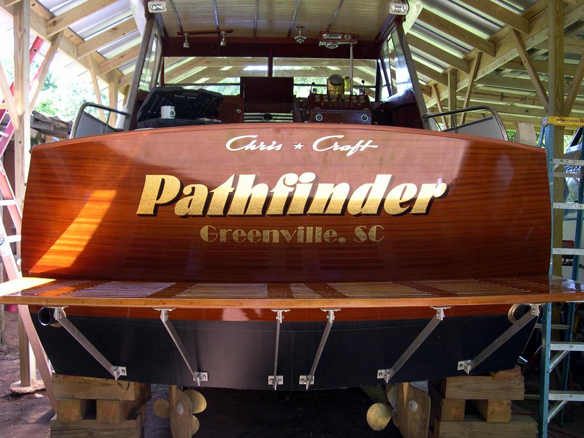

Have been making progress on the restoration. The projected re-launch date is 6/14/12.

Nothing like a good pic of a beautiful stern. ;)

I have great respect for anyone willing to restore a huge wooden cruiser. So many rot away just because they are too much work to fix. Beautiful! with a capital B!

That is one gorgeous transom. Are you going to have a boat at Lake Chatuge over in Georgia next weekend?

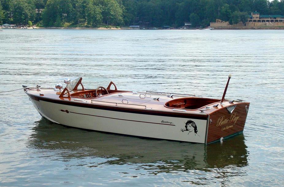

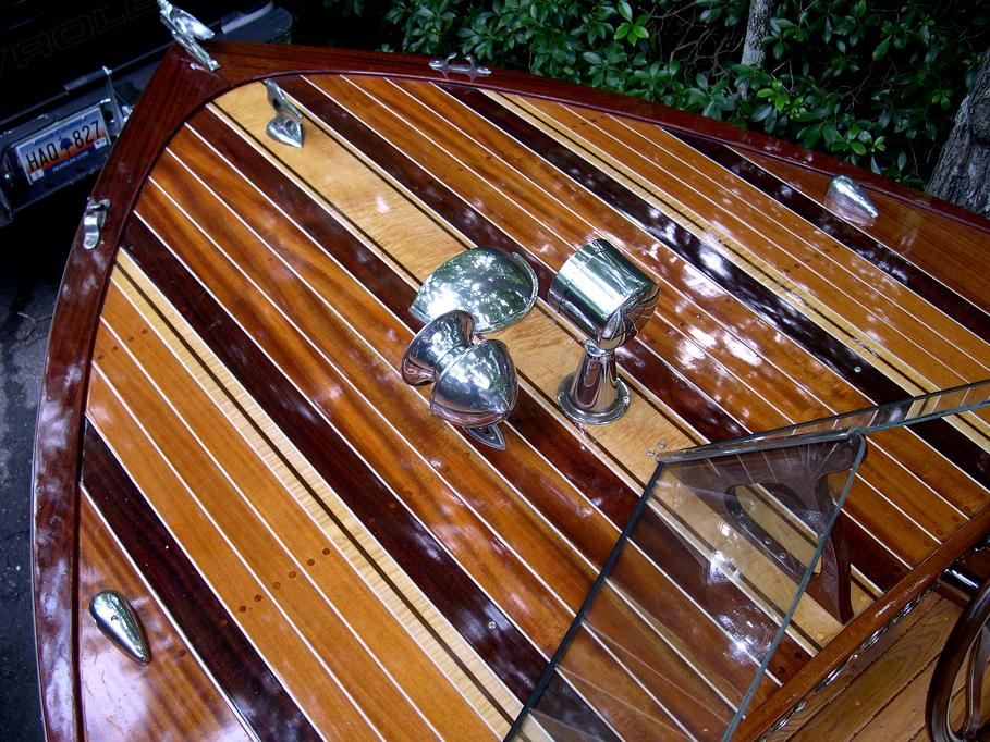

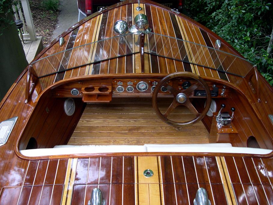

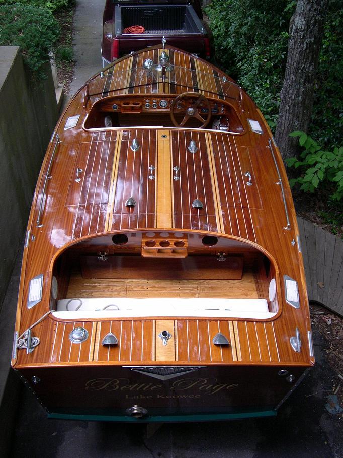

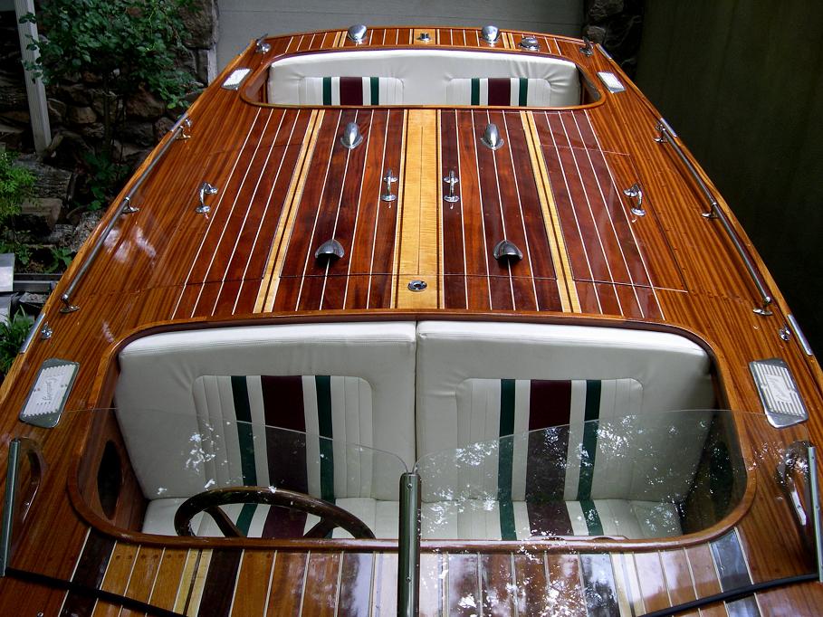

Yes, Bettie will be residing on Lake Keowee at The Cliffs. Since you never got to see her, here are a few photos taken tonight. The new owner wants to pay me to remove the name and artwork so he can rename the boat...which I think sucks but what the hell...it's his boat and money's money. Whatever.

Stunning!! I would be afraid to get it wet!

I heard that! Both of those are absolutely gorgeous restorations, IMHO. I'm a "build 'em to drive 'em" kinda guy, but I sure wouldn't want anybody getting anywhere close to me on the water with either of those. :laugh:

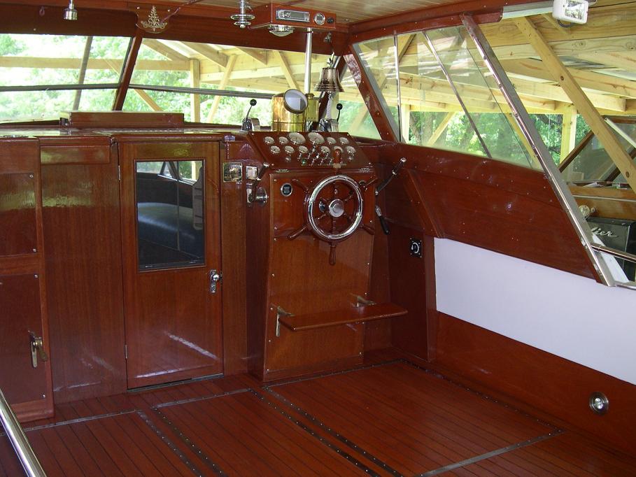

Finished the helm deck...custom fabricated 3/8" X 2-3/4" mahogany planking laid down with 3M 5200, seamed with 3M 4200 and finished with Penofin rosewood oil.

HOLY COW!!!
Re:1958 CC Commander restoration 13 years 2 months ago #63098
  • Neil
  • Neil's Avatar
  • Posts: 1997
  • Karma: 65
Beautiful. Can I get your permission to use it as my new desktop background?
Neil and Mary Ousnamer
Re:1958 CC Commander restoration 13 years 2 months ago #63108
Absolutely outstanding work!!!!!!!!!!!!!!!!!

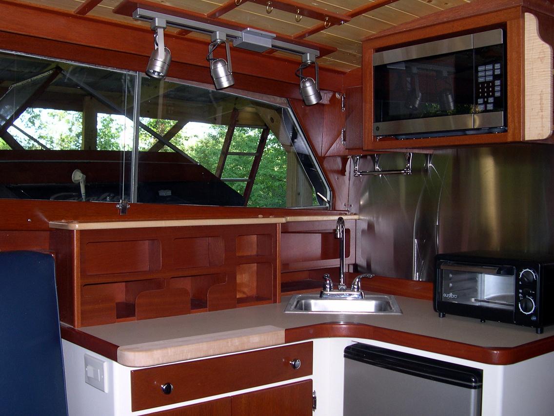

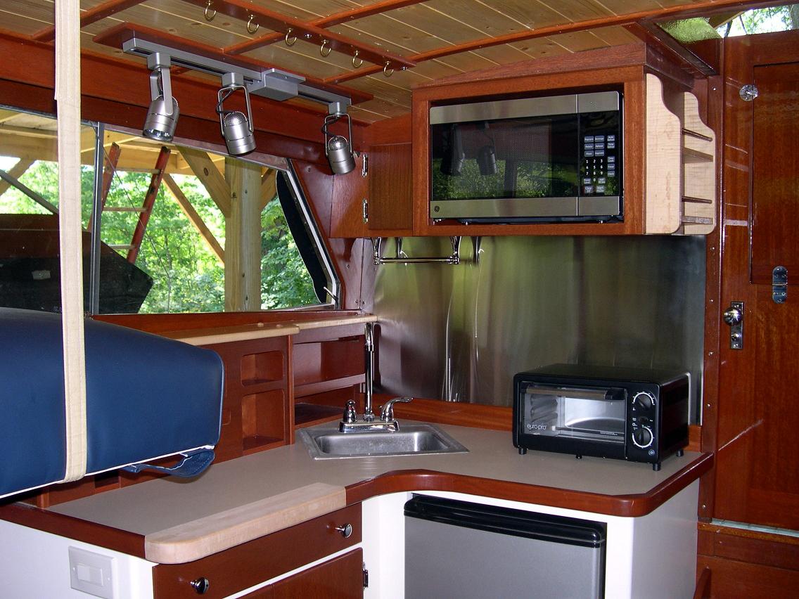

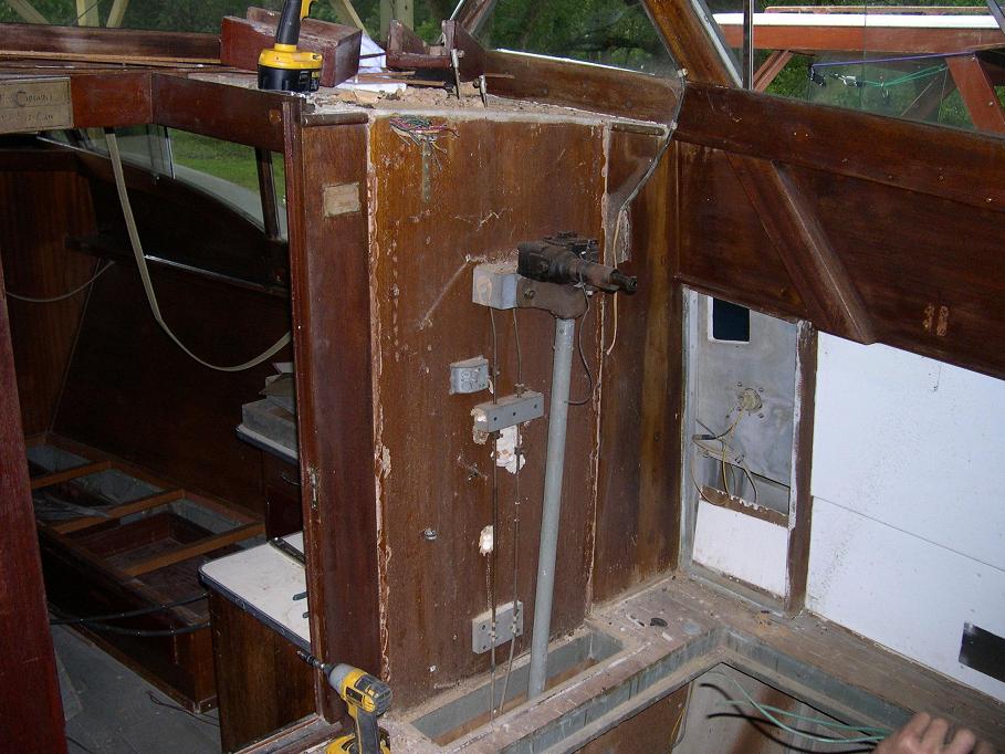

Here are before/after shots of the galley. We relaunch in the morning!

Wow, can't wait to see the splash pics!!!!!!!!!!!!!!!

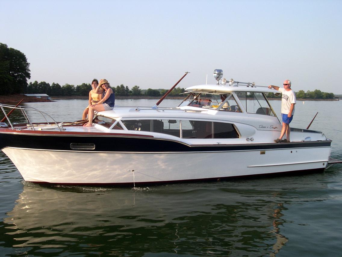

We launched on Friday, June 29th and I snapped this photo the next day. Water intake was extremely minimal and is handled by the bow bilge pump at the rate of maybe a gallon every five minutes...and decreasing steadily.

Absolutely Beautiful! I've got to believe that will be one happy customer. ;)

The happy customer.....

Wow! It's really beautiful. I'm sure you're just as proud as the owner.

Beautiful! All have got to be proud.
