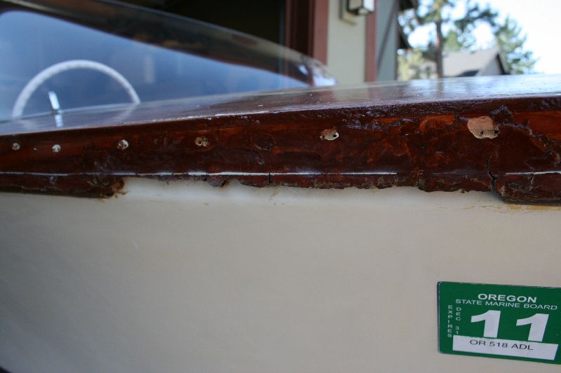

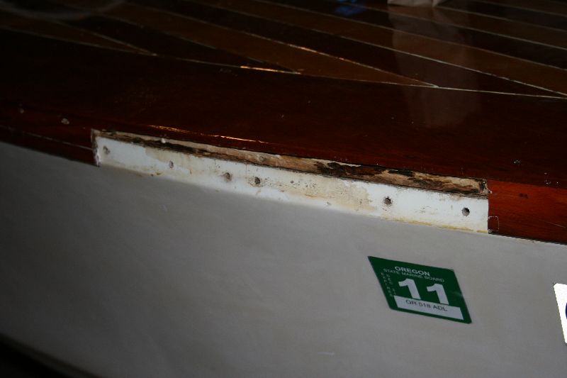

Some of you may remember that I had some wet rot issues towards the bow on my Crosby. I cut out the rotted part and got my wood-worker buddy to get a mahogany piece to fit. I just got the piece along with some wood plugs. When I attach the new piece, what adhesive should I use that works best gluing wood to fiberglass? 3M 5200?
Brian
Re:wood adhesive question 14 years 10 months ago #53340
A flexible urethane adhesive would be appropriate and 3M 5200 is a good example. Clean the fiberglass surface first, then sand lightly, then clean again.
