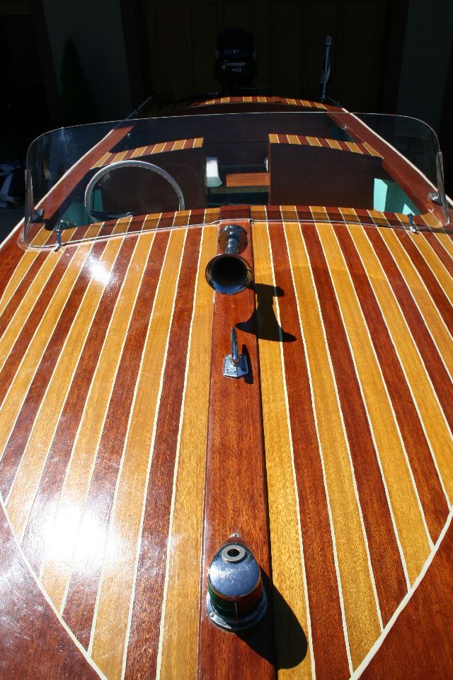

Good idea but, Brian correct me if I'm wrong, he's varnishing the bow. It looks like the Chris Crafts or Century's so the bow wood is blonde and they paint the white between the Blonde planks.

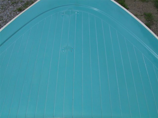

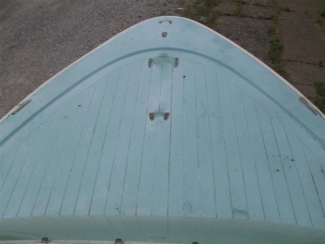

Thanks guys. Here's a pic of what I'm working with. This is before I sanded it. Right now, I have the old varnish sanded out of the channels of the white lines and I stopped right where the boatlife caulk begins. There's just enough of a channel to keep me straight on the lines, but that pinstriper made it look like I could finish the whole deck before I finished a beer.
Brian

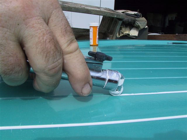

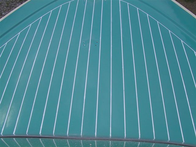

Here's the Beugler striper in action. Not sure it's going to go through. I was having some issues with the download.
Re:Anyone have a Beugler pinstripe kit? 15 years 1 month ago #45242
  • bseguin
  • bseguin's Avatar Topic Author
  • Junior Boarder
  • Junior Boarder
  • Posts: 115
  • Karma: 5
Trying again...
Re:Anyone have a Beugler pinstripe kit? 15 years 1 month ago #45244
  • bseguin
  • Junior Boarder
  • Junior Boarder
  • Posts: 115
  • Karma: 5
Nope. Sorry. Well, you can see it if you type "pinstriping a boat deck" on You-tube. They pinstripe a Chris Craft deck.

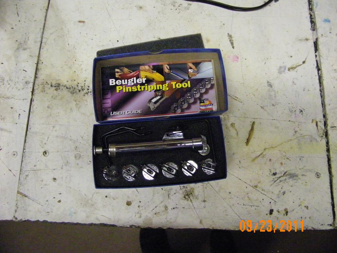

Brian, I have one if you're still interested in the loan. I bought it almost 30 yrs ago and they haven't changed much. Tricky to learn so I would suggest some trials on paint. It needs to be thick. Mail me, it would fit in a usps priority small box.
Cal

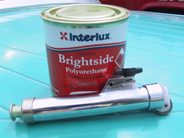

i have used a beugler tool to stripe several boats. i find it was easy to learn to use and does the job quickly. on boats i use the brightsides for striping and boot tops. the consistancy is good for using in the beugler.

It's in the mail this afternoon. Bought it at a world of wheels car show back in '82. One of those demonstration booth things. I think at the time I paid like $15 bucks. Inflation has a funny way of creeping up on us.

Re:Anyone have a Beugler pinstripe kit? 15 years 1 month ago #45342
It takes a steady hand, experiiment first. The instruction book is in the box.
I have a tracking number if needed I also put insurance on it.
USPS priority.
Good Luck
Cal
