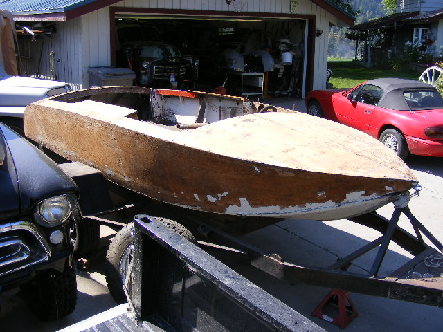

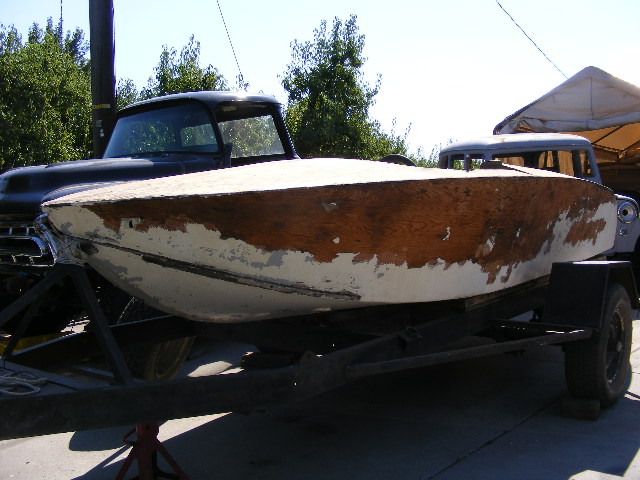

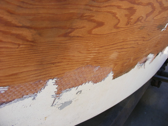

Started to strip the older applied fiberglass off my plywood 15' woody and have a few questions. Surprise, surprise, things arn't sanding at the same speed! I am using an inline air sander and going with the grain but it's leaving the ply looking like 10 miles of bad road. My plans were a simple looking resto like maybe back in the day, not an over restored look. Don't need a jewelry box, mile deep finish. Would like to keep all the original wood but if it's not going to cooperate do you think I should just rip off the old and insall new ply? My plans were to have a painted bottom and sides with a nicer wood deck of some sorts. Any thoughts? Anyone know who made this one?
Another question, nows the time to decide if the seating should be in the rear of Flatty or leave as is? I need a direction! Thanks

I have found that an electric vibrating sander does a better job at getting a good finish. Other types of sanders work better for stripping/rough work.

With the wood softer than the glass, it will be hard not to sand more wood as soon as there is a hole in the fiberglass no mater what you use. Can you feather in the old fiberglass, or is it loose?

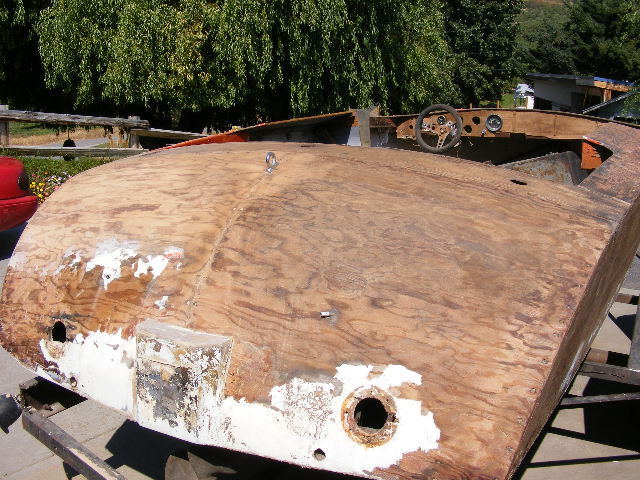

She's loose in places!

I like the transom on that boat and the external rudder. Good luck with the resto.

Jepster is right, the fiberglass is a lot harder than the play so if a hole gets sanded through it he wood will disappear a lot faster than the fiberglass. Also since the ply is fir it will sand like pine with soft and hard places. Your best bet for that sanding is by hand with a sanding board, kind of like the inline air sander but flexible 1/8' ply with a handle on each end and the sandpaper attached to it. IF you use the air file/sander style you have to be very careful and let be too aggressive. Another thought on the glass is maybe using a stripper that will strip fiberglass epoxy. I can't think of the brand right now but I know a few exist.
I would leave the seating as is, keeps it original, but that's just me. Not sure what you have there but definitely looks cool and will be great once your done.

Sure looks like a Glen-L to me. The glass needs to be there. Don't remove it. My Glen-L Missile, and many of their plywood boats are designed with a glass overlay. Great lines!

Jepster/Straycat, yeah just don't leave it on too long that it seeps too far into the wood outer layer. After what Brian said though I wouldn't remove the glass unless it was delaminating anyway.
A lot of those old plywood hulls had glass over them to help keep the strong and keep the water from getting in. I should also preface that with, on the fir ply boats. I don't recall seeing much glass on Mahogany Ply boats. Not that some probably didn't have any, just don't recall any right now. The Mahogany Ply was/is a lot more durable, rot resistant, etc. than fir-ply, hence the use of glass over the hulls.

Fiberglass delaminating in huge area's and stuck like glue in others.
Googling I see alot of Fiberglass "paint strippers" but no Fiberglass stripppers..................

Just put in Epoxy stripper. Here's a quick link to one I found www.wmbarr.com/product.aspx?catid=102&prodid=209 . It does say it's safe for wood. Like I said earlier, just be careful how long you leave it on so it doesn't seep into the first layer of wood very far. Notice that the warnings on the label of the one on the link say don't use on fiberglass, that's your hint that it will eat it/remove it. Also when it's saying it's safe for wood, they generally mean solid wood not plywood, hence the caution on letting it stay too long. Don't leave it on more than what they call for. You'll probably have to do a couple of coats to get through the well adhered stuff.

I'm just guesing but it could be Polyester on the woody, would the Epoxy stripper eat it anyway?

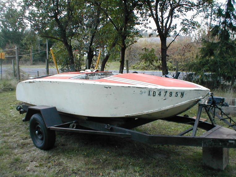

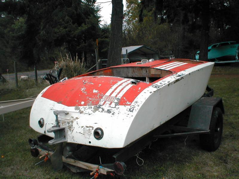

These 2 Woody's have also been posted on the VH site where it's a little harder to navigate..........
Here's maybe it's big brother a 19'er?

Ok cool boat, but check out that funky trailer!
The motor can't be in that boat. If there was a flat head V8 in the engine compartment, the tongue of the trailer would be pointed toward the Moon.

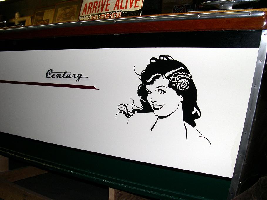

As for the hull...I ran across the same situation with the Bettie Page, my 1961 Century, plywood hull. I didn't have fiberglass but I sure had "iffy" plywood...voids, roughness, etc. My solution was to cover everything with 1/4" meranti marine plywood. (actually, it's considerably thinner than 1/4"...maybe 4 mm?) Anyway, I cut the pieces (two per side) and fitted them "dry." Then I lathered-up the sides with 3M 5200...evenly with 1/8" grooved spreader. I put the new plywood in place and fastened it all over the place with a t-50 tacker. The staples didn't go all the way in and that worked out just fine. They were easy to pull a week later when the 5200 was set up and the tiny holes were filled with bondo, undetectable. Here's a close-up shot of the hull when finished:

By the way, the recovering idea means that you can immediately stop trying to remove the fiberglass. Laminating the hull with new ply using 3M 5200 is about as permanent as you can get and will actually strengthen the hull considerably. If you want to remove it at some point in the future, you'll need a chainsaw.

Although I said bondo, I actually used JB Weld...what I had sitting around at the time. The staple holes were extremely small and looked like pin holes after being filled. I don't anticipate a problem. (Besides...where's the water going to go? It going to run smack into a wall of 3M 5200!)

Want to thanks every body for their recommendations, woody is put away for the winter so won't be doing anything till spring. Looks like a new skin over the old skin is the way to go, will take care of that part than be back with more questions about a new deck of some sorts. Will be keeping the Flatty atleast up to the point of having to choose which power plant to go with. Thanks again!
