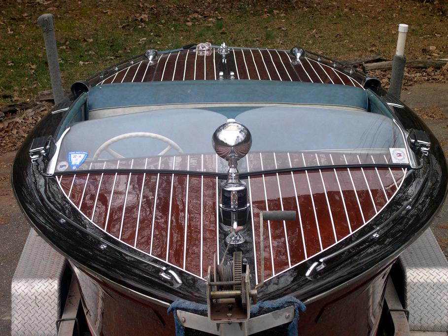

Although I used Captain's varnish for many years, I've switched to Petit Easypoxy 2056 Hi-Build varnish. I like everything about it...very user-friendly, easy application, good flow-out, great finish...and fairly cheap. You can get it on Ebay from Wholesale-Marine for $22.97/quart. Here's the result:
Mentor to the unenlightened!
"Success makes...
Re:Wood sanding question 15 years 2 months ago #43767
Beautious. Urethane?
Re:Wood sanding question 15 years 2 months ago #43773
Absolutely beautiful finish, Nautilus. I use Wholesale Marine ( www.wholesalemarine.com ) as well, for about four years now for various different things. Great folks, reasonable shipping charges, really good prices. ;)
